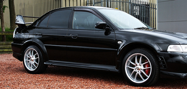

Hello again chaps. On this occasion I thought it was time to show some decent detailing instead of dirty box to clean box like I usually do. What better than a poor condition Pearl Black Evo VI!
Bought recently by my Cousin's Fiance it wasn't in the best condition, granted it's been driven not detailed and is a good 10 years old now! The main aim was to restore some actual Black into the paint and remove the worst of the swirls while re-visiting for some heavier correction at a later date if required.

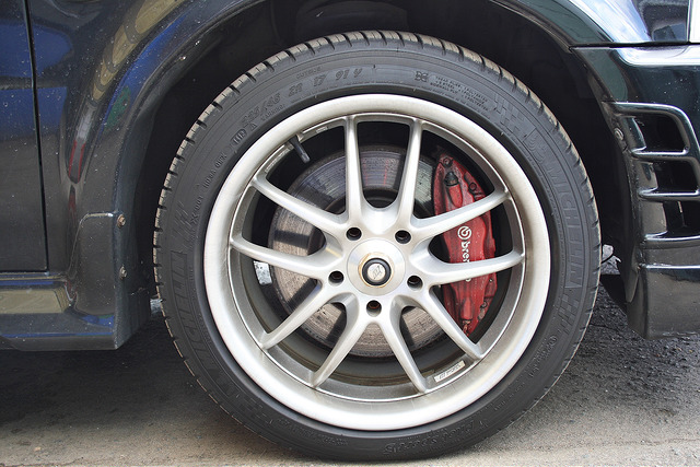

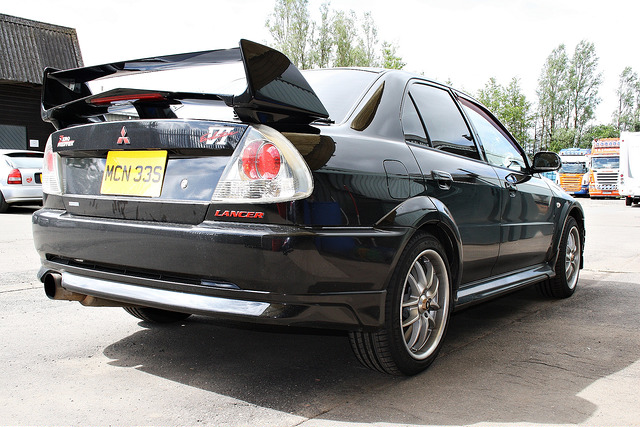

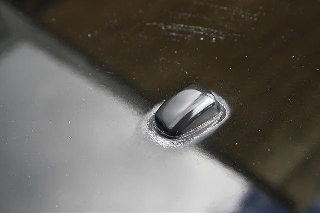

So some befores and straight into it. Everyone knows how to wash a car by now! :eek: Usual process carried out nothing fancy.
IMG_7102 by gally.., on Flickr
IMG_7103 by gally.., on Flickr
IMG_7105 by gally.., on Flickr
IMG_7108 by gally.., on Flickr
IMG_7109 by gally.., on Flickr
IMG_7110 by gally.., on Flickr
IMG_7113 by gally.., on Flickr
IMG_7117 by gally.., on Flickr
IMG_7118 by gally.., on Flickr
IMG_7123 by gally.., on Flickr
IMG_7124 by gally.., on Flickr

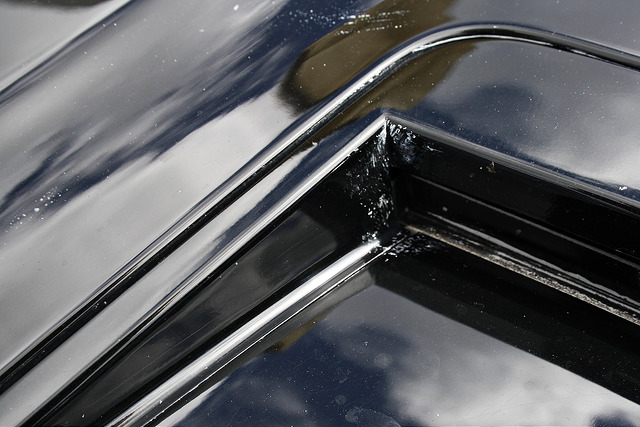

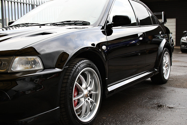

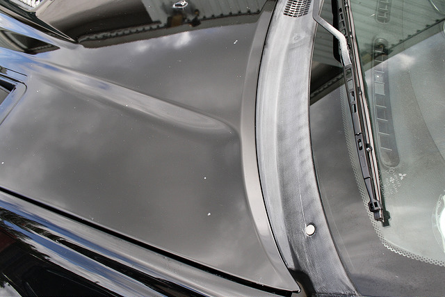

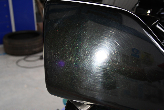

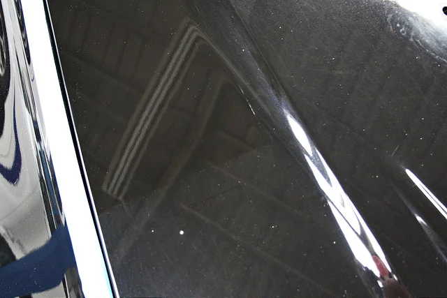

So inside for some drying, masking and some checking paint depths, more fun ahead. Now i'll mention that jap paint in general is soft, of course you never take this for granted but is a decent rule of thumb until you get to check. Paint depths were all over the place on the particular Evo, some serious low points, 2 front wings being very low, was very careful and the Bonnet and driver's door being high.
I had previously checked this Evo and it was very soft so decided on a combo to do the job. In this case a very old favourite combo of Lime Prime on a 3M Yellow pad was the order of the day...
IMG_7132 by gally.., on Flickr
Little test on the bonnet...
IMG_7129 by gally.., on Flickr
IMG_7133 by gally.., on Flickr

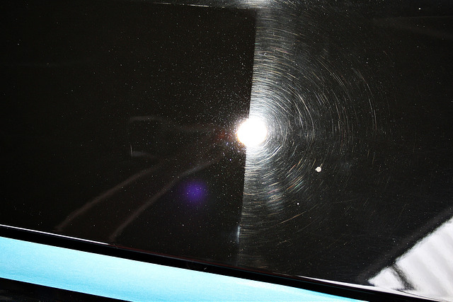

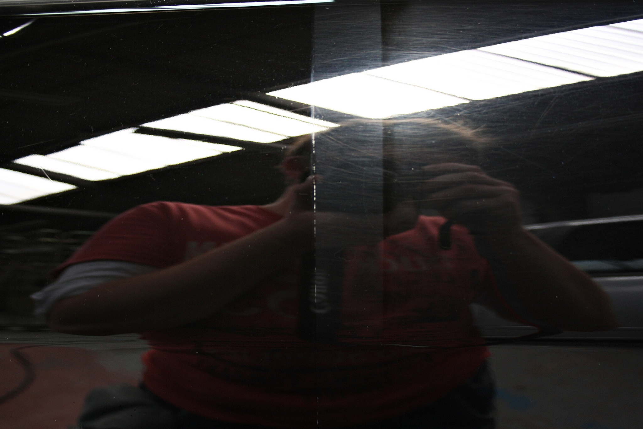

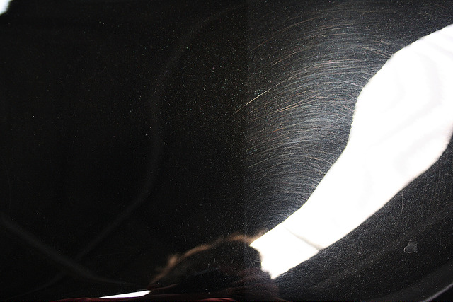

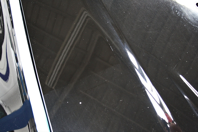

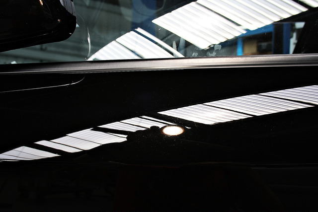

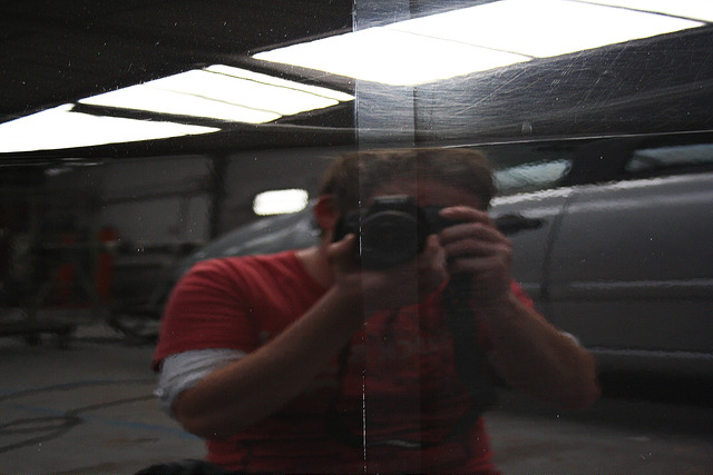

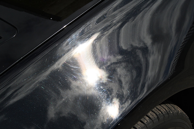

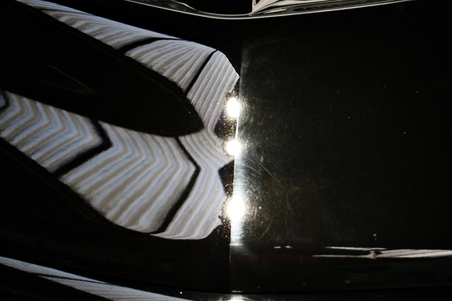

Quick check with the Sun Gun revealed some light marring! Yes marring with LP and a brand new pad! That's how soft it was! I was sitting with a WTF face! Decided to step down to 3m Blue pad, usually used for finishing and keep going with the LP.
Left this...
IMG_7135 by gally.., on Flickr
IMG_7143 by gally.., on Flickr
IMG_7146 by gally.., on Flickr

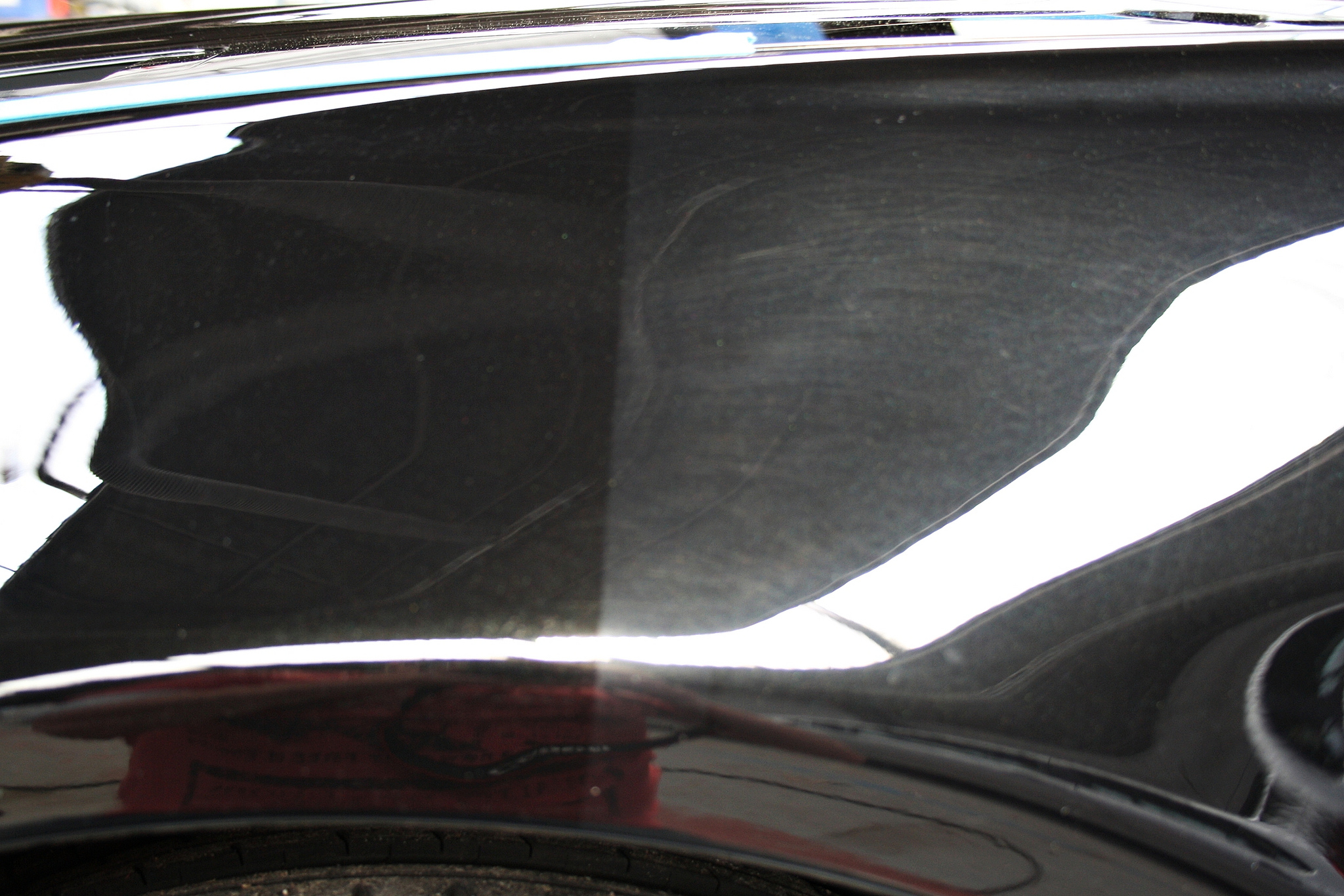

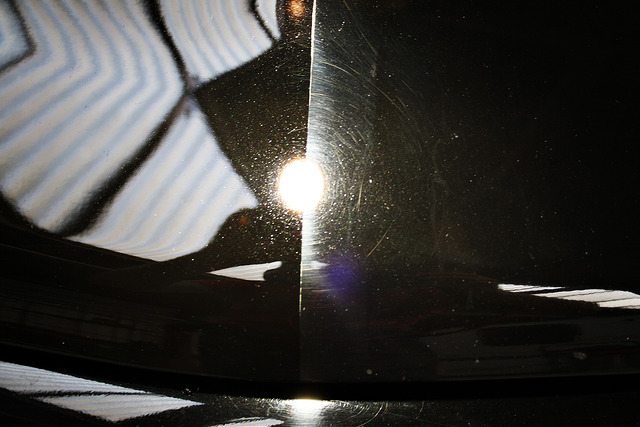

Exactly what I was looking for, some great removal with minimum clearcoat removal, whilst leaving some deeper RDS. Conditions were good and LP giving great work time.

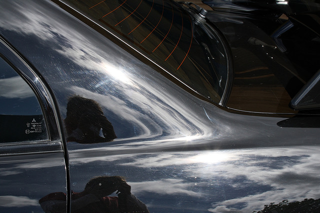

Passenger wing after just one pass/set...
IMG_7150 by gally.., on Flickr
IMG_7152 by gally.., on Flickr
IMG_7153 by gally.., on Flickr

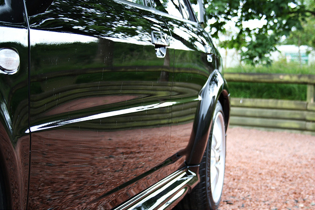

Not too bad for such a simply combo. Never to be underestimated. I stopped using LP for quite a bit. The oils in the product that actually make it so good cause bonding issues with some waxes and sealants. These days to get the best from the LSP after LP I like to give it a double Panel Wipe wipe down...

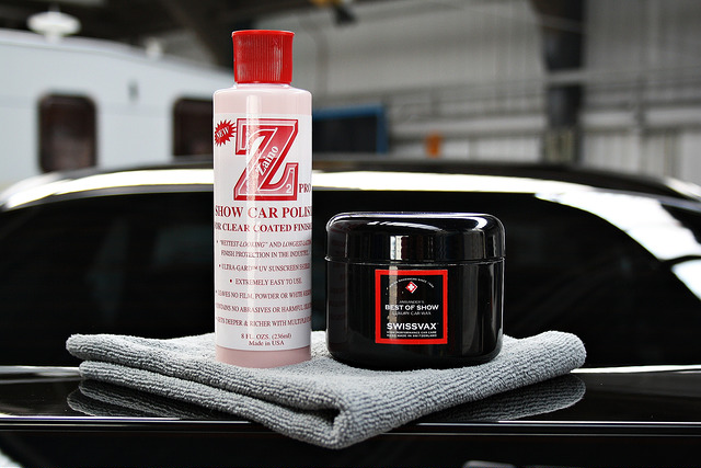

Today's LSP of choice had to offer durability but I needed it to look good, I think Black deserves it. Z2 and Swissvax Bos. Bos for those that know it's a lovely wax but imo it has simply become a show wax on it's own. Packed full of oils it leaves a great finish but simply washes away too quickly, hence the great base of Z2. Nice solid sealant bonding to bare paint for any further layers like Bos. So best of both worlds.

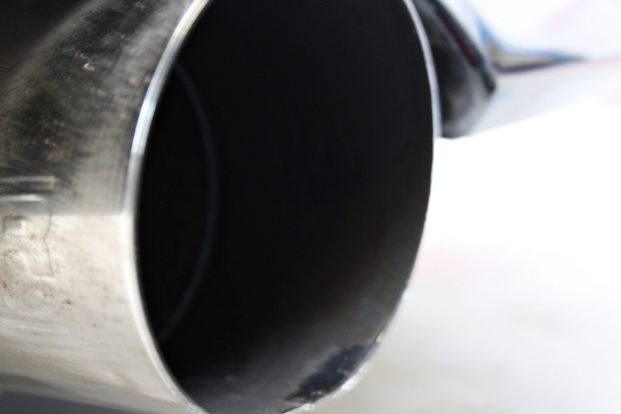

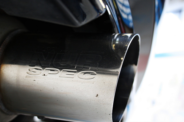

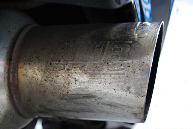

Exhaust dealt with with some Auto Finesse Mercury, impressing me from initial testing...
IMG_7182 by gally.., on Flickr
IMG_7183 by gally.., on Flickr
IMG_7185 by gally.., on Flickr
IMG_7186 by gally.., on Flickr
IMG_7188 by gally.., on Flickr

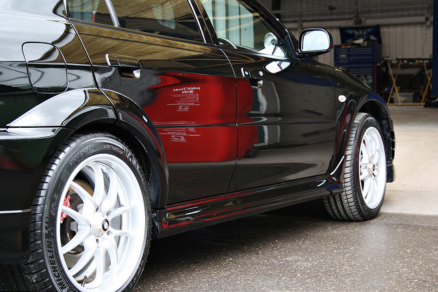

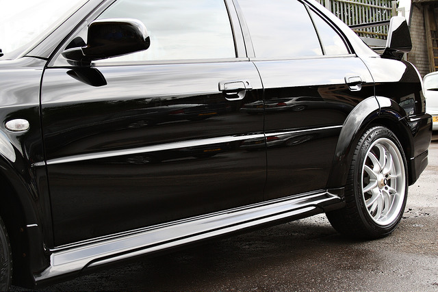

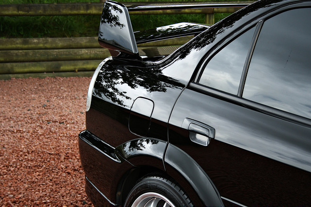

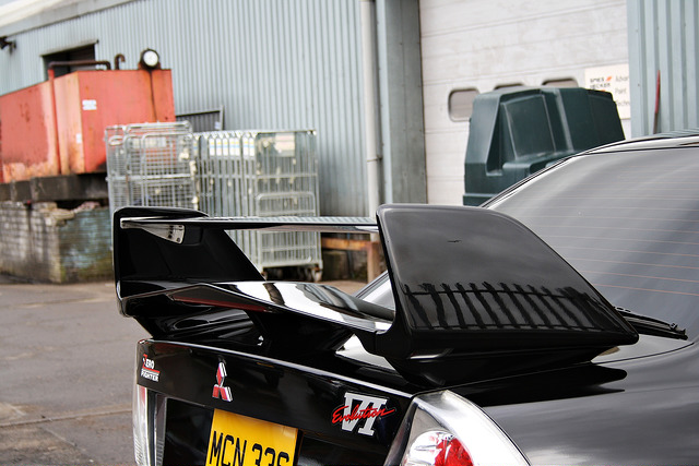

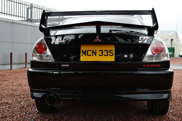

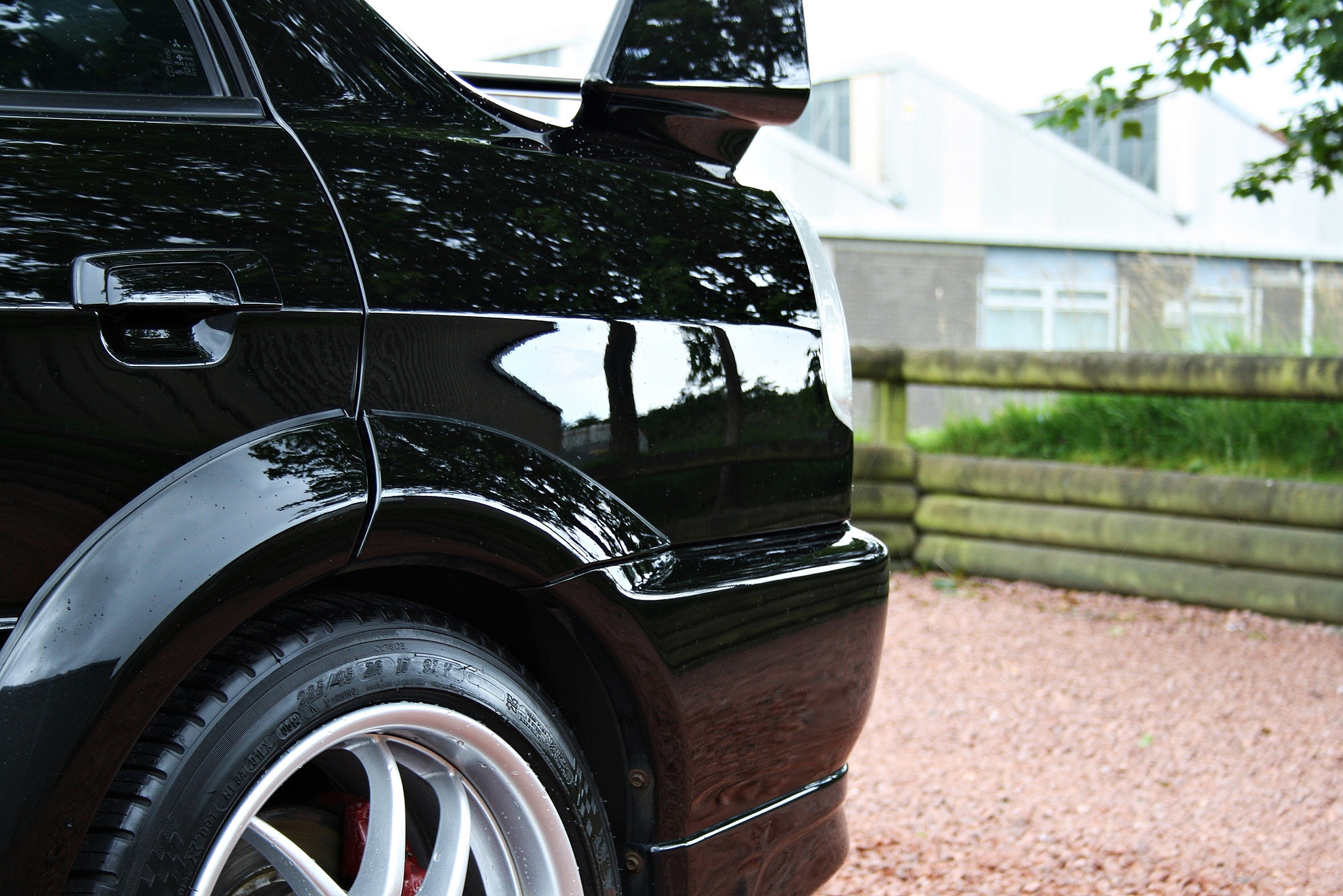

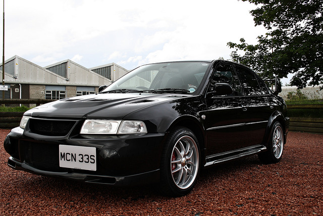

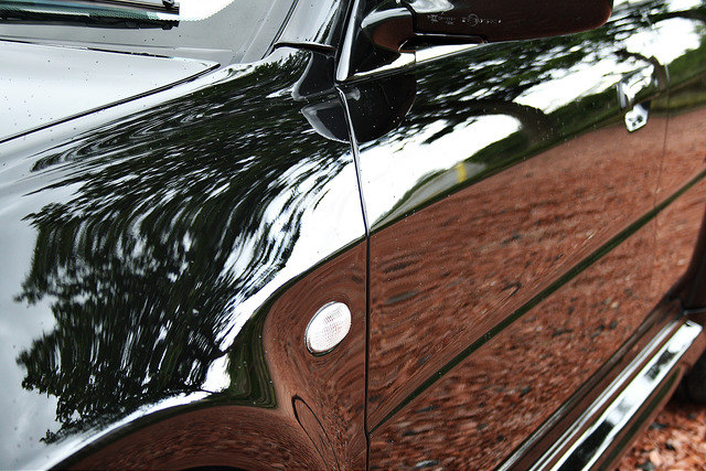

Enjoy the afters...
IMG_7191 by gally.., on Flickr
IMG_7195 by gally.., on Flickr
IMG_7196 by gally.., on Flickr
IMG_7198 by gally.., on Flickr
IMG_7199 by gally.., on Flickr
IMG_7201 by gally.., on Flickr
IMG_7202 by gally.., on Flickr
IMG_7204 by gally.., on Flickr
IMG_7206 by gally.., on Flickr
IMG_7207 by gally.., on Flickr
IMG_7208 by gally.., on Flickr
IMG_7210 by gally.., on Flickr
IMG_7212 by gally.., on Flickr
IMG_7213 by gally.., on Flickr
IMG_7214 by gally.., on Flickr
IMG_7215 by gally.., on Flickr
IMG_7216 by gally.., on Flickr

Great turn round on it, Can i be nosey and ask what your low points measured at, My evo 6 is about 80 microns all round give or take minus a front wind thats been sprayed. Also the auto finesse mercury is that just a hand application because that was a huge revival!
Gally
Yeah just hand, little bit of wire wool on the outside, MF only everywhere else. Decent product from them.
It was around the 70-80 in parts just under on the front wings and lower doors. :) Jap paint at it's best tbf.

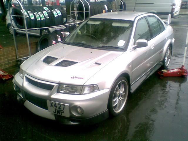

No problem :) There was a limited edition in Japan called the Zero Fighter, approx 340BHP, bodykit (front/rear lips, sideskirts), different springs, the Work Meister wheels, badging etc.
It wasn't called the Zero Fighter in the UK as that was a name given to a WWII Japanese fighter plane and would've been considered bad taste - so it was called the 'Extreme' and available with 450BHP :evil: through the then named Ralliart UK in Dudley.
Having said all that, your mans wheels are 17s and they were 18s on the ZF/Extreme, so could be fakes after all. :rofl:
Here's a shot of an Extreme for reference:
