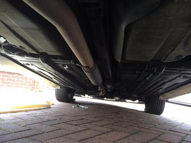

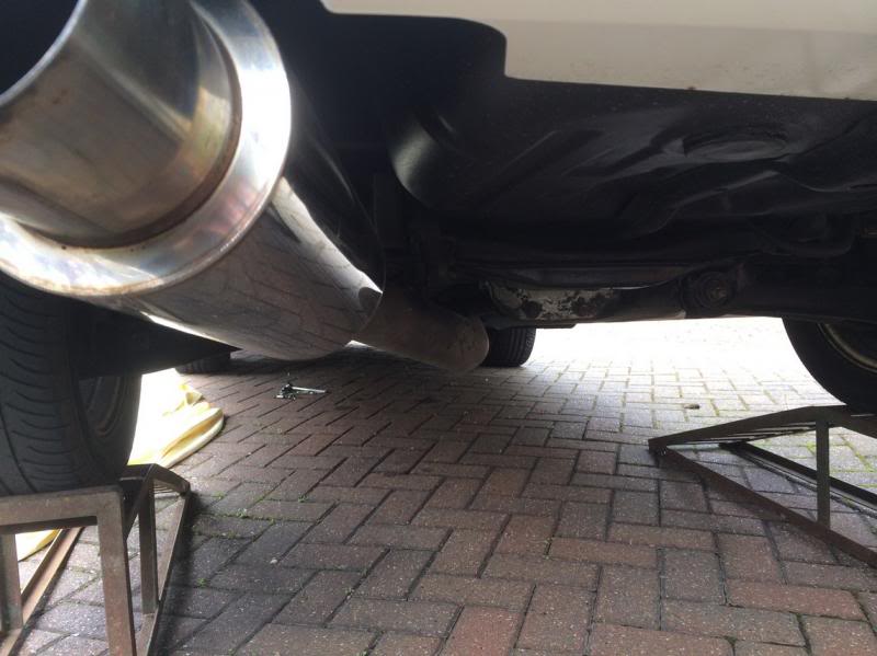

Next thing to do, which had been on my list for a while was to replace the exhaust with an OEM one, it was just too noisy with the big exhaust on, the drone at 3/4k on a motorway for example just made it really unpleasant, and I didn't mind potentially losing a few hp if it meant a much nicer ride, plus I really dont like the drainpipe look, so a new exhaust was ordered from Mitz

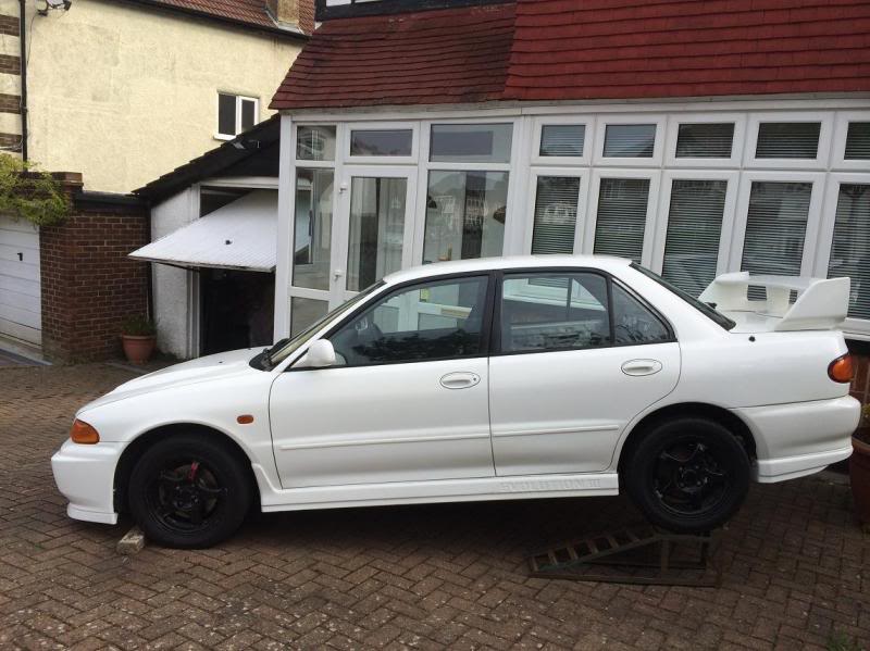

And I borrowed some ramps so that we could get underneath and swap the exhausts over

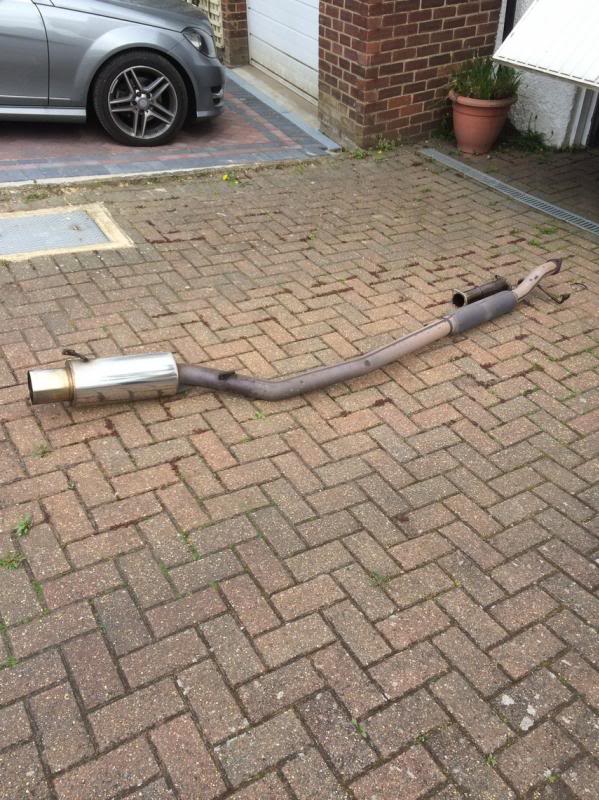

Old exhaust off
And sold!

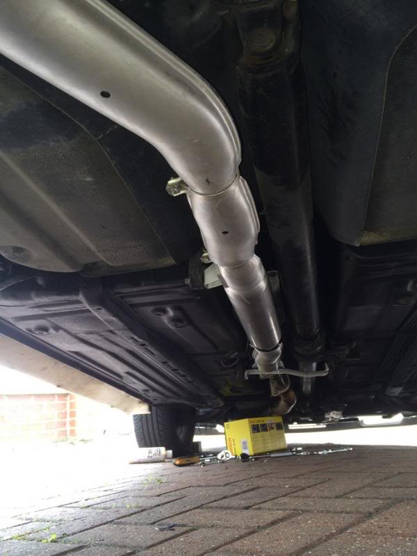

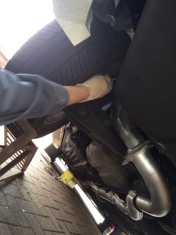

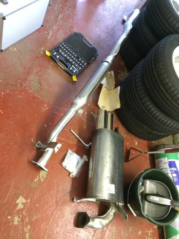

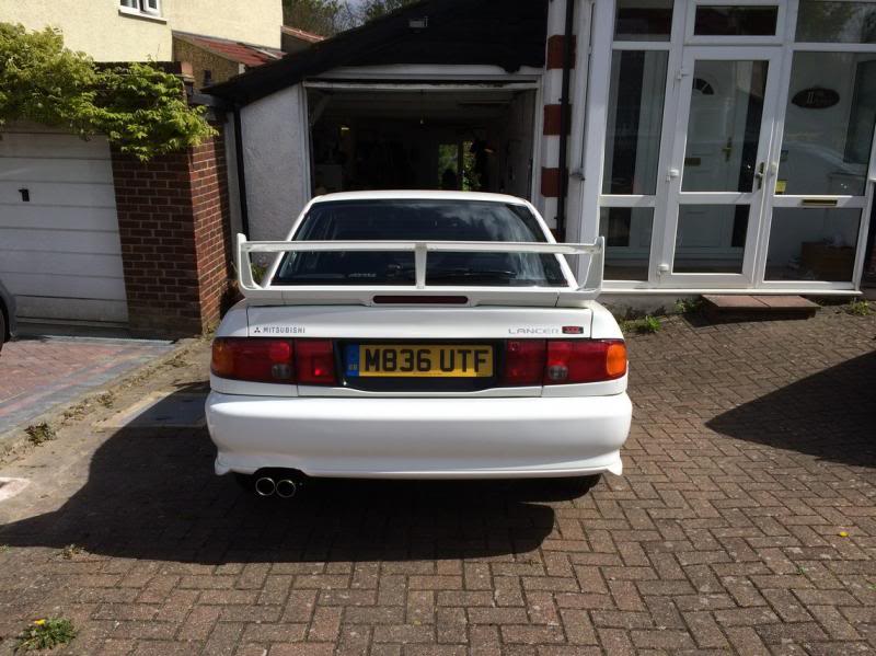

Then on to fitting the new one, this included lots of new exhaust hangers and gaskets too as some of them had perished a bit
And fitted :)
Ive left the decat in for now, but for me this has massively improved the way the car drives, its so much more comfortable and the performance has surprisingly not changed all that much, if anything all its done is move the powerband very slightly down the rev range, I imagine if I had any other mods then the standard exhuast could prove restrictive but im not planning on modding at all apart from maybe a remap, so im quite happy with this :)

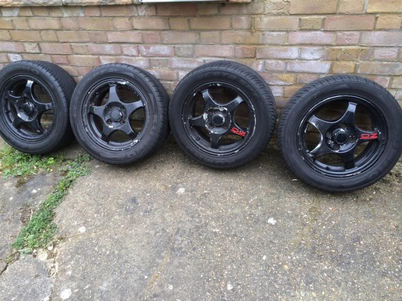

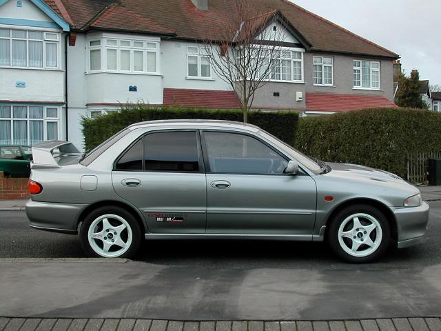

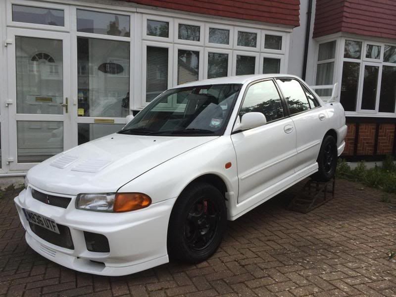

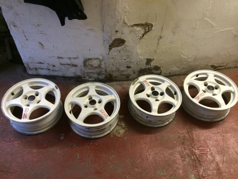

Next thing on the list was the wheels, I already had a set of the original wheels that id bought not long after buying the car, so I took these ones off and sold them

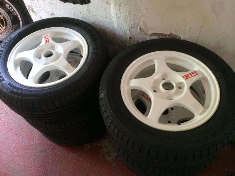

This went some of the way for paying for the other set I had to be refurbed by Lepsoms in Kent, while I was at it I had them fit a set of brand new Goodyears :) so off they went....
and came back fully refurbished with new tyres

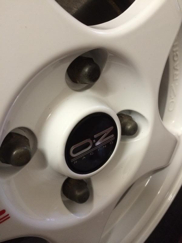

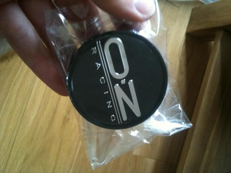

and new OZ wheel caps as well, surprised Mitz still stocked them but they have been very good for parts, cant complain at all
  Street Triple R

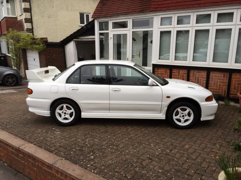

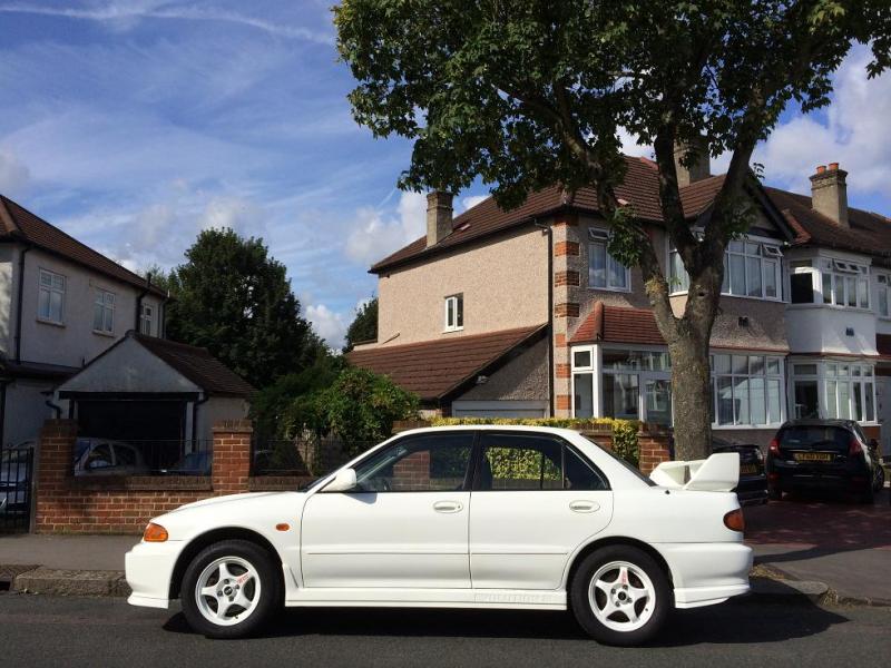

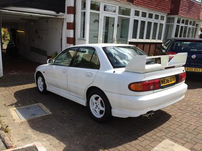

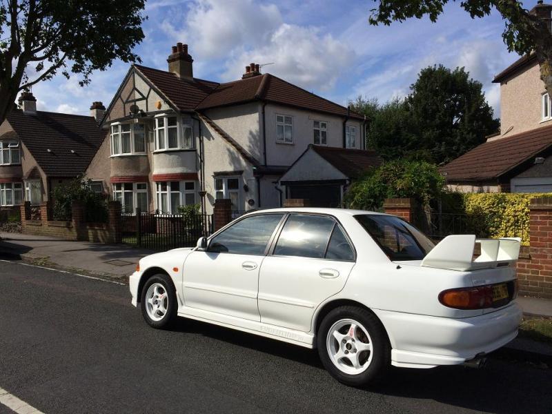

And fitted :)
I know the wheels look tiny, and for some reason my suspension, despite being standard, seems to be riding much higher than it should be, bit stumped about that one at the mo :S but there is a 16" version of this wheel available and I may look to get those at some point in the future but this will do for now...plus its very fast on the 15s :)
The eagle eyed amongst you will notice that the wind deflectors have gone...wasnt really a fan of those

Much better on the white wheels, those black ones looked horrible. It looks load better now!

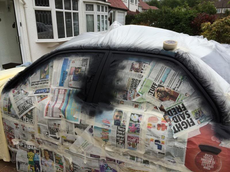

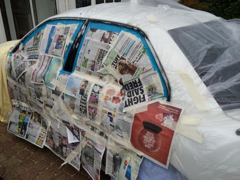

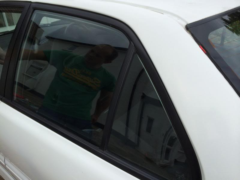

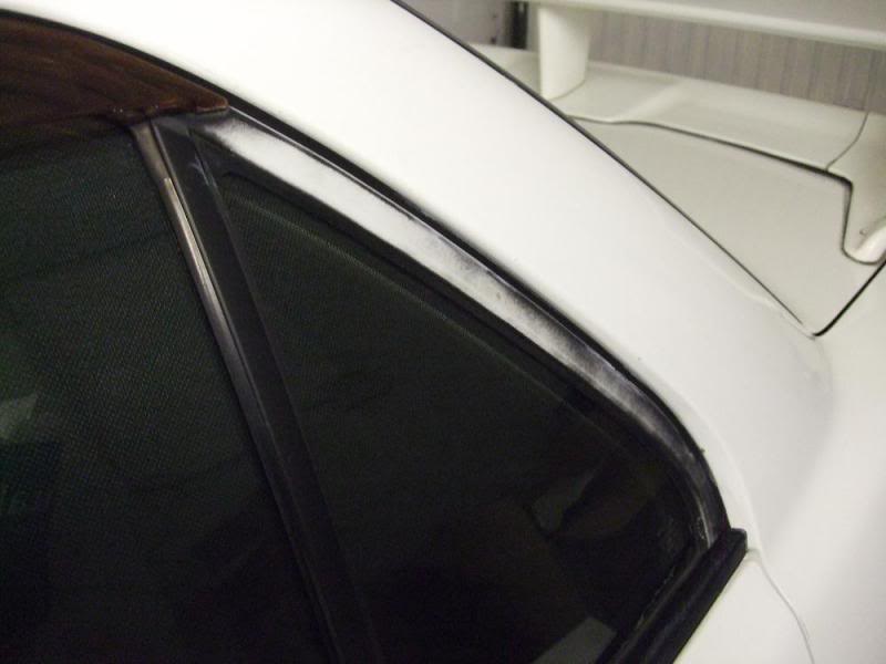

One of the things that was bugging me was the door frames, the paint had completely faded in some areas and it made it look really tatty
So, we decided to paint them....not sure why it took us so long to get round to this but oh well :)

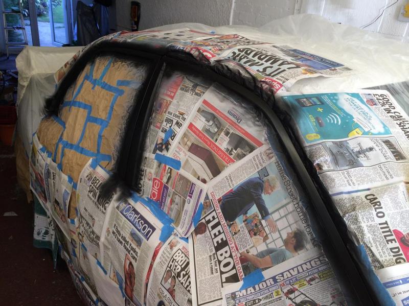

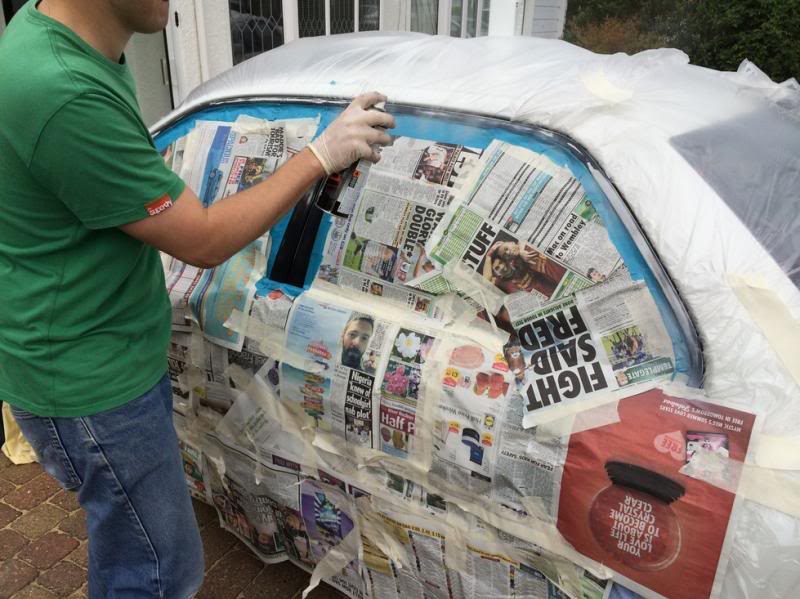

the frames were carefully masked up (this takes ages!)
Then sanded down to give the new paint a good key, and primered
and painted black
This was done for both sides
Painted the other side in the garage....bad idea!...the fumes!! just lucky I was wearing a mask!

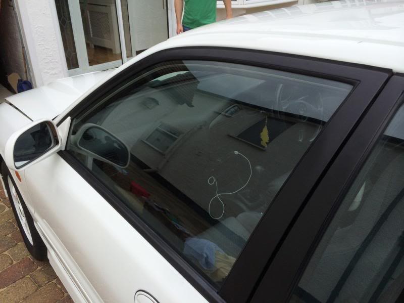

And a couple of afters
Luckily the primer overspray you can see on the last picture came off quite easily!

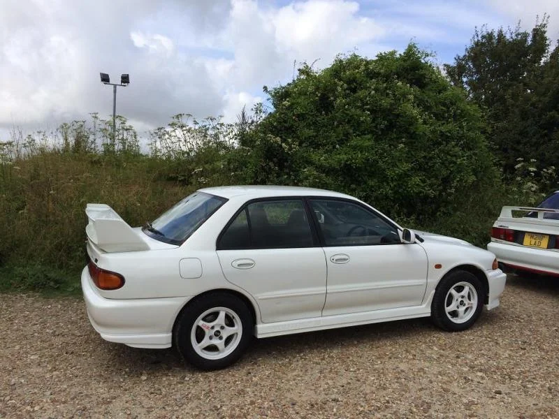

Yesterday there was a meeting arranged by the MLR at Devils Dyke near Brighton, Never been there before but a really nice spot, good place for a date probably lol

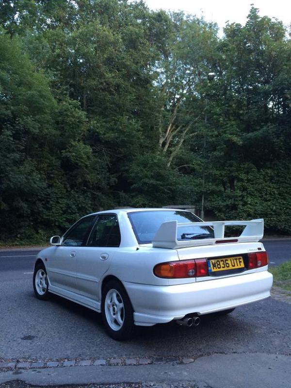

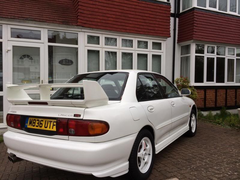

Took a couple of pics before I left
When we got there we met up with a few other Evos

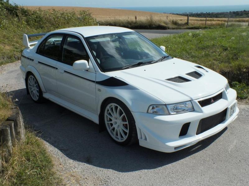

Including this lovely Makkinen edition
In the car park, parked up behind an Evo 2 RS, the dent in my rear passenger door still needs to be attended to

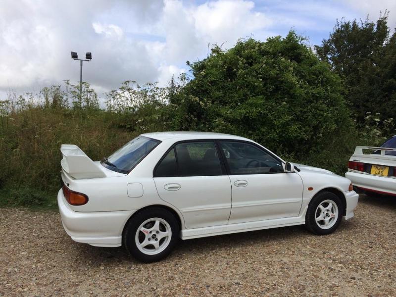

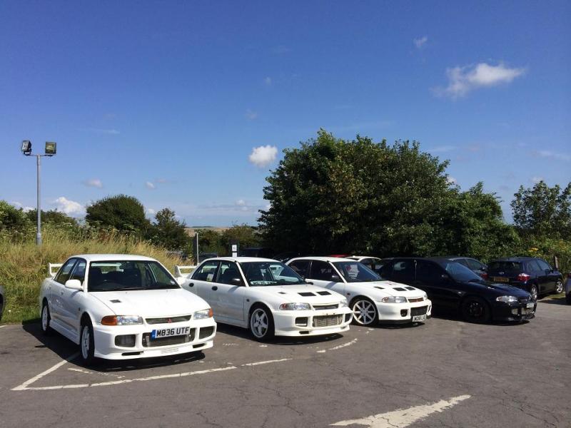

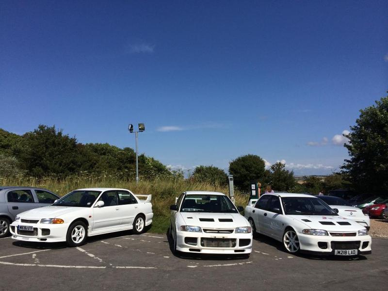

and met up with a few other early Evo owners, according to howmanyleft there are only 20 Early Evos on the road in the UK today (although there are somes sorned) so to get 4 out together in one go is pretty good going! :D
So there is mine, could well be one of the very few OEM Evos in existance! certainly Evo 1-3 anyway, also an Evo 3 RS, Evo 2 RS and another 3 GSR, The RSs are around 70 odd kilos lighter than the (already light!) GSR models, wighing in at around 1170kgs and are distinguishable by the black bonnet vents, door mirrors and door handles

Nice update & a great improvement on the door frames.
That white TME though, do want!!

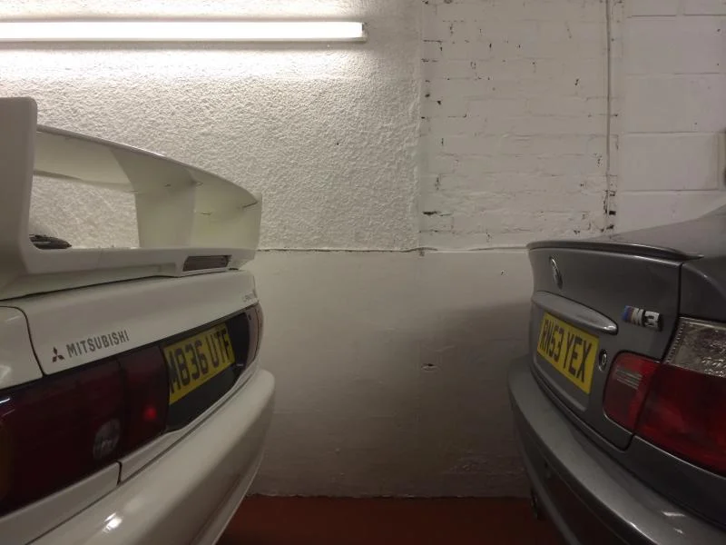

Firstly the Evo has a new stablemate!
Its very interesting comparing the 2 cars, both absolutely fantastic to drive although completely different really!

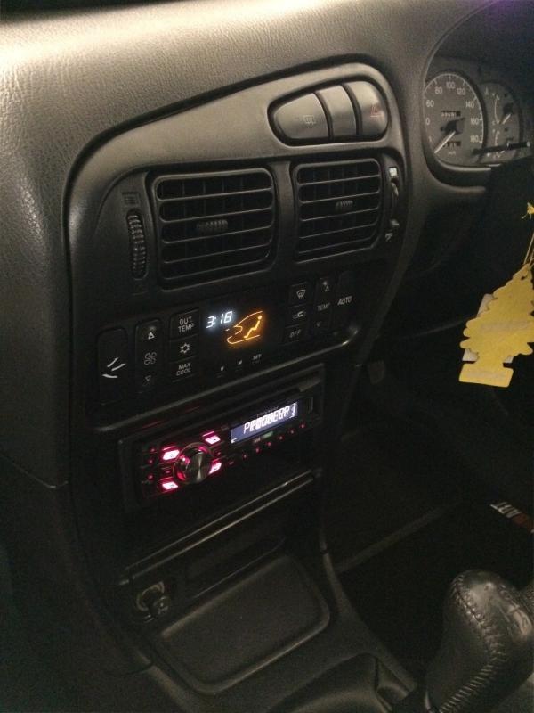

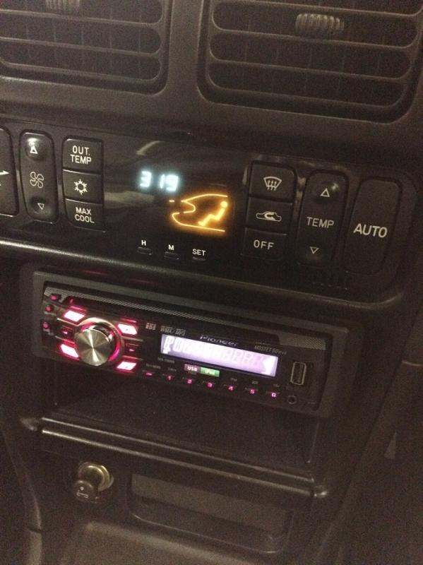

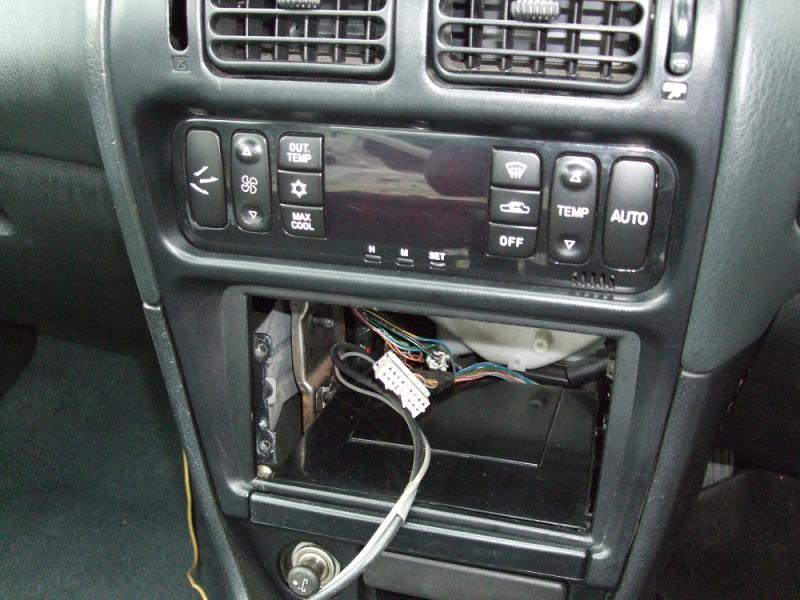

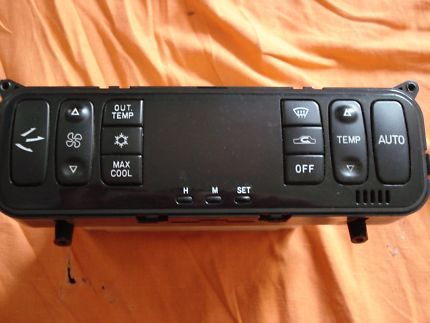

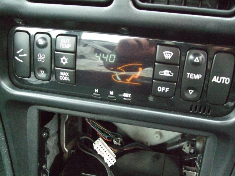

Back to the Evo! when I bought the car, the air con control unit display had failed, still worked but you couldn't tell what it was doing.
Lucky enough a guy living a few miles away from me had one from his old Evo 1, so that was bought
and fitted, you also can see the awful jap stereo has gone
and been replaced with a more up to date, Pioneer USB ipod player, but not too flashy as it would stand out quite a bit in the dash otherwise, also got a little cubby hole underneath where i keep an old ipod to connect to the radio

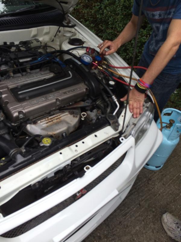

Before the car was sorned, i had the air con regassed as i really needed it on that day out in the summer! the Evo interiors do get hot!

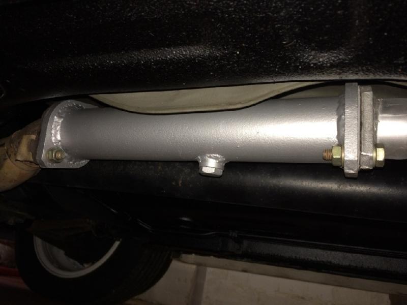

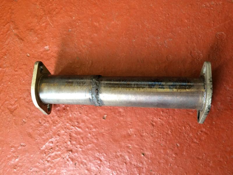

Another job that needed doing was replacing the leaking decat pipe! as it could get pretty fumey sometimes, you can see from this picture how bad it was, looked like it had been chopped in half and badly welded back together
Replaced with this one
Much better! doesnt leak!

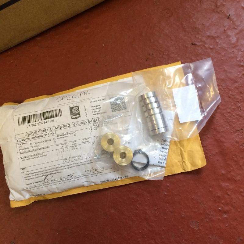

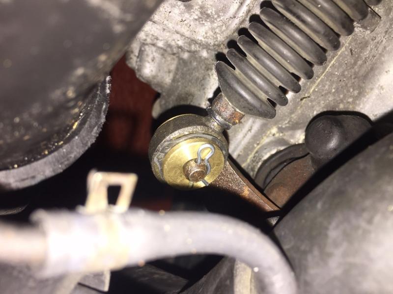

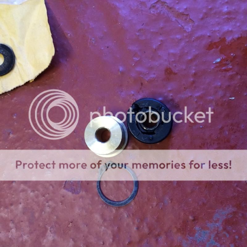

Another job that has been done is to replace the gear shift bushings from rubber ones to brass ones, The
problem with the rubber ones is that over time they perish, which makes the gearchange become slack and inprecise, on mine it wasnt too bad but you could tell it needed doing
The new bushings were ordered from the USA as the Early Evos share a lot of parts with the DSM cars in America
and here you can see the new Brass bush along with one of the perished rubber ones
Fitting was a bit of a nightmare mainly because the access to the gear cables was pretty tight, having to remove all the turbo pipework etc as well, but here is a picture of one of them fitted
It should hopefully tighten up the gearchange a bit, but i'll be able to report back once I retax the car in the spring

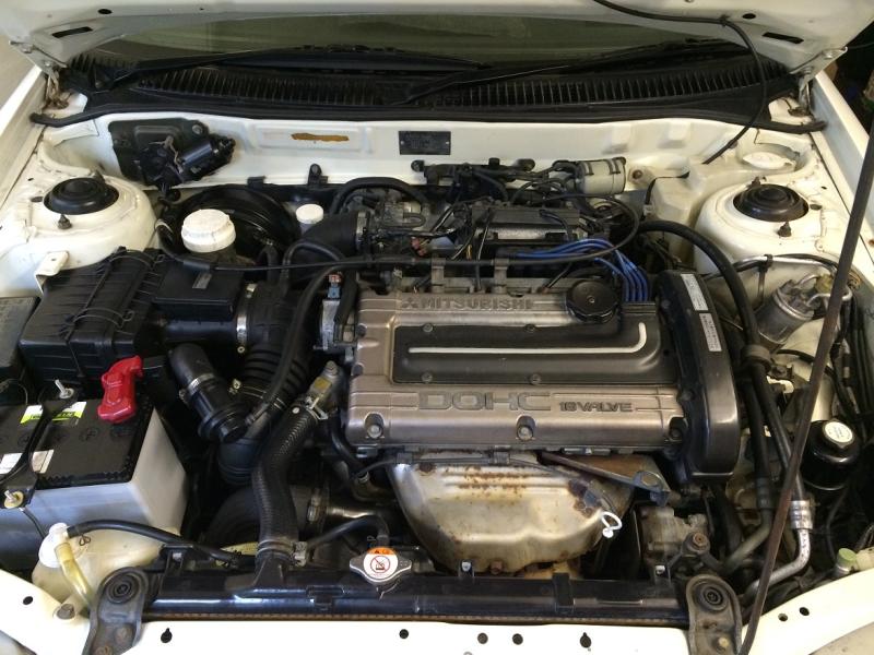

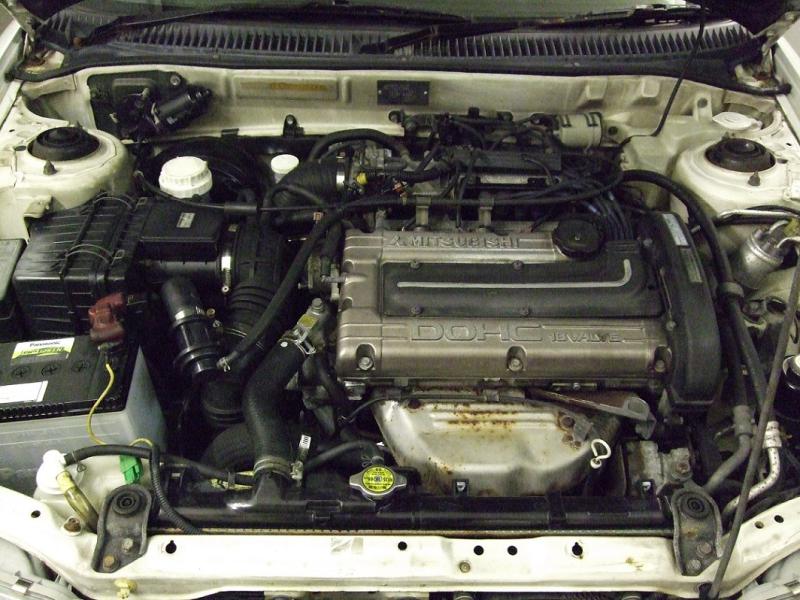

The engine bay has had a good old clean..
Before
after

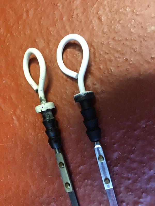

Including a new dip stick as the rubber had seemingly gone hard on the old one and didnt really fit well in the pipe any more, new one fitted perfectly

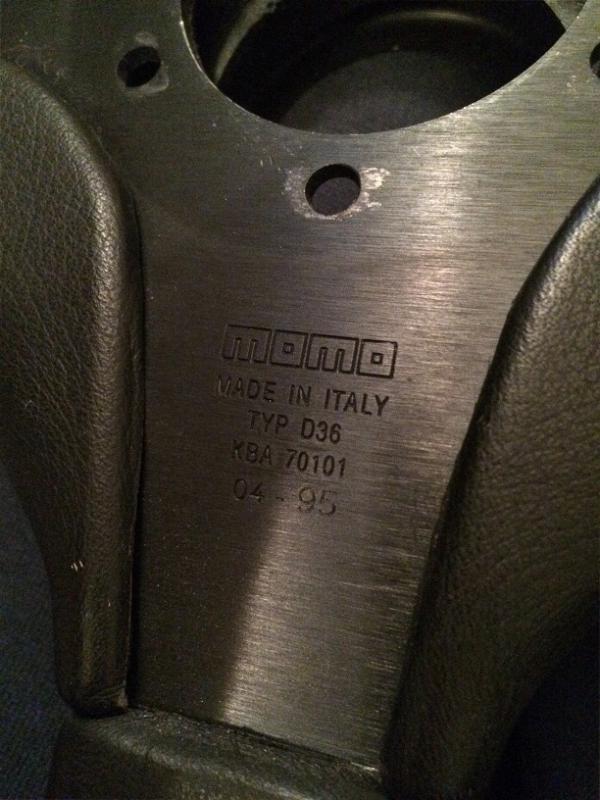

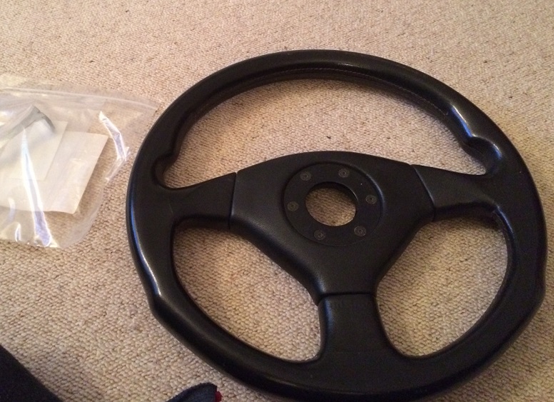

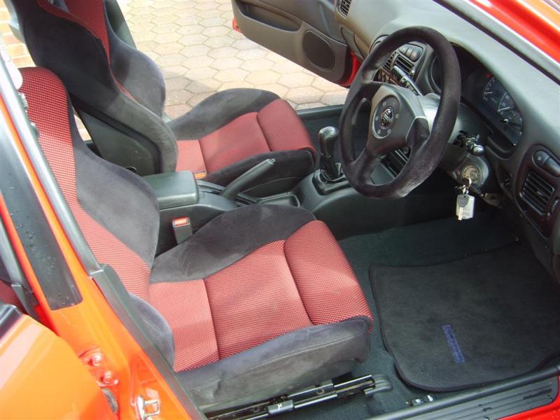

The next thing on my to do list is to get the steering wheel retrimmed, I saw this Evo 2 which had the Tommi Makkinen Interior fitted from the Evo 6 TME as well as the alcantara steering wheel

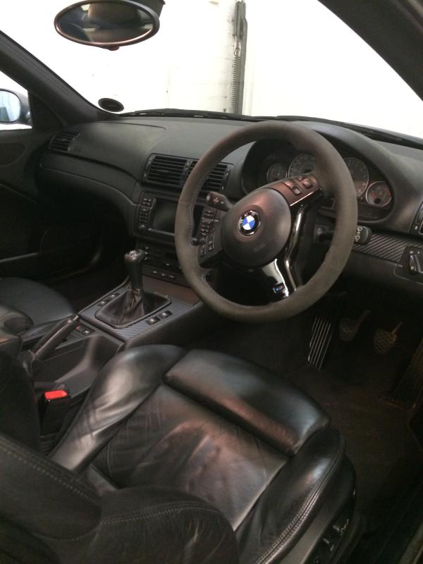

Also the M3 has an Alcantara wheel and I really like it
So Ive bought a replacement Evo 3 Momo wheel (just in case I wanted to go back to standard leather) and this will soon be getting sent off for a retrim :)

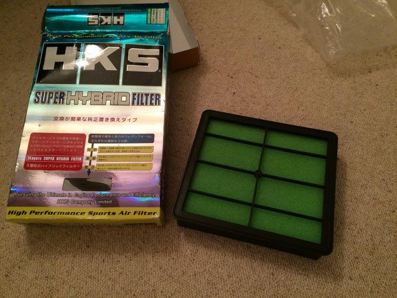

Also bought my first mod! (apart from the decat!) a HKS panel filter!
