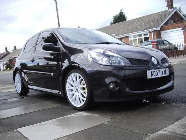

anyone got advice for what to buy ? .. as you can see my wheels are lost in the arches :dead: a bit .. not to sure on these, and was wondering what the best way to do it was...
I've got FK Automotive Hubcentric spacers.
If your getting larger spacers, get system B spacers that bolt to the hub first, then your original bolts bolt the wheels to the spacer.
The other option is system A Hubcentrics, which still have the lip, but require longer bolts as the don't bolt to the hub first.
