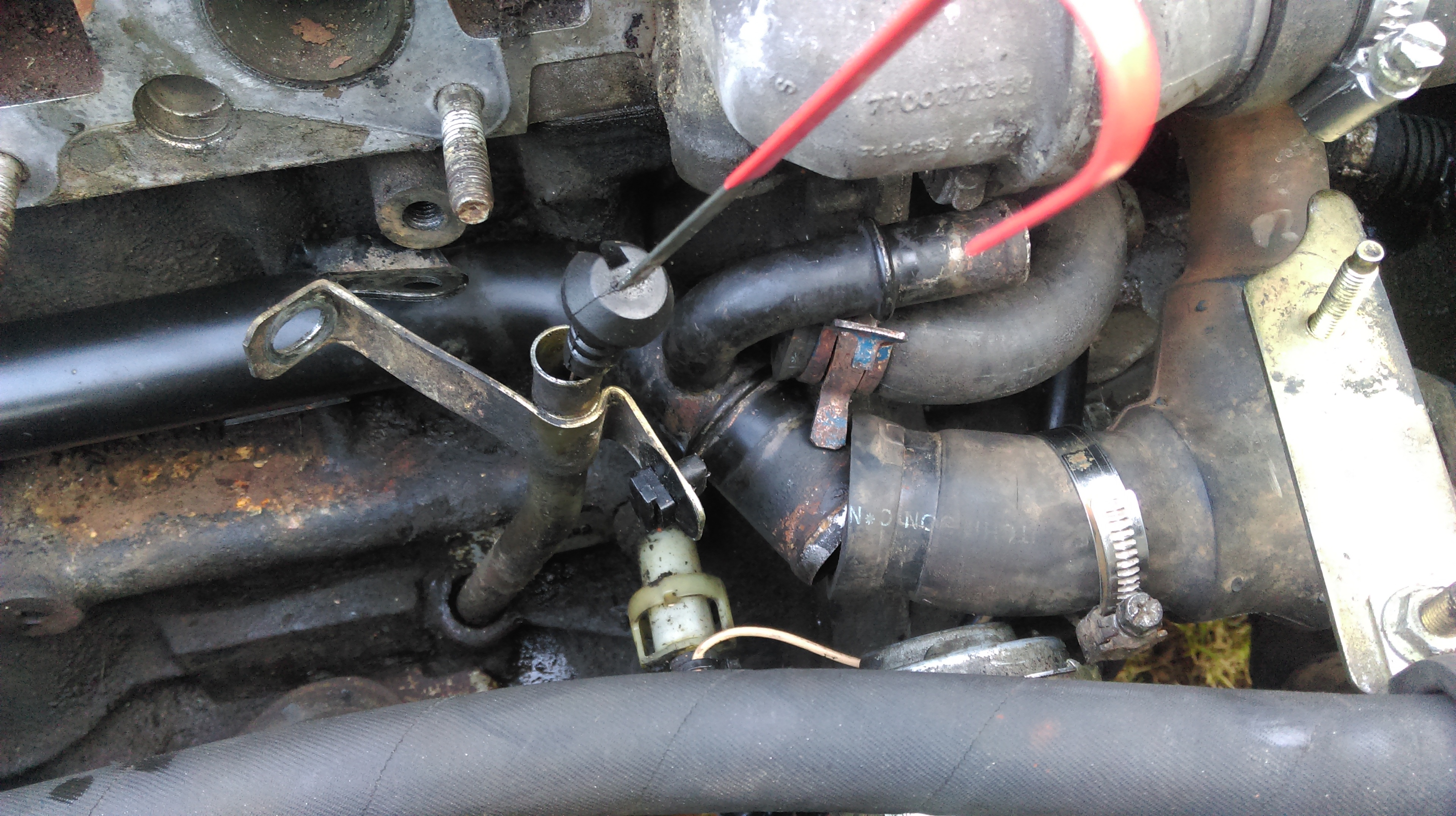

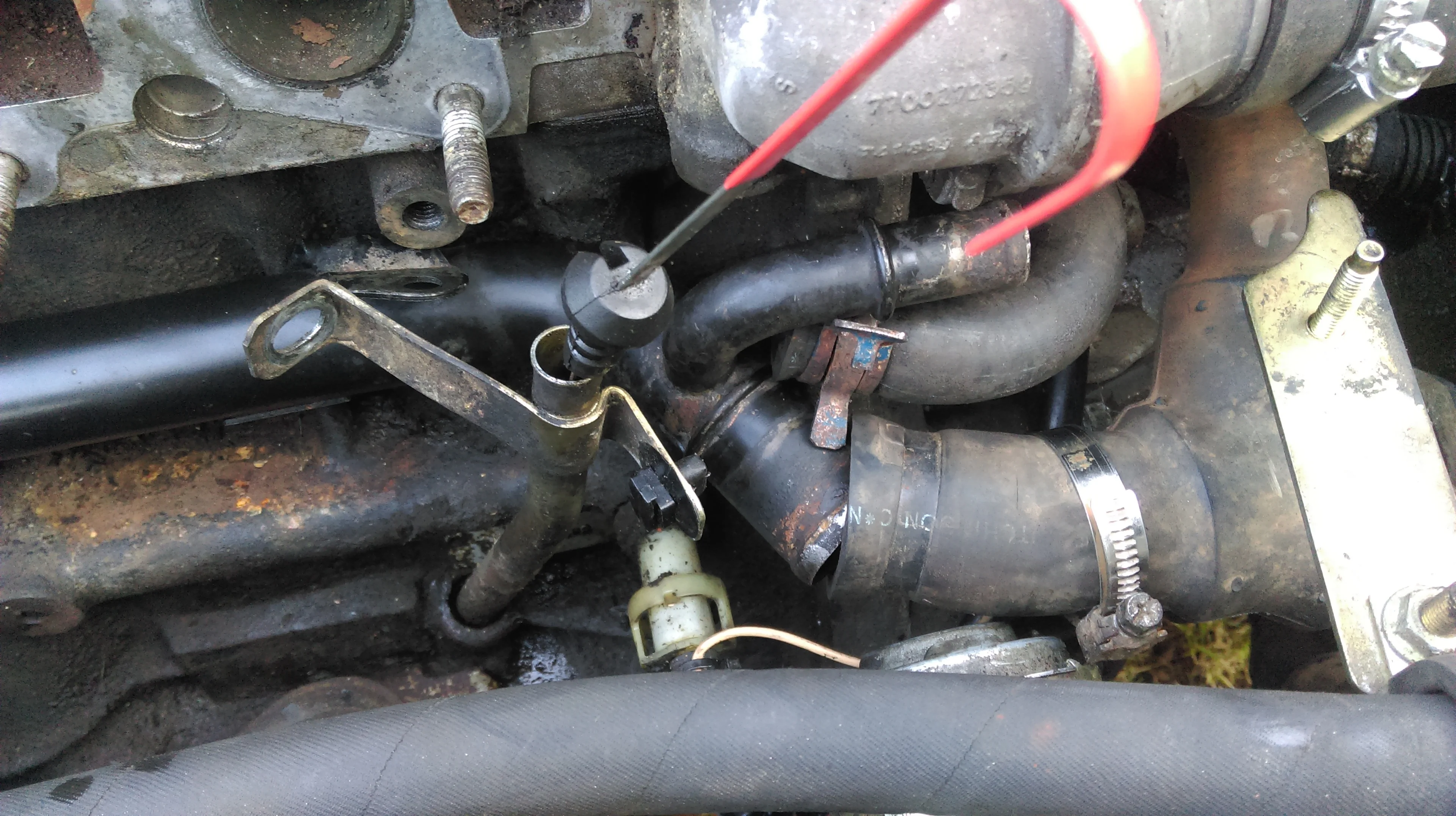

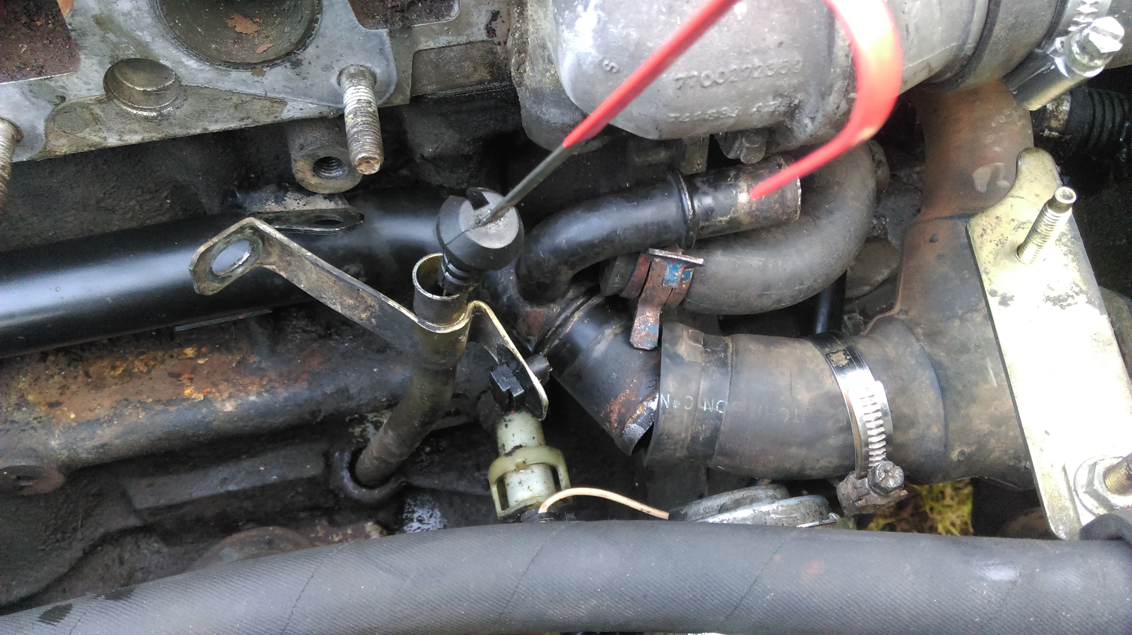

Post : Pics speak a thousand words .
this is a pic of the issue, i can post more if that can help.

That's the wrong pipe for your engine .
I can see that the small sized outlet is up against the head / block and it's not at the correct angle for the existing hoses .
Yeah i was wondering that. But every picture i saw of the 1.4 engine has the same pipe, at least it looks like the same one.
