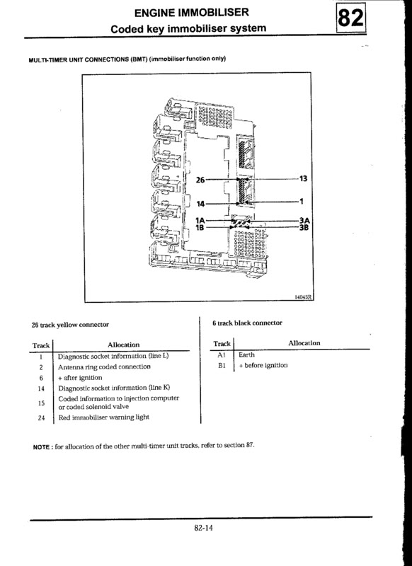

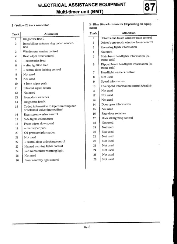

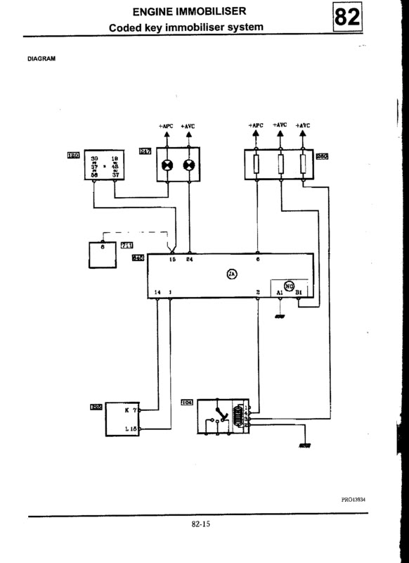

Now, ive got the wiring loom in my hand, and from the decoder ring ive got 3 wires, ones an earth and the other 2 go to 2 different plugs on the UCH, now, does this mean the immobiliser is in the UCH? or it goes through the UCH into the ECU? so i could potentially run the ecu with out the decoder ring etc etc?
The way i had seen it before this is that the immobiliser is set into the ecu, the ecu sends a code when turning on the ignition, and reads the code from the key.
But now seeing this, its either as above or, ignition is switched on, then the UCH checks the code on the key, and depending on the code being matched, sends the OK signal to allow the ecu to fire up and run the engine?

The ECU and UCH are linked together the imobiliser program runs in the ECU but the UCH has checksums for it.
the way you explained it above is exactly right- but you need to run the decoder ring.

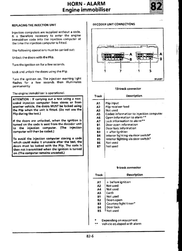

Right, this is the 16v layout, does this help ?

Pin 83 is the coded line to the UCH as i remember. Regarding the PM if this method was used it should be fine with no UCH.

I think you will find its B3 Paul, there are only 22 pins on the de-coder unit and they are split into A & B to correspond with the top and bottom rows of the plugs (very silly way of doing it imho)
RSTuning
  R35 GTR
Nope i deffo mean what i said, the ecu is numbered 1 to 80 odd. But as you say on the system it's A/B
RSTuning
  R35 GTR
I mean the actual ECU. I have the details at work but i'm sure it was 83. I'll PM you a pic to show you what i mean

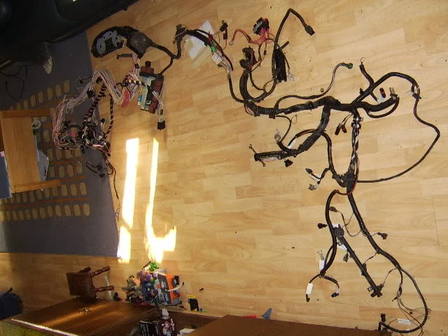

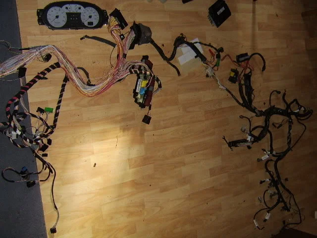

Heres my living room currently lol:

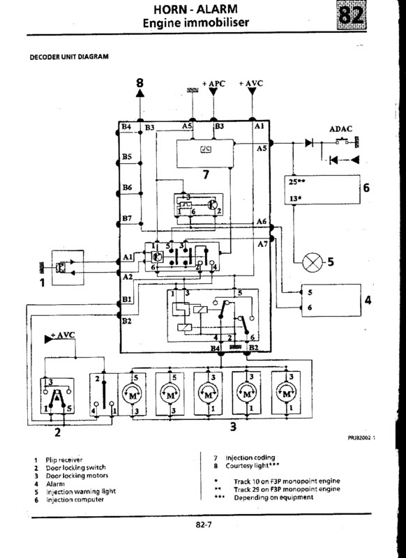

Ive decided to keep the 172 dash, and just cut out all the wiper/light wiring etc that isint needed so all im running on the 172 loom is the engine, dash and immob.
right, just been cutting most of the loom out and i think ive finally nailed this immobiliser decoder, Ive traced 3 wires, 1 negative, 1 redwire then goes to a 5amp fuse in the fuse box then one goes into the UCH, now, if i cut it at each end of the uch, would it work still or does it need the UCH to decode it?
