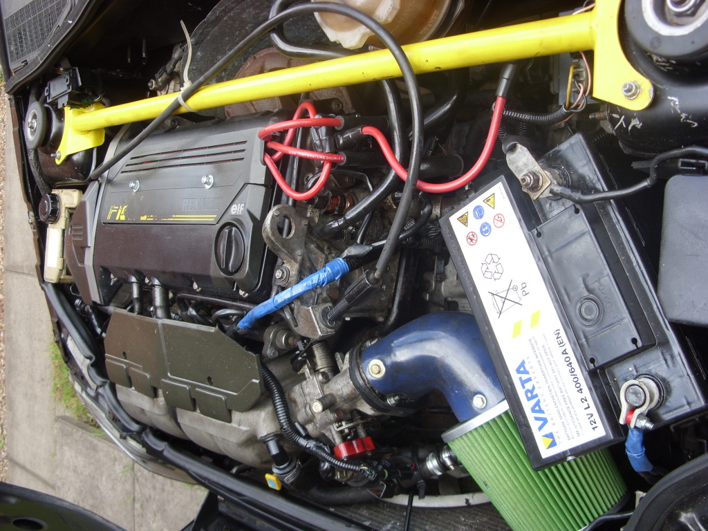

  182
if iirc this is what your engine looks like?? if so where the throttle cable is spring clipped to the rocker cover to the left of the filler cap pull the little spring out and pull the plastic bit towards the radiator 1 notch at a time (put the clip back in every notch you do) keep starting or leave running if it will the car until it runs on its own and idles right. then there is a little stub screw got yellow paint on the head of it sometimes in the mechanism under where the cable is attached to that plastic thing in which the throttle mehcanism retracts to (normaly). adjust it inwards until it touches the mechanism,turn the car off then adjust the throttle cable back so when you press the throttle pedal to the floor the little flap that moves is dead vertical so you can see right in (like below) put the spring clip back in and start the car should be idleing perfect. thats what i did on my old 1.2 i had years back and worked a treat
its easier to do than explain :eek::eek:
