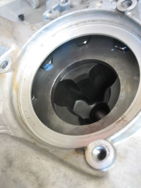

you can tap the casing to take the diff retainer plate, no need to swap diffs etc.

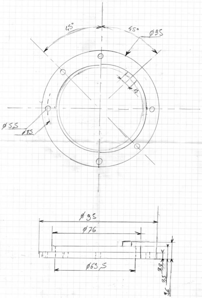

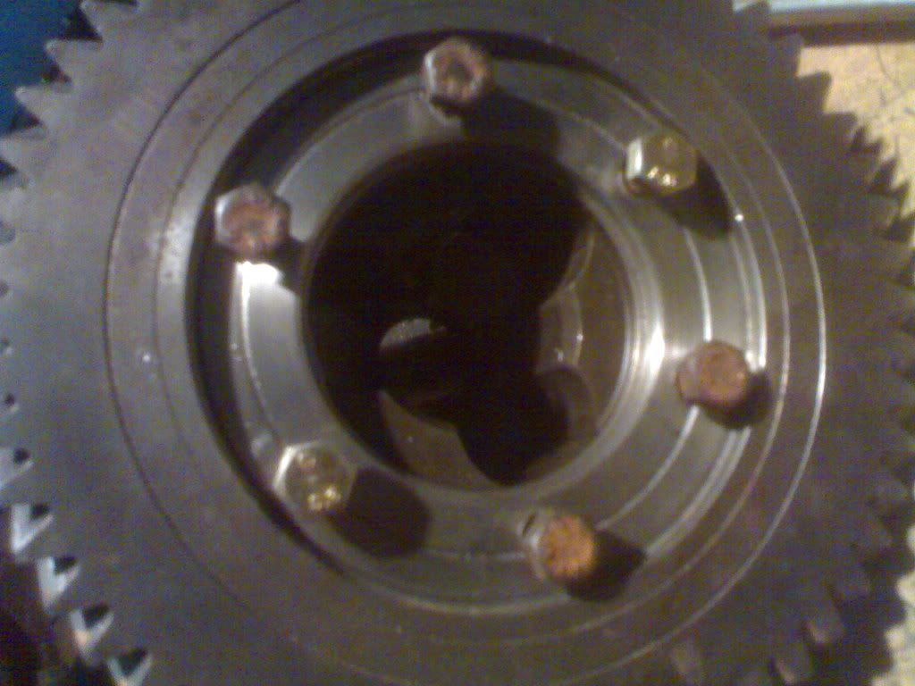

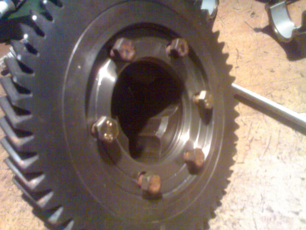

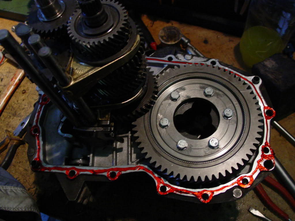

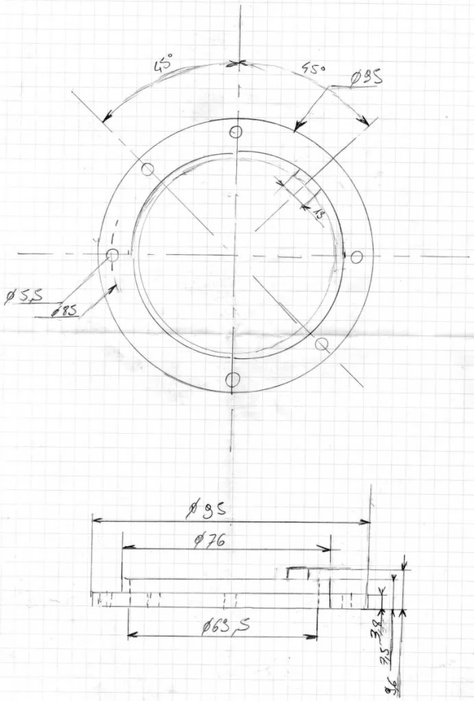

Yeah, ive seen that before, the first few pics look like my JB3 at the moment.......but also seen people on other forums machining their own retainer plate after seeing this on C16v (last pic)
treiSHU said:
either this one
or you make one of these and you drill 4 holes into the diff and make a thread for the bolts. iirc there was one for sale on ebay a few months back.
