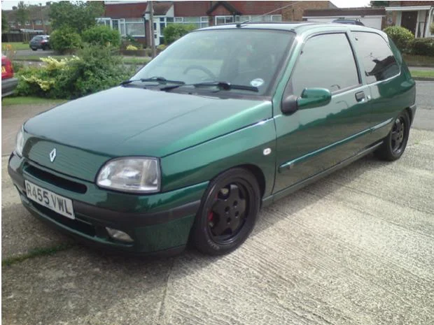

The basics!
-Gaz GHA Coilovers, about 65mm drop at the front, about 40mm on the torsion bar :)
-Powerflow Stainless Cat-back exhaust
-Clio RSI wheels, Yoko A539s
-Window tints
-K&N Panel filter, 2 Cold air feeds custom made...
-16v Spoiler, Green
-Colour coded door strips
-Fog lights with LED's
-8000k 55w HID's
-Black rear lights, and 3rd brake light tinted black
-Clear indicators
-Re-sealed leaky sunroof
Probably more but thats most of it :)

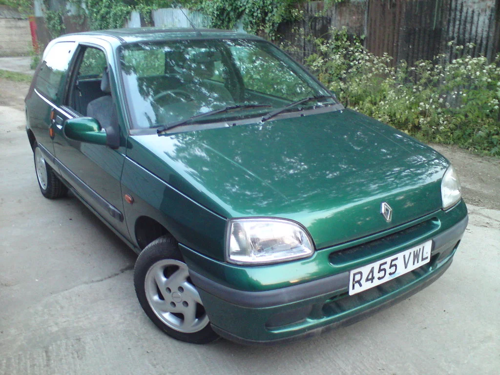

So, just over a year ago I passed my driving test and had bought this beauty of a mk1 from a friend of a friend :)
Here she is completely standard May 2011!
Had no tax and MOT so a new exhaust, 2 wipers and a tax disc later, I was on the road!
Got a Kenwood headunit in, £32 on a JBL sub from eBay, £20 wireing kit, and £20 on a brand new amp off a mate at work and my tunes were sorted, for now...
Put the fog lights in, Led bulbs, lights inside and some random other cr*p. Now for the real Modifications...

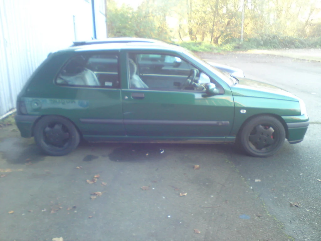

Found a set of Clio 1.8 RSI wheels on eBay for £50, picked them up form luton so not too far for me. had them powder coated in satin Black for £50!
Waited a month so i had enough money for tyres and put on 4 Yokohama A539's 185/50/14

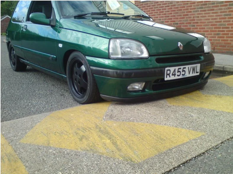

Here she is, Standard height, New wheels!
Looks stupidly heigh but don't worry it was not like that for long!
Bought 35mm springs, fitted them and had the torsion bar done the next week:
Sorry about the crappy Quality!

It's all nice and clean inside and out ;) (Click photos for actual size/better quality)
Comments and thoughts please :)

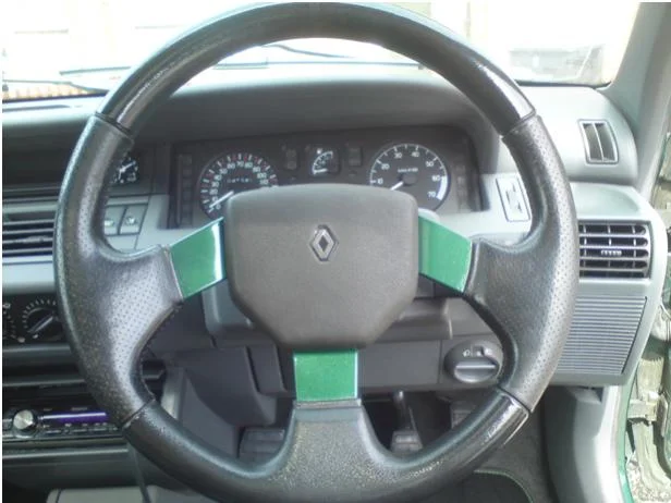

Btw, Yes that's a Williams steering wheel, and I've painted it Green... not to everyone's taste but I like it :)

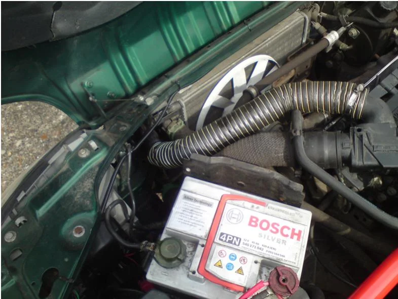

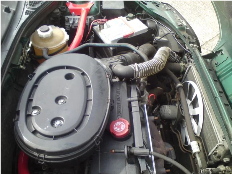

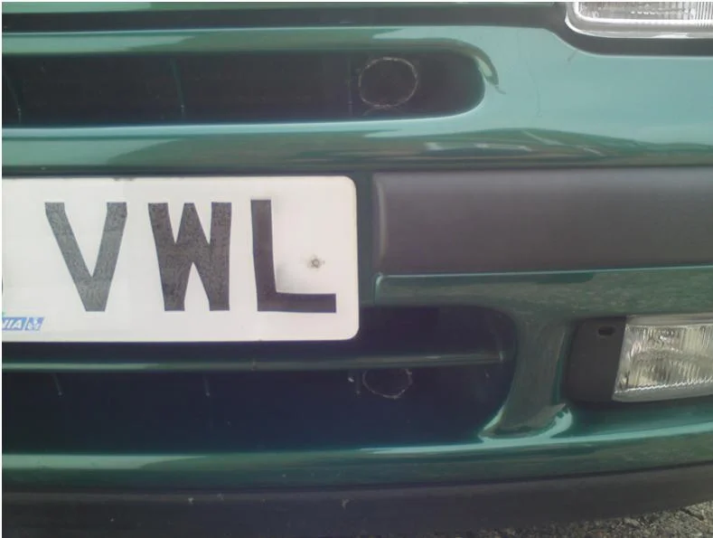

I did have a K&N induction kit, but this made it slower because it was sucking in hot dirty air from around the engine. So i've put the standard box on with a K&N panel filter and two custom cold air feeds.
On the airbox there are two inlets, One for cold air from behind the headlight, one goes to the manifold cover for warm air. (manifold cover has been removed!) Inside the inlets there is a valve that controls the flow of warm air from the manifold cover. I've smashed the sh*t out of it so now its straight through both inlets to the air filter. Some cold air ducting from eBay, electrical tape and cable ties I've got this amazing little set up which I honestly think gives me a good few more bhp! The 45mm pipes go into the top grille and lower one, Plenty of COLD CLEAN air for my engine! Let me know what you think ;)
Yeah, There an OMP Strut brace in there too, makes quite a difference I think, stiffened the front up nicely, but now I have coilovers, It Stupidly Stiff.
So, with a Powerflow stainless cat-back and a half decent air intake my engine is running as well as it can without mega £££ I was thinking around 80BHP?

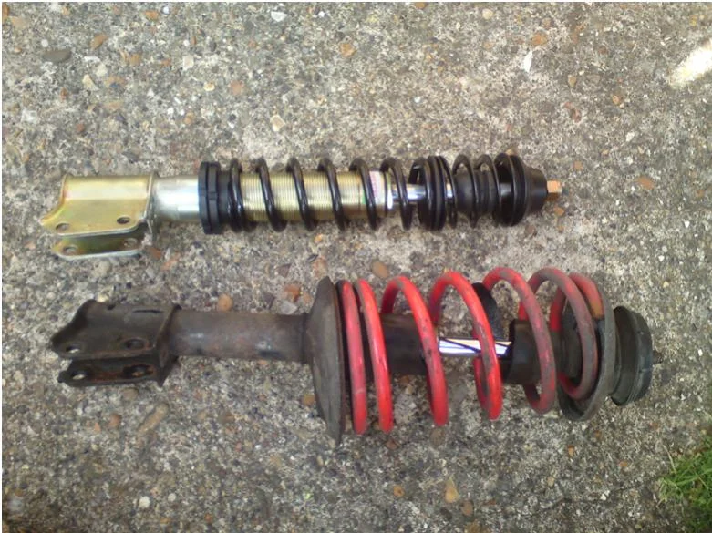

I decided that because all the front suspension was fcuked this warrented me buy the coilovers after all! :)
Went on Larkspeed.com for the cheapest ones, but there was a 3week delivery time :( Sh*t.
So now It was time to try and get it through the MOT, removed the shocks, cleaned them up and made it look like I'd replace them with second hand units, a free re-test later and my car had an MOT!!!!! Oh yeahhhh, and ruined suspension.
3weeks later my £450 YOLO moment arrived at work... WOW. I think I may have had an accident.
Sorry, this is the only pic I can find!

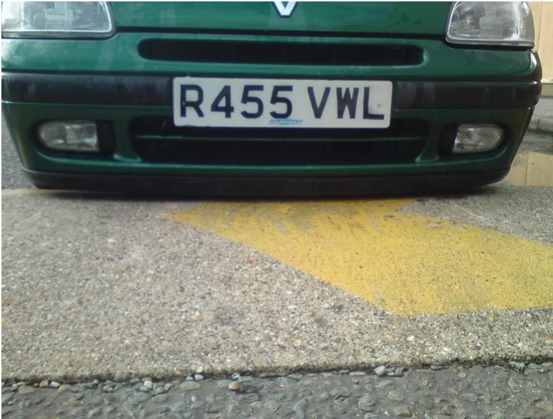

Anyway, fitted them and went to get it tracked. (after my driveshaft fell out as I took the old shock out and I spend 45minutes putting it back in...) This is where it all went wrong. AGAIN.
The car looked nice, low, but handled like a bag of s**t. this was expected as i knew the tracking would be miles out.
But according to the lasers at the tracking place the car had 16mm of toe out, 2'degrees of camber, the wrong way. The top of the wheel was further out than the bottom. DAMM!
Got home and put the springs and shocks back on in an hour or so.
Phoned up Larkspeed who got GAZ to phone me direct to find out what was wrong. The only way I could think of getting around this was to machine the top hole on the coilover a little bit towards the engine so the Hub would sit further in at the top. When I was talking to the Gaz man this is EXACTLY what he told me to do!!!!!! :D :D
Took the coilovers to work the next day and machined about 1.2mm from each side on each coilover.
Put the coilovers on the weekend after and back to the tracking place.
BINGO. toe was 8mm out, that has been put back to standard. camber was SPOT ON. WIN.

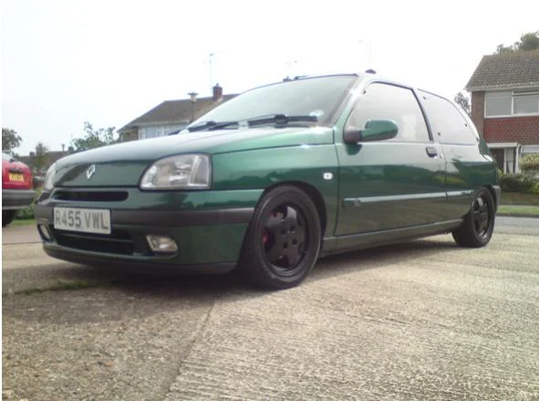

Got two new Yokos by this time so new tyres on the front half-worns on the back :)
Time for a test drive...
Wow. It's a go-kart. Litterally won't let go of the road. Love it.

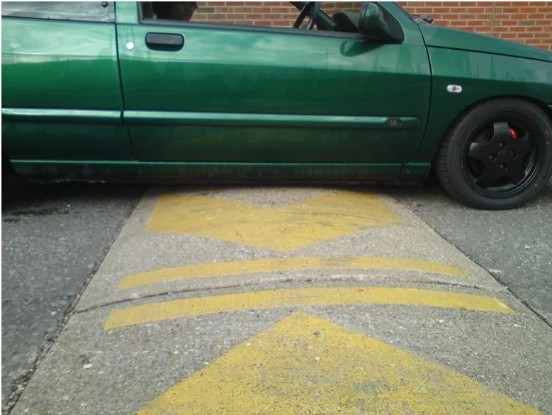

Now the problem is the speedbumps where I work! I have two of these to get over everyday! Opps...
I can only just get over them! My cat scrapes a little bit, nothing major! Phewwww!!

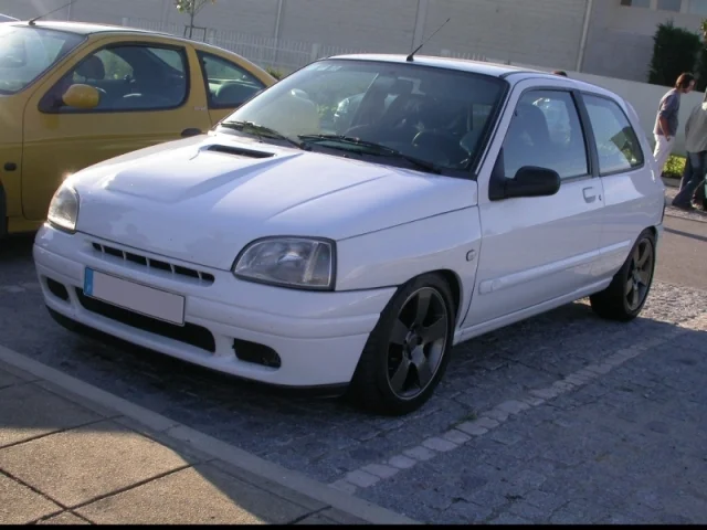

I think that White PH3 with the Williams bonnet looks really good from the front, really want to do that now!! How much would something like that cost?!
