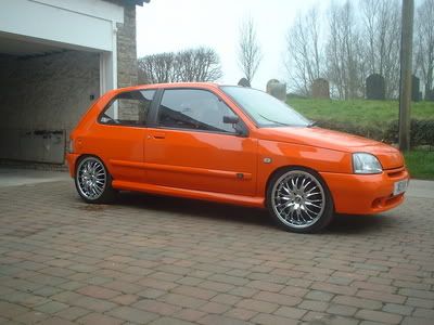

can you post some mk1 lowerd fronts as i need to decide how much to lower by. Also any preference to setup.. i.e i read somewhere on that you should lower the back or the front more than the other cant remember which way was suggested.

the back should be around 15mm higher than the front!as thats what clios with a torsion bar came out the factory looking like!
Ryan (cant host pictures as uploader wont work)
the front is lower than the back for handling purposes. but theres nothing to say you have to keep it that way, aesthetically, i would imagine an even appearence would look better.
im talking about the 16vs and williams, i dont know if its the same for the others.

yeah aesthetically it looks loads better with the rear slightly lower like DazRsi ^^.thats one nice car!!
Ryan
Mines 40mm on the front (Avo Springs and Shocks)
Rear is around the 50mm mark - i really like the stance it has.

Its -35mm spax front shocks and springs, and rear torsion bar is lowered a measured -35mm not 4 clicks or any daft method!
hhmmmmmm think im gonna go with a 35 mm drop all round. as ive measure that the front the the side skirt will be mighty close to the floor even at that drop.
Hey mate, there is pics of mine in my profile if you click ^^member profile^^. mine has been lowered 55mm front and about 70mm back, but to be honest, i still dont think its low enough! i think it definately looks better lowered slightly further at the back..
and remember, just because the springs say -35, the car wont actually go 35mm lower, it only means the spring is 35mm shorter than the standard ones, which compress more than the uprated ones. think that makes sense?!? lol
