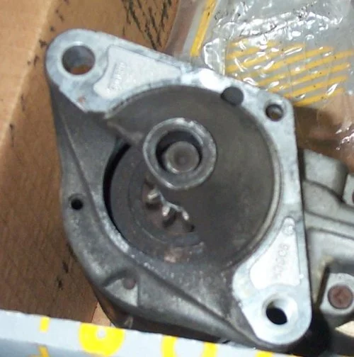

This is what happened to my starter on my 1.2..
Very odd.. it made a clunk every now and again but started.. sometimes, it just didn't.. but like I said, extra boost of power was enough to turn it.
^^ i know its a starter motor, but whats it supposed to be showing? or is it just so he knows what it looks like?
oh right...so theres ment to be a cap on the end of the sproket then...i take it thats what hold the spring in place to!
did you manage to drive it like that?! i would have thought it would do major damage to your fly wheel! lol.
