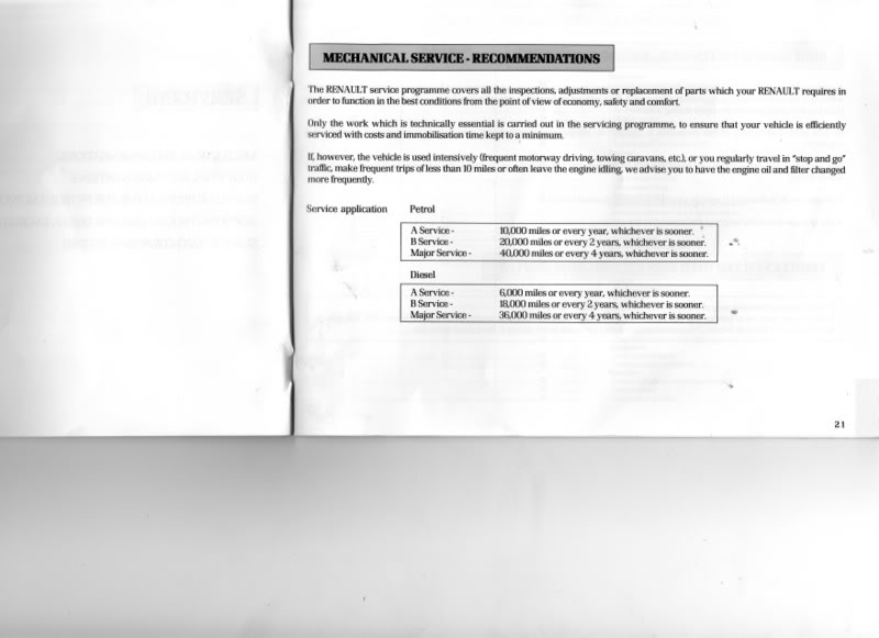

Just had a look in a mk1 service leaflet....
Petrol
A Service - 10,000 miles or every year,whichever is sooner.
B Service - 20,000 miles or every two years, whichever is sooner.
Major Service - 40,000 miles or every four years, whicever is sooner
Diesel
A Service - 6,000 miles or every year, whichever is sooner.
B Service - 18,000 miles or every year, whichever is sooner
Major Service - 36,000 miles or every year, whichever is sooner.

No mate, from this renault service book I have petrol and diesel are deffo the correct way around! I always thought diesels had longer service intervals too...
You sure. I just had a look at one and its the other way round lol.
I've always said petrol engines at 36k and diesel at 40k
I've just done a write up as your lazy :D
That is weird i've got a couple here and they are other way round. I'll scan them if you want lol.
