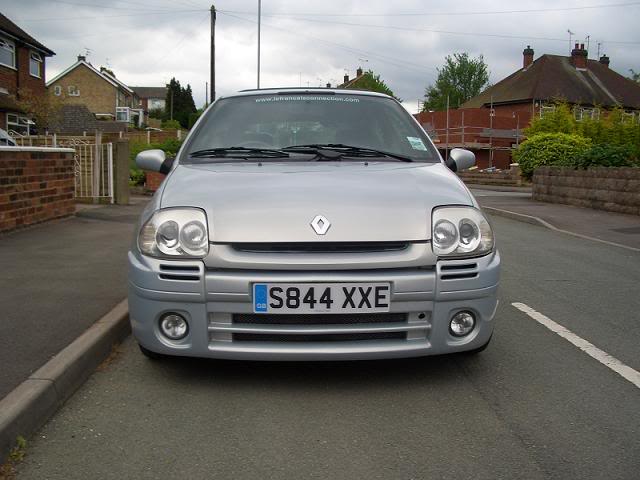

Mk2 Ph2 front bumper on a Ph1
Its been done on a mk1 clio , i assume you would need to have some plastiwelding done at the top to remove the diamond other than that its probably quite easy - pointless as the ph1 looks more aggressive IMHO
you think so yin? im not sure it does. Vinny I don't think it would look anything special, your cars well mint already with the 172 look.
Thinking of doint the whole front end so its like the ph2 lights the triangular ones, and new bumper and wings etc
Want to change it from a ph1:
to a ph2:
I was wondering if this was possible or if anyone had done this before?
Yeah it is possible and as Big Yin says you need all that stuff and possibly a new slam panel.
HAve you put a 172 bumper on with standard wings?
Yeah my bumper now is of prima's 172 front bumper replica but its damaged as someone reversed into me, i have now got a set of 172 front bumpers and wings, i need the sideskirts now. but i was thinking as i need all that lot sprayed, how hard is it to have all the ph2 stuff
If your handy with a spanner id imagine you could do it all bar the welding on the front panel and slam panel not hard work IMHO but is it worth it ???
