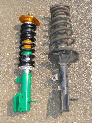

haha i wouldnt say im the man, ive just spent a s**t loads on different setups.
i think these are of a saxo but same idea(pic at bottom), on the left is the new coilover if you look you will see it has a threaded bit that the spring sits on, this gives you your height adjustment, so you can go from a little lower than standard to massively slammed (if thats your thing!)
on the right is the standard shock absorber, you would just be changing the spring on this and leaving the standard damper fitted, ive found in the 4 or 5 cars ive done that even on a slightly less hardcore (in the lows department!) spring like eibach sportlines, the dampers only last a month or 2 (this is on cars with say 40-60k already on the standard susension setup) the car feels sloppy and bouncy, infact to be honest, even with brand new dampers, they are just too soft for a hard spring and feel miss matched imo (where on the RS cars the standard dampers feel perfectly suited to eibachs)
a few years back a load of us were all running Apex -60mm kits (both springs and dampers) and im going to be honest and say i actually liked it, it sat nice and low and the dampers were matched to the springs and there was a good improvement in handling. (this kit used to be around £220 but i think its now near the £300 mark) At the time though our cheapest coilover option was FK @ £600 odd!
you now have Vmaxx at i beleive £400 ish? and raceland at under £200? (ive never really looked into or tried them, just saw it on here a few times)
personally if it was me again id look into a set of Vmaxx and see if they are ment to be any good, or if -60mm will suit you then check out the Apex kit.
sportline springs are good but imo you need to factor in a set of dampers, even if its at a later date, and a set of bilsteins or konis are probably about £400 all round anyway!
Cheers so if i get coilovers I dont have to get upgraded dampers?
But if I get eibach sportlines I would have to upgrade the dampers?
And the apex kit comes with the springs and dampers?
So coilovers are the best and you can adjust ride height your self?
