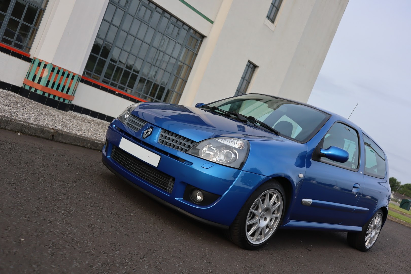

Been 9 years since I had my 182FF and now back with a 172 Cup. Came with the classic Cliosport mods of Silvervisions and short front number plate.
Surprised to see it has aircon in it so don't know if this has been fitted afterwards or one of the few that had it specced from factory.
Was going to put the half leather interior in it but the original seats are in such good condition I don't think I'll bother. Plus maybe my imagination but think the Cup seats have a higher bolster...or I just put on weight since I last sat in one.
Jobs done so far is replacing the washer jet and few missing and broken clips. Can't seem to find the white clips for the scuttle panel so think they may be discontinued.
On the to do list is new struts for the boot, tidy up some bits and then treat it to some ceramic coating.

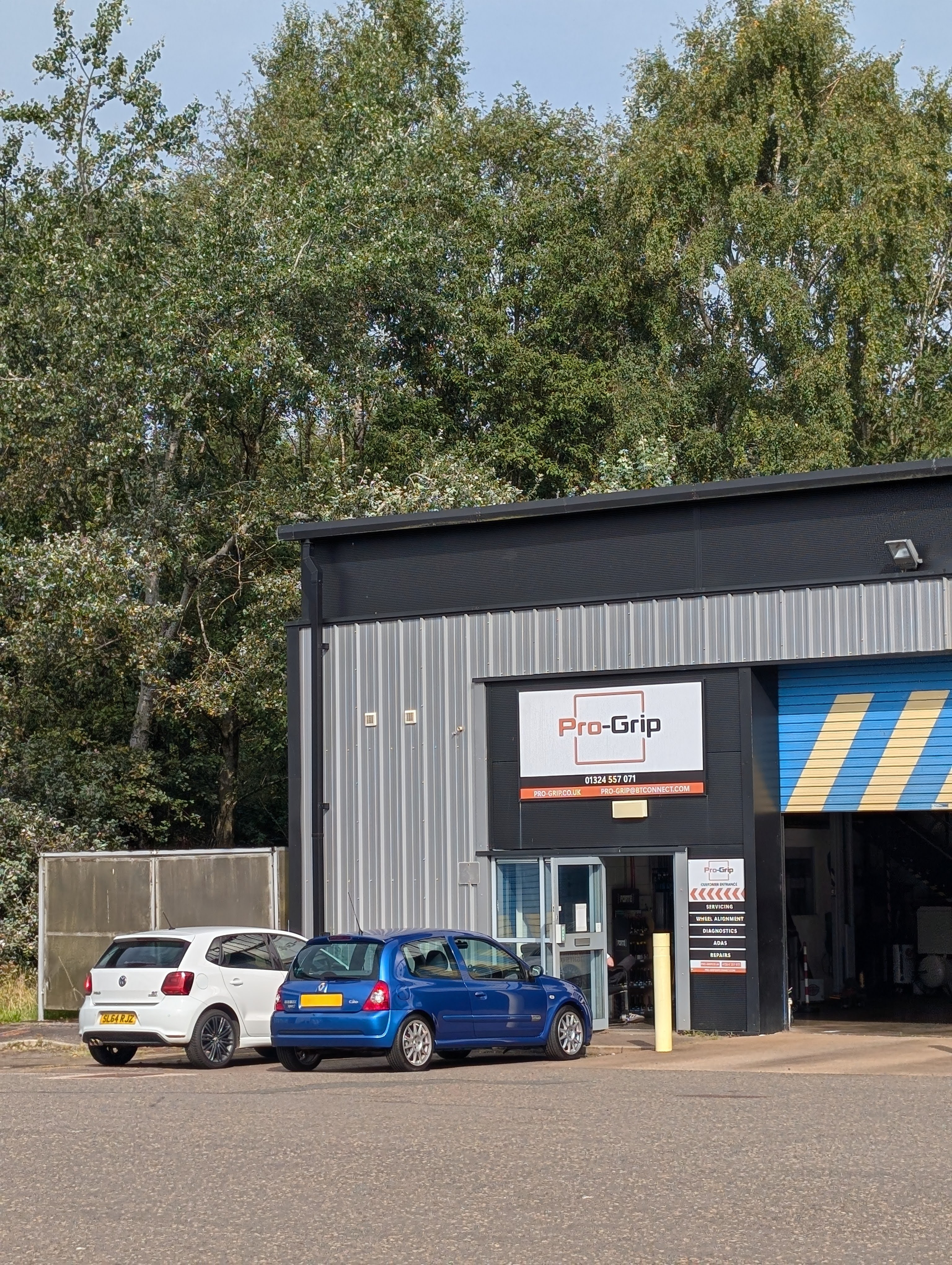

PS3's were 8 years old so treated to a new set of tyres and down to Progrip for alignment. Handles so much better now.

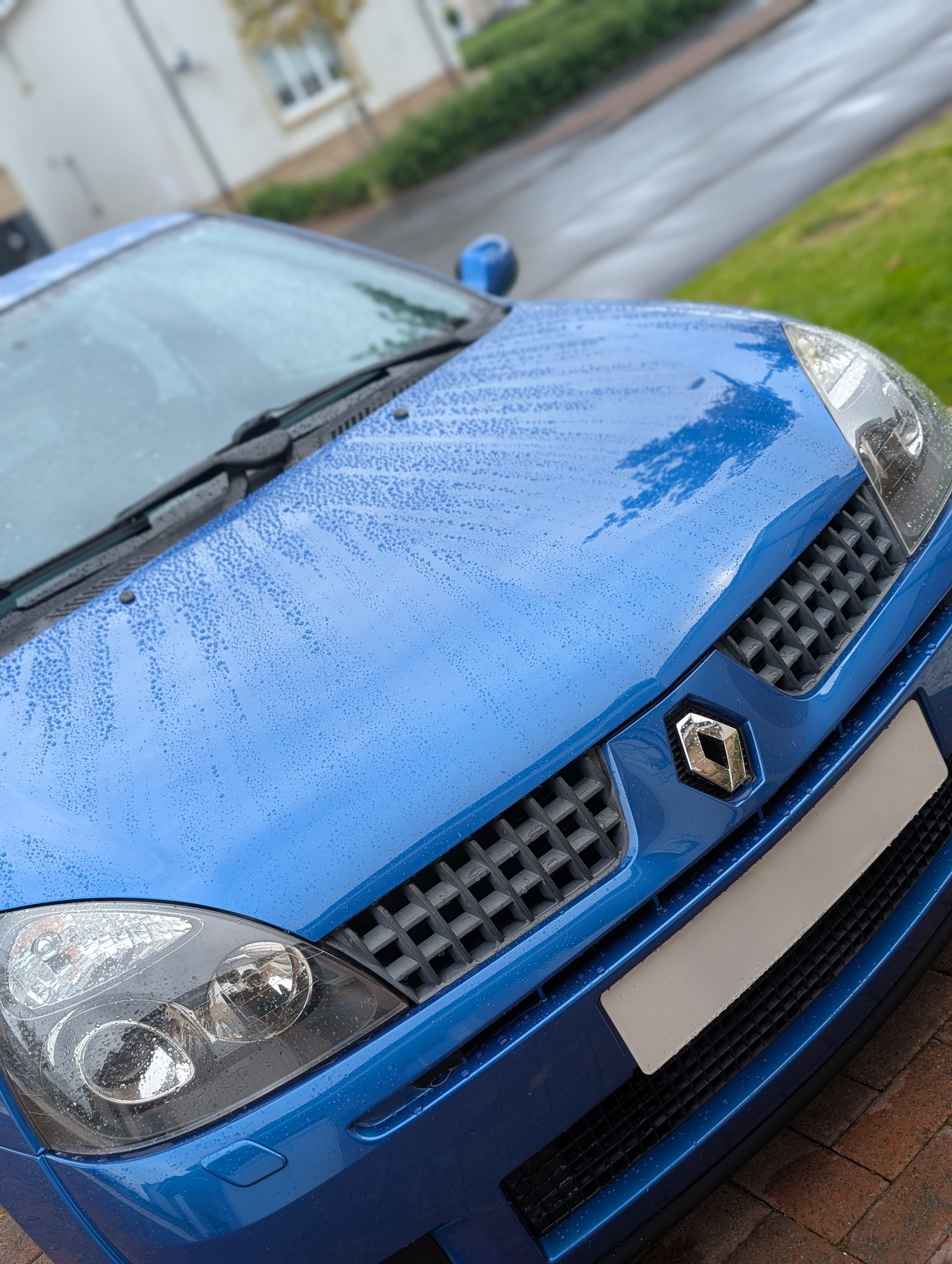

Finally treated to some CQ UK, scrubs up well for its age. Feel the grill let's it down but undecided if I should spray it black or not.

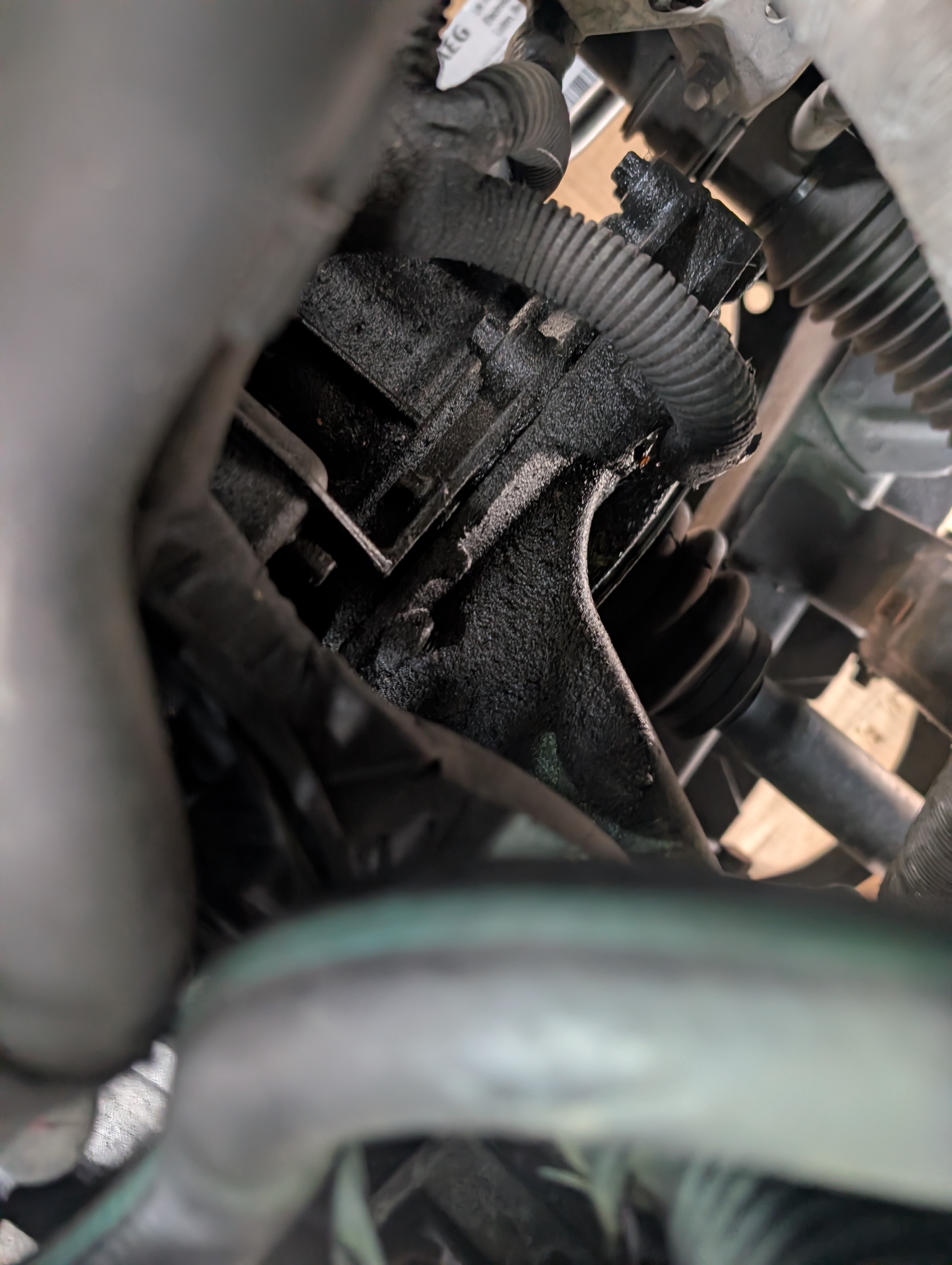

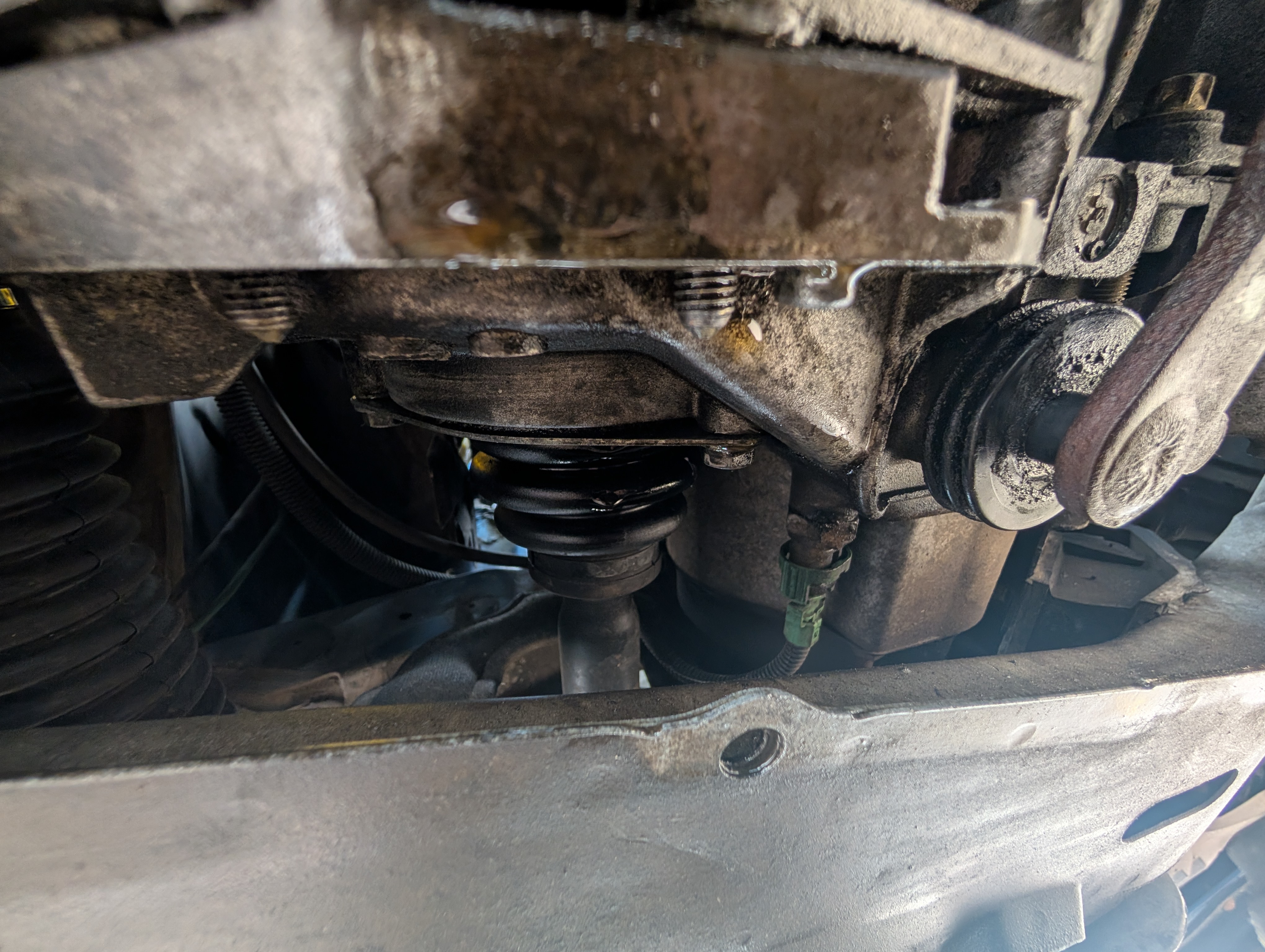

Noticed a small puddle on drive and found the culprit. Looks like it's coming from passenger side driveshaft, doesn't smell like cat piss though so think it's engine oil. Easy fix?

If it’s passenger side and engine oil could it be dripping from rocker cover, the cam shaft caps or the rear main seal?
Brigsy
  T.Turbo
Prob gearbox oil given the area. The newer nfx doesnt smell of anything compared to the old nfj.

Possibly a drip from above?
Belts due in 6 months so prob just get it done early and get them to check the leak whilst in.
