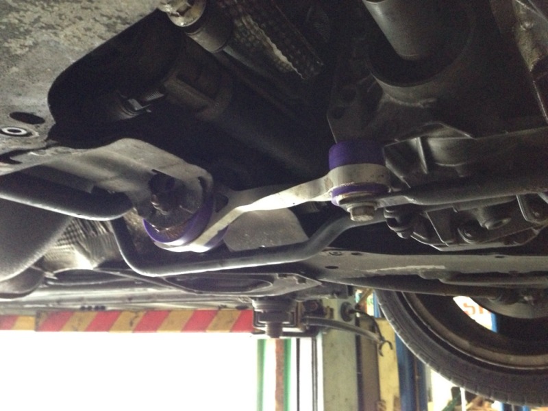

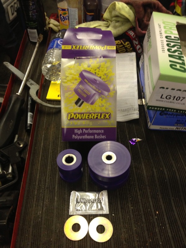

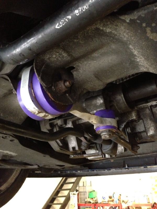

Poly dog bone bush fitted

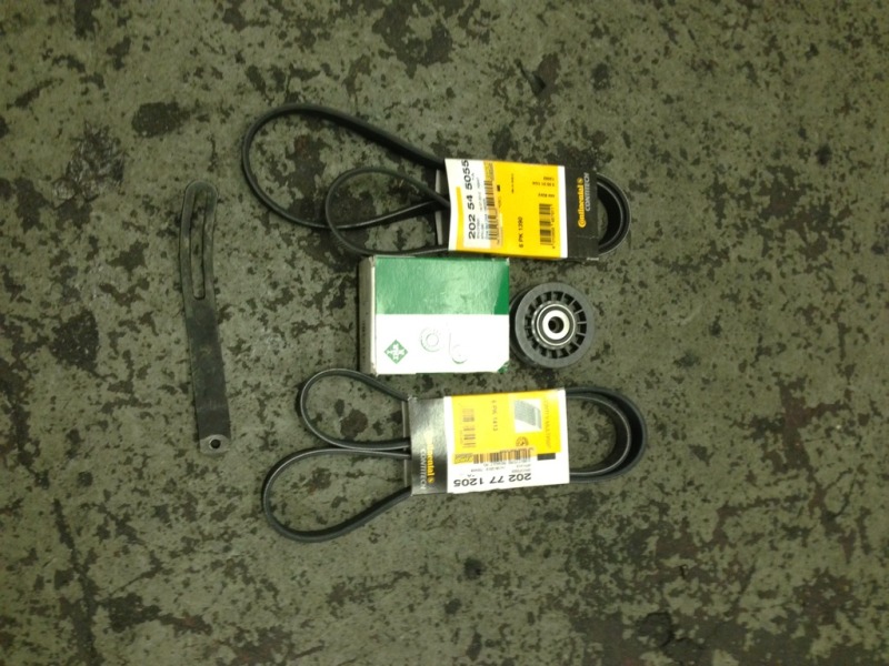

Air con removed and replaced with manual set up, grabbing a slightly smaller belt today as using. 6pk 1413 so will grab a 1400 to give ,e a bit more adjustment. Mercedes 6pk idler pulley.
Hopefully be replacing the aircon pump space with some forced induction :)
