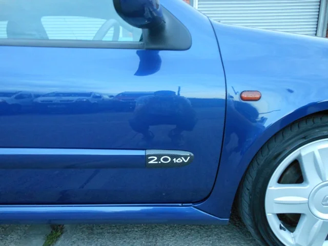

I have now got my car back from Spray Station and Midlands Car Care :clap: The car went in for a whole side respray and a detail after it was wrecked by Motofix :banghead:
Spray Station prep before paint :approve:
Fresh new paint :cool: the paint on this is Fantastic Mick did such a good job i will be going back to him with my front bumper and bonnet after looking at his evo it is the best paint shop i have seen!! I was told about him through Russ at Midlands Car Care.
nice dryed paint before its detail as you can see it looks nice before its even had its detail.
Spray Station (Mick) also sprayed some of my plastics black as they were so faded restore products just wouldn't touch it.
Im told the black on the plastic should also last up 2 years! but the paint work should last for years!! after looking at his evo that was painted 9 years a go it still looks brilliant

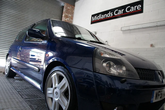

Russ used Zaino Europe Z2 & Swissvax UK Shield
Thanks for looking comments and feedback welcome!! :clap:

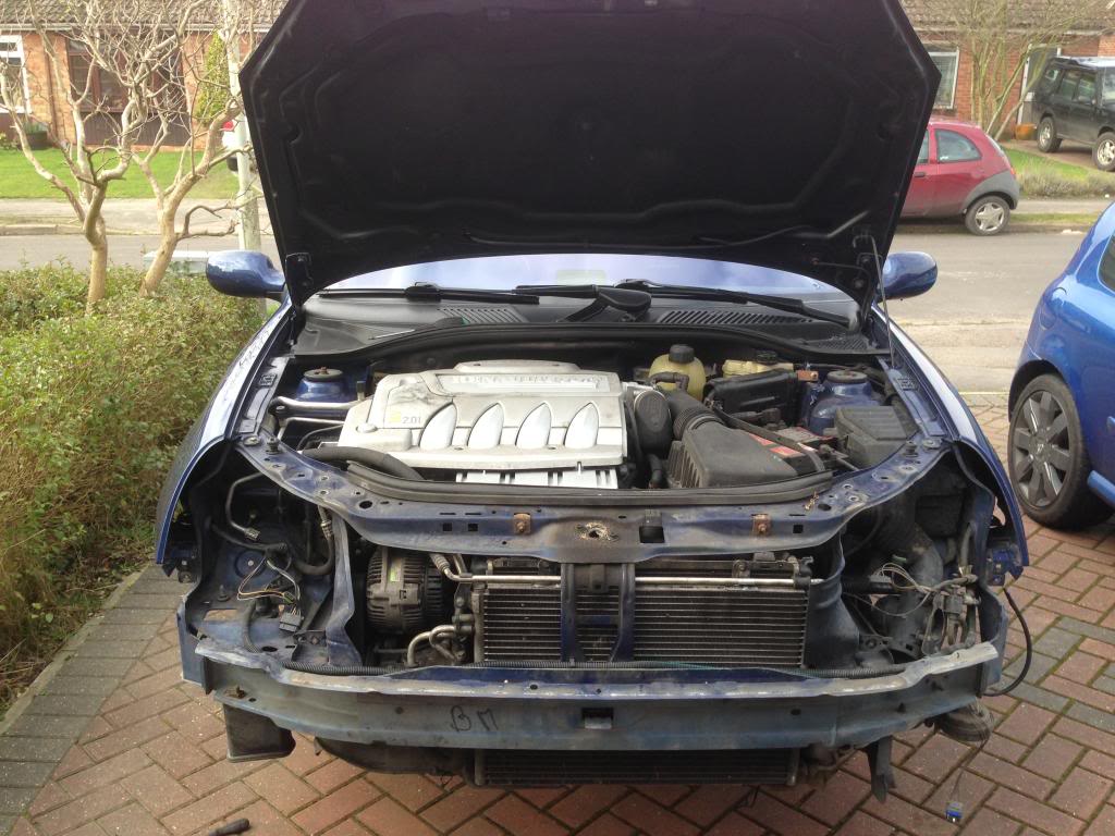

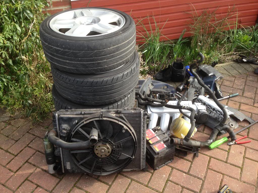

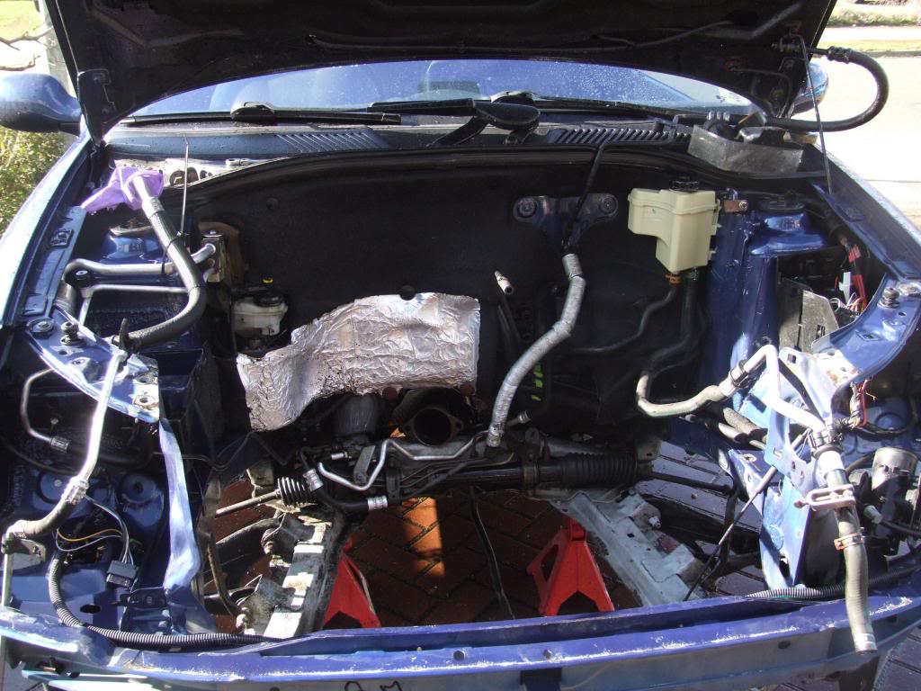

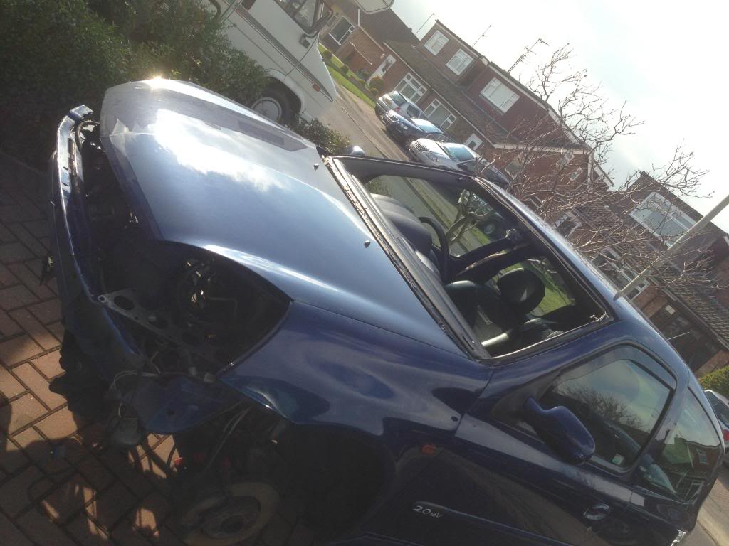

The other half made a start this saturday on the mamouth task of doing all the last repair work to the car with a little bit of help from me supplying bacon butties and the odd drink ;) heres a few piccys to help

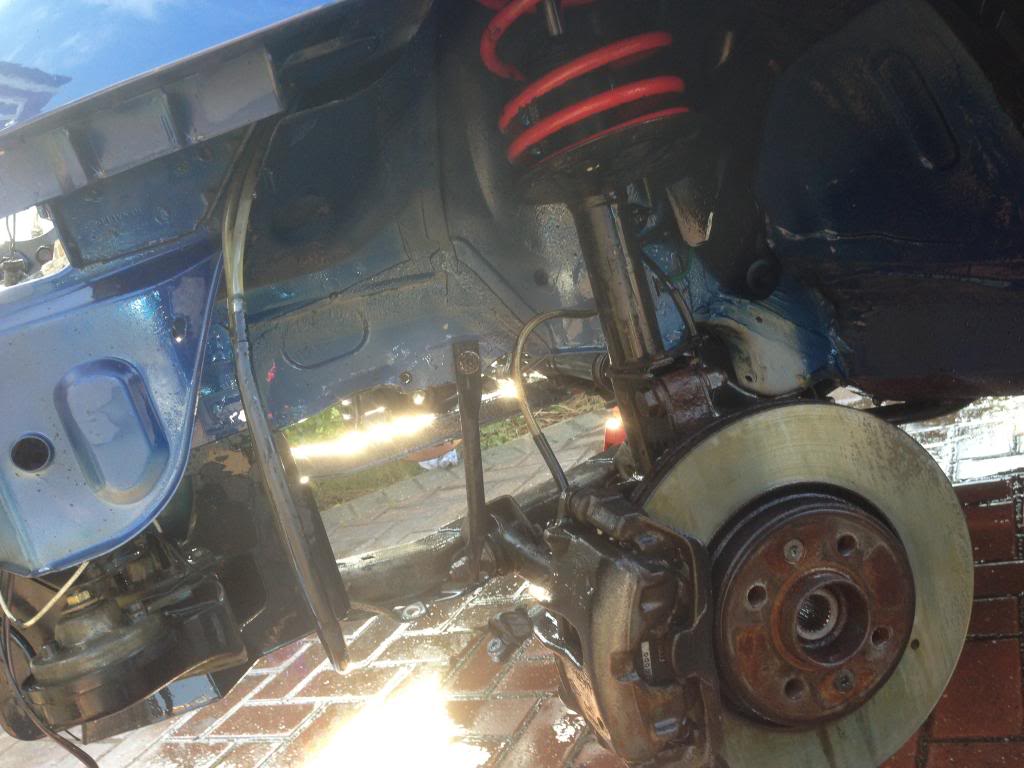

up on all 4 axles stands ready wheels loose and hub nuts

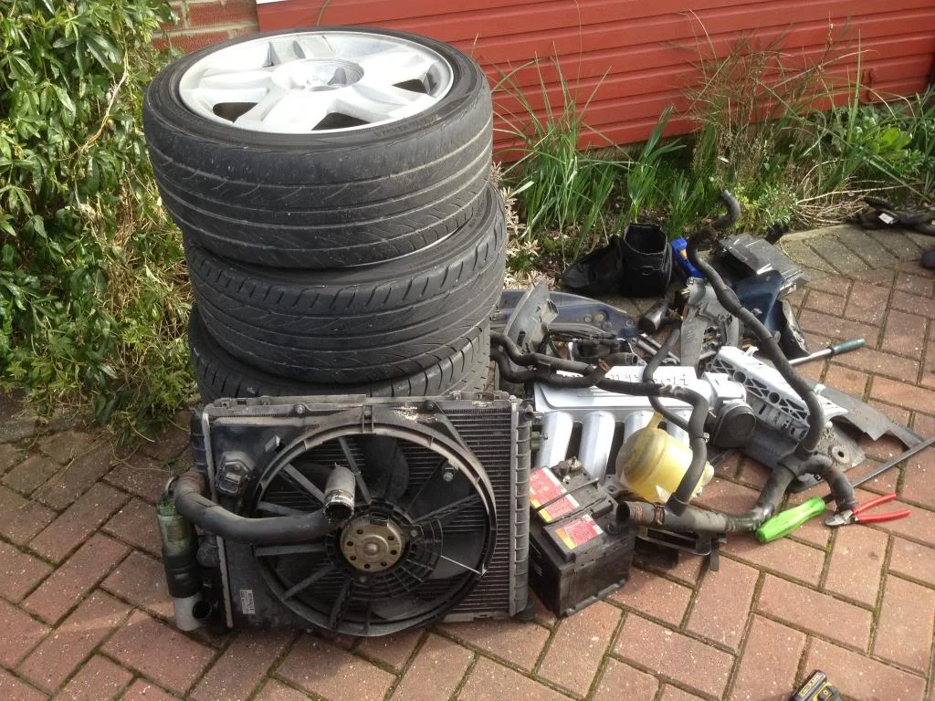

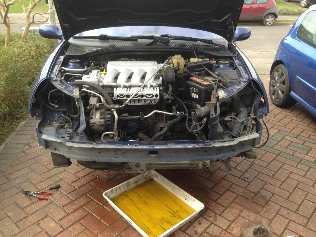

front end off slowly getting there
piles getting bigger not far off from removing the engine

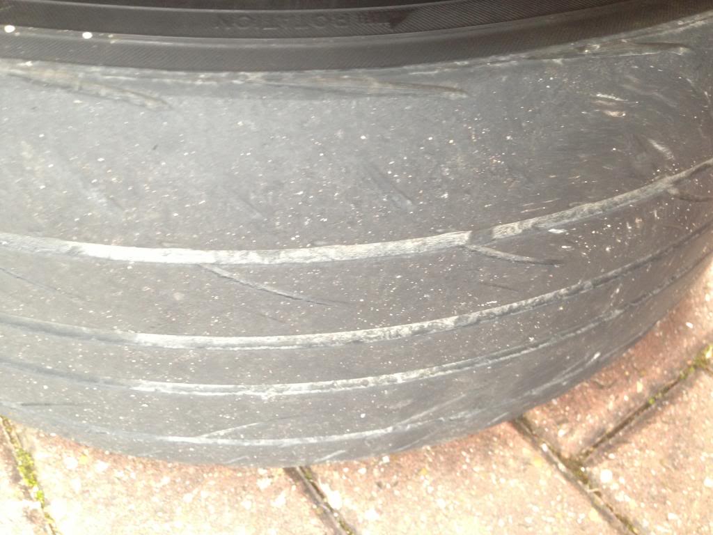

found out im due some tyres also

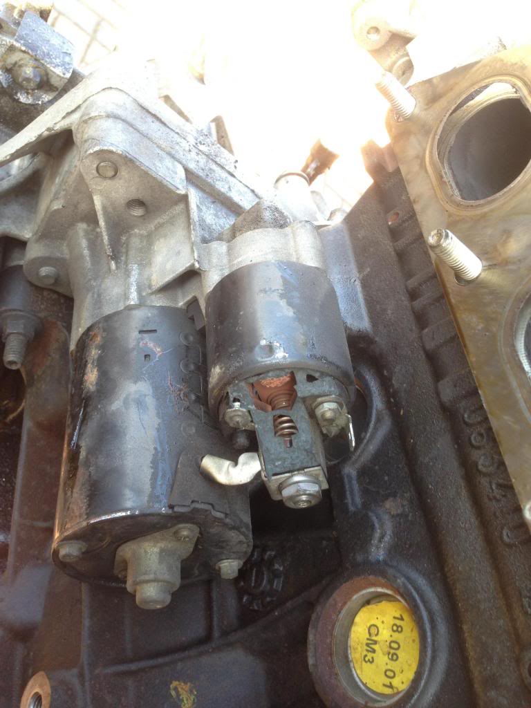

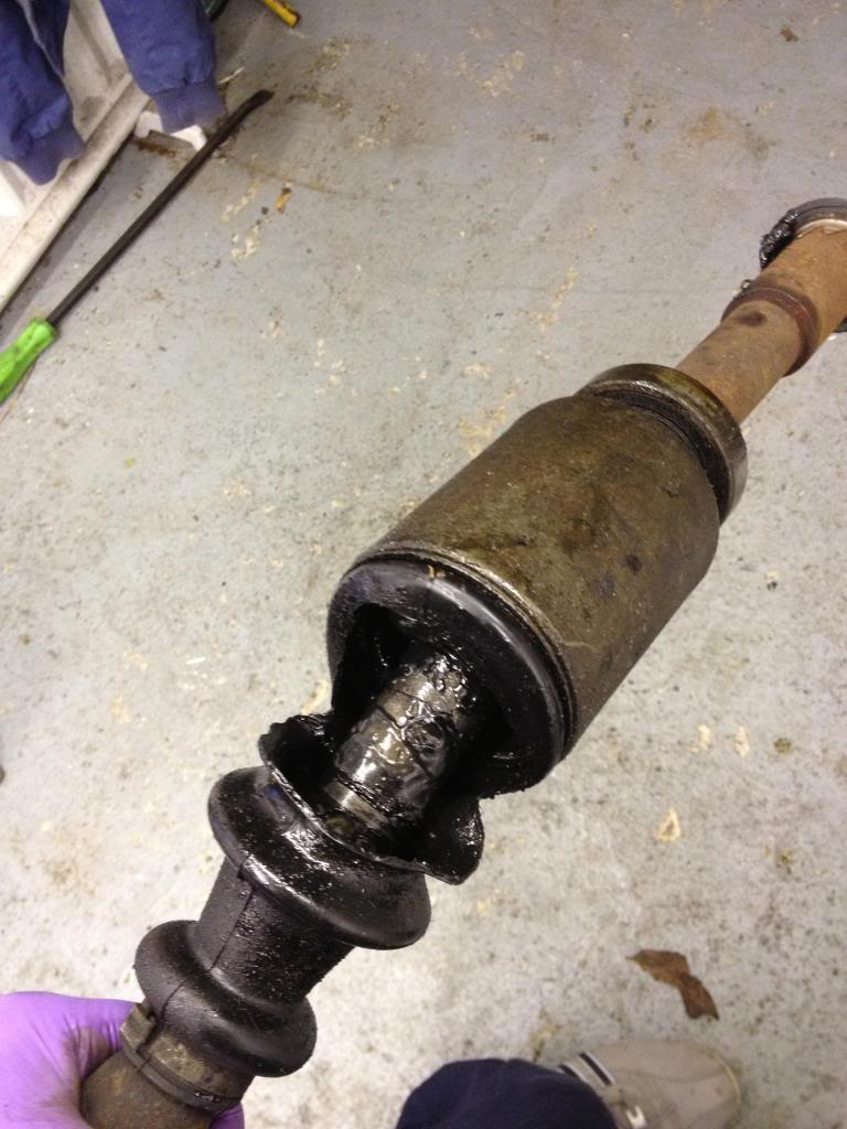

Mr bean had a few issues with the starte motor wiring and unexpected extra bills with the driveshaft

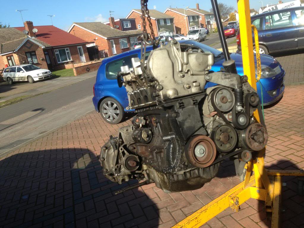

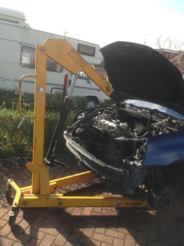

well its nearly ready to lift this was my part in helping by operating the lifting :approve:
lots of CV grease all up the back of the engine where the gaitor has split !!!

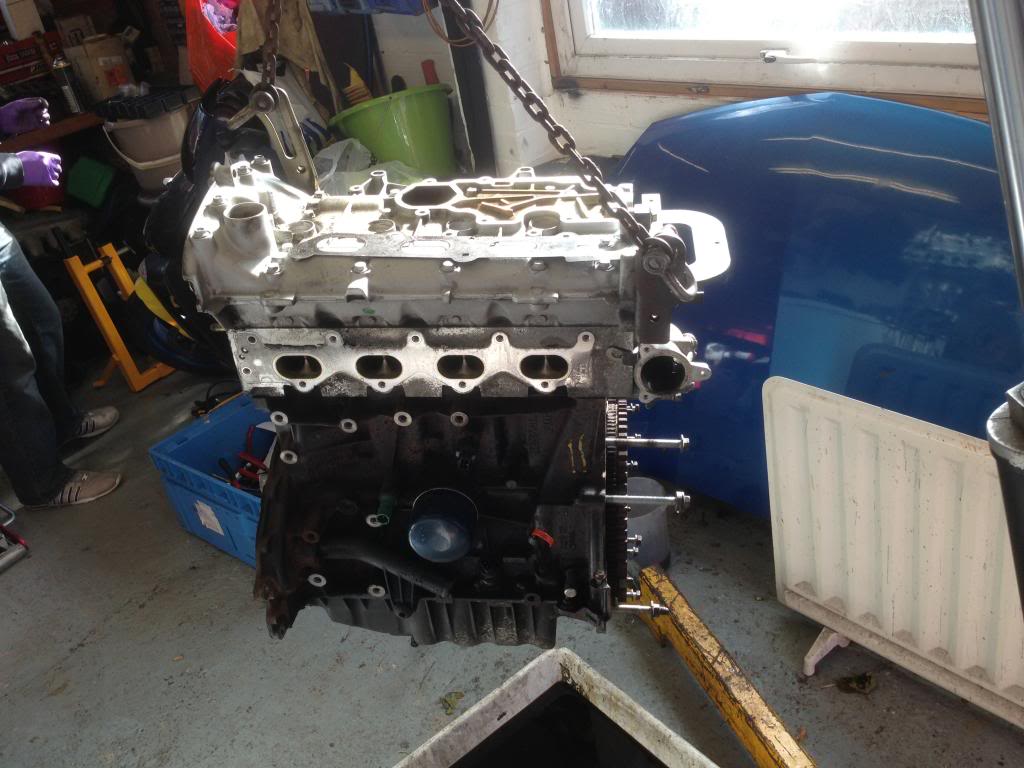

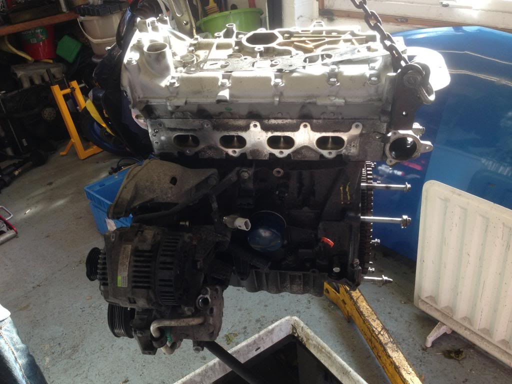

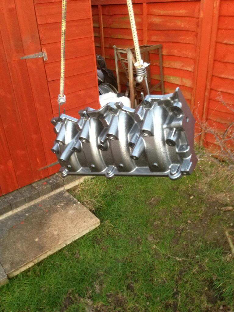

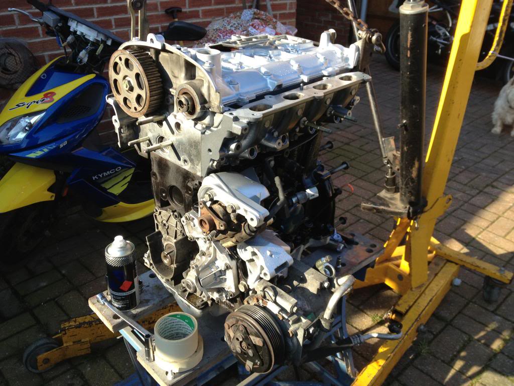

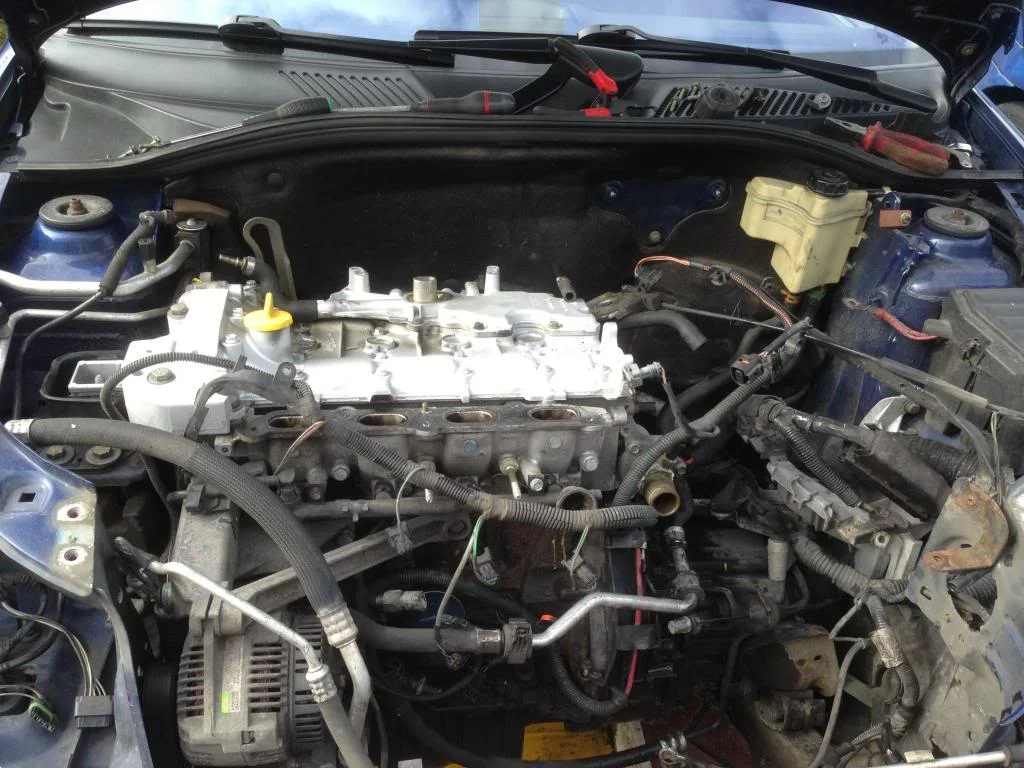

so that was all of saturday taking the engine out. Sunday was cleaning off the engine bay,wheel arches and pressure washing off the worst of the engine then Mr Bean would be stripping the engine down monday ready for repainting parts and new belts dephaser etc

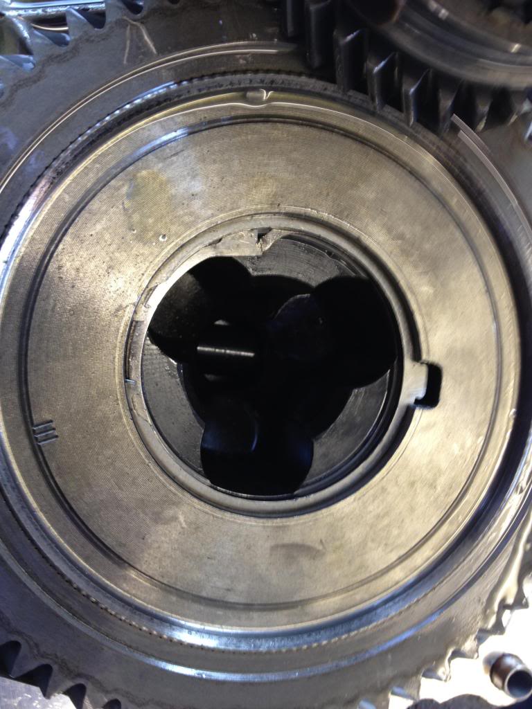

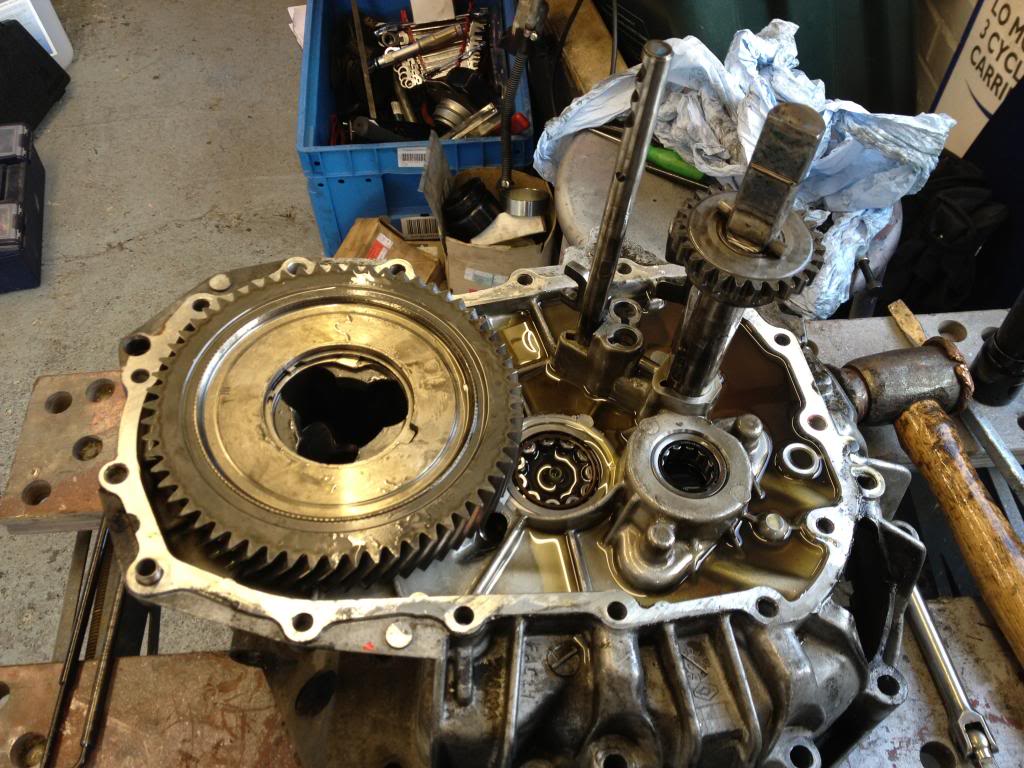

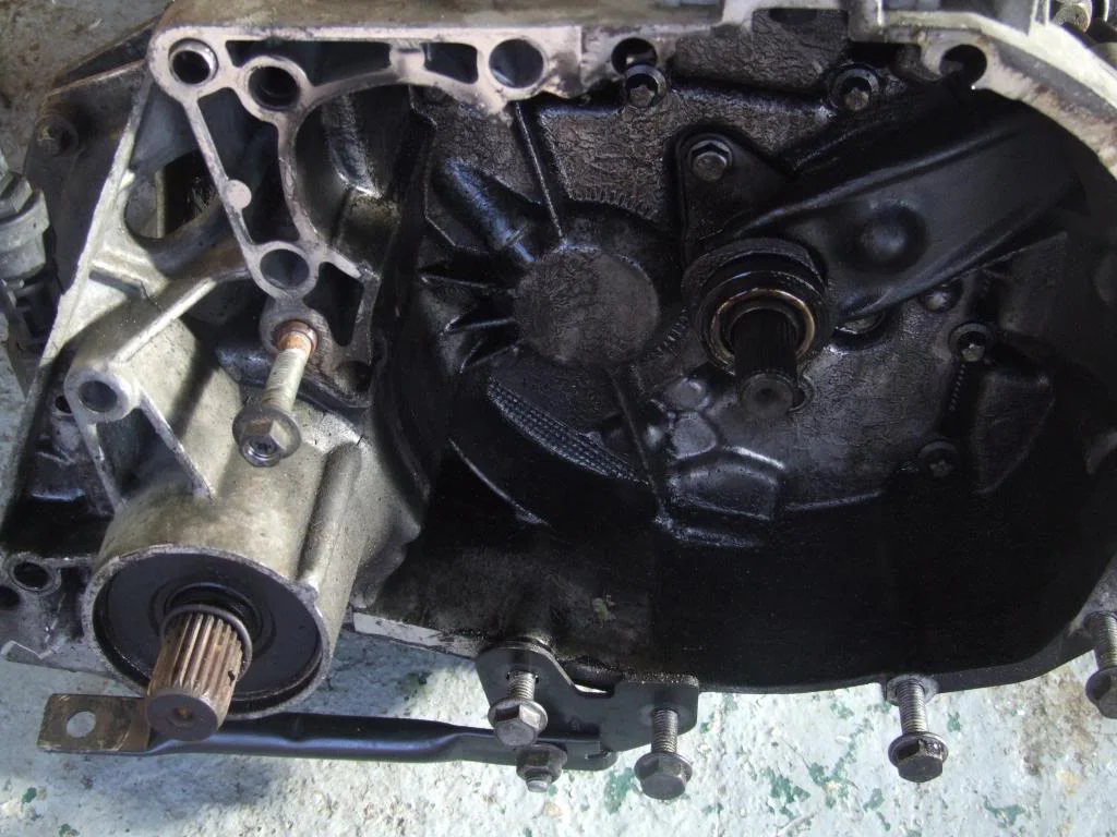

found when we stripped the gearbox that it was in a bad state and really in need of that rebuild the clutch wasnt fairing well neither covered in gearbox oil

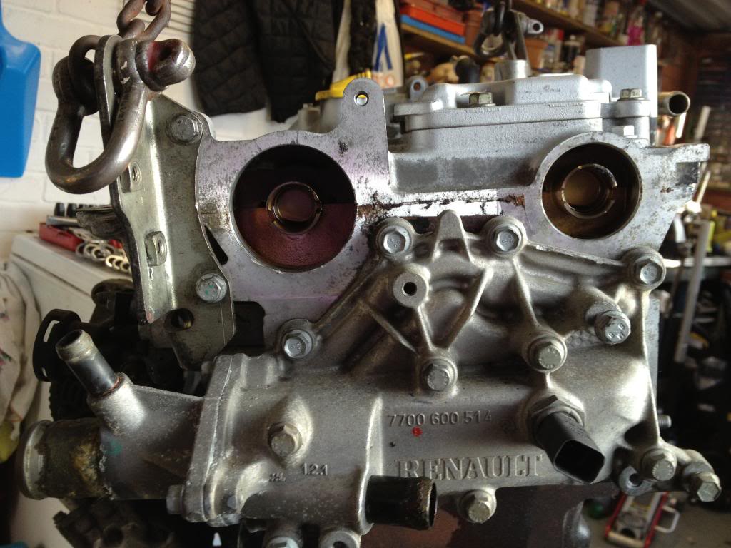

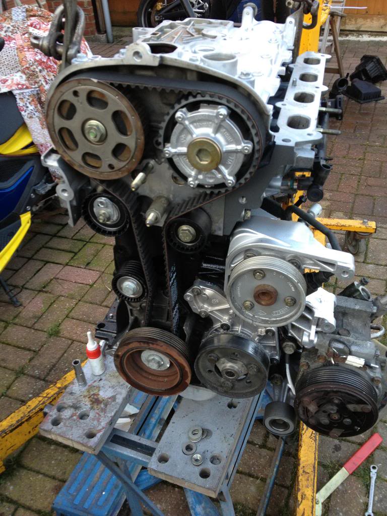

found that the dephaser pulley was a little knackered to say the least and timing out a little
engine all locked with the proper tools and ready for the strip down
not the best picture but when removing the injector rail we noticed that number 2 injector was a bit scabby around the jet so will be replaced with a better one

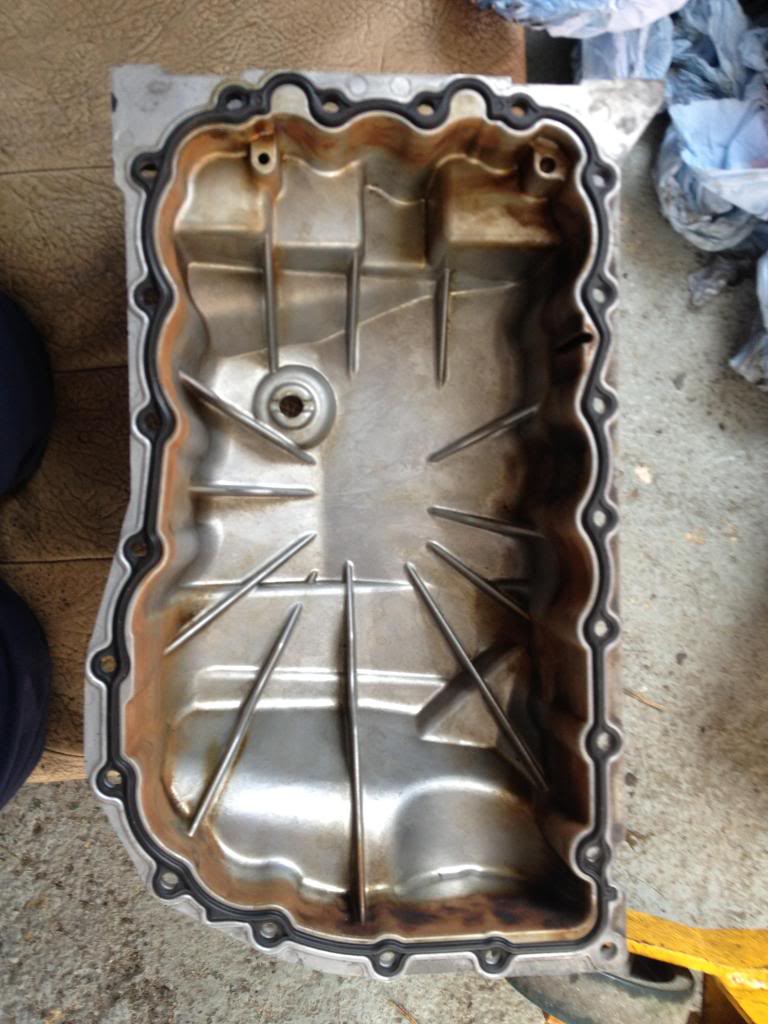

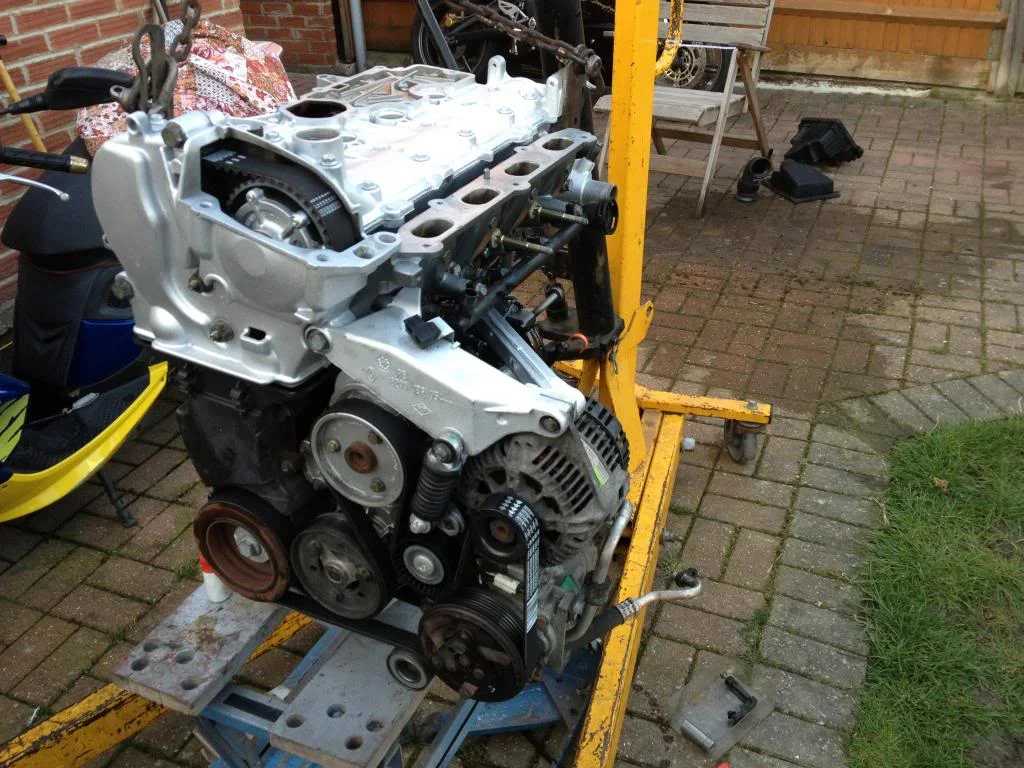

Mr bean has been busy today sorting out the rest or the engine and putting the engine back he's removed the sump and replaced the gasket as it was leaking also cast his eye over the bottom end all looked really well for a 155k engine !!! so that was re-sealed and torqued up. Then it was time to move onto the cambelt area as i have been having a few issues with a noise at around 80-90mph so Mr bean set out to see if it was anything todo with the cambelt. Mr bean found that the dephaser pulley was completely shot and well due a replacment its never been replaced until now so it shows looking after your engine helps.
Mr bean also found that one of the idler pulleys was really noisy so he thinks this is the cause for the noise i was hearing around 80mph as this engine has had a hard life with a fair few trackdays and european driving and we both thought as it had a hard life to change the belts early was only changed 3yrs ago and at 90k. All new genuine belts and dephaser pulley fitted also treated to a new water pump and OE aux belt kit engine was pritty much done before he put the belts on he also resealed the rocker cover. The other half was then to move onto the gearbox strip and rebuild.

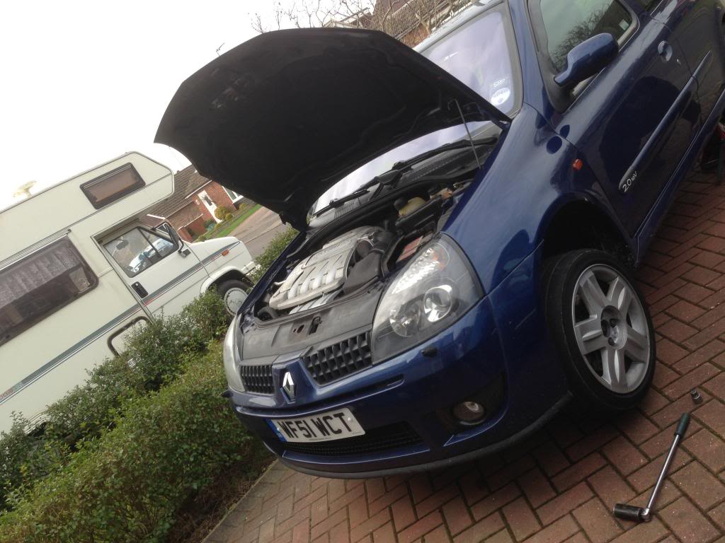

here are a few pics from tuesdays building
it was a nice day so cracked on with it all outside :cool:

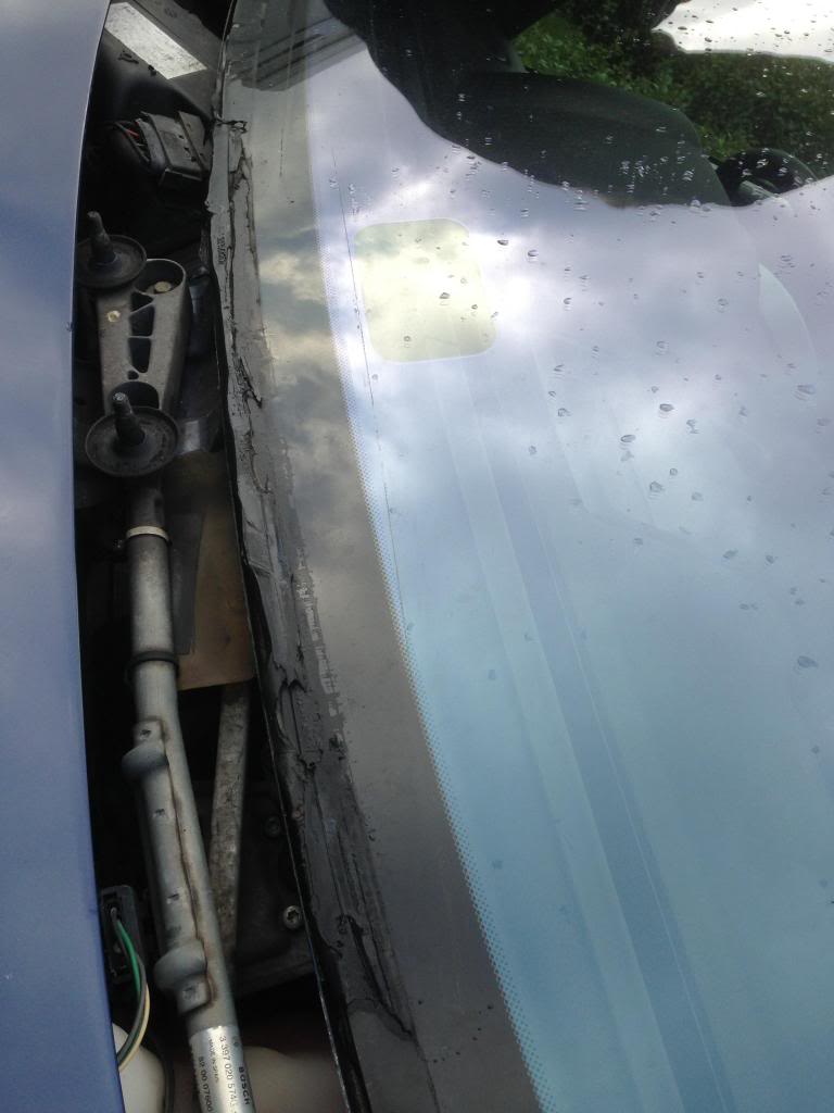

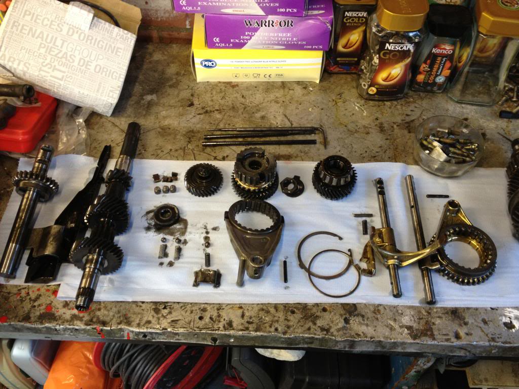

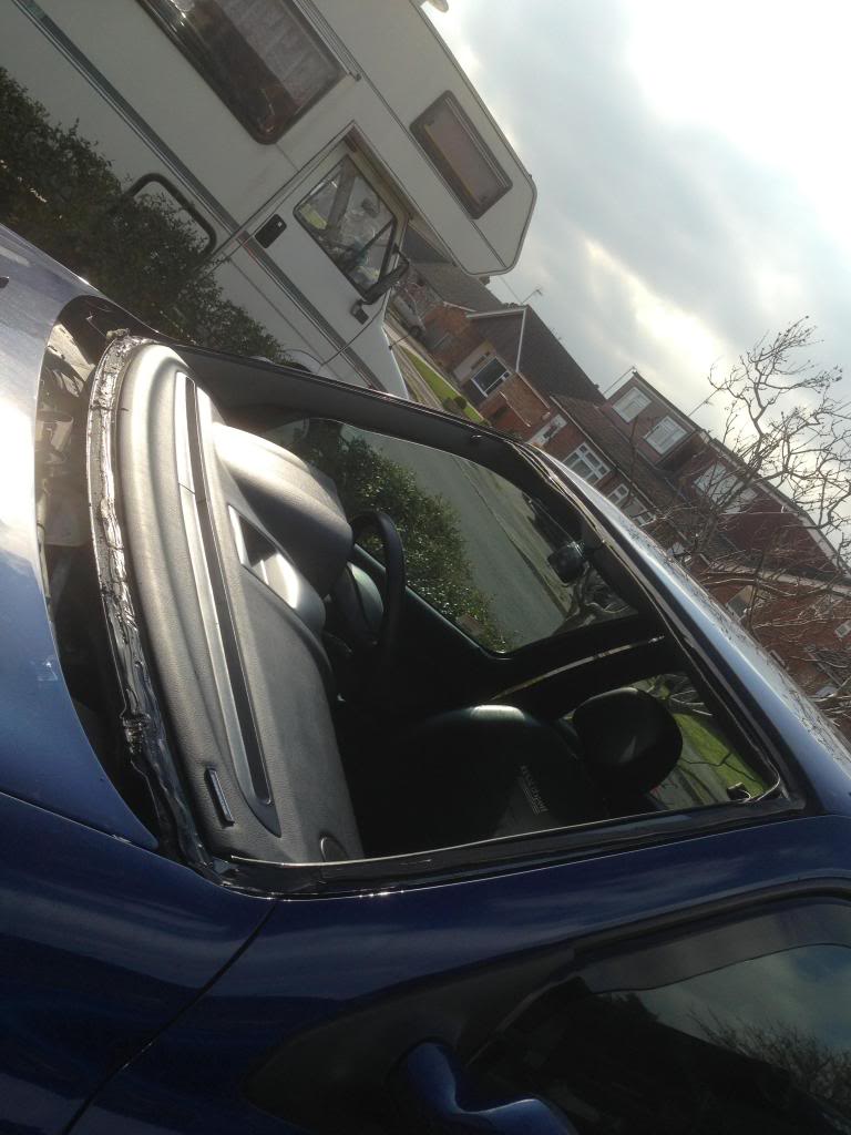

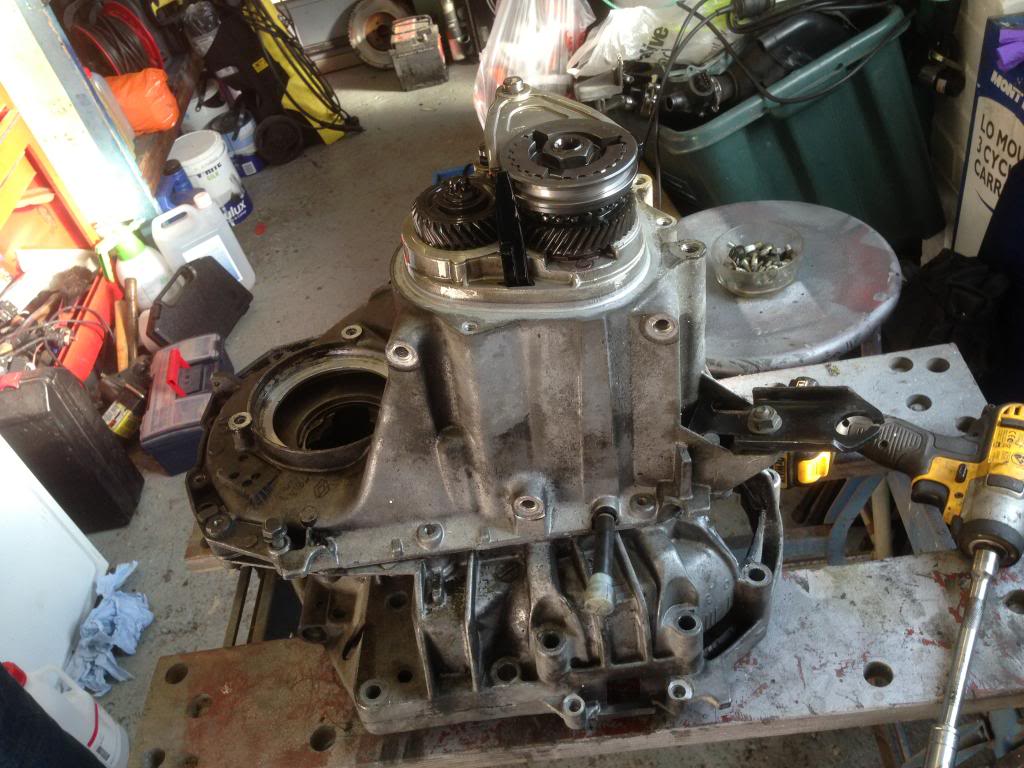

Today was the start of the gearbox strip and rebuild and also to pop to bristol to collect some parts for the clio also i was having a few issues with a water leak from the passenger side head linning since having the windscreen replaced a few weeks ago. So a fully packed day Mr bean was up nice and early braving the cold weather working away in the garage stripping the gearbox down he came across a few issues with the diff circlip not far off from breaking so a quick call to work to order a new circlip and spacer washer but Mr bean had a brain storm after we had ordered the parts that the spare 182 gearbox he had was fitted with a bolted diff and to see if he could use that in my gearbox ??
Mr bean did a bit of research on Cliosport via the search function :p that 1 or 2 people had modified the bolted diff clip to fit the older type of gearbox i dont no if this is possiable but Mr bean's old man is an engineer so we shall see.
so we went off to bristol to see ya53lhd_MATT to pick up a new clutch cable and cup suspension as my ebach springs are to stiff for what i need now straight back just in time for the glass company to turn up the bloke was really sympathetic and criticised the previous guys windscreen skills as he had done a bodge job by not prepping the screen also damaging trims and glue-ing my ultrasonic sensors into the glass bonding :mad: to put it bluntly i reckon i could have done a better job a quick phone call to my insurance company to complain about the blatent disregard for my clio and poor skill was a total winner they re-inburst me my excess for the glass so wasnt bad
tomorrow is wheel cleaning ready for Gtechniq seal while the other half carrys on with the gearbox rebuild.

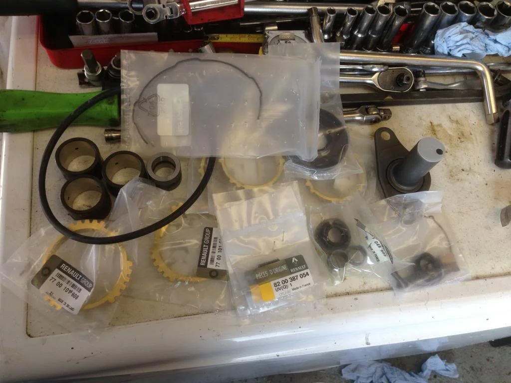

here is a couple of pics.
a genuine renault rebuild kit and its contents hopefully sort out all that crunching in gears
heres the pics from the windscreen
