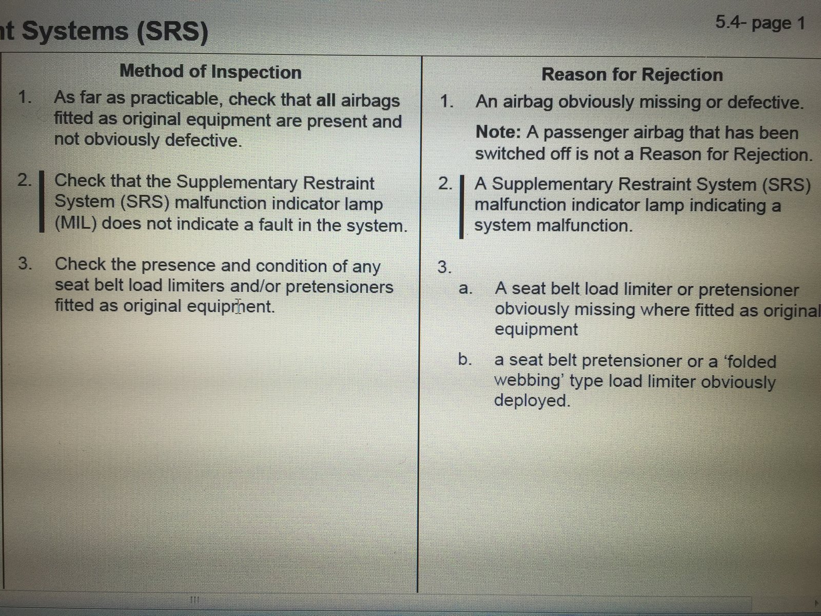

I think he misinterpreted what it means by "fitted as original equipment " . Original equipment is defined as equipment fitted to the vehicle as it left the factory.
Reason for Rejection 1
