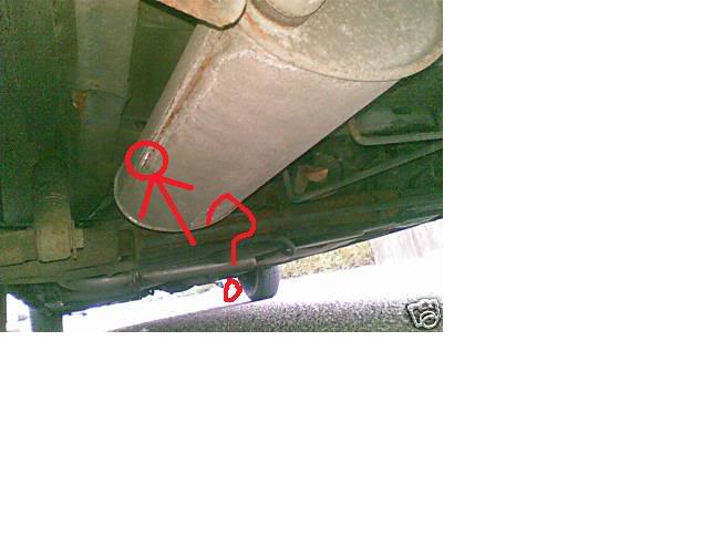

MOT Fail ??
on the left of exhaust (chassis rail)
the rust on the chassis rail you mean?? if the tester got it to deform with the corrosion assesment tool then yes... as its 30cm from a structural point (shock mount)
the rust is fine, it looks indented to me.
well either way,, it only wants a tiny tiny plate welding on it (20 quid max) or grinding off and stone chipping
either ways not really a problem
^ sills will be fine, you seen mine Lmao, put it this way looks like iv driven over to many fat people :) but still passed, just i need to sort them tho..
dents are fine rust isn't
but its tester decision on how bad corrosion is ie if its obviously weakened by rust (bends/flakes under the corrosion assesment tool) or a hole
oh,, and its within 30cm of structural points (which pretty much means the whole outer sill (seatbelt mounts, shock mounts etc etc)
