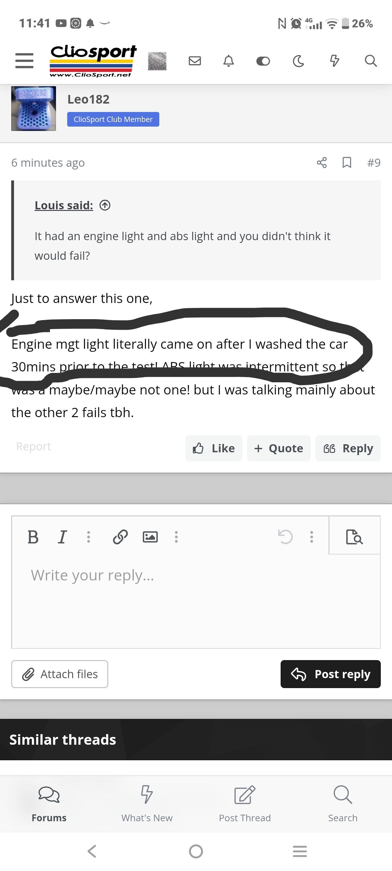

It had an engine light and abs light and you didn't think it would fail?
Just to answer this one,
Engine mgt light literally came on after I washed the car 30mins prior to the test! ABS light was intermittent so that was a maybe/maybe not one! but I was talking mainly about the other 2 fails tbh.
