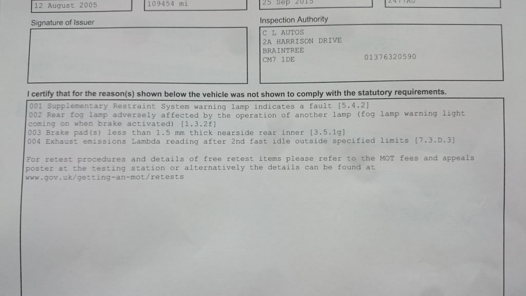

182 just failed it's mot
The one thats going to cause me issues is number 2.

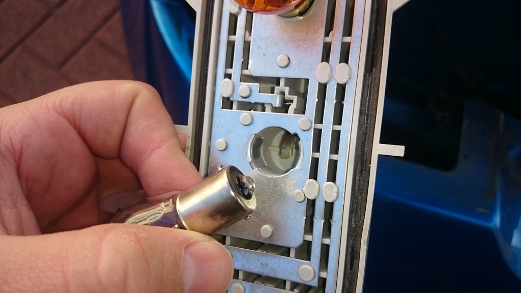

The fog only comes on when breaking or when doing indicator on passenger side, not the drivers side.
If I remove the fog bulb from passengers side, the dash still lights up. If I remove whole cluster the fog on the dash still lights up. If I also remove whole cluster from drivers side, the fog on the dash doesn't light up.
Passengers side
Andy_con
  clio 182

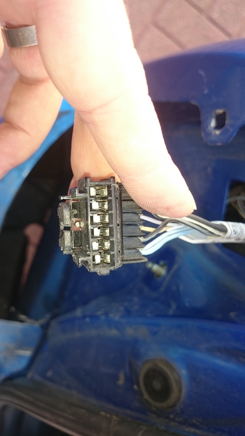

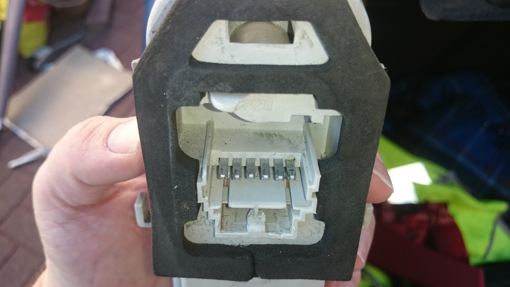

Right slowly narrowing down.
Took all blues out of both sides and put hem back in, in order of bottom to top. The only time the issue occurs is when I put the top bulb in which I think is break.
Even even when I had indicators and fog bulbs in on both sides nothing. But as soon as I put either of the two top bulbs in the fault appears.
Really can't find an issue with the pins
Andy_con
  clio 182
Right managed to solve the issue with solder, o put a drop of solder on each pin and the problem has gone away.

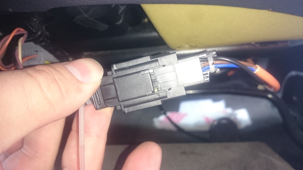

How does this connector under the passenger seat come apart?
  Clio 172
Looks like the airbag harness? See where your thumb is there's two raised bits, slide a small flat head in there and release the tab if it's what I'm thinking
Also good diagnosis on the wiring plug, turned out its saggy pins
Andy_con
  clio 182
Bing thanks, bit of tin foil in the pins and air bag light is off two faults down two to go

Have you replaced the front lambda sensor, that is a prime suspect for causing emissions fails.
