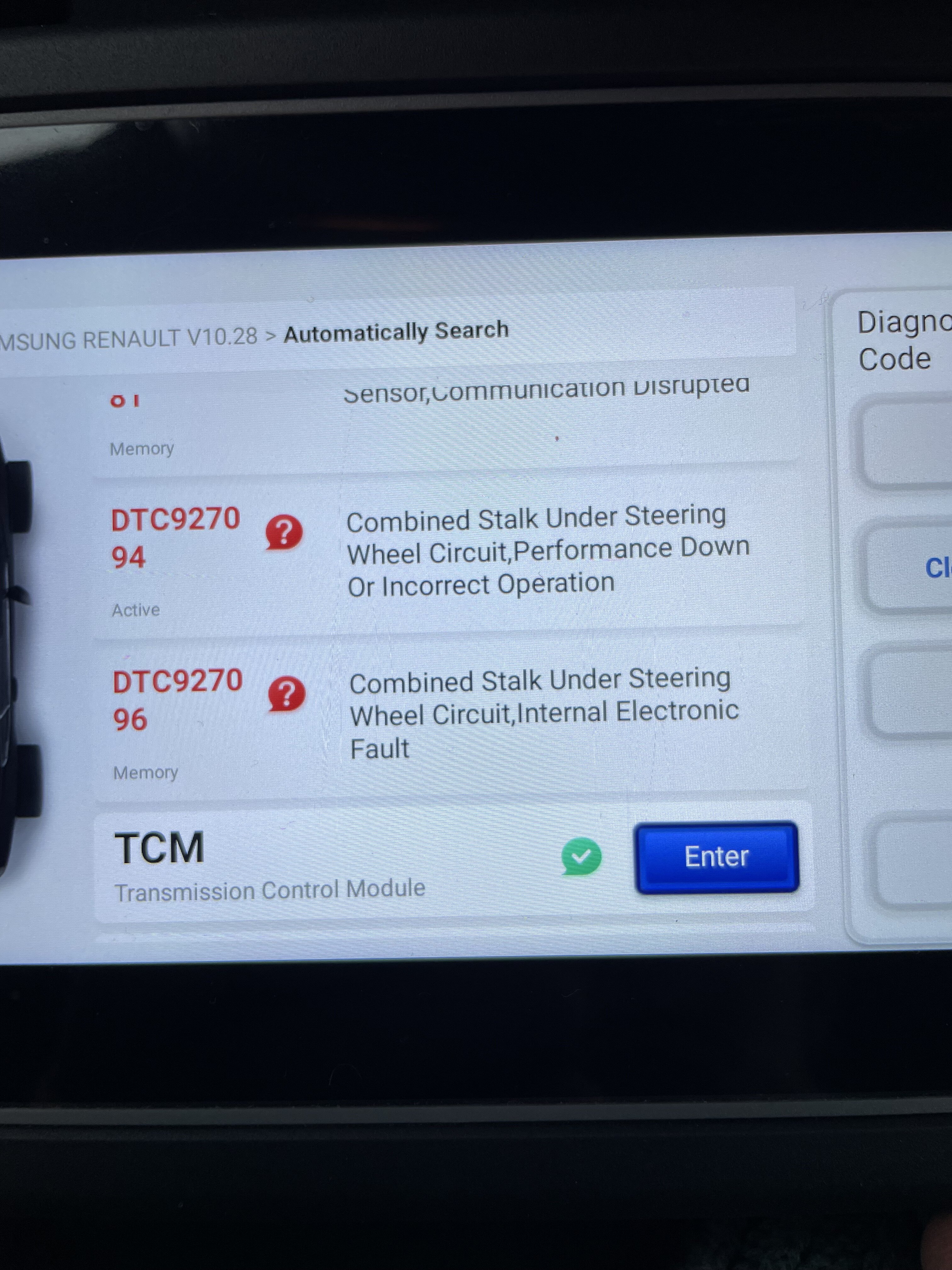

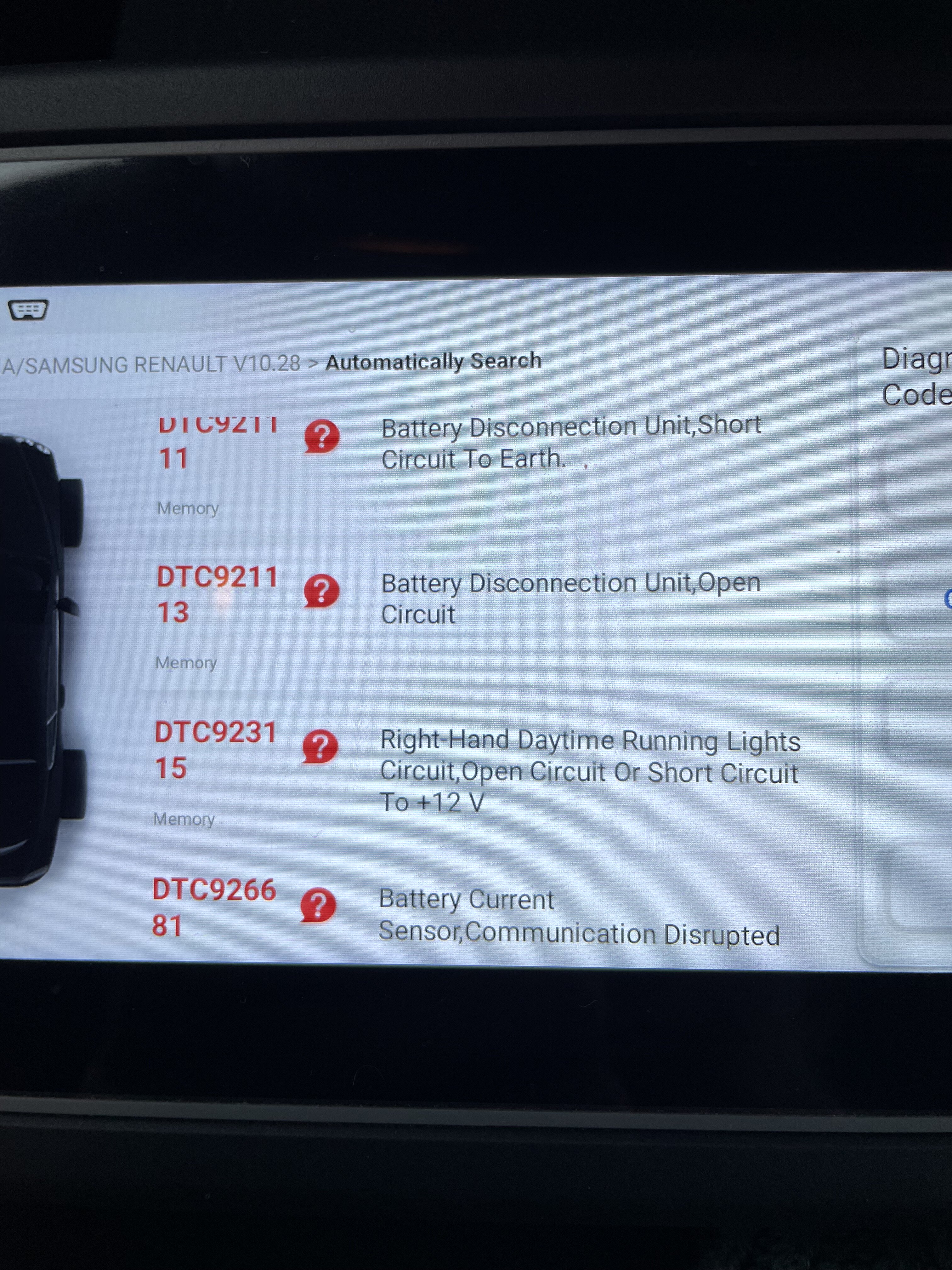

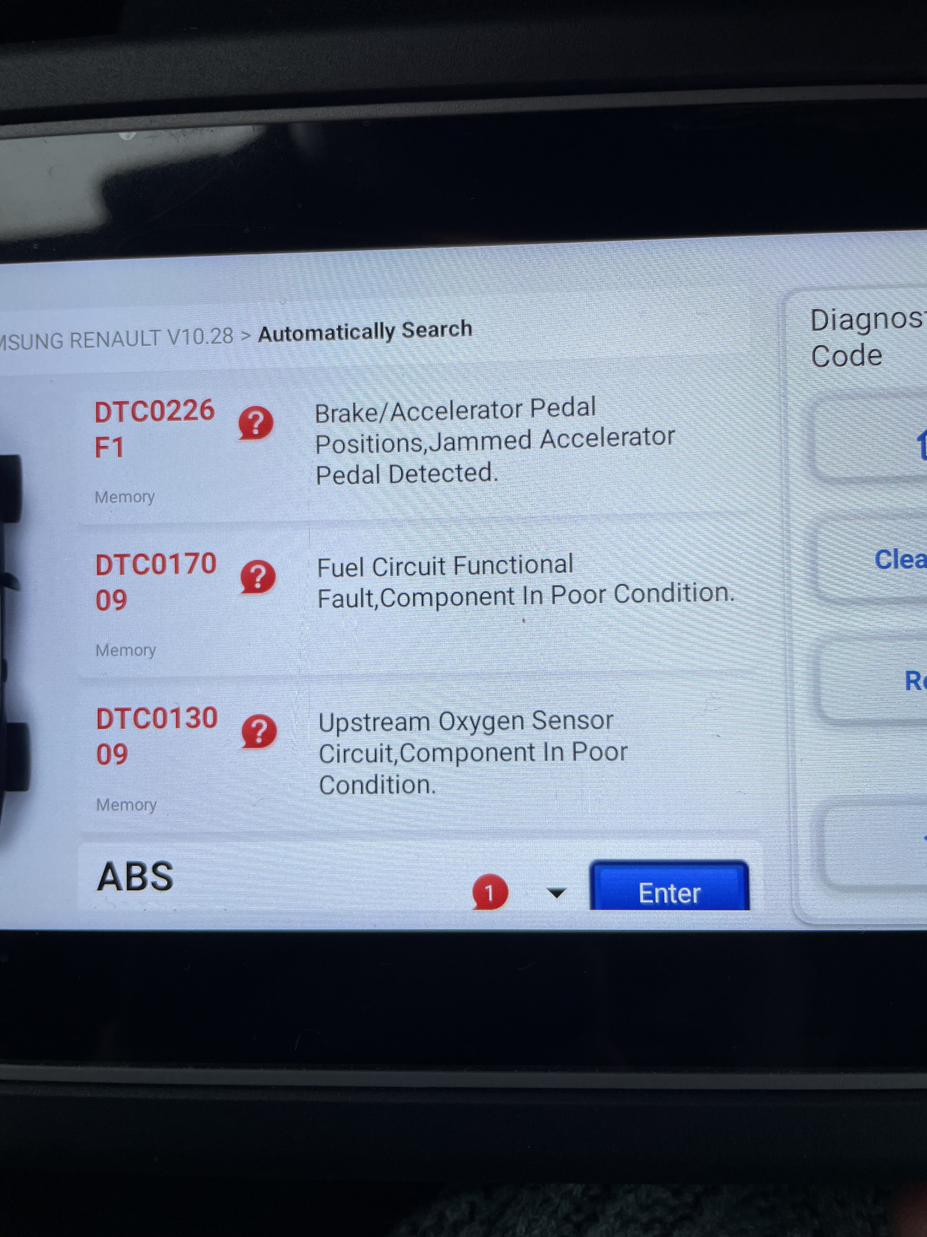

I usuallly get one or more of the following ‘check ESC’, ‘check hill start assistance’, ‘anti pollution’
I just ignore them now 😆 every now and then I get the computer to view and clear the codes
Here’s the last lot I had up…
Some of the codes would be quite worrying and costly if a garage were to change or ‘fix’ these red herring issues.
If the car is running ok I’m clearing them and cracking on 🤣
View attachment 1673815View attachment 1673816View attachment 1673817
The fiesta does indeed have the same getrag gearbox 🤣 but it is mapped completely differently so therefore seems like a different box.
