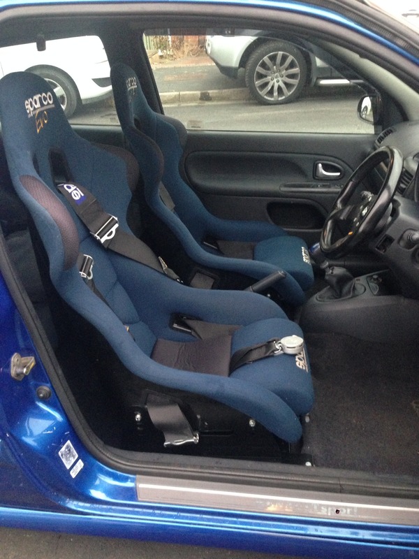

Hello all,
I'm completely new to this so my apologies if this has been repeated but can't find what I'm after, my brother and I have bought some omp seat mounts to go with our omp seats, however after fitting them my head almost touches the roof, I'm 6ft 3 so no sups it's there, I've seen posts on here where people have cut out the original rails and bolted the side mounts directly to the floor, this way you are furthe back than normal, can I get some advice on how to do this and any complications to worry about? Pictures would help or better ideas for tall long legged drivers like me :)

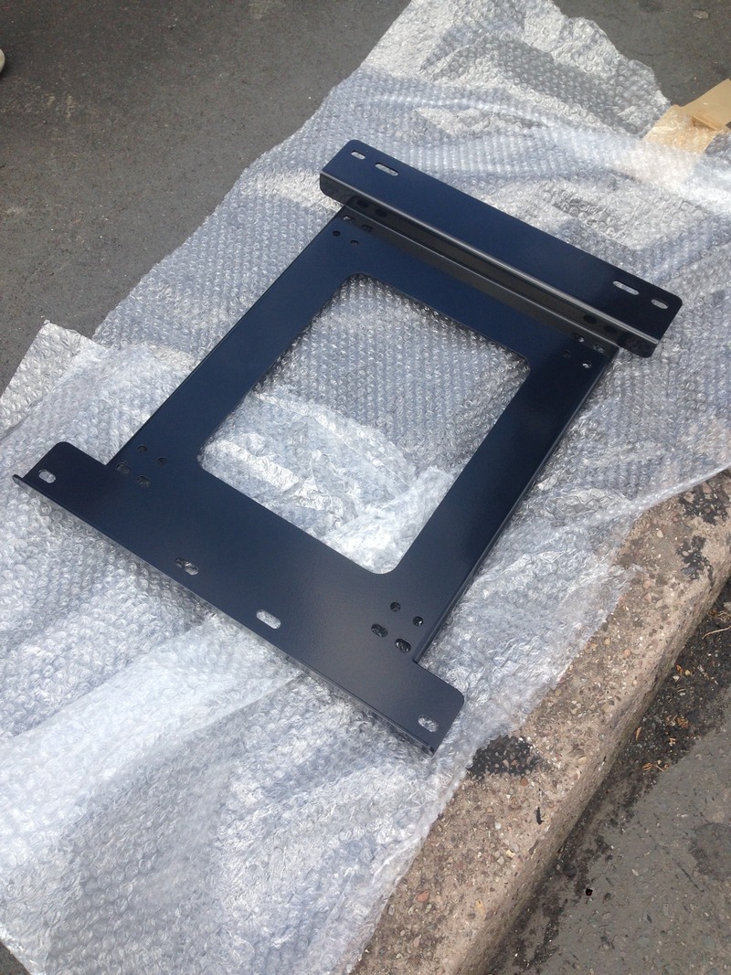

I can supply my VBD Clio X-Low subframes to solve your height problem.
They are £130 for two collected from Merseyside or plus £16 posted to mainland UK.

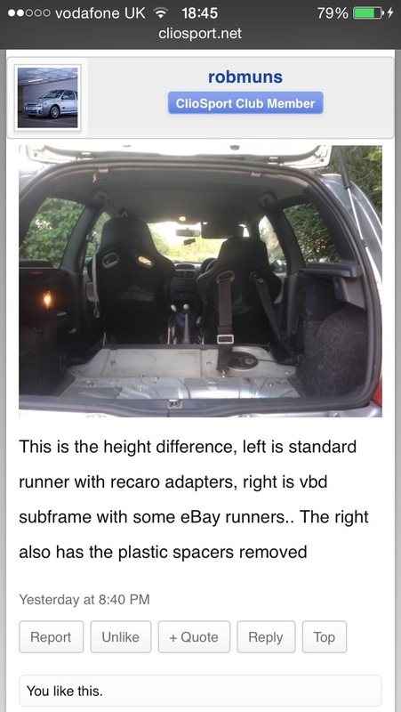

Hi mate whilst I didn't have the same issue with my head touching the roof being 5,9 I felt high up
I bought a set of frames of Jon ( the above post) and can not speak highly enough of the, no modifying no having to run spacers perfect for and you literally are on the floor
