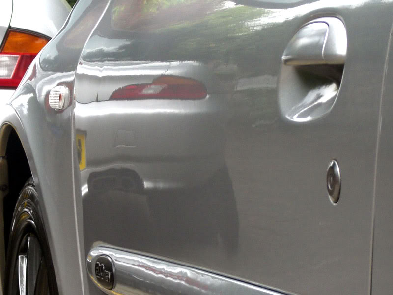

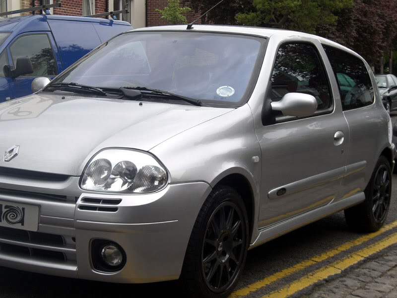

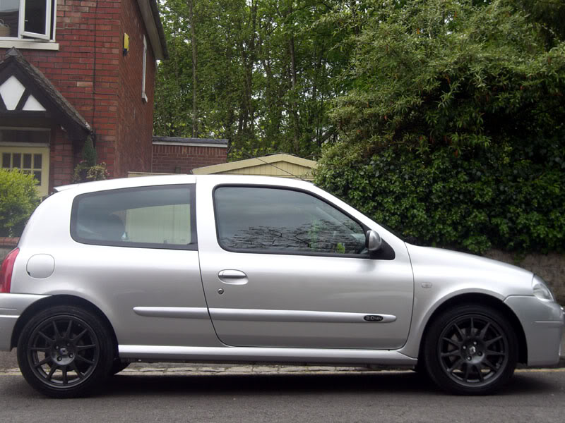

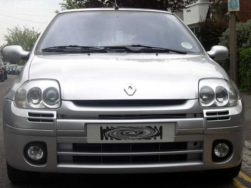

A mini detail this am with Mr Stabby (Tom) and Wazza16V (Nick) from Cliosport. Tom wanted his car detailed before the French Car Show.

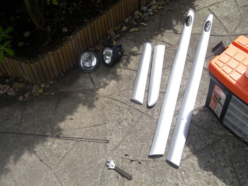

We also managed to remove more bits than last time!!!

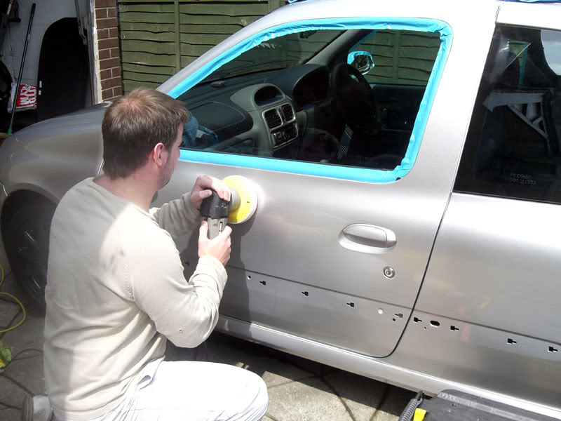

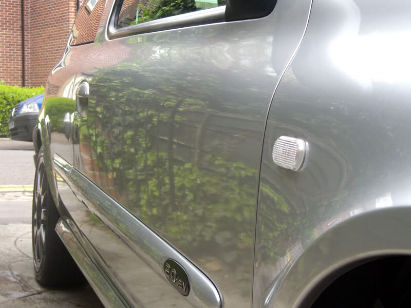

Here Tom Used the PC and SSR1 to remove any hologramming from SSR2.5 via the rotary.

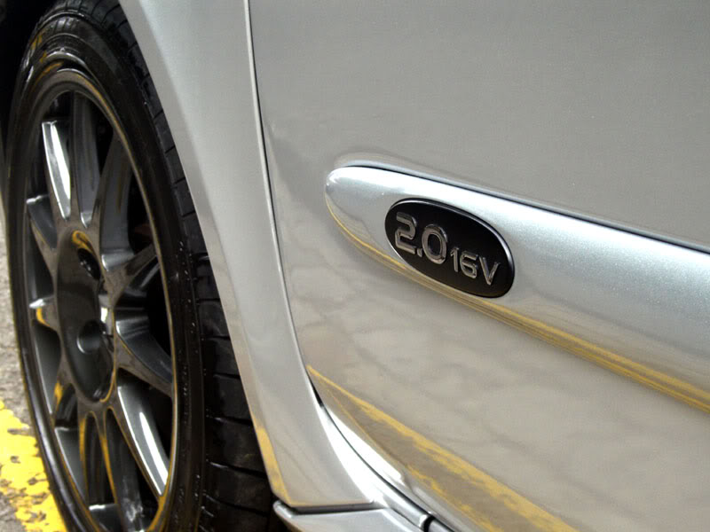

Nick did a grand job on the wheels with Wheel wax and megs endurance tyre gel :thumb:
Process
QEW wash
Megs aggressive clay
SSR2.5 on rotary, SSR1 on PC
Z6 wipedown
2 coats of Z5 and one of Z8
To be fair the wheels have been 'just refurbed' but the 'wheel wax' brought them up nicely!
Side strips popped off easily apparently! Tom did all the remocal work!
