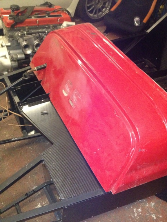

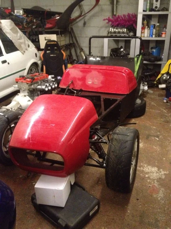

Started mocking up the panels today so all the drilling and cutting is done before Spray Shack start painting.
Can't believe that adding 2 panels makes it look so much more like a car.

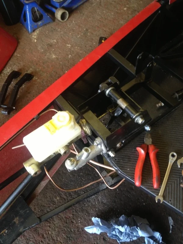

Had a bit of a pay this weekend and got the brakes and clutch master sorted.

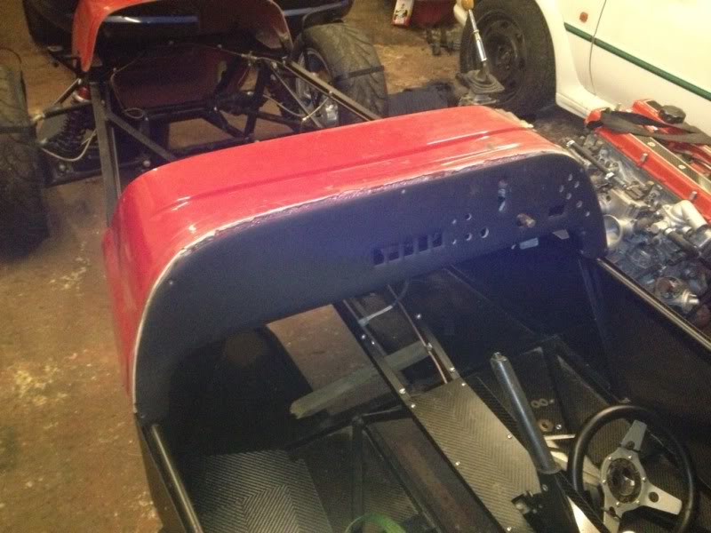

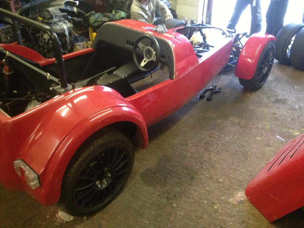

I've started putting the body panels on so all the drilling and cutting is done before the paint job is done.

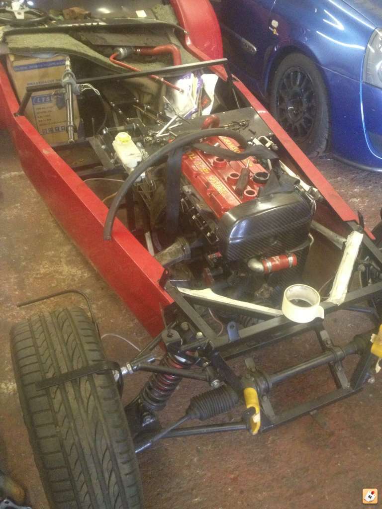

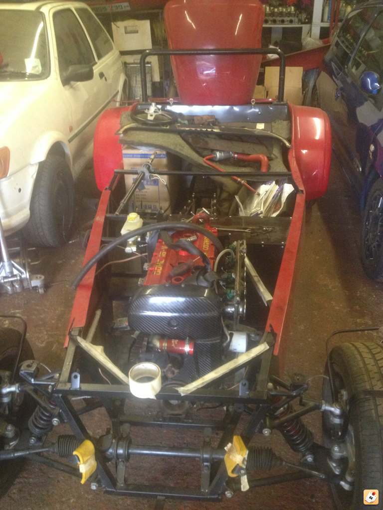

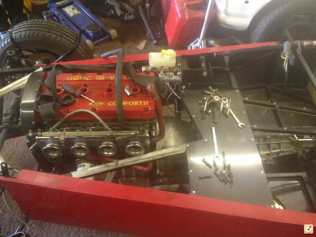

Long overdue but here we go!
Got round to Chips at the weekend and removed the heart from his Serria and I think a little of his own heart too.
I wasted no time getting to work.
The engine and box are a tight fit but it looks quite easy to modify the chassis to get it perfect. It literally needs a small notch to clear the starter motor mounting on the bell housing and a slight mod to allow the inlet to fit. Looks less than an hours work. :)
Only issue I've found so far that's going to take a bit of technical thinking is the steering bar runs right through the alternator so I need to run a different one, possibly on the other side of the engine.
Also the 2wd exhaust manifold is far too big to fit in so I need to source a 4wd one as the are much more compact and still capable of flowing 400bhp.

But water pump will still be in same place. Although you would need to add an extra tensioner if alternator was on the outer grove I guess.
  Ph1 172 & Clio DCi
I could even space the water pump pulley out a bit so it too can run on the outer grove. Saves weight and the need for another tensioner then. :)
