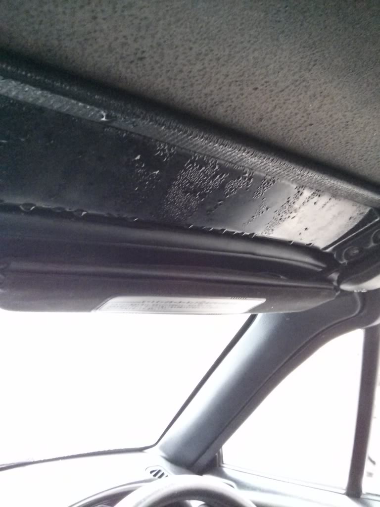

My mx5 with soft top hood is leaking water somehow, there is no obvious wafter dribbling in but every morning when I see the car its all steamed up with condensation. There are water ddroplets on the inside windows and on the soft top roof.
I need to check and unclog the drainage holes which I haven't checked yet, what else could it be ? Window seals? New roof ?!

Behind the seatbelt towers.
The rain from the rof falls into the rain rail, then circles round into a tray behind the seatbelt towers and down through a hole. It's common that they get blocked.
  work for BMW
Spot on, cleaning them both out so hopefully that does that trick, thanks alot bru

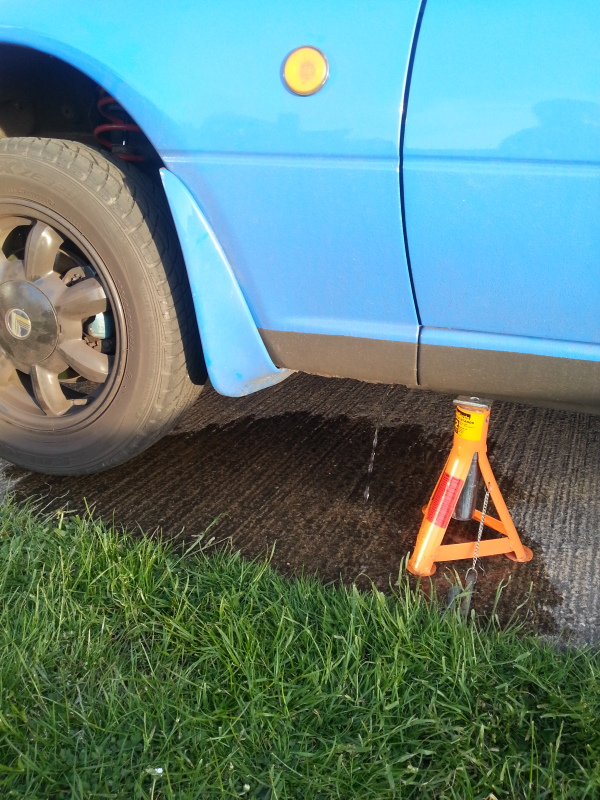

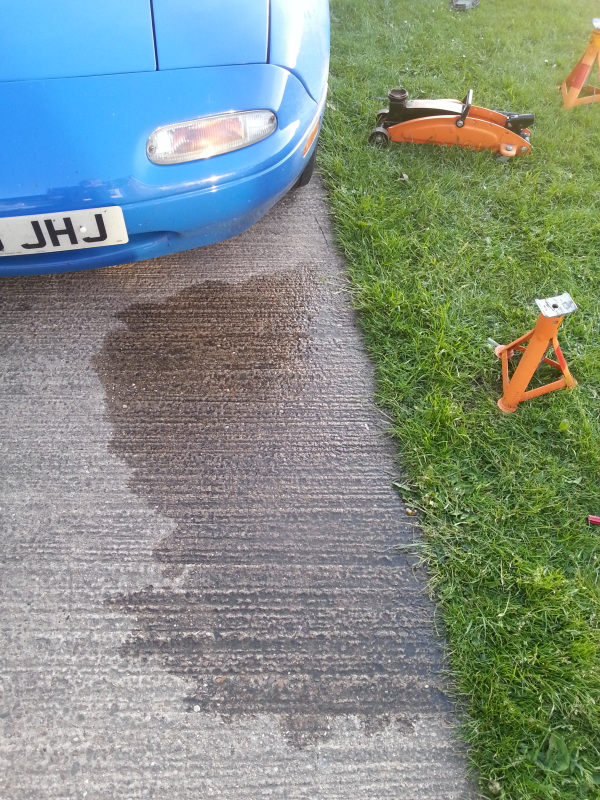

  A3 2.0TFSI QUATTRO
Mine did this when drainage holes were blocked
Mainly the ones in the sills and then slowly worked a stiff wire through from the roof and the ount of c**p I dug out and the amount of water that leaked oit of the sill was unreal
You can see the water coming out
The end result
