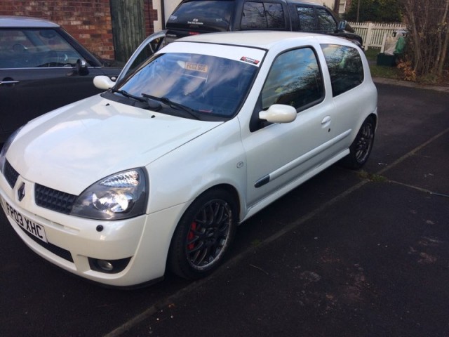

This is my first build thread so hopefully not to yawn! So i have known the car for several years whilst it was in a friends ownership, i had even helped build it through some lengthy late evenings at my unit rolling well into the earlys hours!
My friend was reluctantly selling due to re-training and taking an income knock! I haven't owned a clio for about two years now and didn't really plan to own another (Have had five) but after a nurburgring trip in late 2017 i decided i needed another clio in my life and my friend messaged asking if i would be interested... Perfect timing! The car was collected about two weeks later :)

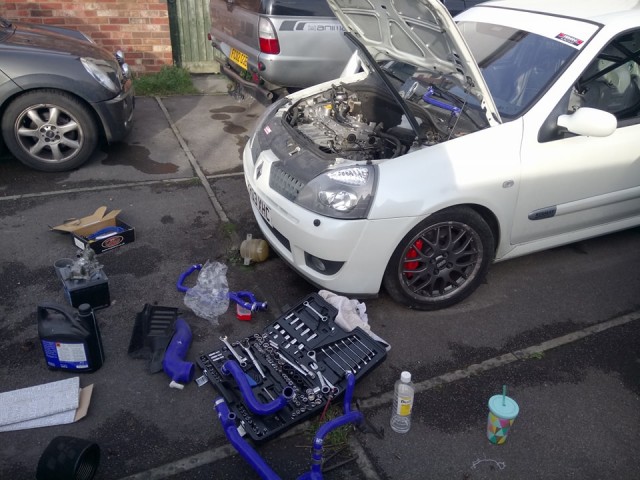

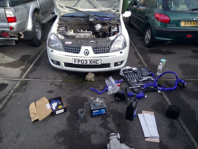

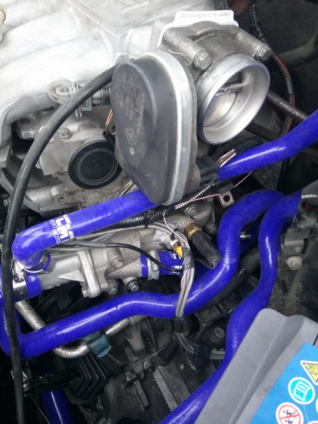

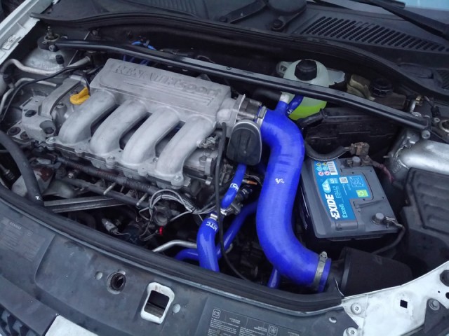

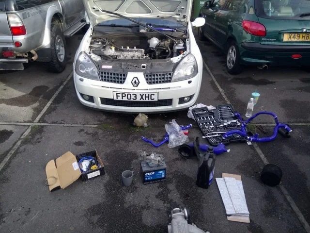

My friend had some Blue Silicone Hoses he had bought that he intended to fit but hadn't... so threw them in for me! Managed to get these fitted last weekend along with some blue Magnicore Competition HT Leads.
The Spa Water Temp Guage required it's own temp sender as the ECU requires the OEM read out (so i am told) so have had a boss welded into the side of a spare water gallery housing to thread the gauge sender in so that was also fitted with the new hoses, and new header tank.
Fluids :up:
