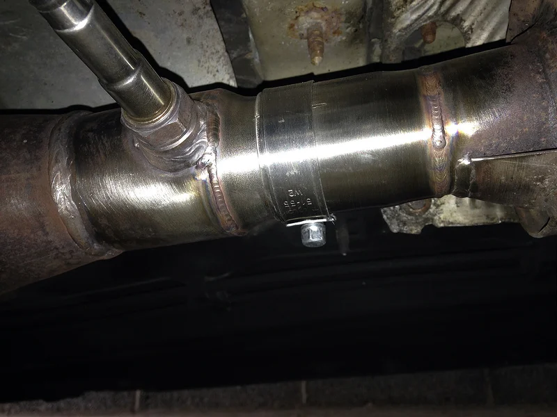

had local fabricators sleeve cat to exhaust join as it kept blowing + new ECU bracket

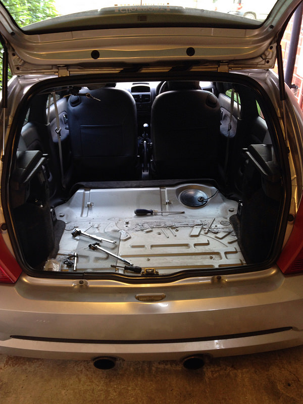

striped out all the rear interior - front will go too in time

Sleeve
image by mgoddy, on Flickr

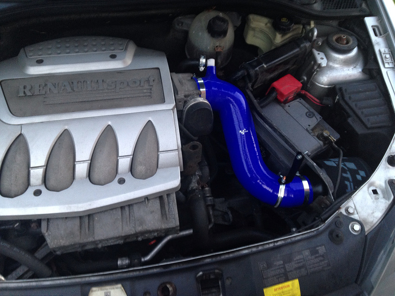

Induction
In process of striping

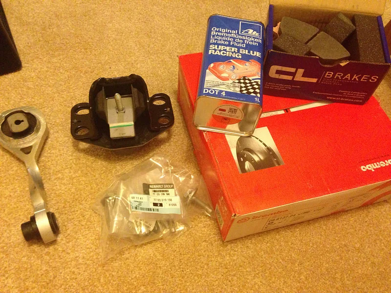

Shiny bits

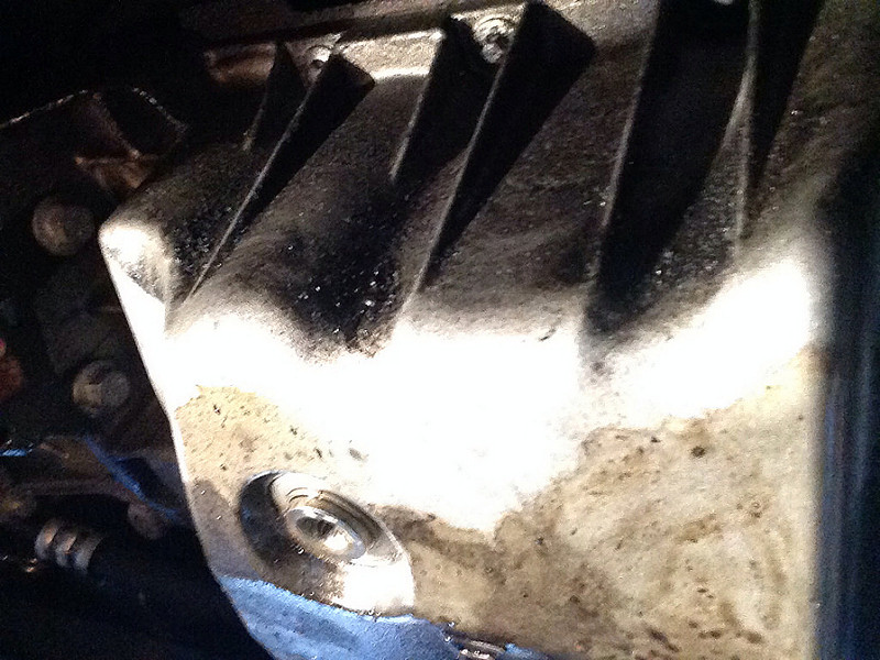

One worrying thing was oil on the sump which I noticed - oil level still pretty much full from service so can't be that much - will keep an eye on it.

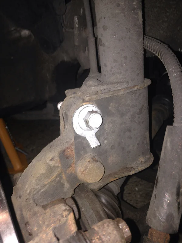

The other thing is I've heard the camber washer should be facing in towards the engine but mine are down - is it a major issue?

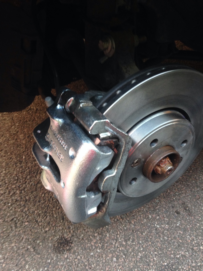

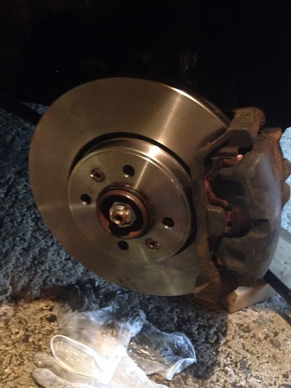

New Discs + Pads

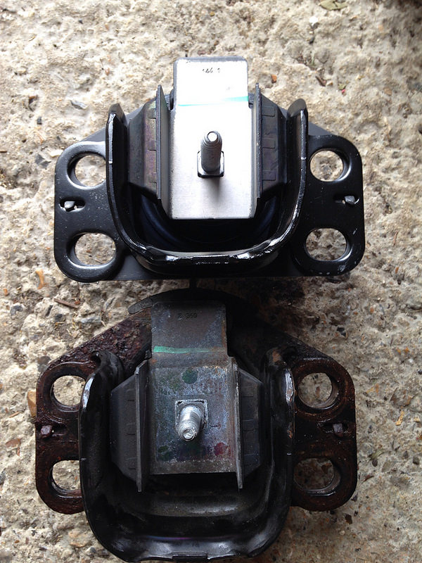

Old mount vs. new
Oily sump (terrible pic)
Camber bolt

So quickest fix to the brake issue was a new caliper - 70 quid once I get the surcharge back so not too bad at all.
unfortunately the braided line on that corner was not letting any fluid through at all so I've had to revert back to the oem for now - no idea what's happened as it's brand new so can't understand why it would be blocked?!
The braking performance is fantastic though - instant bite and so much more stopping power than I had before refresh - although very noisy.
