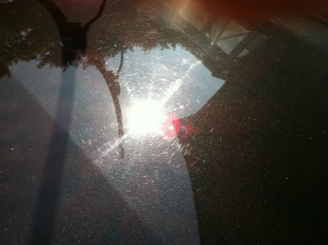

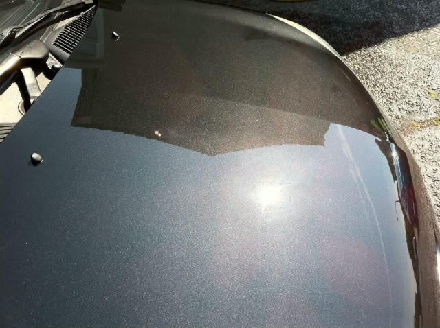

The paint after the first detail was always very good as I was amazed at the transformation, but on sunny days the paint was swirl city, below is a pic of the bonnet as a sample but the whole car was generally this swirled if not worse in places.

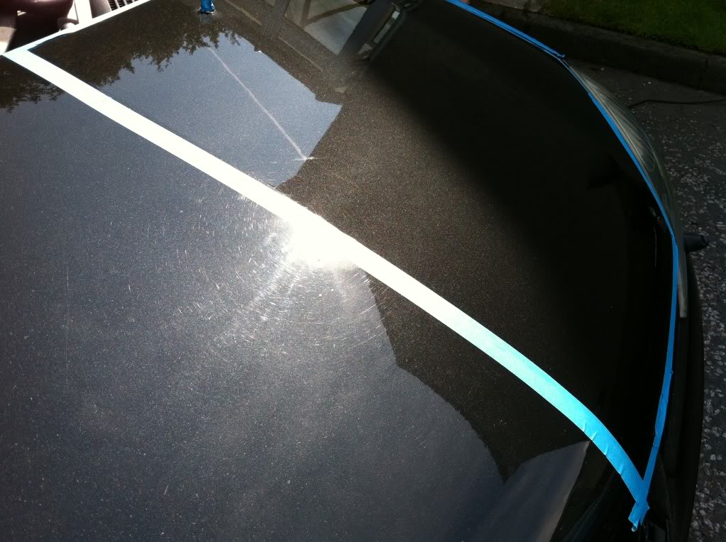

I started with a lot of caution at first using the final finish polish and the white foam pad. This let me get used to the machine and made me find out I was using FAR to much polish as it sprayed all over my windscreen wipers and windscreen when I turned the machine on. I was getting some level of cut but I then went up to the blue pad and power finish. I used this between the first and second speed setting, The level of cut improved but was still taking a lot of passes (due to my slow speed I think). Once I found out I wasnt going to burn through my paint like some of these storys people talk about I moved on to the yellow pad. I started on speed setting 1 moving up to 3 when the polish was spread out, This was getting rid of the swirls effectivley I just used a bit of common sence keeping the machine moving and not applying to much preasure these were my first results.
After a bit more refinement this was the finished bonnet.

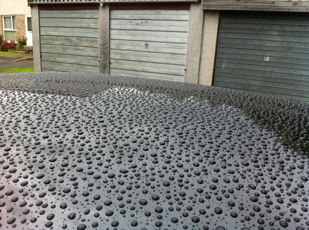

I removed a lot of the swirling leaving behind A fair bit off Random Deep Scratches. I did not want to chance my luck first time round as I was happy with the results. The RDS will hopefully be removed at a later date when I have more confidence and I have read up a bit more. I did the whole car with the yellow pad and the power finish. This was hard work I wont lie, and A LOT people also think you are some kind of weirdo polishing a car two days in row Who cares though the swirls were practically all gone just leaving some RDS few at that. I went over the car with a coat of poorboys black hole show glaze and a couple of layers of red vics.

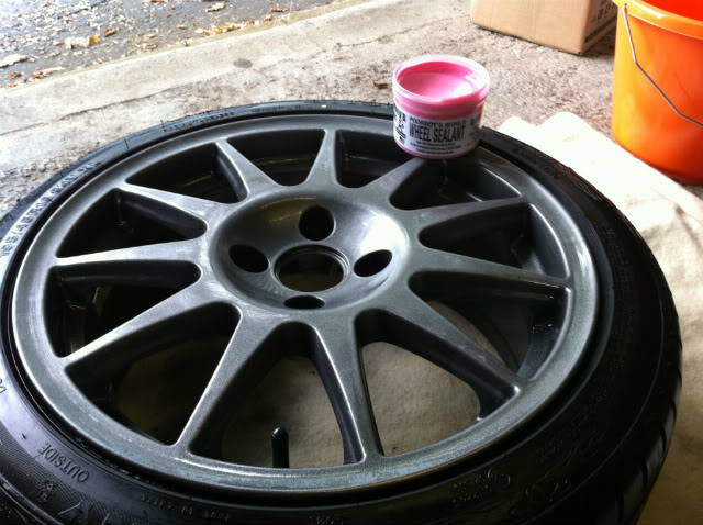

Next up was My new turinis I treated my self to, fresh from the powder coaters got them done in anthracite. I was amazed at how good they were £40 a wheel including the centre caps sprayed and balancing Bargain:approve: Pentland Powder coating for the record just outside Edinburgh.
I went over each wheel with three layers of poorboys wheel sealent inside and out lovley smelling stuff.

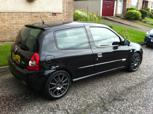

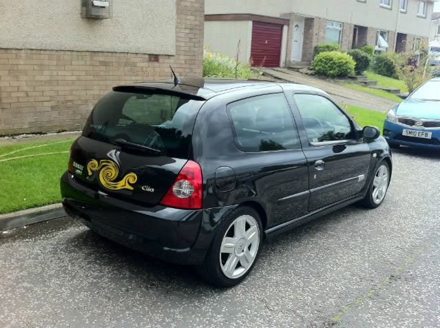

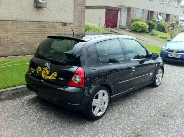

This was the car before.
And after.....
And after.....
