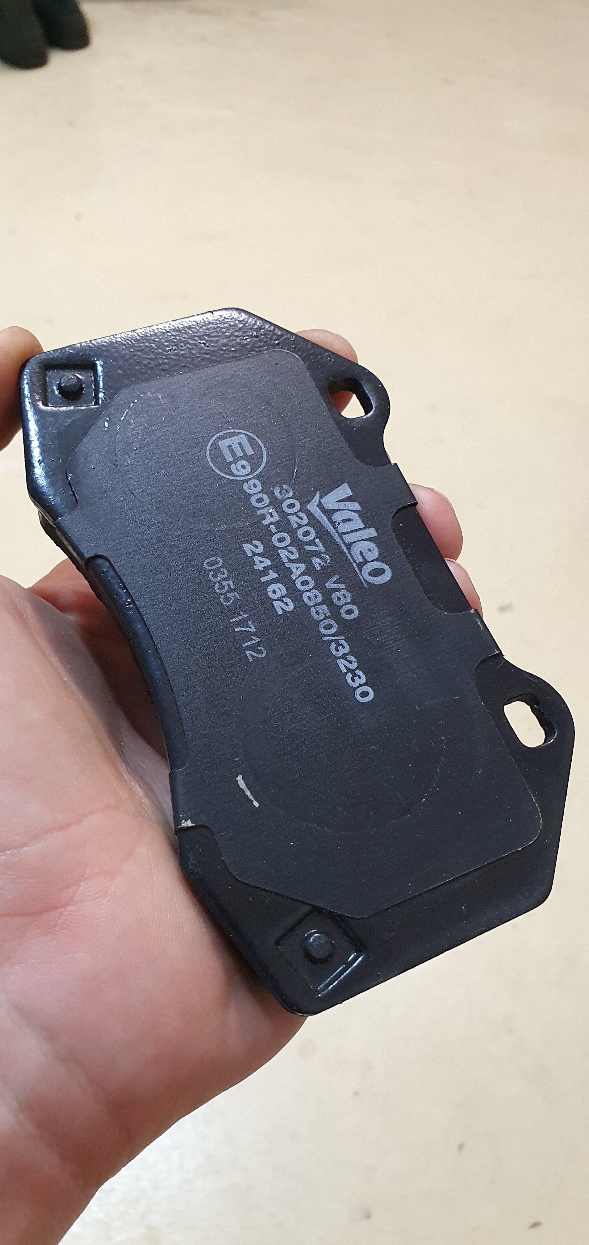

These are the Valeo pads I ran before, they have a backing plate and are chamfered on the edges. None of that helped as I said, exact same noise, exact same side.

I don't know what to suggest unfortunately. If you're adamant it's not the pads, and they're free to move evenly on the pins it can only be misalignment of the calipers from the brackets.
I'd expect the tolerance on the pad and pin to mitigate this though unless it'd VERY bad.
You could chuck some paint on the pad and go for a couple of stops down the road and look for even wear. I'd not suggest it on expensive pads, or for long term.

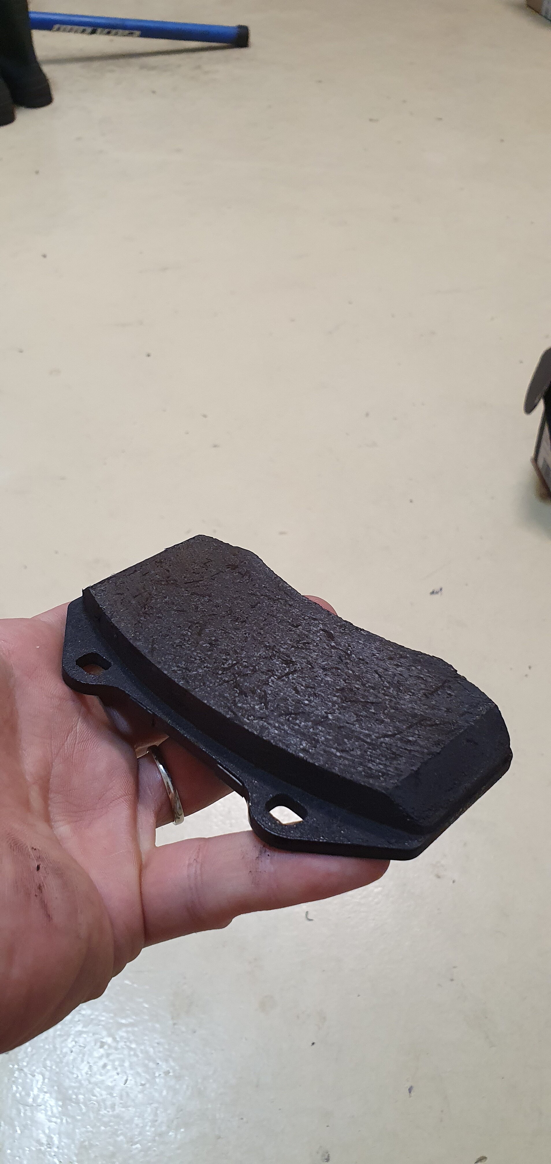

Meanwhile I took a closer look at the DS2500 pads that I recently removed to see if I can find any clues to the noise. And I found that the inside pad from the right caliper is worn unevenly, as if one piston is pressing harder on it than the other on that particular side.

Looks like one of them is "lazy" and doesn't apply enough pressure on the pad, creating that uneven wear. I may also have some air in the caliper? I don't know. I'll redo the job on that caliper and keep you posted.

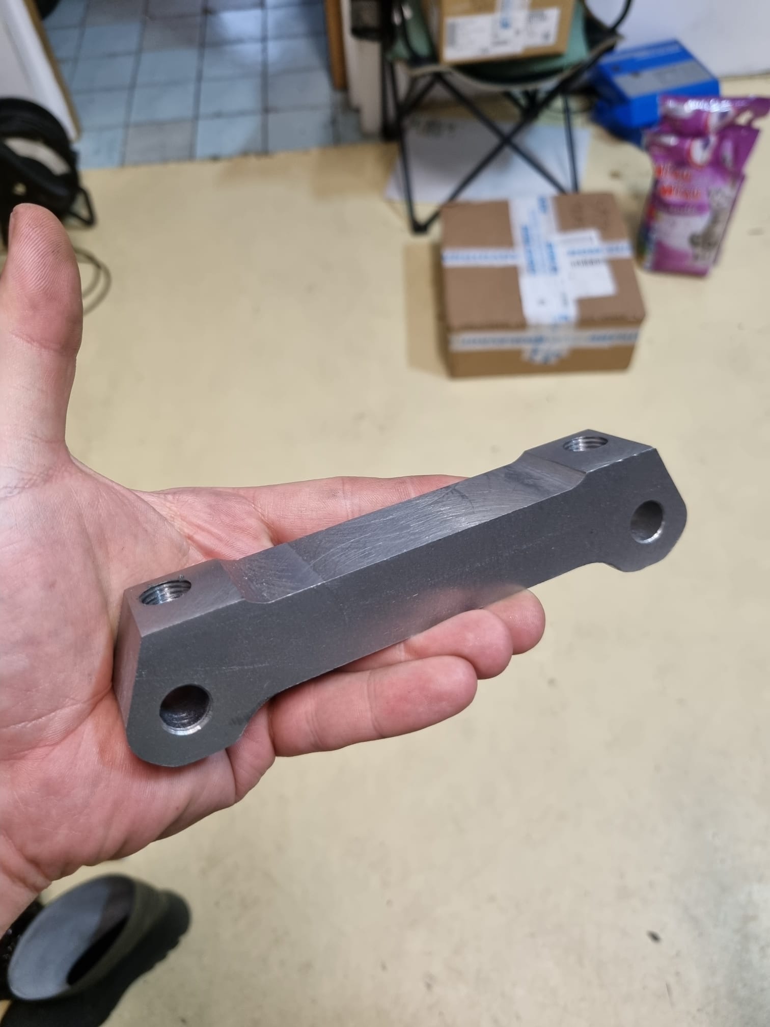

So I decided to finally machine some proper caliper brackets, and because I didn't want to hassle with drilling the calipers to make some "pms style" brackets for the 280mm discs that I have- I went to the 300mm disc route so I took the necessary measurements, made the brackets, bought a new set of 300mm scenic discs and also did some pad spacer/shims to accomodate for the fact that these calipers were made to suit a 28mm thick disc versus the 24mm scenic one so here they are:
WhatsApp Image 2025-05-29 at 17.52.25.jpegWhatsApp Image 2025-05-29 at 17.52.26.jpeg

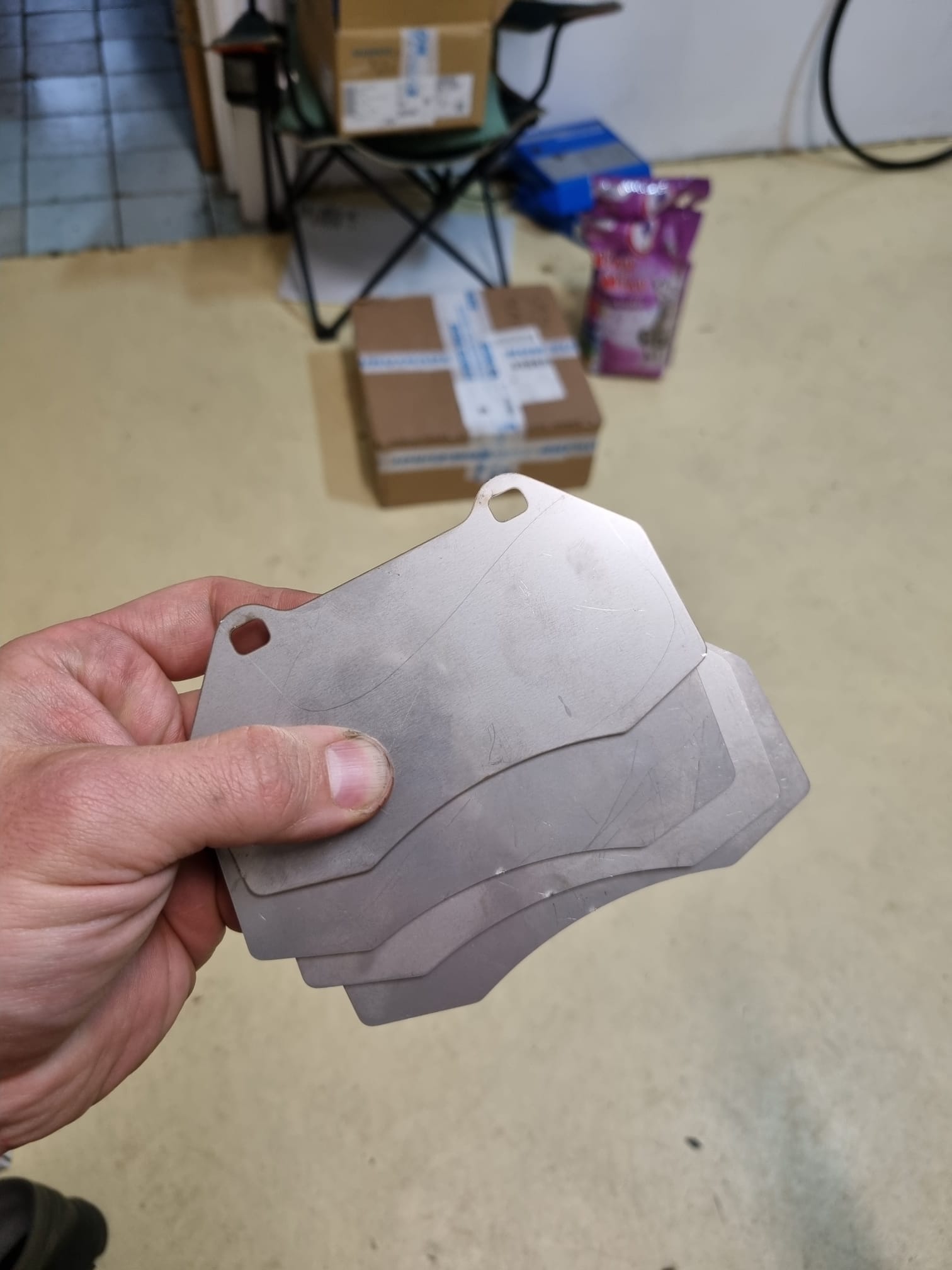

Now, as I get my hopes up once again to get rid of the squeal, I also bought some anti squeal adhesive pads from mintex, they're made of some kind of thick adhesive rubbery tape, anyways...
The question is- should I stick this to the back of the pad itself or to the back of the pad spacer/shim that contacts the pistons?
And final question- as these will be used with the ds2500 pads on the occasional trackday- do they hold up to temp or do they catch fire and I'll be better off without them?
