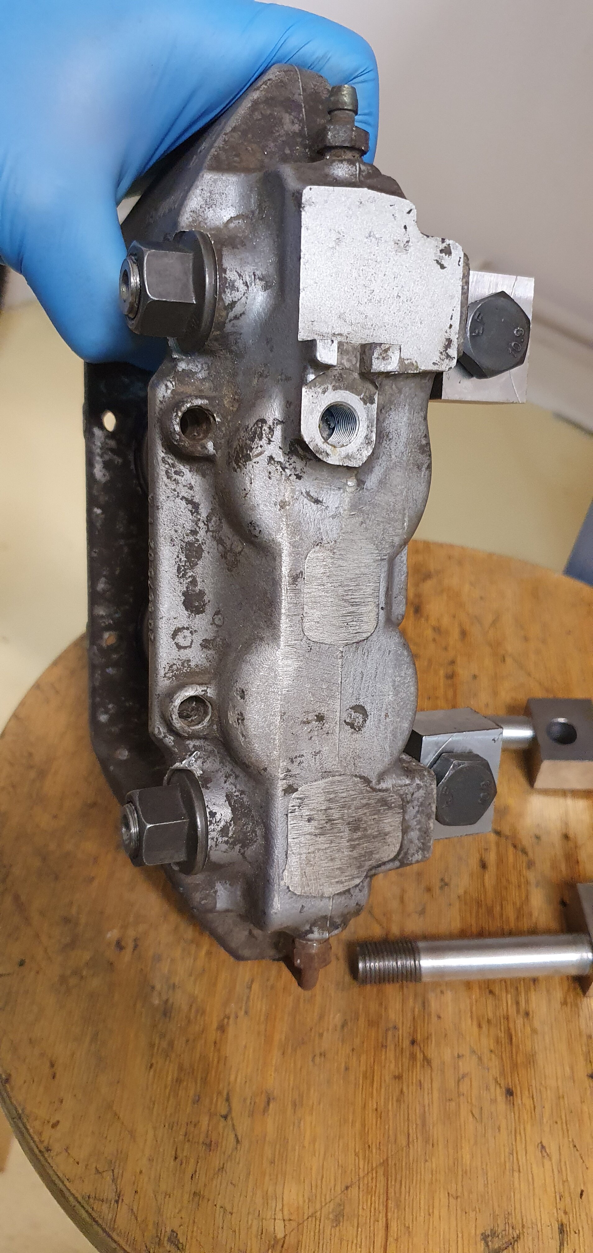

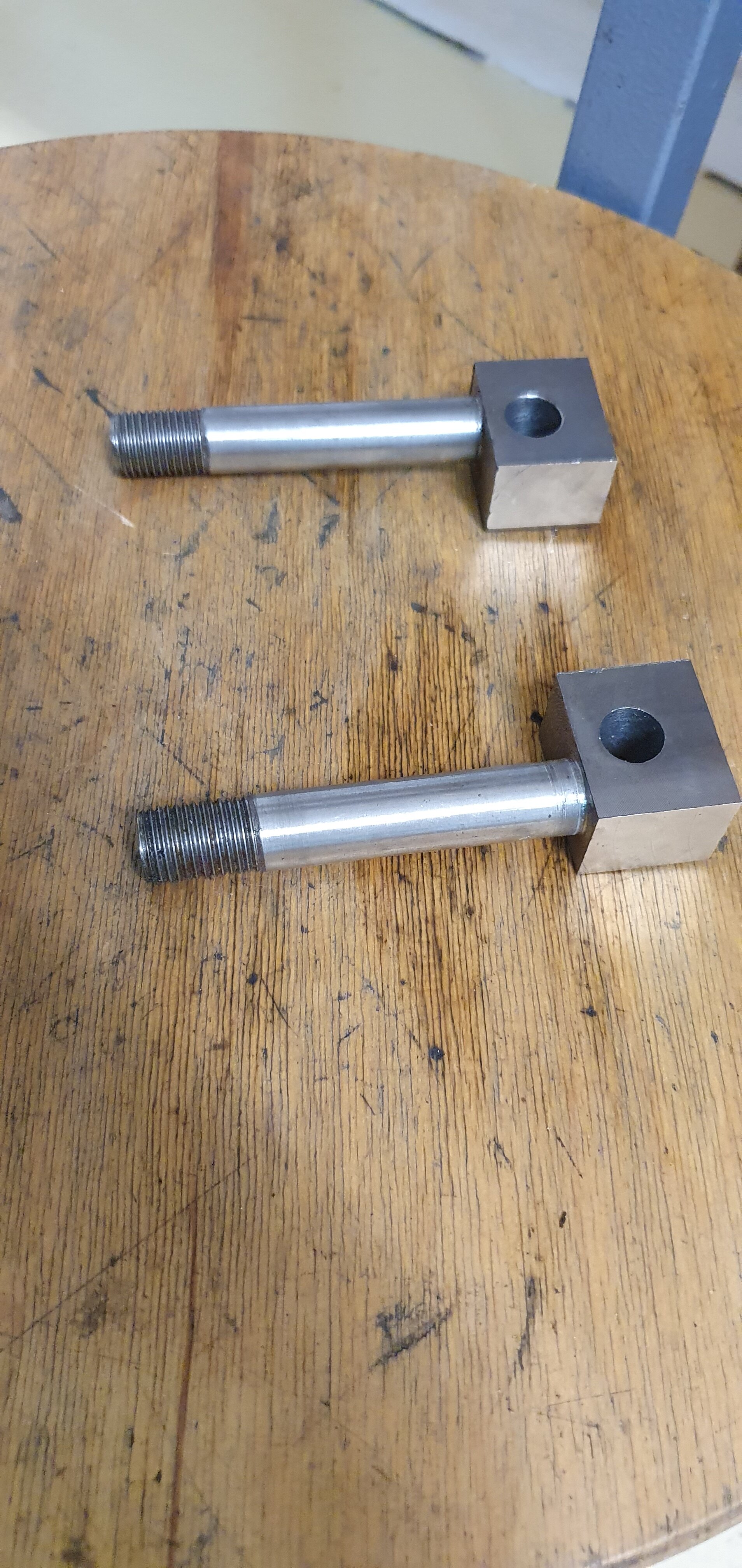

I have some odd adapters custom made, but the calipers sit ok, but will do a re-check to be sure.
They look like this:

You could try to take the pads out, but leave it on the disc, and have someone slowly press the brake to see if all pistons are moving at the same speed, or if one is sticking. Just don’t let them pop out or you’ll have to start over.
I’ve used the frentech service kit - it was absolutely fine so I wouldn’t worry about that at this stage.
Normally the brackets are one piece to give more stiffness. Maybe yours allow the callipers to flex.
I've thought about that but if the nut that holds the caliper to the adapter is tight and then the adapter is tight to the hub there should be literally no flex as the adapter itself is a long bolt that goes through the caliper and then the bolt that secures it to the hub is close to the mating surfaces between caliper and adapter so very little leverage for flexing. Of course I'd rather have them in one piece but I think it should be fine.
Plus, the other side is totally silent, I imagine if there was a design flaw big enough to create a noise that wakes up the whole neibourhood I'd expect it to be present on both sides.
I also marked the bolts and nuts that hold everything in place with white marker paint to observe if anything comes loose. So far so good
They do look quite crap. I wouldn’t want to run them personally.
Switch them side to side. That’ll prove if it is them
They work with the 280 discs without having to drill the calipers like with the PMS kit. I don't know other brackets that can be used without modding the calipers. If you do then let me know. I'll Switch them and see
