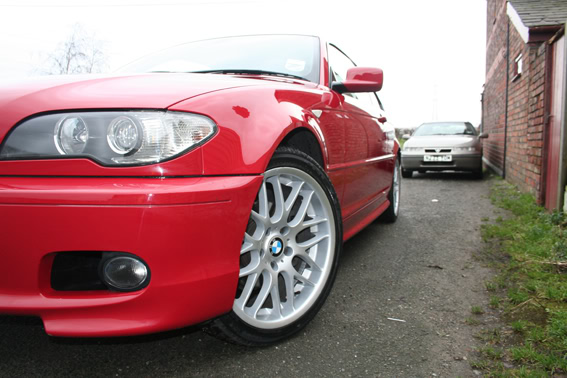

ok took the beemer to the carwash in town for a mini vallet and wash.
dropped her off in the morning and came back to pick up at 5ish (dark)
anyways the car looked smooth as silk .. they had given it a "free" full body polish for my repeat custom.
well the next day as i came out of the office to grap some lunch, the car was side on to the bright sun.. and OMG the paint is fucked. there must be a million swirls, also there is like this wierd shizzle when you look at the paint in differnt angles theres like holagrams in it like deep shadows.
when the light is off it the cars looks fine but as soon as i hit amber street lights or daylight its looks sooo fucked up.
now i have the pc in the garage.
but i have no pads or polish.
what pads do i need?
what polish
a guide would be great.
or if someone wants to do it that would be great lol.
this is the colour. flat imola red
