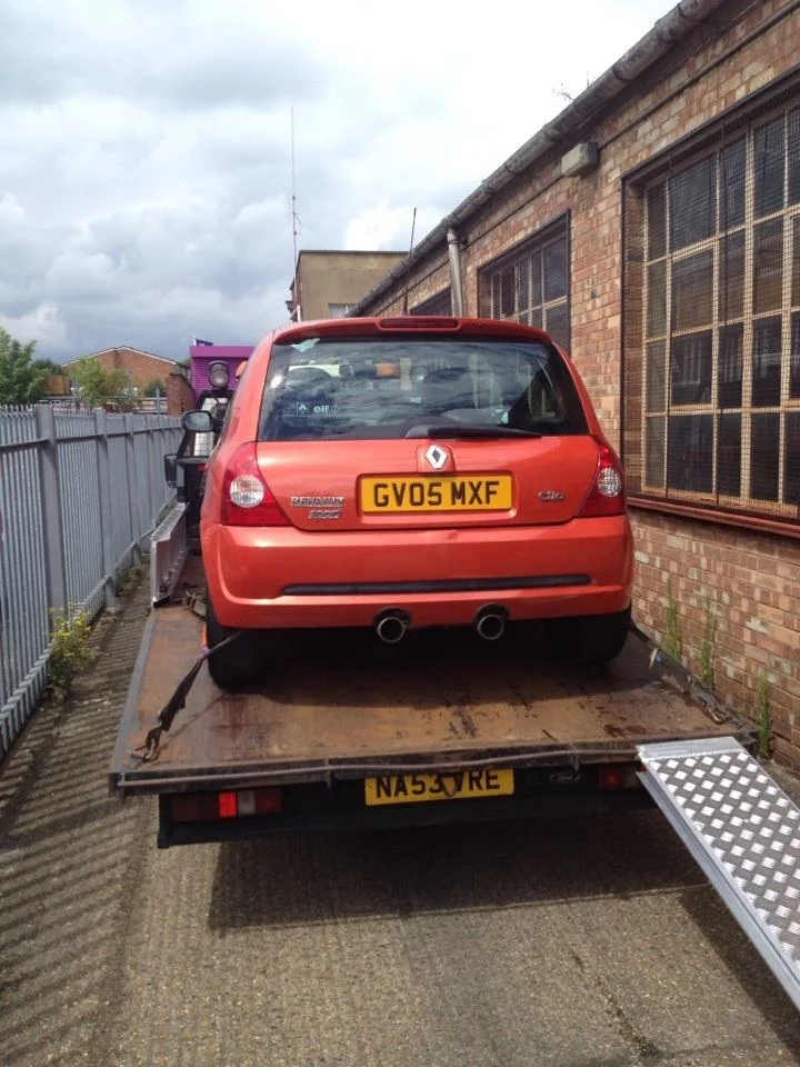

On the way back I met a few mates down at Pitsea flyover then as I went to leave I went to start my engine and It wouldn't start an I heard a small click noise from the bay and I knew it was gona be Cambelt , and had to get it recovered back to my work place in Romford

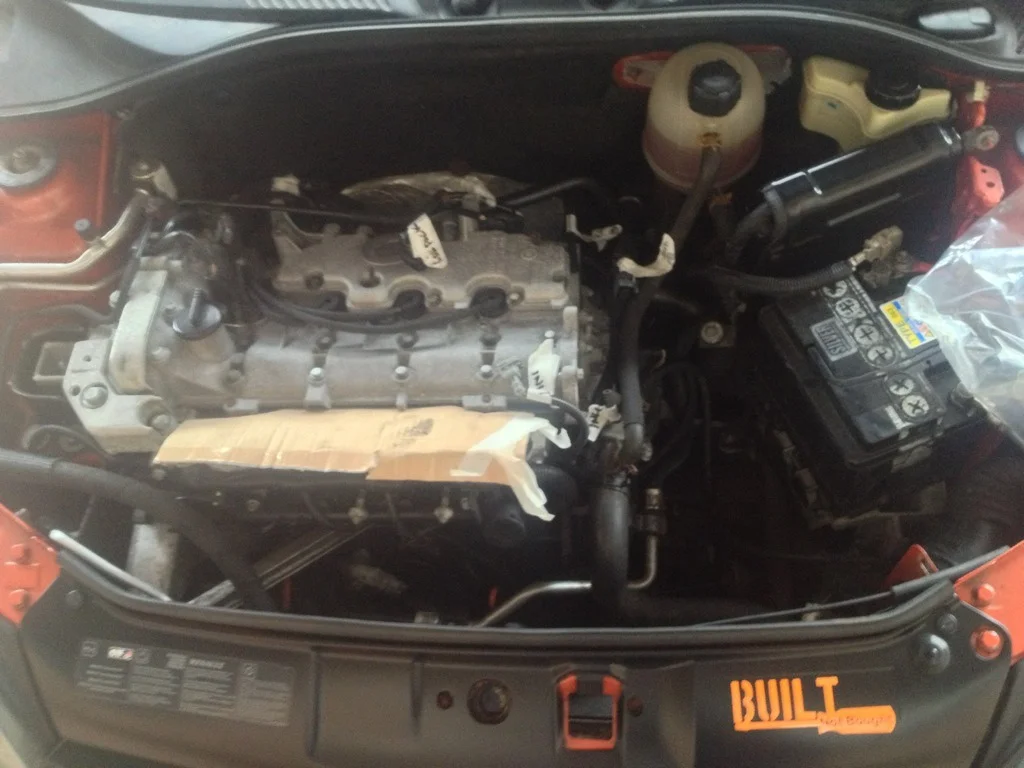

The next morning I went down to work and took the top engine mount off to look at the top of the belt, for a second I was over the moon so happy because it hadn't snapped but then realised the belt must have jumped
Considered either just swap engine over or get the head rebuilt because I have the history of the engine and it was a very low mileage engine so I decided on the head rebuild
So then about 6 weeks later off it went to Engine Dynamics a renault engine specialist in Braintree

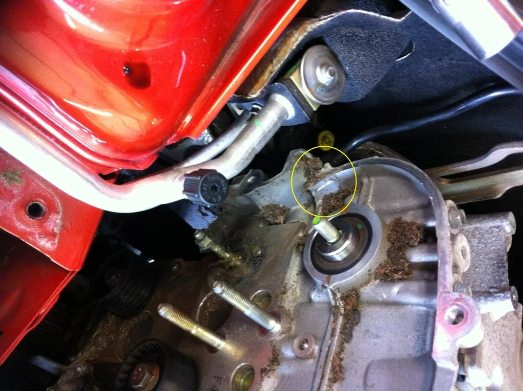

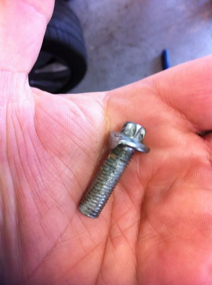

Once he took it all apart he see what happened, it is the most unlucky timing belt failure he had ever seen I'll upload the pics and explain it bit by bit in his words

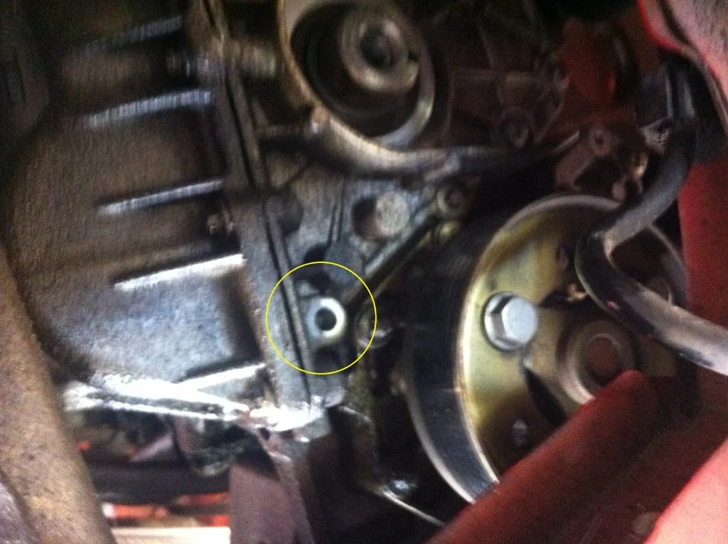

A bolt must have been over tightened from the factory or a flaw in the bolt, it broke and somehow went upwards possibly aided by the aux belt and ended up wedged up in the exhaust can pulley, the bolt originally came from the crank seal housing
The Bolt that cause the problem
It then wedged itself in the circled area causing the belt to jump and then bent 12 valves
Also destroying my cam pulley in the progress
Andy at Engine Dynamics then fully rebuilt and refurbished my cylinder head, and done the obvious stuff like belts and pulleys, he also replaced my leaking PAS rack and I got him to put a performance map with over run on my car

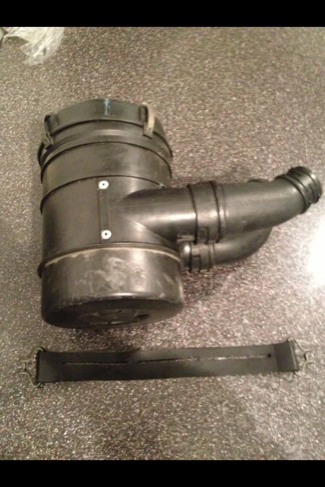

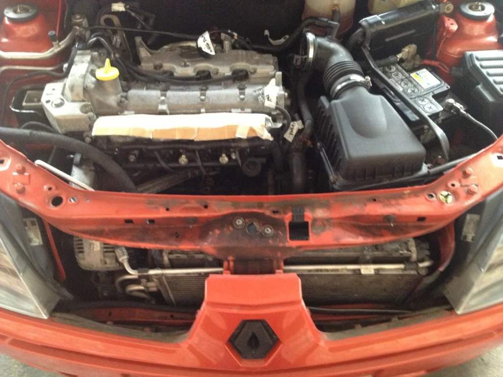

I bought a Ph1 air box(going to be painted) and a piperX filter insert for the air box

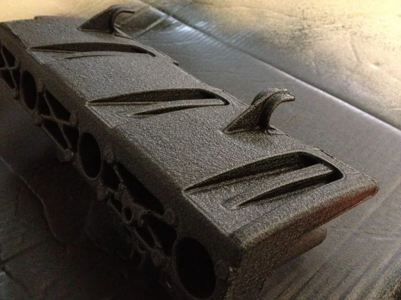

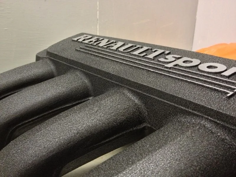

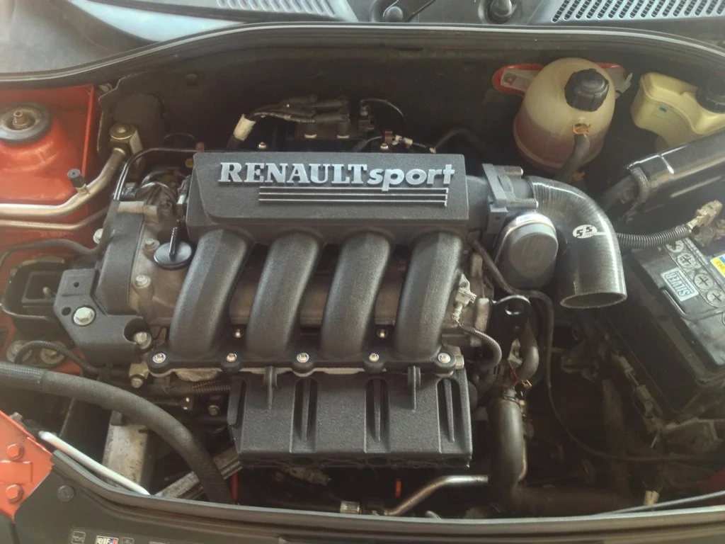

Took my inlet and other bits off to be painted

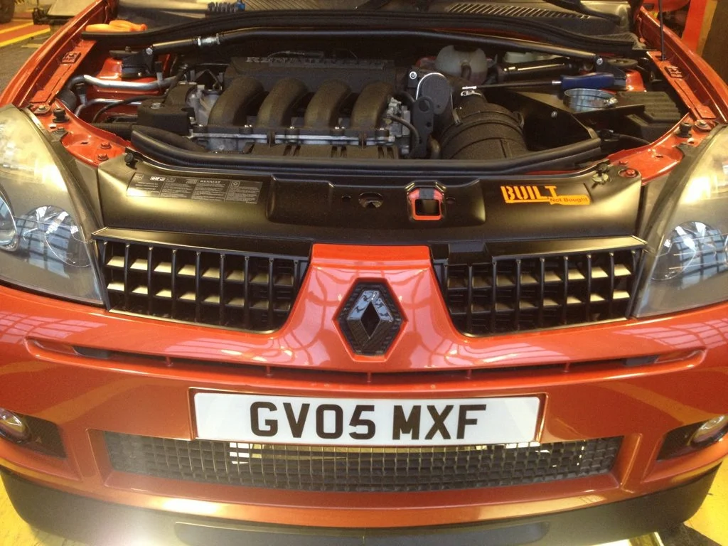

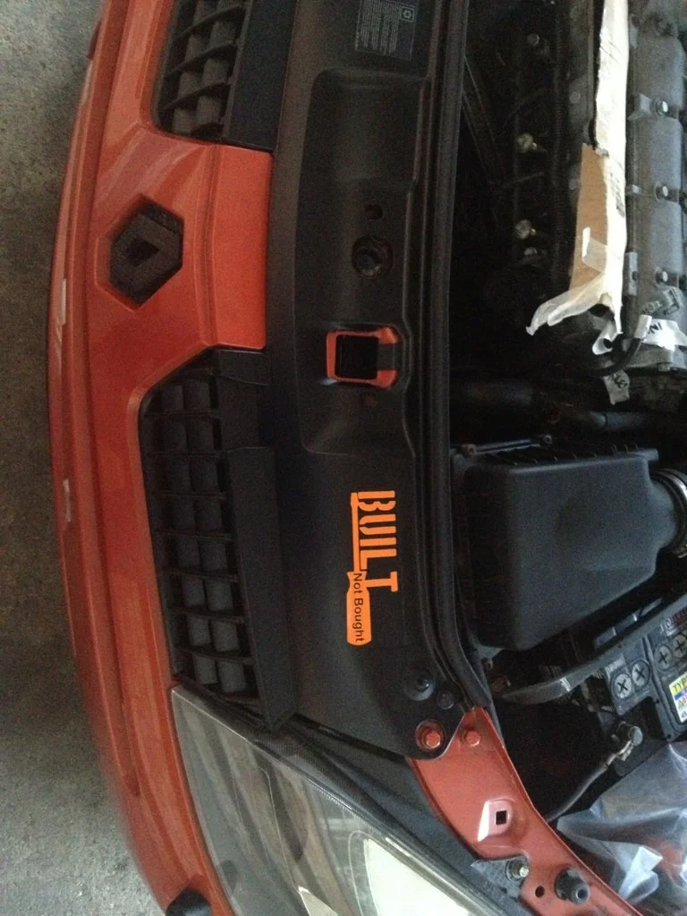

Once the grille was painted I refitted it and added a sticker to the small recess

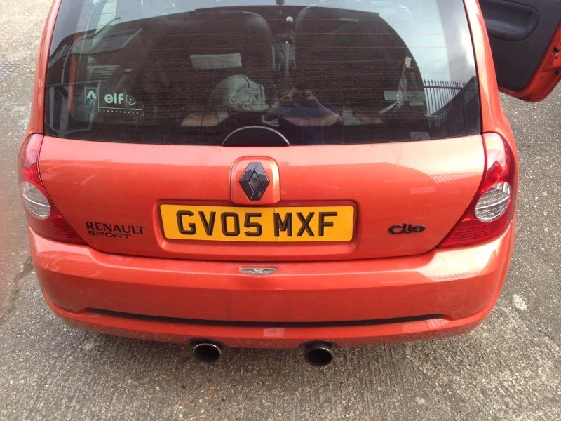

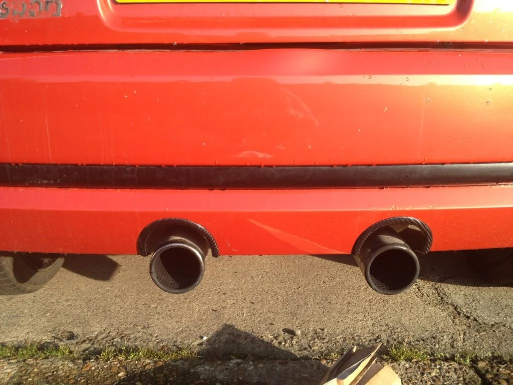

My exhaust melted my trims so I've replaced them with carbon ones and painted the rear plastic bumped trim

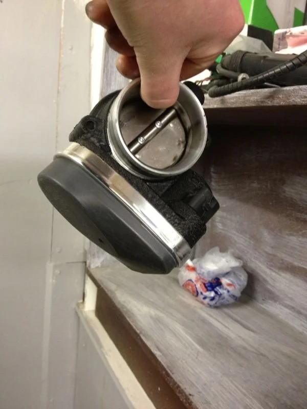

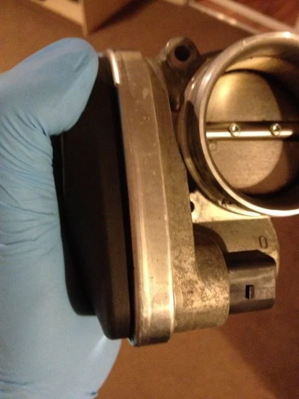

Polished my throttle body :)

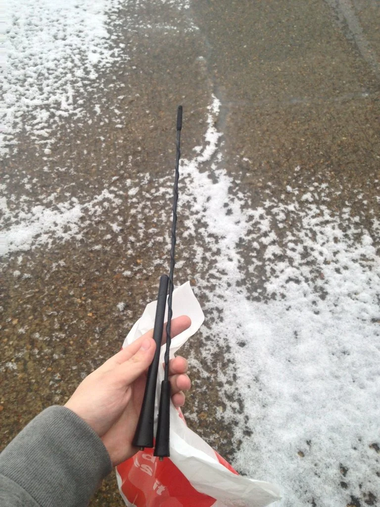

Got a civic type R aerial

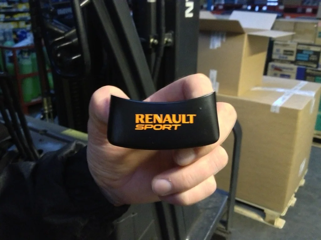

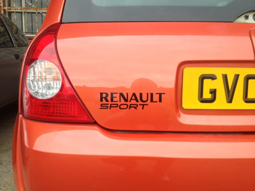

Black 197 style renaultsport rear sticker instead of standard badge

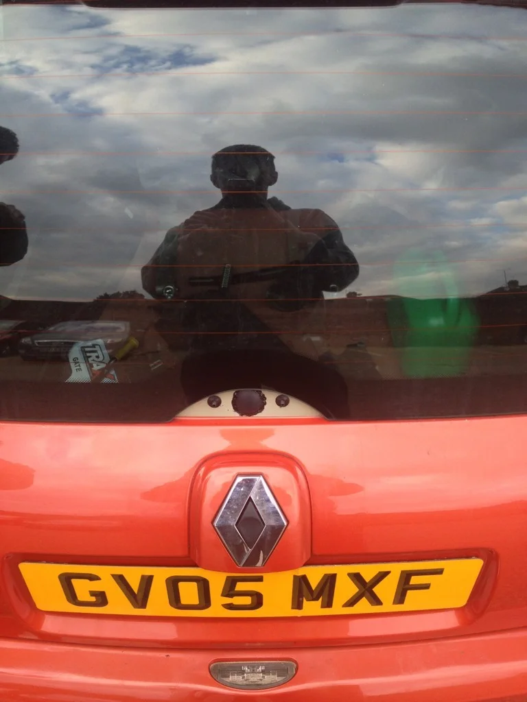

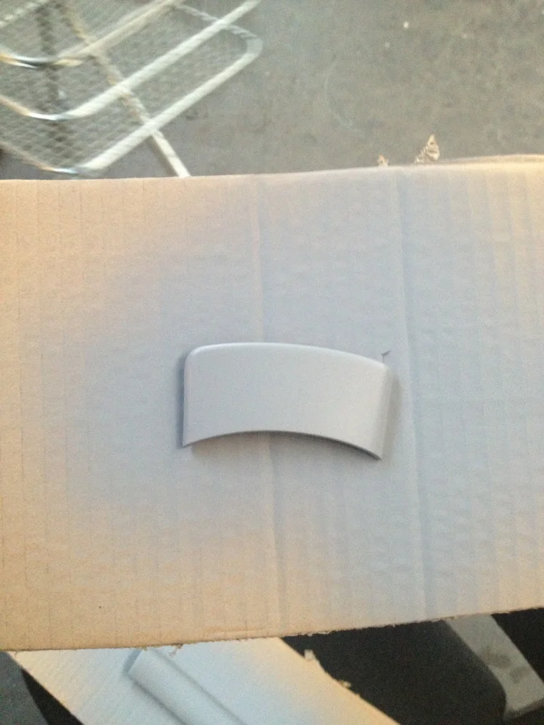

Rear wiper removed and sealed properly then blank fitted

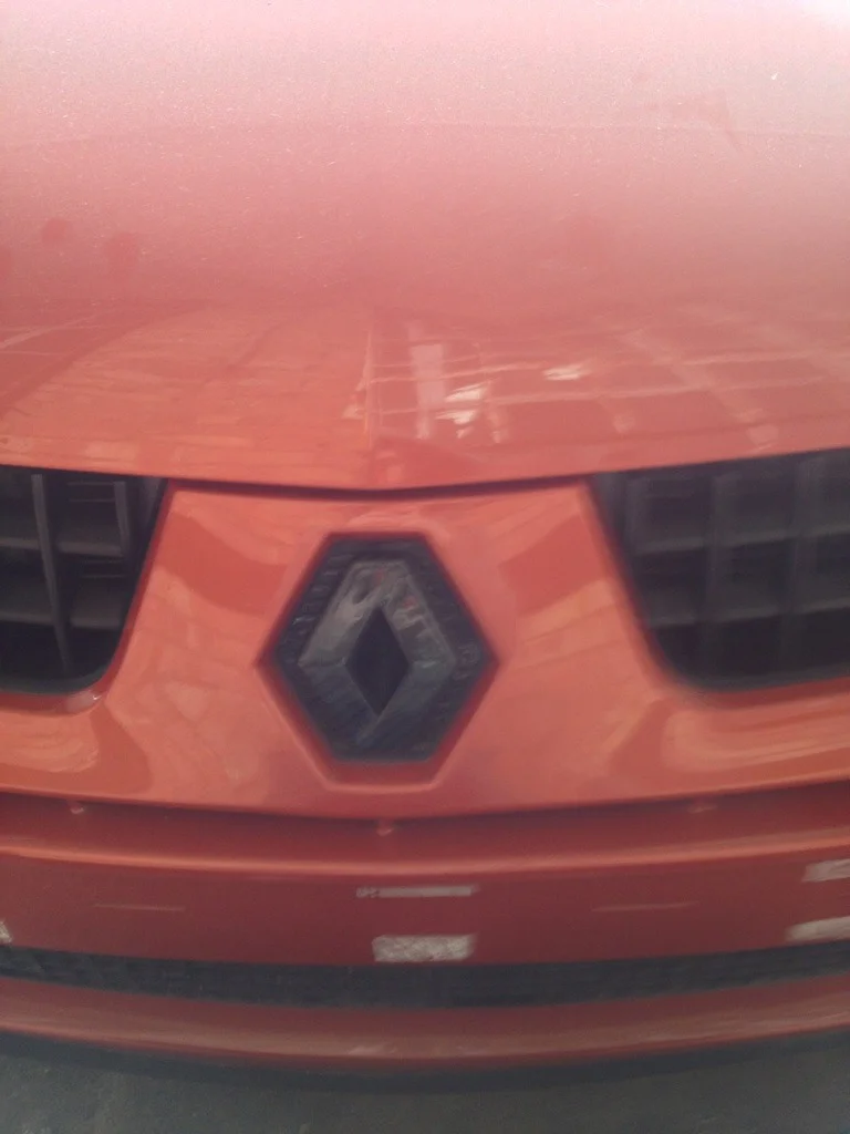

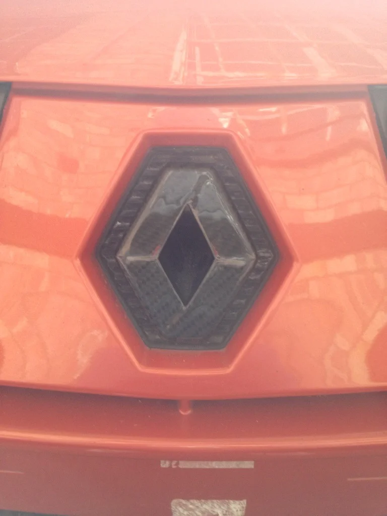

Genuine Carbon front badge to replace my old wrapped one

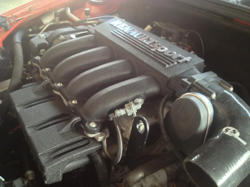

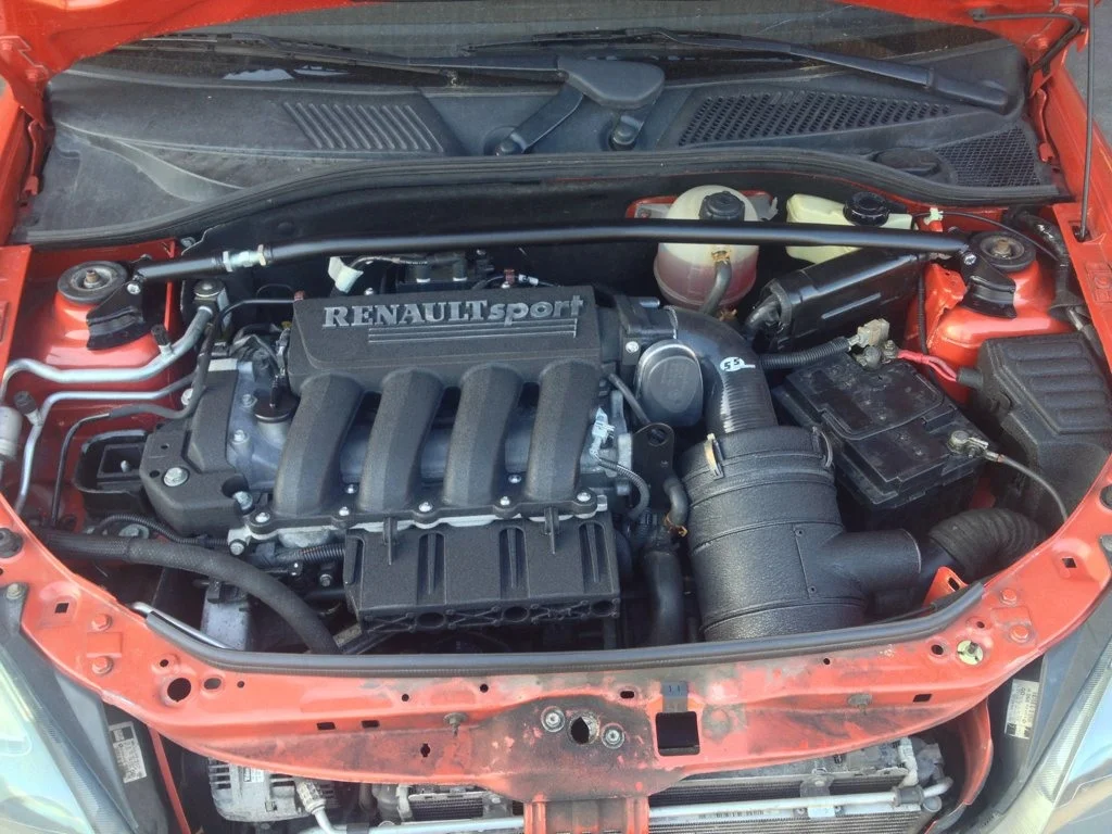

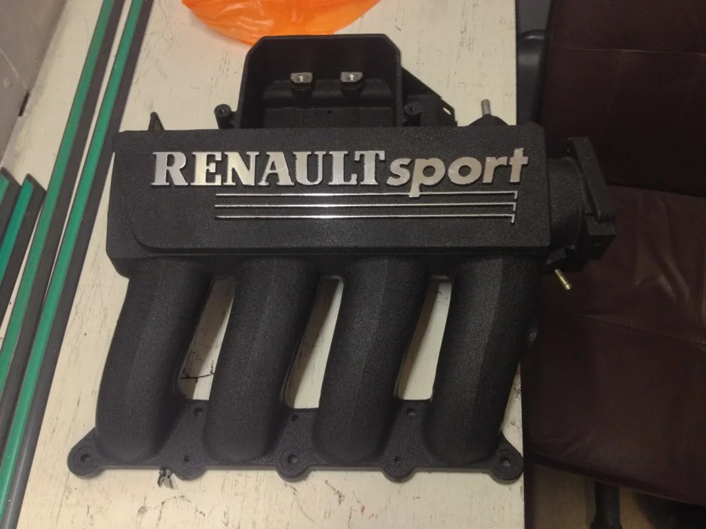

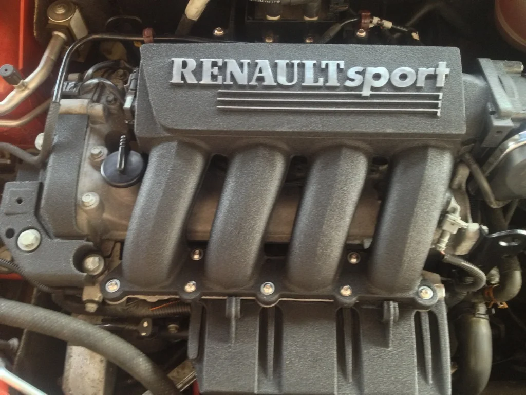

my inlet, engine mount and throttle body was painted Crackle Black and my engine hooks and oil cap were painted satin black I fitted back to my car today along with my SFS Silicone bend

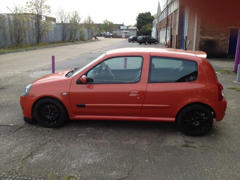

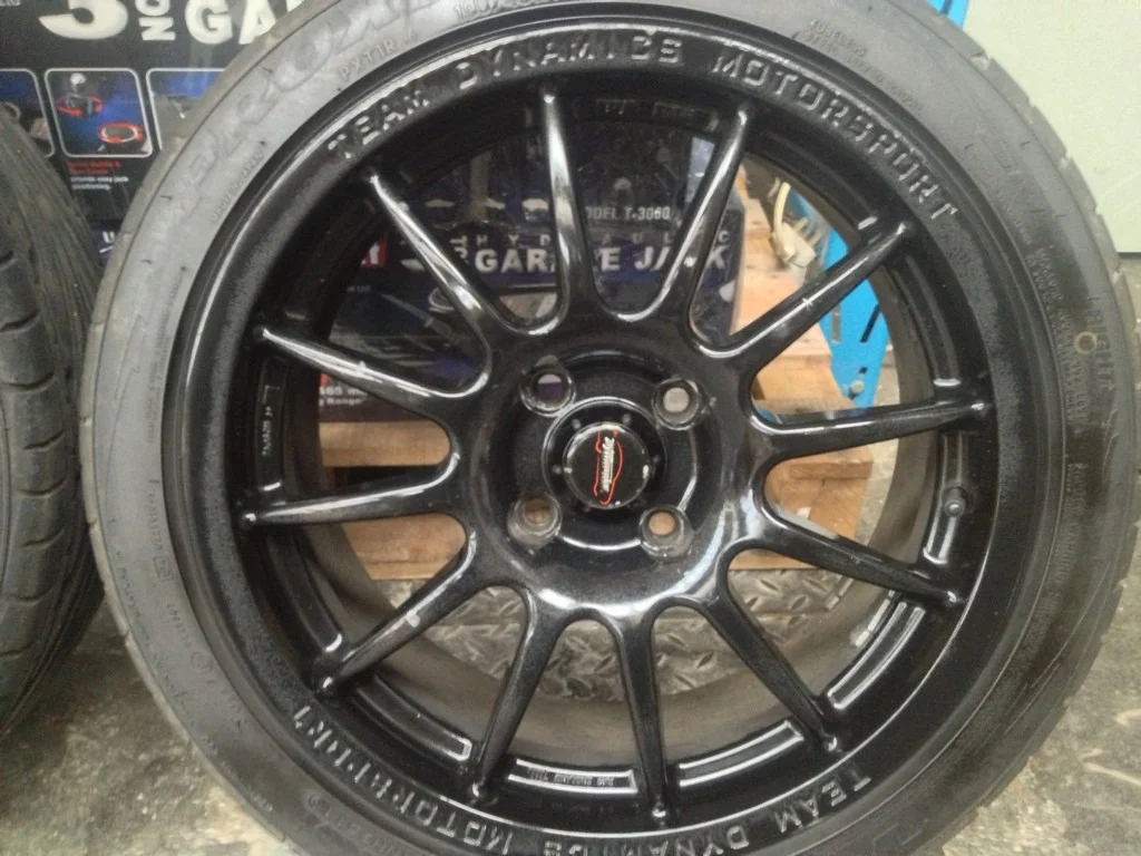

Bought some black pro race 1.2s from someone on the forum with new toyo tyres

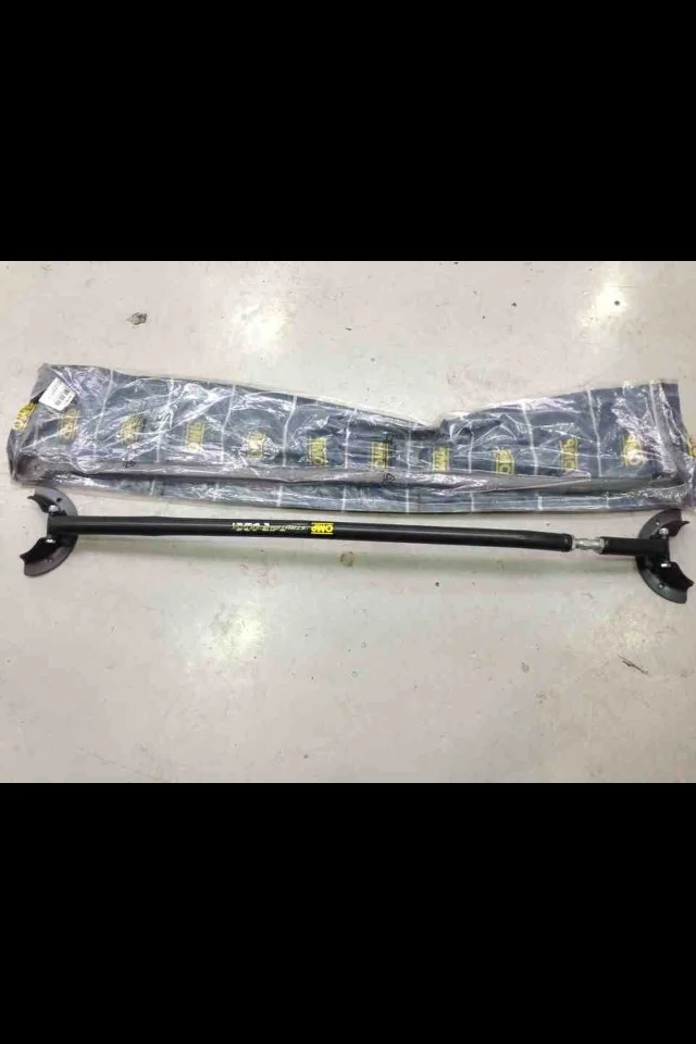

Bought some strut braces front and rear from eBay, thought they were black but when they arrived they was anthracite so they've been painted satin black too

Looks good mate, where did you get that rear wiper blank?
Im just using a grommet and it doesn't look as nice as yours! :)

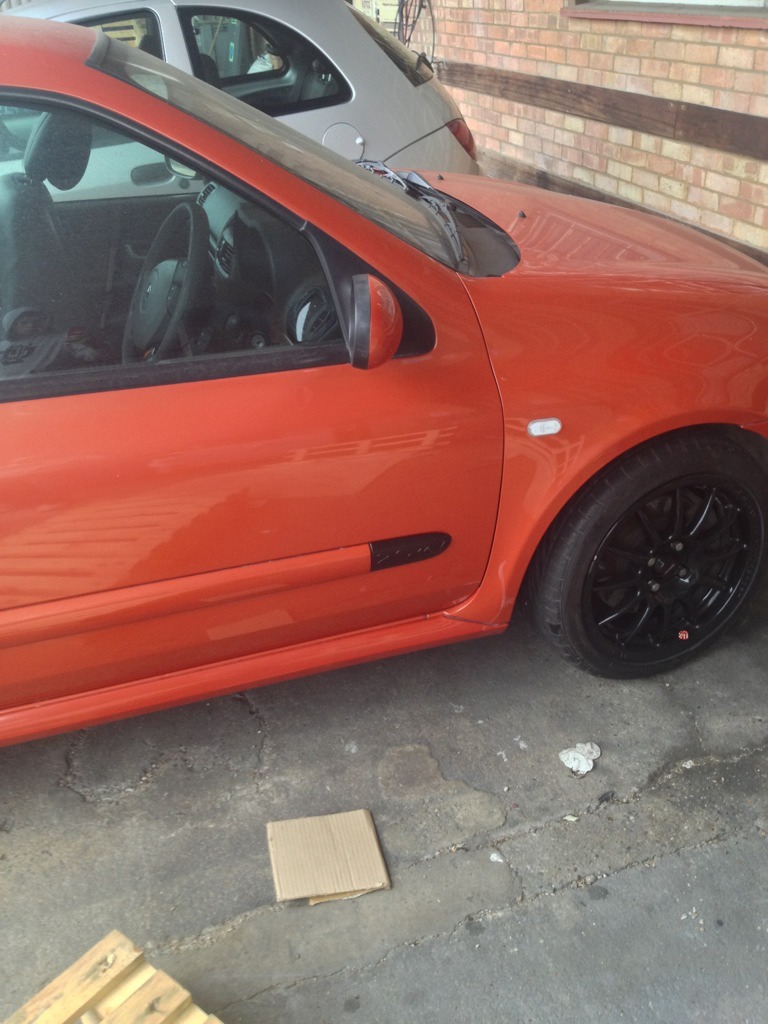

Black door bullets fitted :)
Please excuse how dirty it is at the moment it's been off the road for months and needs a good clean,

Yeh you can spray it with any VHT paint doesn't have to be crackle paint I think I'm the only person on the forum to use crackle paint, mainly because its not very well known and also because it has to be painted in a particular way and then heated up a lot which makes it a pain to paint, just make sure your wire brush it an clean it up first

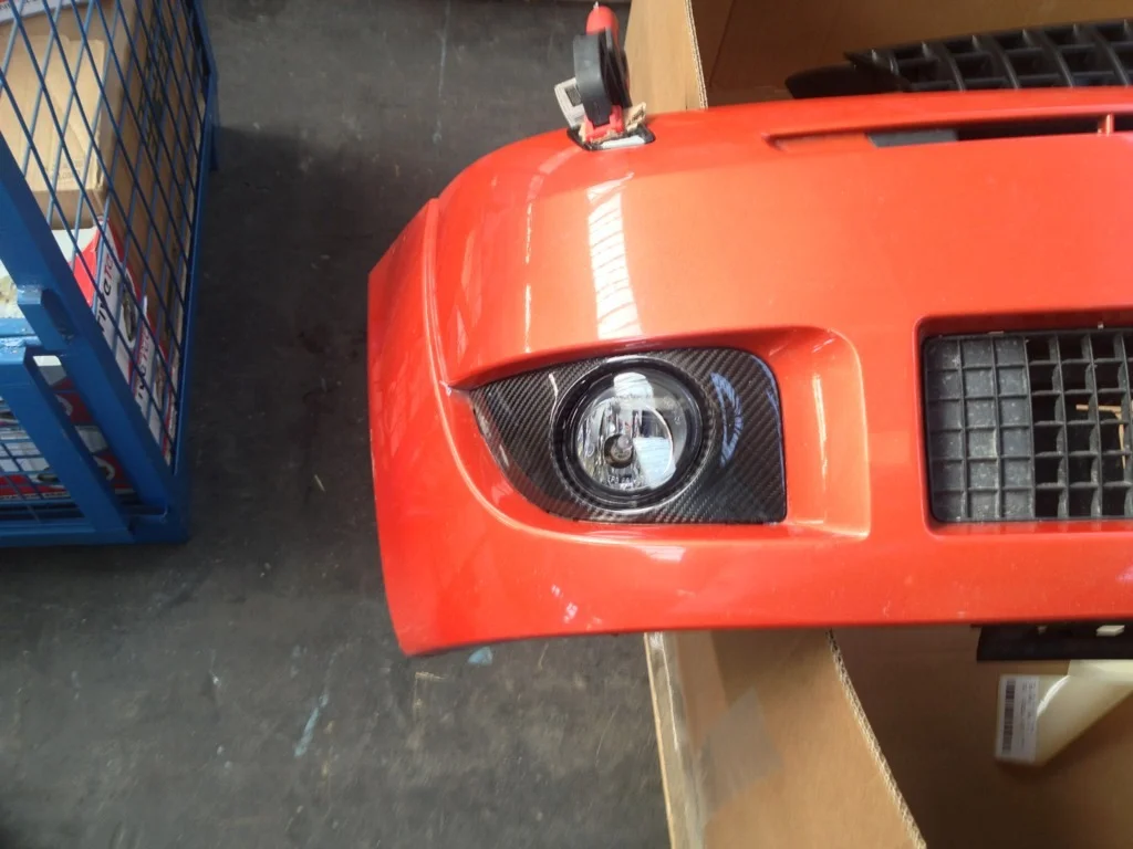

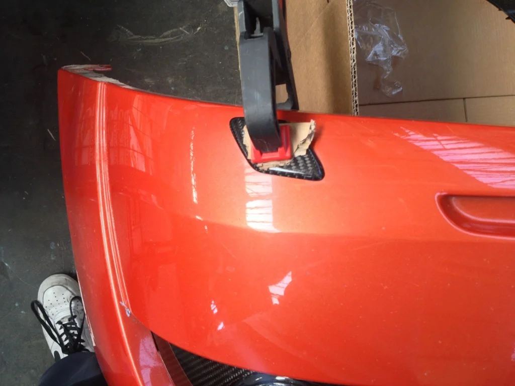

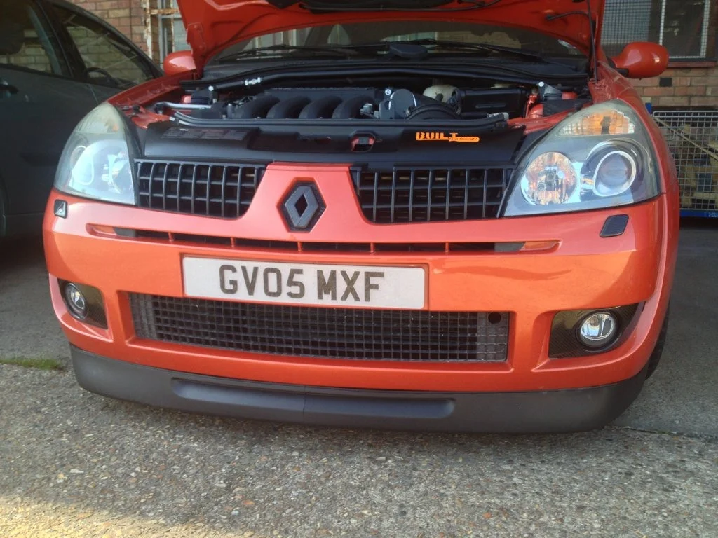

Bumper off so I can do a few bits,
Removing headlight washers, blanking headlight washer pipes, fitting carbon headlight washer blanks, clean bumper up, clean everything behind the bumper, change a fog light as one of mine has a crack, fit headlight carbon fog surrounds and few other little bits too

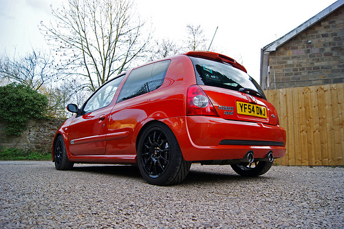

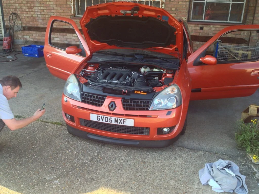

Car is now on the road
Ph1 airbox on
Carbon fog lights on
Carbon washer blanks on
New splitter was short lived but here you go
Lowered on cooksports
Carbon rear badge fitted

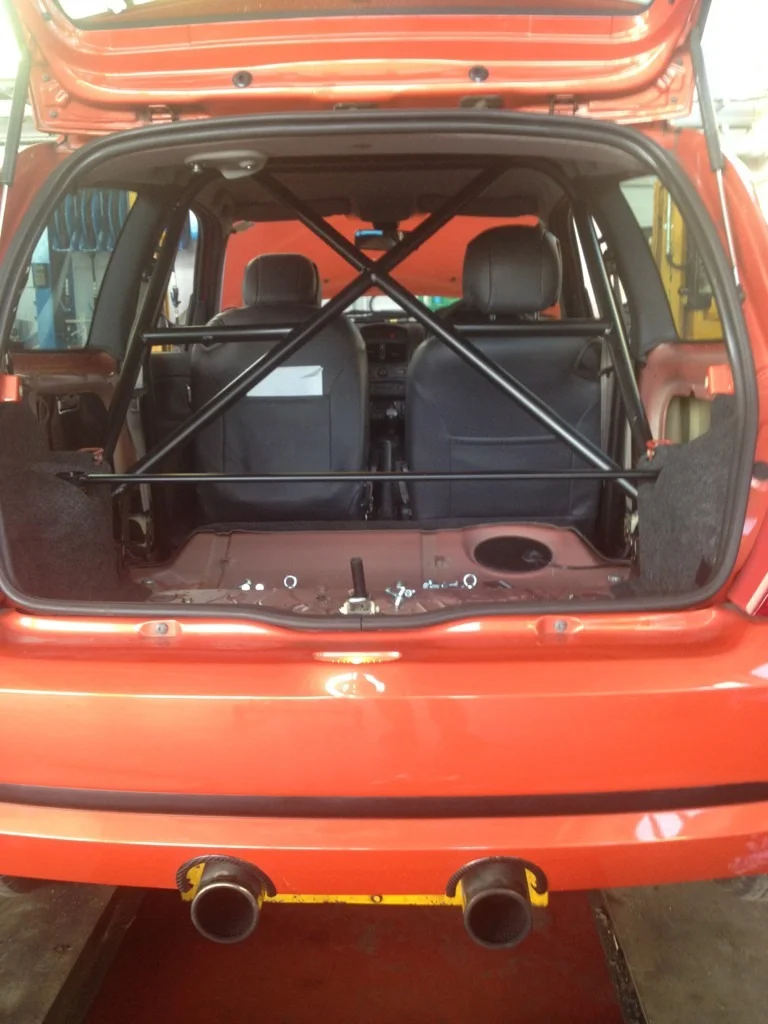

Roll cage and rear strut brace fitted :)

Have you got a guide to what you did and parts you used to remove the old headlight washers and fit blanks. I've bought some off here and ill be spraying and bonding them into my bumper like you have done.
​Car looks good too :) Like that front splitter a lot but you can see why it didnt last long!
  Clio 182 FF inferno
Sorry I haven't but its really easy you need to remove the bumper which is 2 clips at top of grill(flat head screw driver), 2 10mm bolts under the arch liner in the top corner of the bumper(1 each side), few torx screws underneath and at the side of the bumper(1 at each side and then I think 2 on the bottom each side) and 2 10mm bolts on the black bit underneath too then pull the bumper each side away from the wing it's 3 Clips you'll hear undo themselves, once that's done dont pull the bumper too far you have to disconnect the fog lights which is one plug on the passenger side then pull the bumper away and pull the hoses off the washer jets and out of bumper and undo the back of the washer jet with I think it was a 20mm spanner and they come straight off, then what I done with the hose was when the bumper was off you can see right in the corner near the Passenger side wheel where the 2 hoses have joins in them, I removed all the hose up to there then connected them to each other with a small cut off bit of tube from what I'd removed, it's really simple when you have bumper off, a lot easier then you would think, when you do it if you get stuck send me a message and I'll draw a picture up for you
