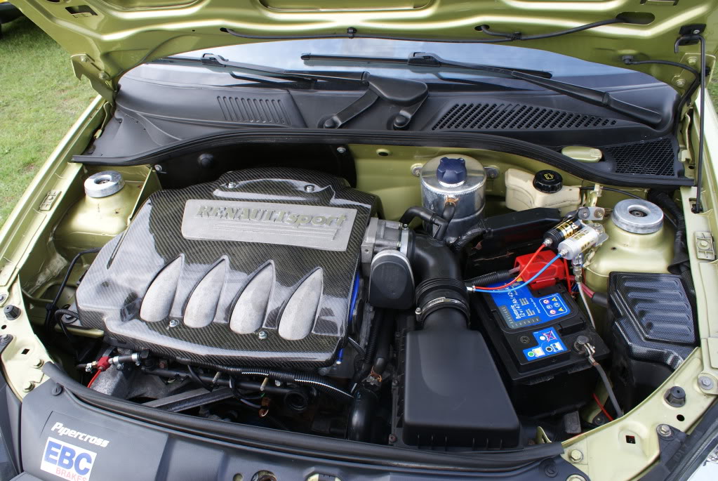

Well I've had this for a while now, as some may have seen at Trax this year but so far haven't put any pics up yet...
One of my favourite bits...

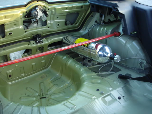

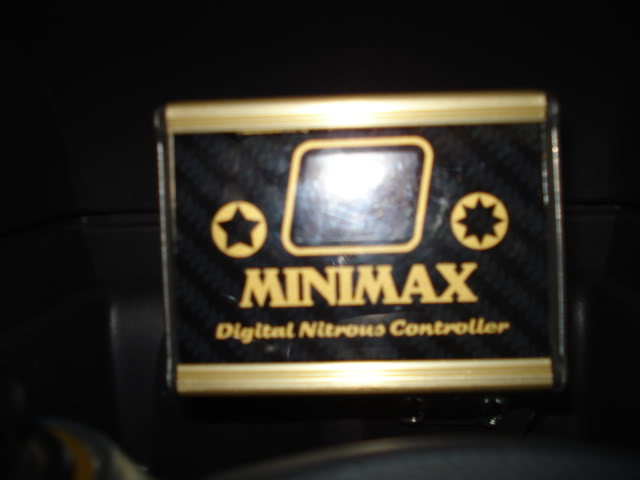

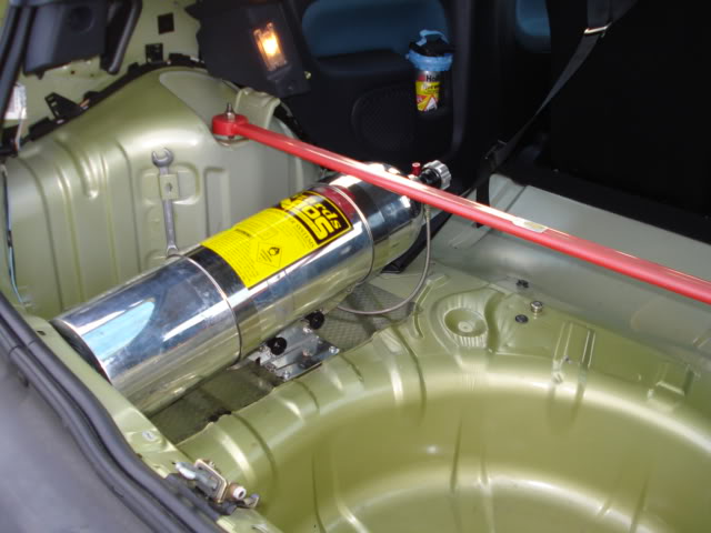

The kit is a 50bhp wet shot of Nitrous all kept in a 12lb shiny bottle :D and running alongside it I have a Minimax progressive controller.
So far I haven't been able to fully appreciate the system but from what I have seen it's brilliant. There's a very noticeable kick when it first starts and then it's pretty quick from there. I'm looking forward to the RWYB at Santa Pod soon so I can have a proper go!
It means that on NOS i'm running 220bhp so I'm more than happy with the kit :cool:

Is this not a sure fire way to make the engine go bang?

They say that these engines can take 65-70 shots but I thought I'd keep it safe and go for 50bhp. The controller means the nitrous is progressively introduced so it's not one big strain on the engine. At the moment I have mine set so that it's slowly injected for 4 seconds and by the time I reach 4 seconds I'm getting the full 50bhp.

You're lucky that hundred shot of NOS didn't blow the welds on the intake! ;) love this car! get some videos of it in action :)

£60 to fill up and a bottle that size holds 4.5mins but when you're only using it for 15 seconds at a time it's more than enough.

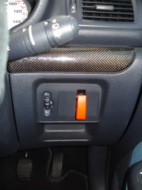

Will try and sort one out next meet Rob! It only comes in when the throttle is floored so I can switch it on and drive normally and then as soon as it's needed floor it :)

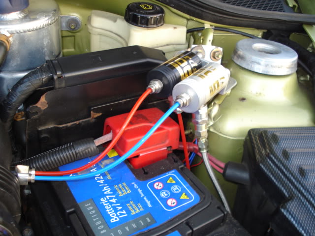

Flammable liquid + live end of the battery terminal together = alittle scarey for me!
Tidy car though, but couldn't you have removed the sound deadening it's bolted onto seeing as it's on a diet anyways?
I let the company who fitted the kit decide where it was put as I wanted it where it would be best and they stuck the mount there, know what you mean though would be nice to get rid.

Not sure i would be happy running it myself though untill i fully understood it and the safety behind it.
Might be way wrong but surely in a heavy rear end accident thats a bomb in the boot?
