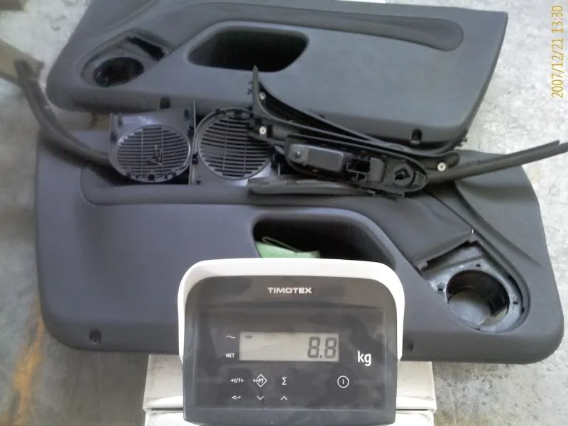

My latest weight saving mod...
MarkCup
Only seems like a small amount, but the change in charcter of the car is HUGE :approve:
Louder, coarser, more fidgety, tyre whine, exhaust drone, and quicker (obviously) - goodbye to 8.8 kgs of waste...

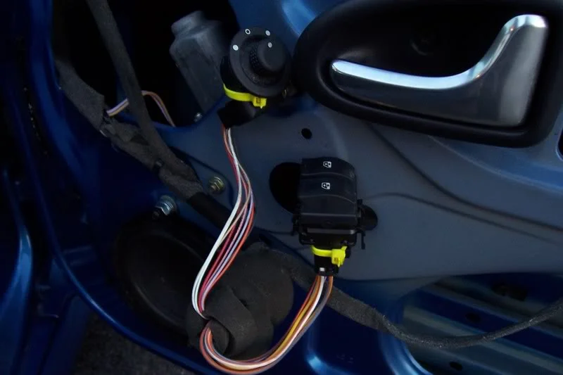

Also, a big thumbs up to Dave at Rentech for his handywork with a few cable ties :D
For the record I chucked a 16" Turini on the scales too, and with a worn-to-the-indicator 205/45/16 fitted it weighed 17kgs dead.

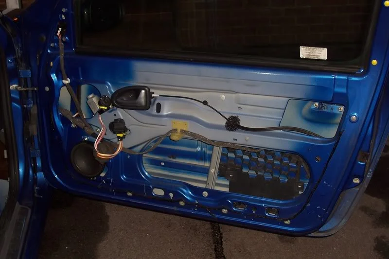

Liking the ghetto doors Mark :cool:
Get the electric windows out and swap them for winders ;)

have you stripped out the back already, must be a fair abount of weight in the rear plastics.
so whats next persepx rear windows? no roof liner, no passenger seat?

Good work, just looks a bit messy with the cables etc showing.
You've not seen my car then - grime, filth, stone chips, swirl marks, bright yellow badly chipped wheels - looks are last on my list LOL
