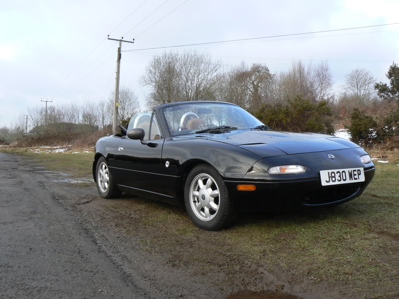

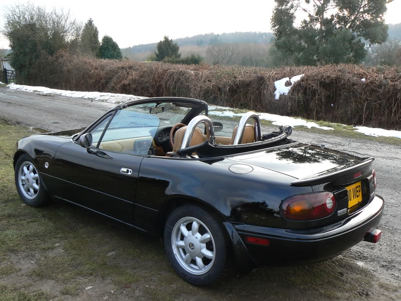

I started looking for a suitable donor car and settled on a 1992 Eunos Roadster V Spec as it had some nice bits that I could sell to recoup some money. Unfortunately due to personal circumstance I had to delay the build of the car. I looked at selling the Eunos to free up some space, I however decided to keep it as a weekend driver after I realised how awesome it is on the road. Some pics of it from early this year.

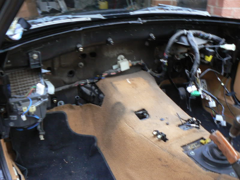

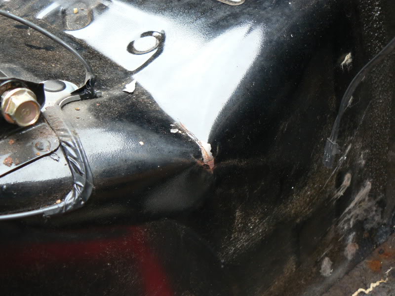

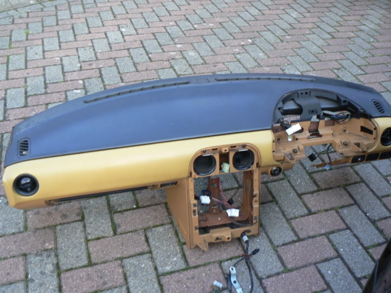

I started to take the interior out so I could sell all the bits I don’t need and start planning. I took the dash, seats and carpet out which revealed some interesting battle scars.
Dash removed. I don’t think the original owner would like this very much. lol
We thought this might have been due to accident damage but we couldn’t find any other marks to support this theory. All the panel gaps were perfect with no other damage.

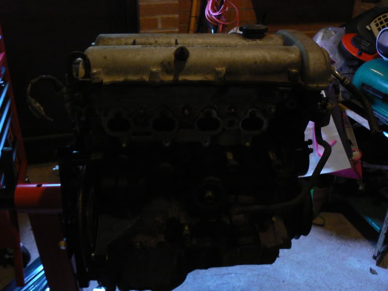

I managed to get a 70k miles engine out of a written off UK MX-5 from the local MX-5 specialist. It was delivered in the back of a van as I didn’t want it in my car and left on the garage floor as I didn’t have bolts of the correct length. I sourced some bolts the same day and after some heaving lifting we got it onto the stand (I did the most important job of supervising while the others lifted it;)).
The engine is now sitting in the garage ready to go off to the machine shop for some improvements and will hopefully be back soon so it can go back together.

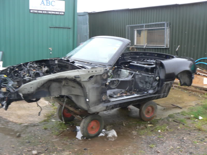

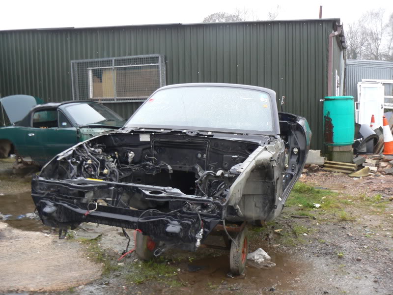

After we went over every part of the shell we discovered when it had an accident on the front N/S it bent the shell upwards on that corner. The repair on the car was a high standard but somehow they missed this. With an uneven ride height it would mean the setup would be extremely awkward and thus I decided to transplant everything I need into a straight shell.
Progress is slow at the moment but should speed up next month when I get the new shell.

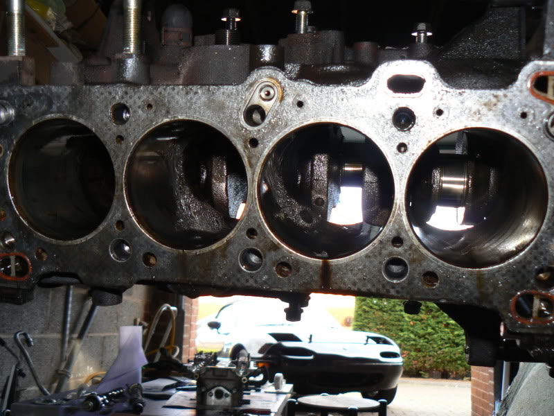

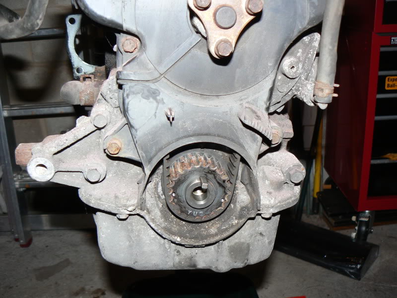

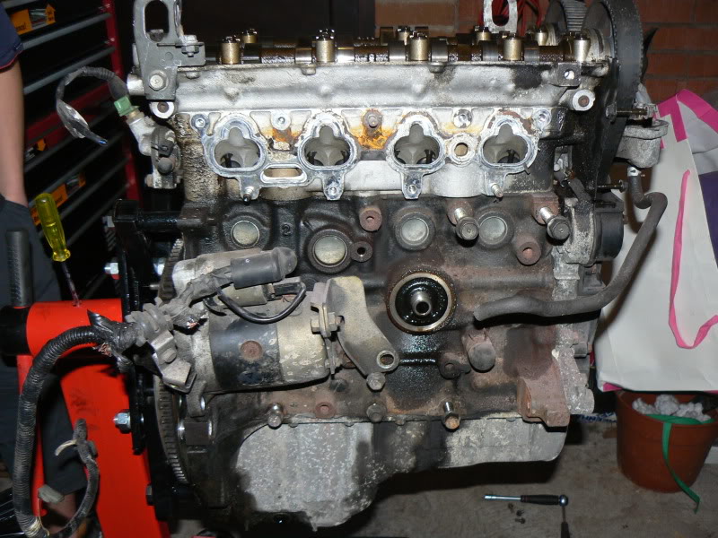

Uploaded more pics from the engine strip down.

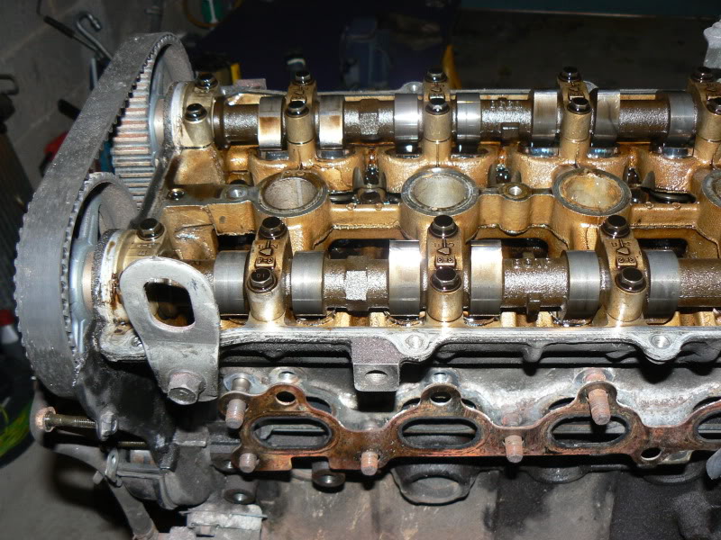

Cambelt, tensioners and pulleys removed

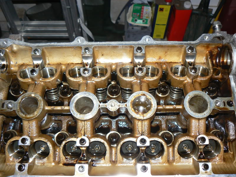

Cams and lifters removed after I realised I'm a moron.lol
Removed the head and onto my temporary workbench.
Still going smoothly.

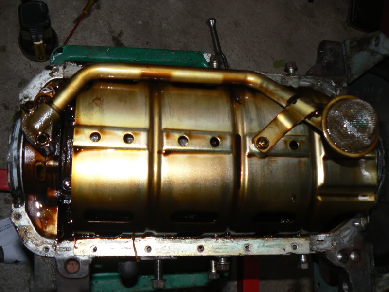

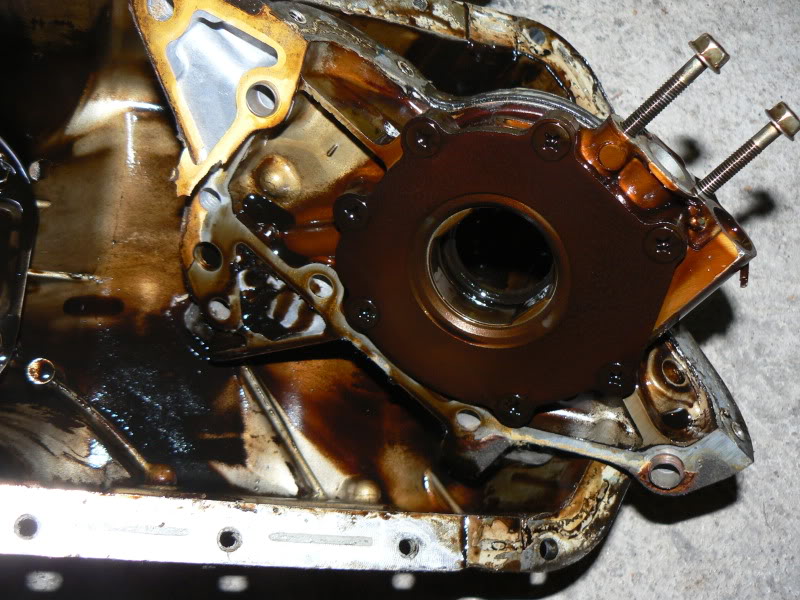

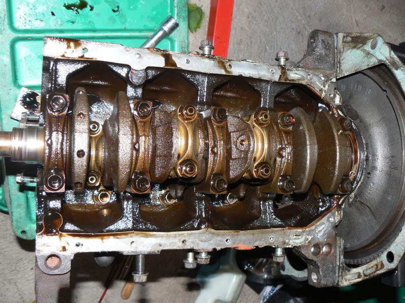

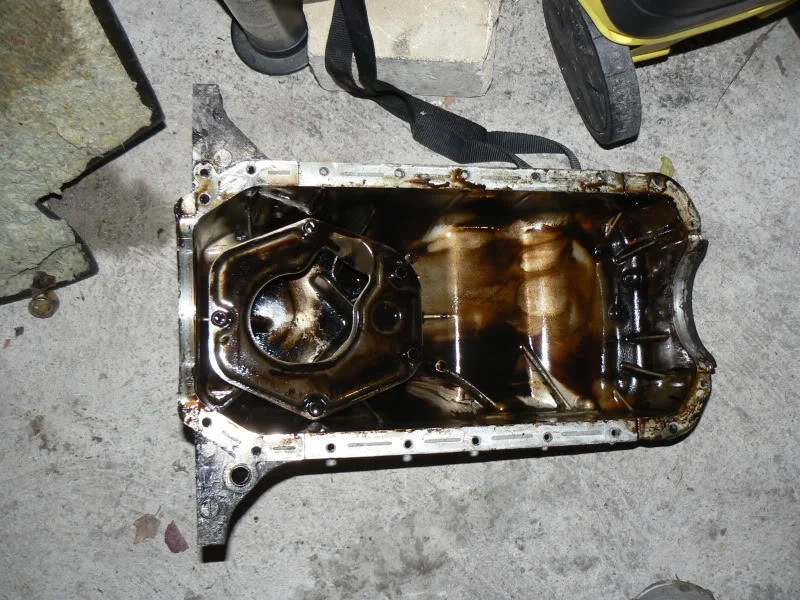

Took a while to remove the oil pan as I couldn't figure out a way to separate the baffle.
My 17 year old oil pump. I think I'll replace it for a piece of mind.

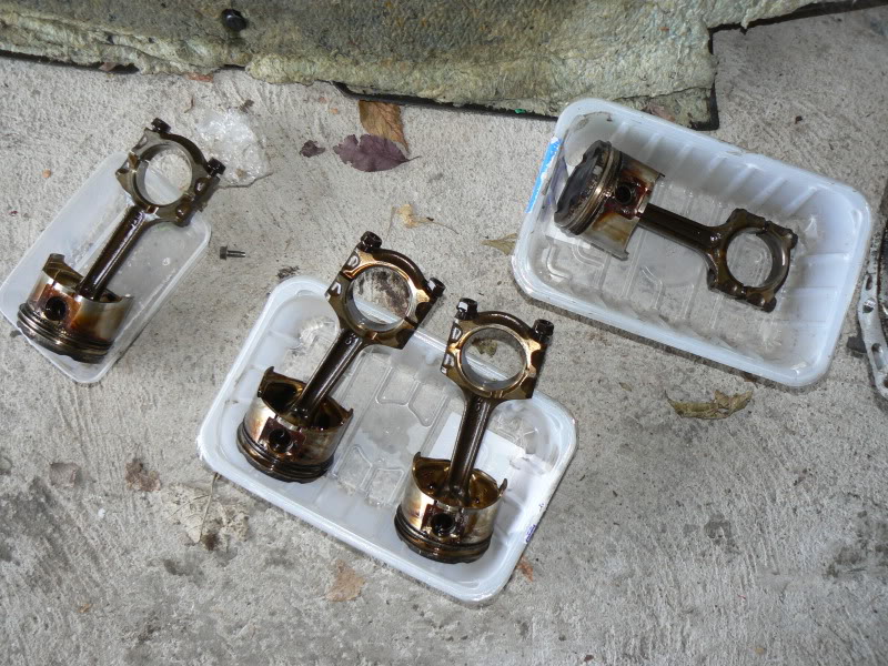

Getting much lighter now.
Ready to be sent off along with half my account.

Eeeee that kink did not look good mate, eaasy to miss if the chassis measured up okay mate.

Cheers tony. It is quite frustrating but luckily I have lots of overtime to take my mind off this for a while and to pay for more new stuff.
Also managed to get a donor car that got crashed into on the N/S door, same car my new engine is out of.:) Just need to get a trailer and pick up the new shell.

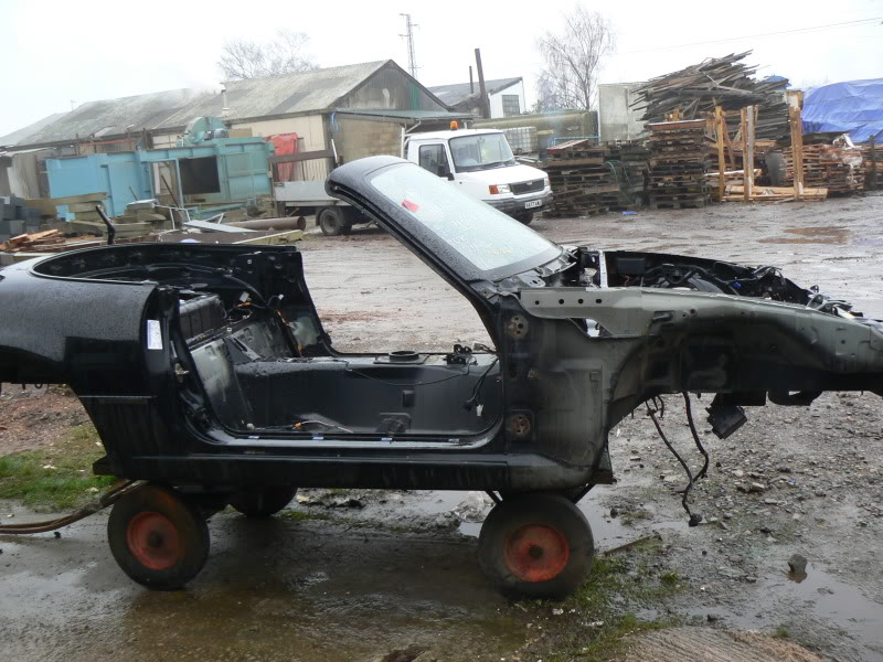

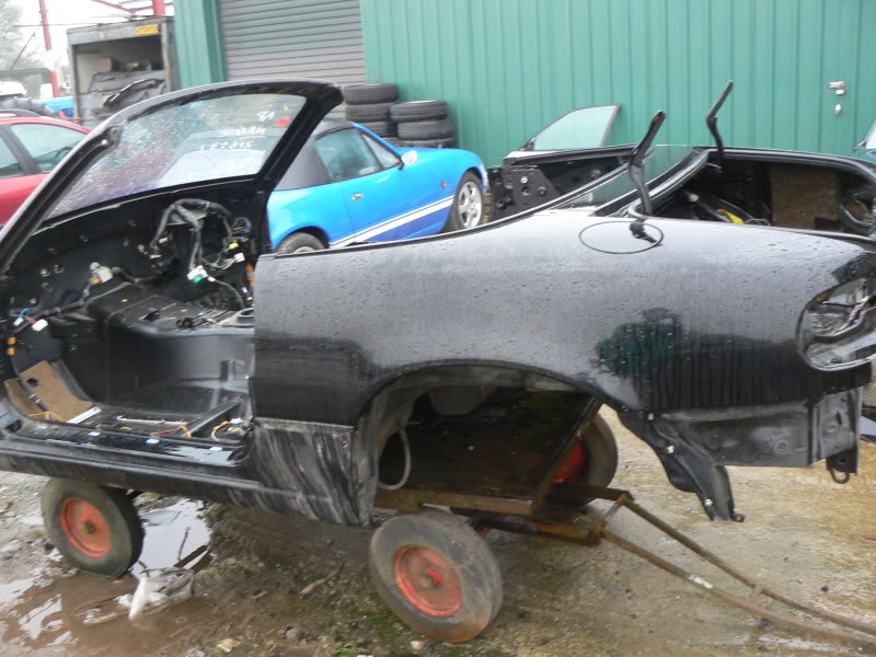

New shell finally arrived. It is a 93 1.6 V special that has just been imported from Osaka. Last know mileage is 129000km. Looked over it this morning and it is in very good condition with no rust.

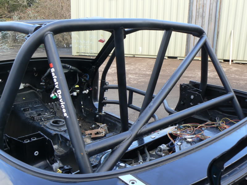

The saftey devices cage has also arrived so ready to go in as soon as the interior is painted. Will start swapping stuff over in the new year.

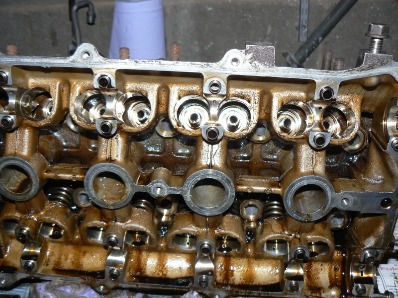

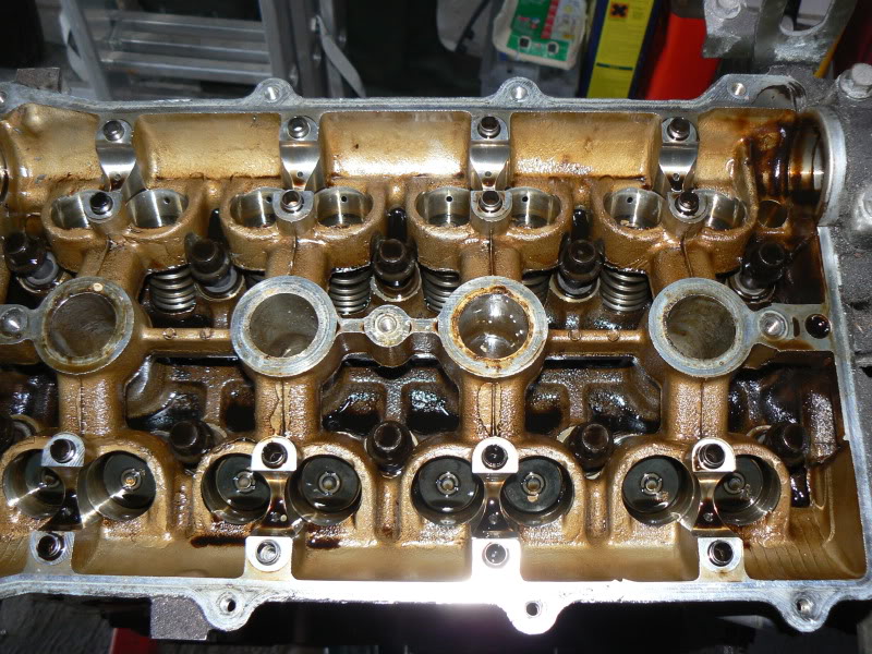

Just got the engine back from the shop. Waiting on the big ends for now so thought I'll put the head back together.

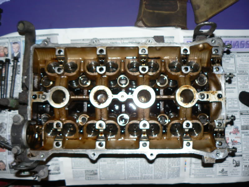

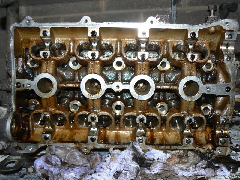

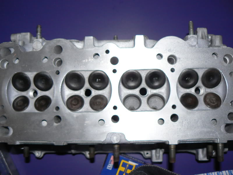

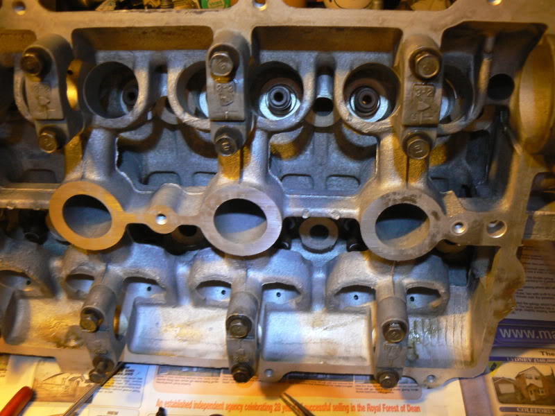

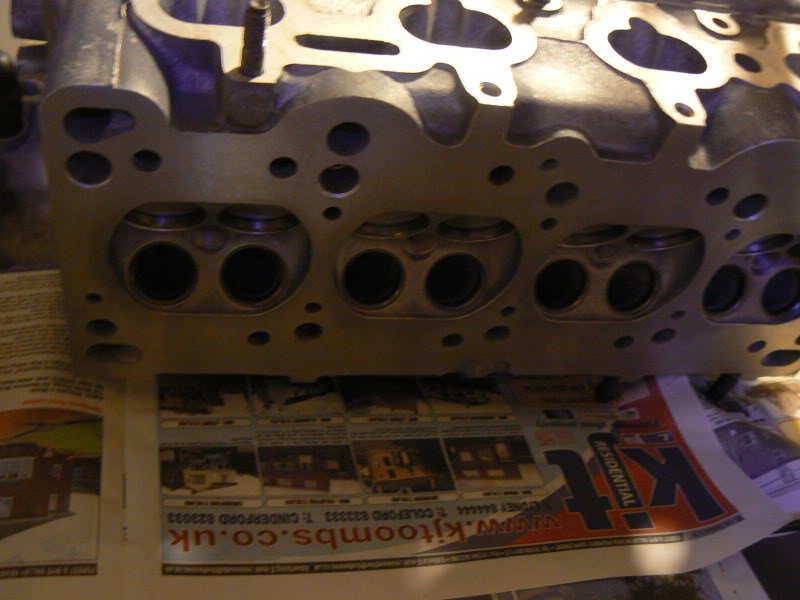

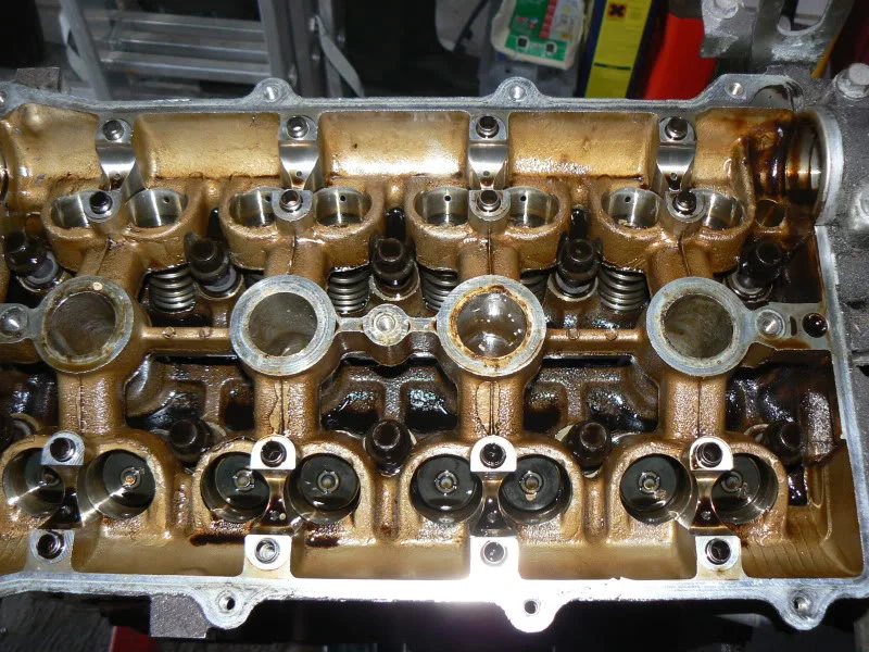

Bare head. All cleaned.

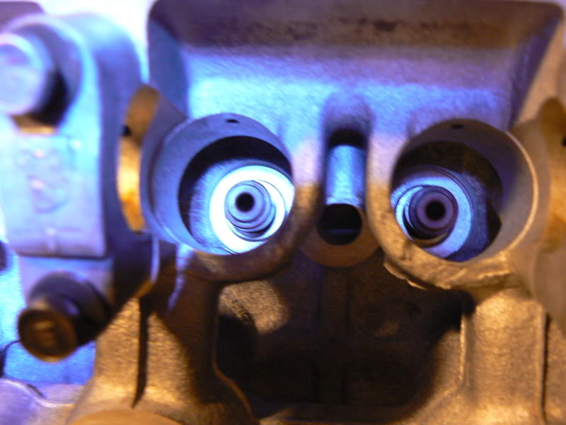

New valve stem.
Waiting on 2 valves.
Bottom end tomorrow.

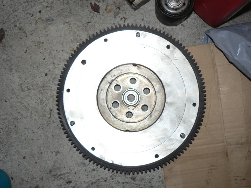

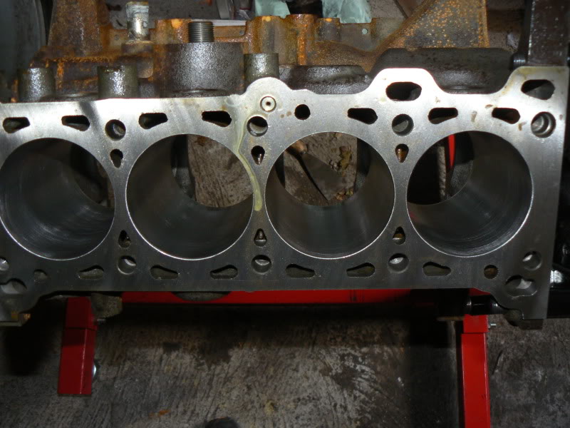

Refaced flywheel. Regs do not allow lightening or balancing.

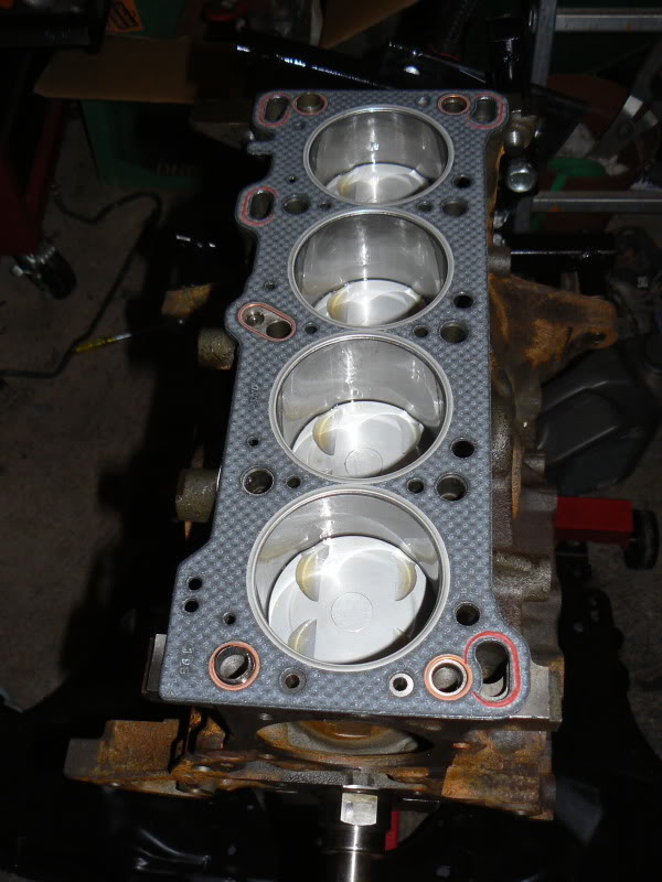

Block awaiting some paint. Loving the nice new bores.

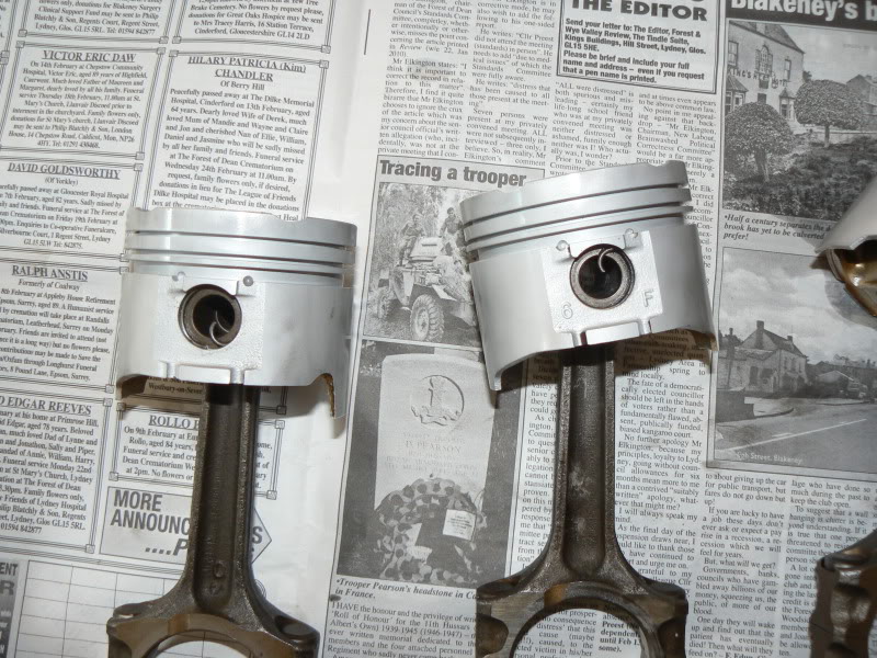

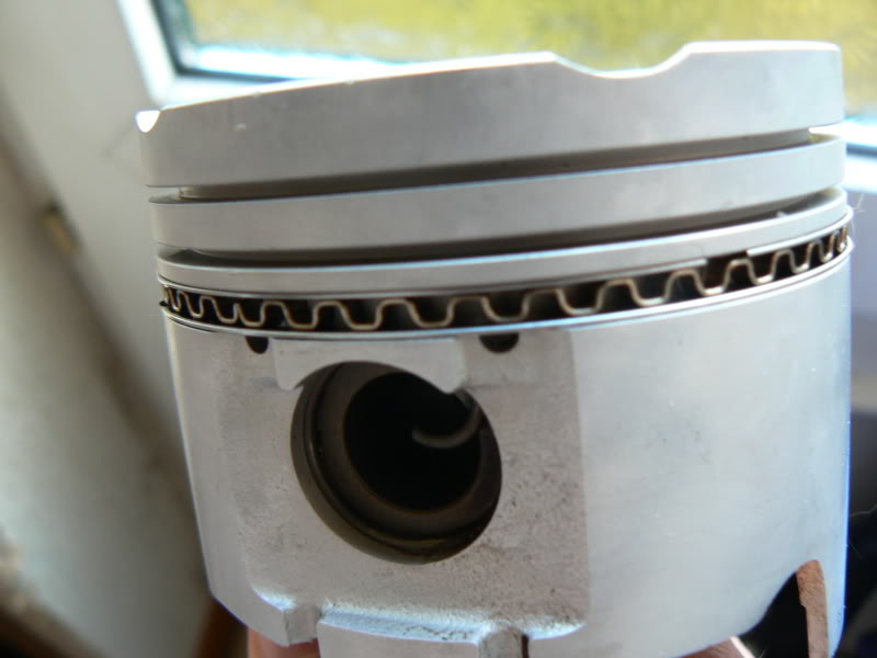

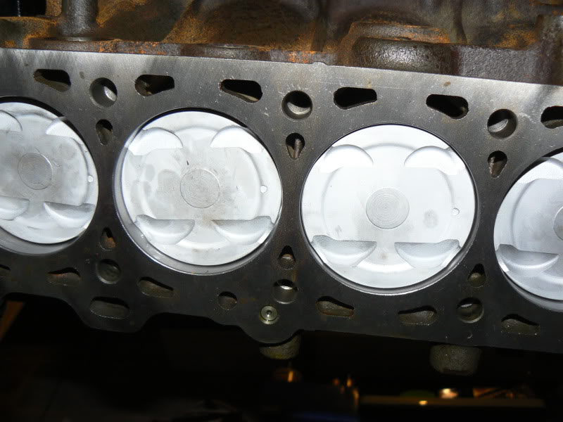

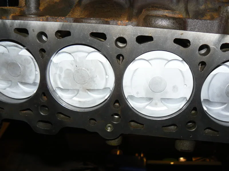

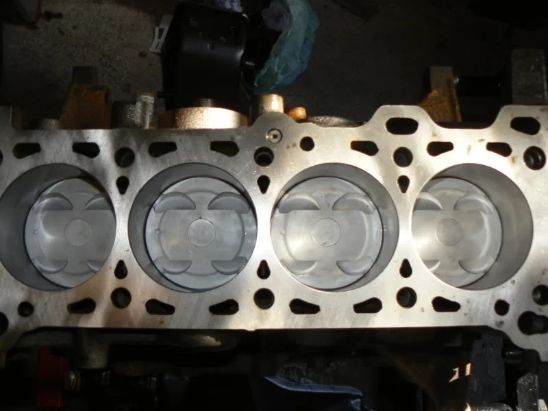

Pistons all cleaned and awaiting assembly.
Oil scraper and spacers installed.
Then the rings.

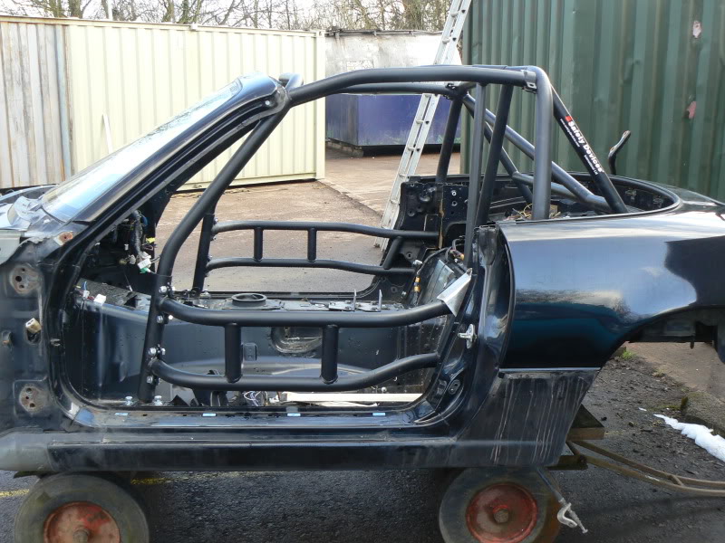

Cage waiting to be fitted. Should be done by next WE.
Will be building up the front a rear chassis assembly next week then the shell can just bolt onto the car.

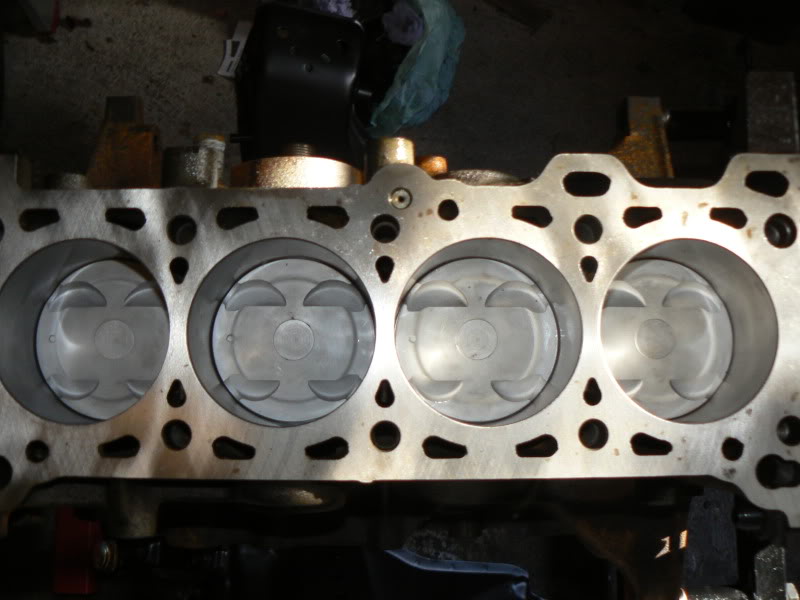

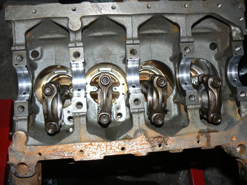

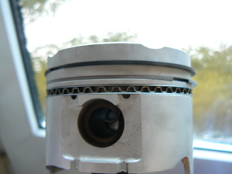

Pistons fitted.

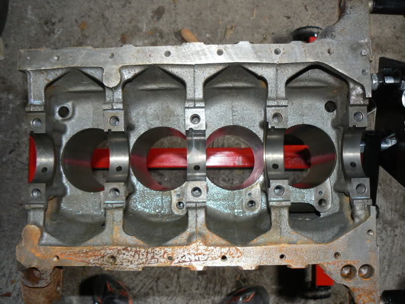

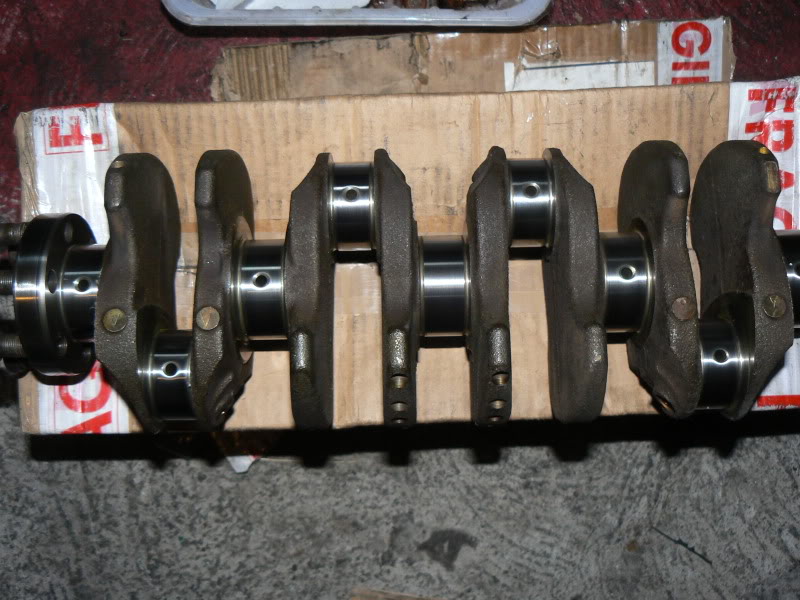

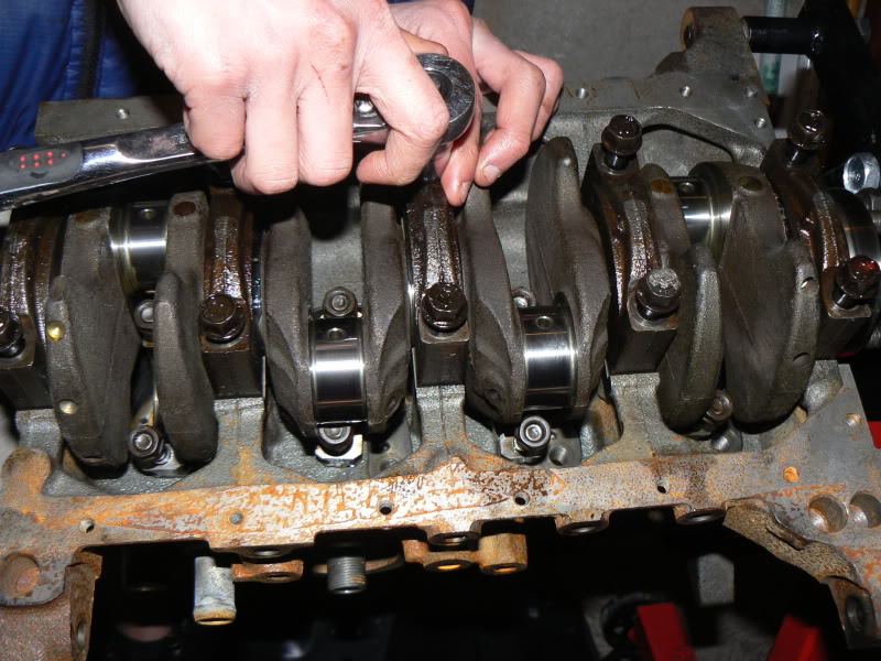

Crank looking lovely. Hopefully it'll never be seen again.lol

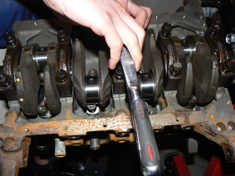

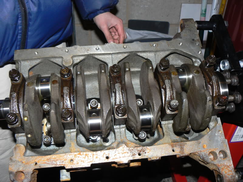

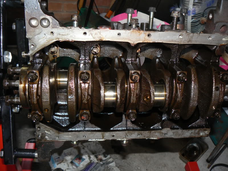

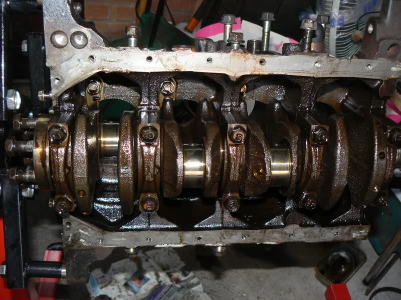

Crank installed and torqued.

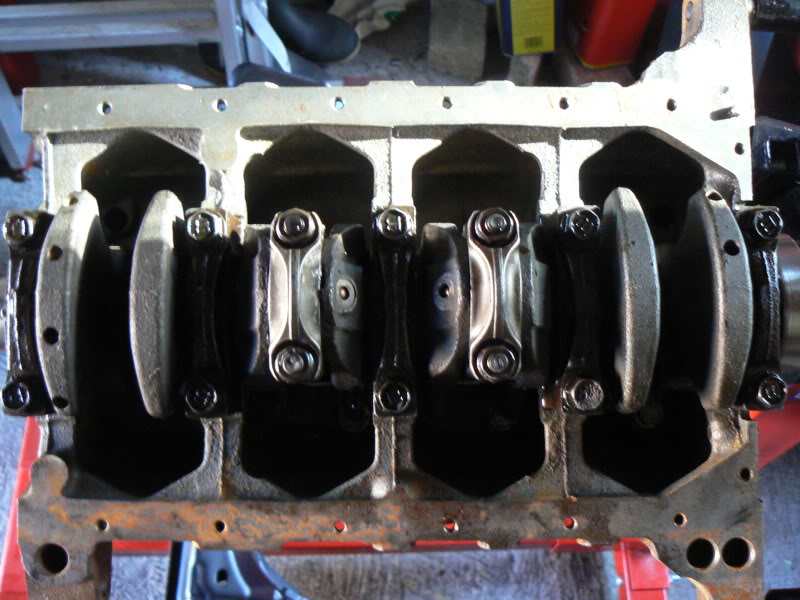

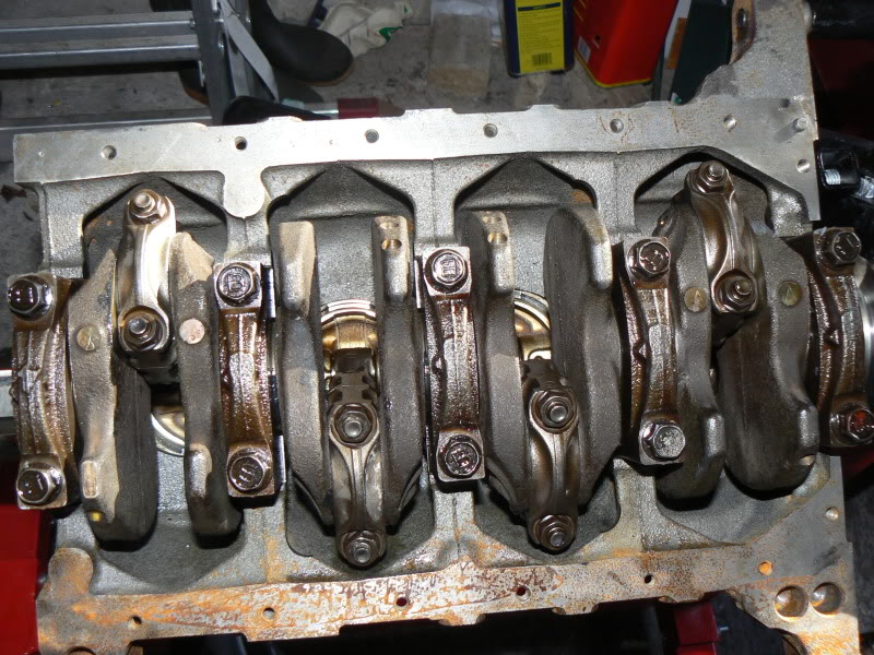

Pistons and conrods all installed.
Seem to have got over enthusiastic with the oil.:clown:
Engine would have been finished today but the front oil seal wasn't the right one so need to wait for a new one.
