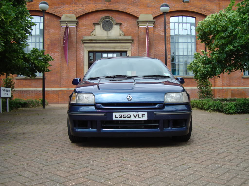

I really really like your front plate as well, i want the same lol ... where can i get one, size and font etc ?
Struggler
  Ph1 track 172
that lupo got on my nerves!! they wouldnt move, was good there last night, albeit a bit crowded which usually ends in tears!!
every time i saw you go past i was tempted to chase after you lol!
plate is from fancyplates
http://www.fancyplates.com/step1.php
just enter the dimensions as 520mm x 80mm (or 90mm, probs best measure)

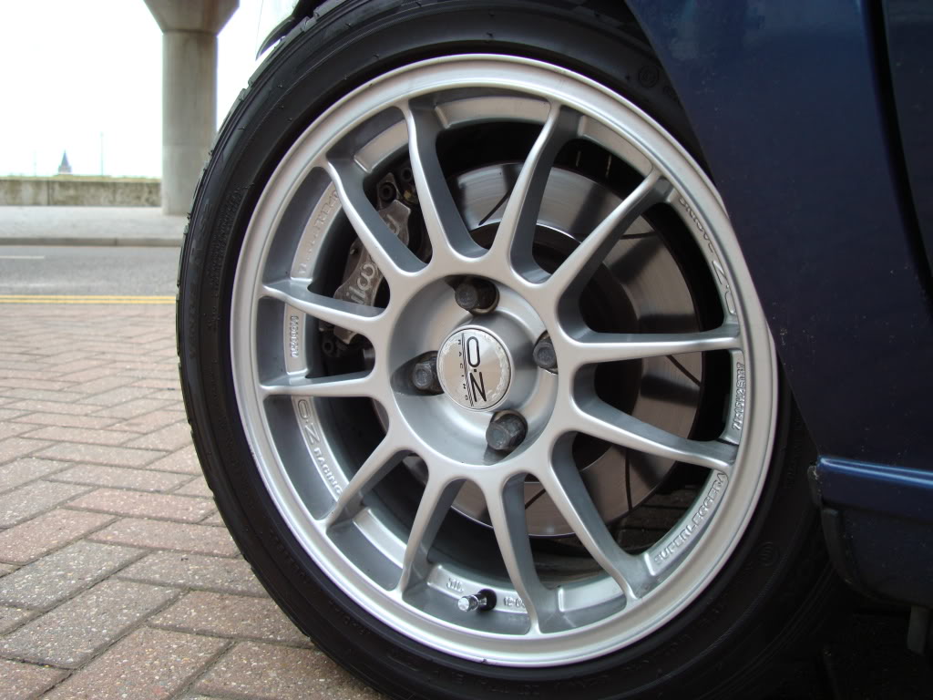

and i WANT your brakes! lol

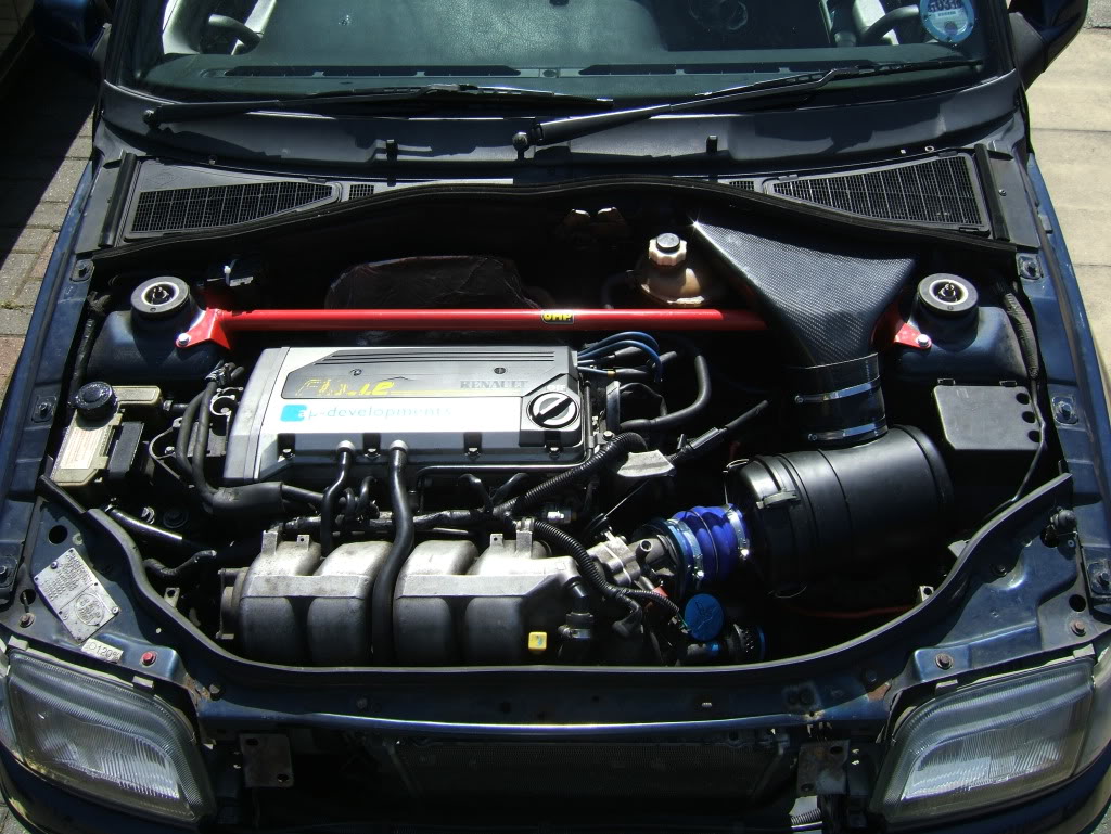

the spec of the engine is :
2.0ltr F7R
Piper 285 Cams ( classed as a stage 3 cam )
Piper adjustable pullies
APD stage 2 flowed head (headwork)
Supersprint exh manifold
Mongoose Exh system with decat
Group A Scuttle induction kit
RS Tuning remap
its making about about 185bhp 156lb/ft @5.5k ( has a 7.3k limit) but is running dangerously lean after this due to maxing out the injectors. ive just got a set of bigger injectors and will be going back to see paul in the next few weeks to have a new map done for the bigger injectors and to up the power:evil:
as i previously mentioned i also have an omex 600 , 172 flywheel, clutch , coilpack, leads and a set of volvo t5 high imp injectors ( high imp needed for standalone ) . just need to get loom and a few sensors then that lot will be ready to fit as well ( russ all them parts were yours minus the omex ;) )
