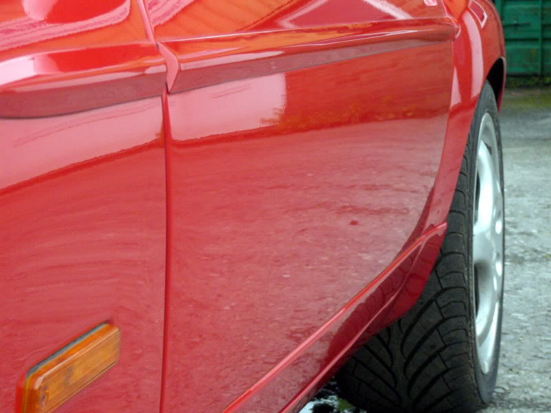

Firstly the nearside front wing (from my test patch) was treated to ssr 2.5 on the pc (remember AIO didn't touch it) and then followed up with megs #80, megs #81 and then Nattys Blue for its UV propeties. I used a good 8 oz of #80 on this car the paint was so thirsty!
The above process took an hour on this wing

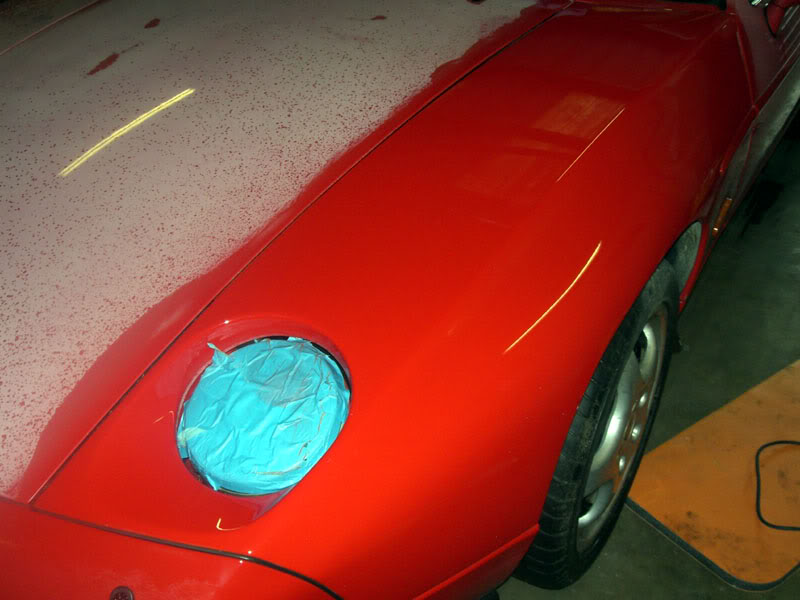

Next up I decided to polish the offside front wing - this is where we hit some problems! The pc and ssr2.5 was only tickling the paint. Stepping up to menz IP on the rotary and polishing pad made some indents but still laughably poor. It took 6 passes of powergloss on a megs cutting pad at stupid rpm to clear the paint. Interestingly this side of the car was 170-180 microns compared to the other wing which was 120-130 microns. After chatting to L200 Steve one theory could be a poor respray job using clearcoat which had to be 'ground through' first - see later.
2.5 hours on this wing alone and well behind schedule

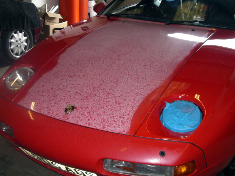

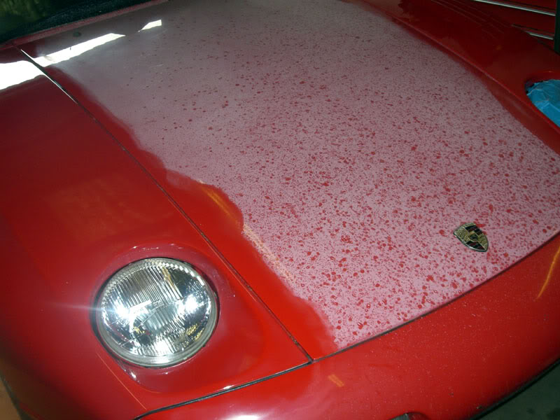

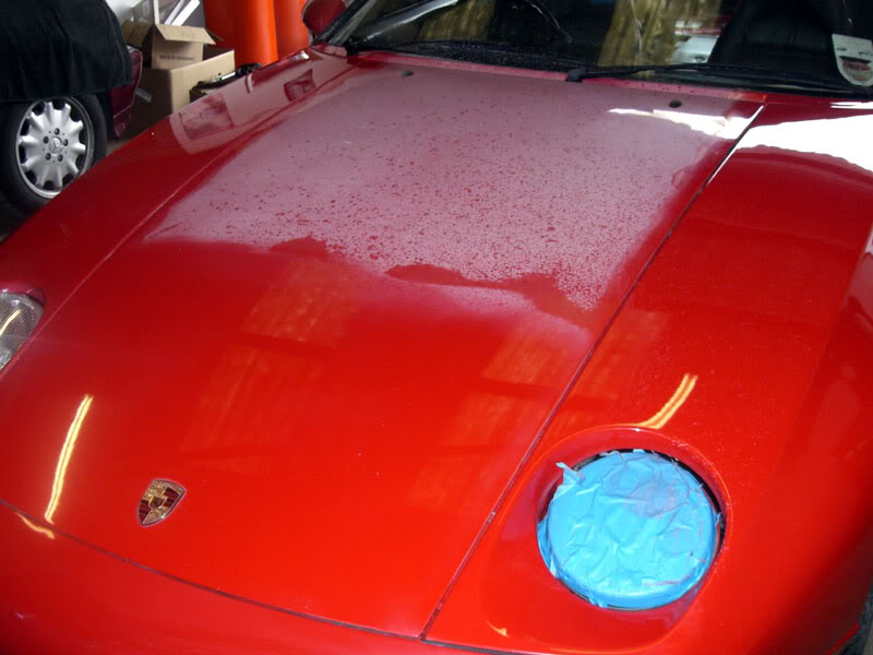

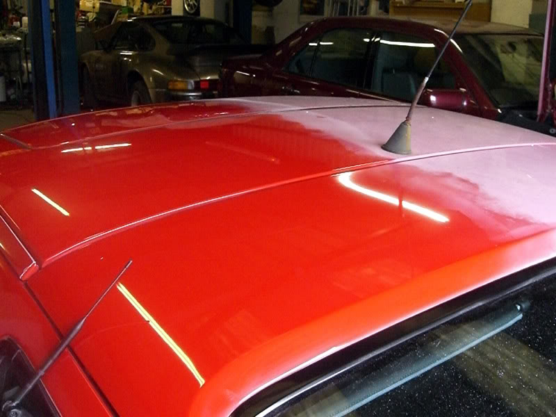

Thank god the bonnet was childs play the oxidation almost fell off lol as it did on the doors

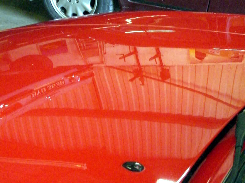

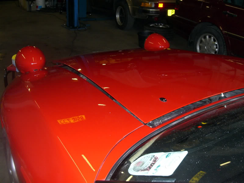

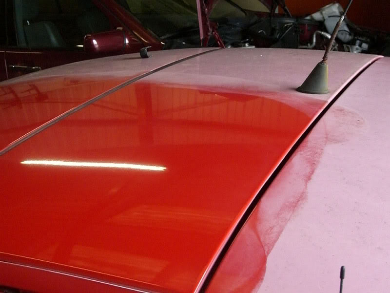

The roof was a tricky customer and I was back on the megs cutting pad and power gloss again slow going

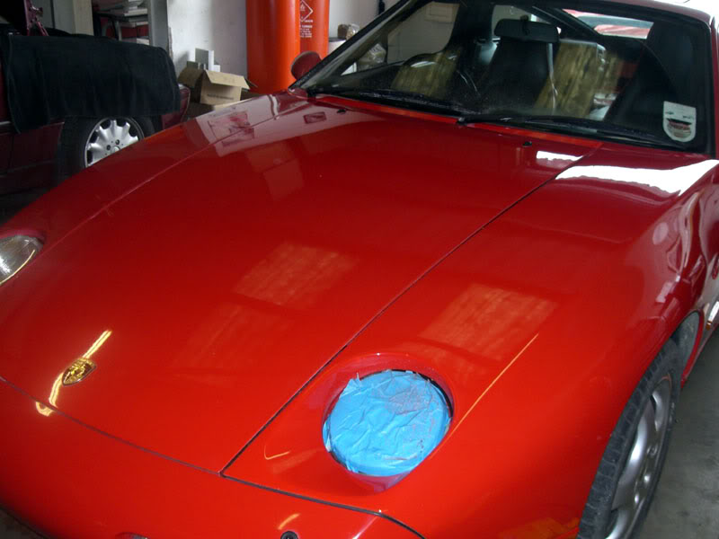

The bonnet and lights were popped and the wipers removed so I could get to some tricky areas

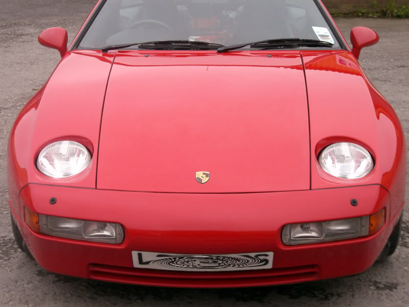

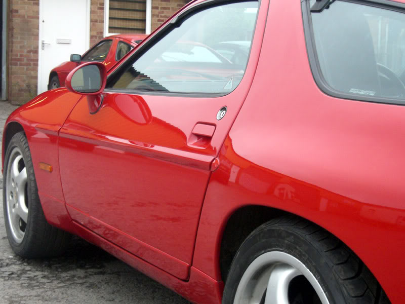

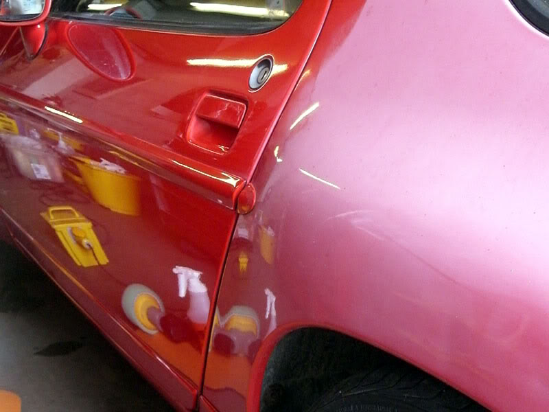

And the afters?

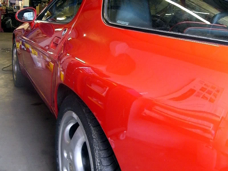

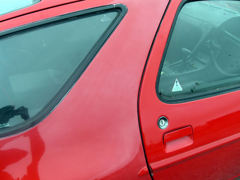

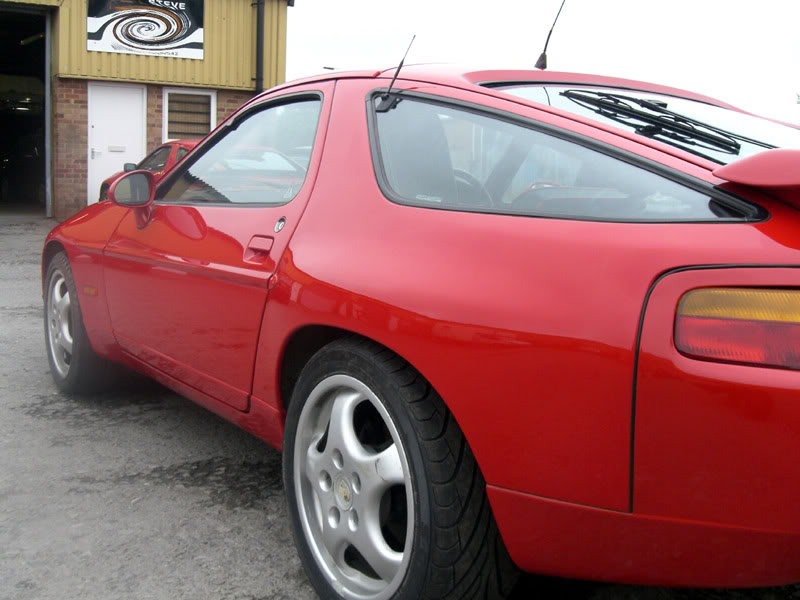

I'll start off with the dissapointment. The offised rear quarter could not be brought up to an acceptable std. Powergloss and rotary even wet sanded the fecker and no improvement - no paint transfer either!!!. If this panel was poorly clearcoated in the past then it was a better job than the rest as this couldn't be shifted. This panel will need repsraying or more than likley blowing in by a quality SMART guys I know. Not bad I suppose as I did think we may need a few reprayed areas.
The rest of the car was guarsd red though:devil:
