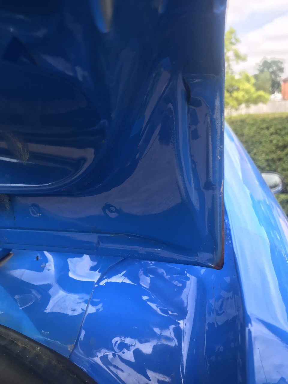

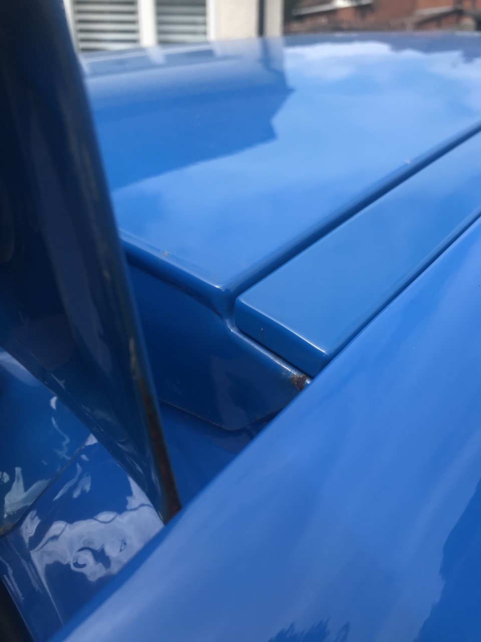

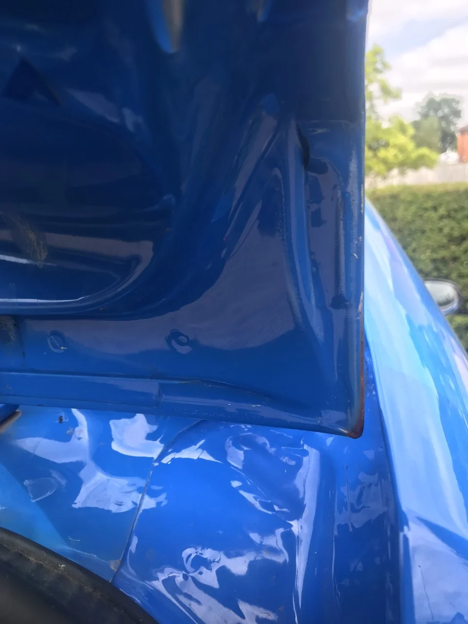

I own a 2012 Renault Clio 200. I have rust showing on the edge of the tailgate and paint bubbling and a spot of rust behind, see pictures. I also have a corrosion on the sub-frame.
I took the car to Renault Wolverhampton and spoke to the service manager but he felt the car had been resprayed at some point (and therefore not covered by the warranty) and cited the following as evidence:
  • Slight paint bubbling, see pics

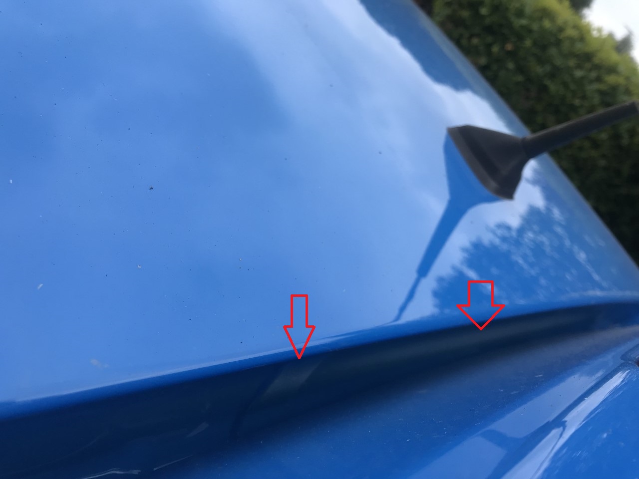

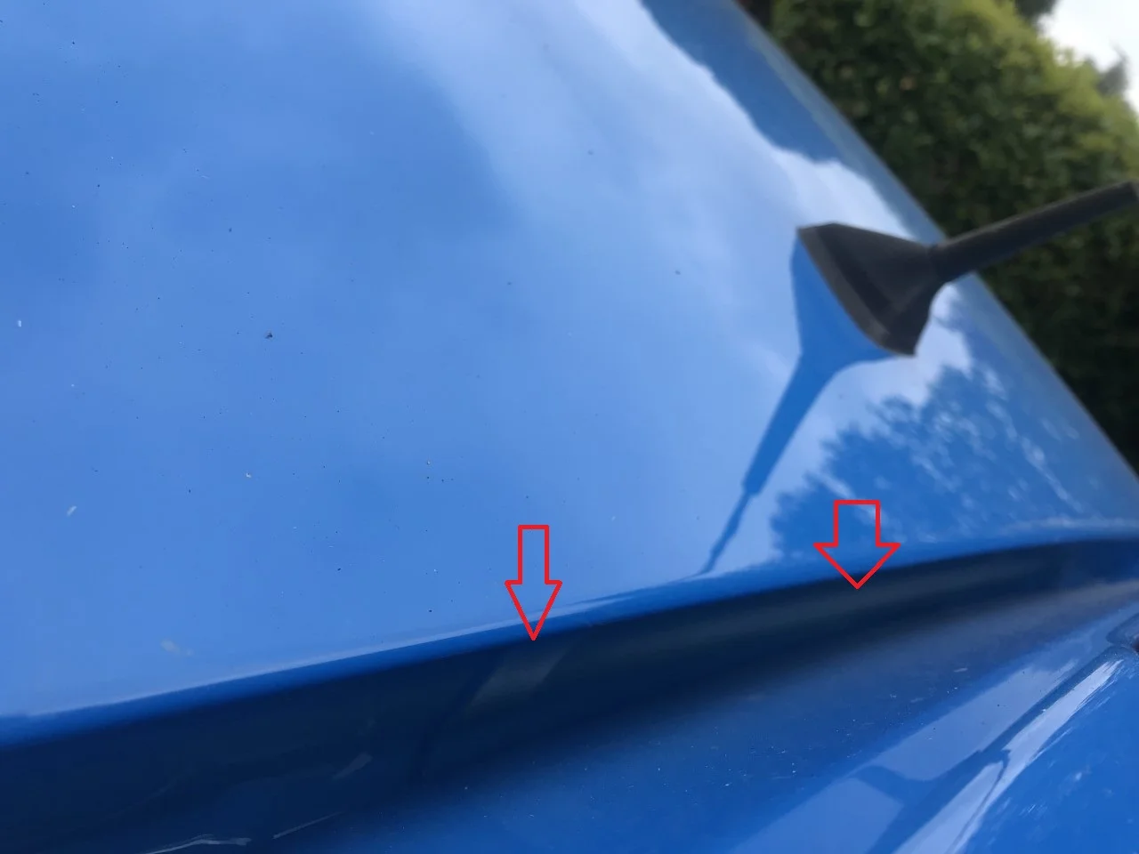

  • Lighter patch of blue paint behind the tailgate (see pic with red arrows)
I've taken the car to an approved Renault independent body shop and they felt it could have actually left the factory with that light blue paint patch. Also, could the bubbling not have been caused by poor paint/material/application at the factory and actually be part of my claim rather than making it invalid?

Pretty sure the light bit is just an area without clear? Or a primer.

The first picture looks to me like the tailgate has caught and worn away the paint causing the rust. Can’t see how else that would be caused

On my car it was the tailgate as above and also the roof rails.
The bodyshop manager inspected my car and took paint depths and highlighted the area on the roof rail.
The bodyshop manager then inspected my friends car with the exact same issue on the tailgate, His roof rails where ok with no bubbling on them.
