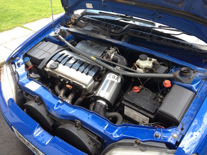

The original 8v box which was refuted in 2010. I have an invoice for the conversion in 2010 where everything was changed at a cost of just under £1600!

What's involved in converting from 8v to 16v?
As for converting to 16v its fairly simple, I did a few saxo's a few years ago. All the engine an box bolts straight in, you need to use the 16v engine loom an a unlocked ecu so its runs with the cars immobiliser so it saves faffing around swapping keys. The 16v really is a great engine.

looks very tidy, whats the running issues?
The car just kept losing power and cutting out. I'd leave it for thirty seconds and off it would go for another 50 miles before it would do it again. To me, it felt like a sensor problem of something - the previous owner had to swap the exhaust for the mot and just slammed any old 106 exhaust on there so don't know if that's causing issues or not.

Id say a sensor issue, especially as you say leaving it then it's fine points towards something electrical - crank sensor?
My mates 16v has developed the same issue. Sorry for the lack of reply I'm that busy I didn't want to waste your time if his wasn't running properly. I've put a coilpack and a coolant temp sensor on his so far and it hasnt made any difference (both suggested by 106oc).
I've also got an unlocked, remapped ecu which you could have for little money ;)

Have you tried the throttle position sensor?
That could be the culprit for I cutting out. I had to change mine on my VTS when it was doing something similar.

Lambda sensor causes cutting out on these. Mine was on it's way out and used to do it, then I got a 2nd hand 4-2-1 manifold that had a different lambda sensor in, threw it on and it was faultess!
