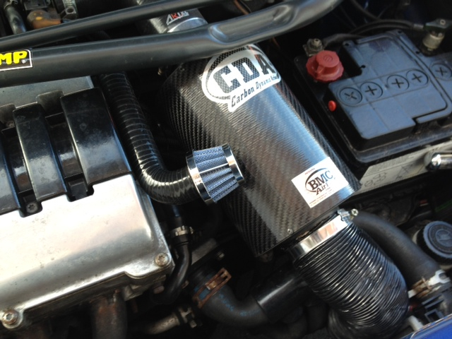

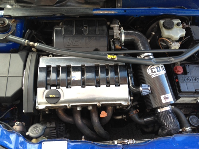

Ahhhhhhhh, starting to get frustrating now. The garage have just called and are blaming the fault on the bmc air filter saying that some pipe is not connected properly and this is causing a bad mixture. The only pipe that's missing (I think) is the oil breather and I can't believe that this would cause it to lose power and cut out! Back to the drawing board!
  Alien Green 200
Its not the air filter, ran mine with a bmc and no breather filter for months. My bets on coilpack.
Donny_Dog
  Jim's rejects
Complete rubbish.

Fitted a breather filter today and a new oil cap. Not quite managed to work out what the running issues are but should find out by Thursday all been well.
