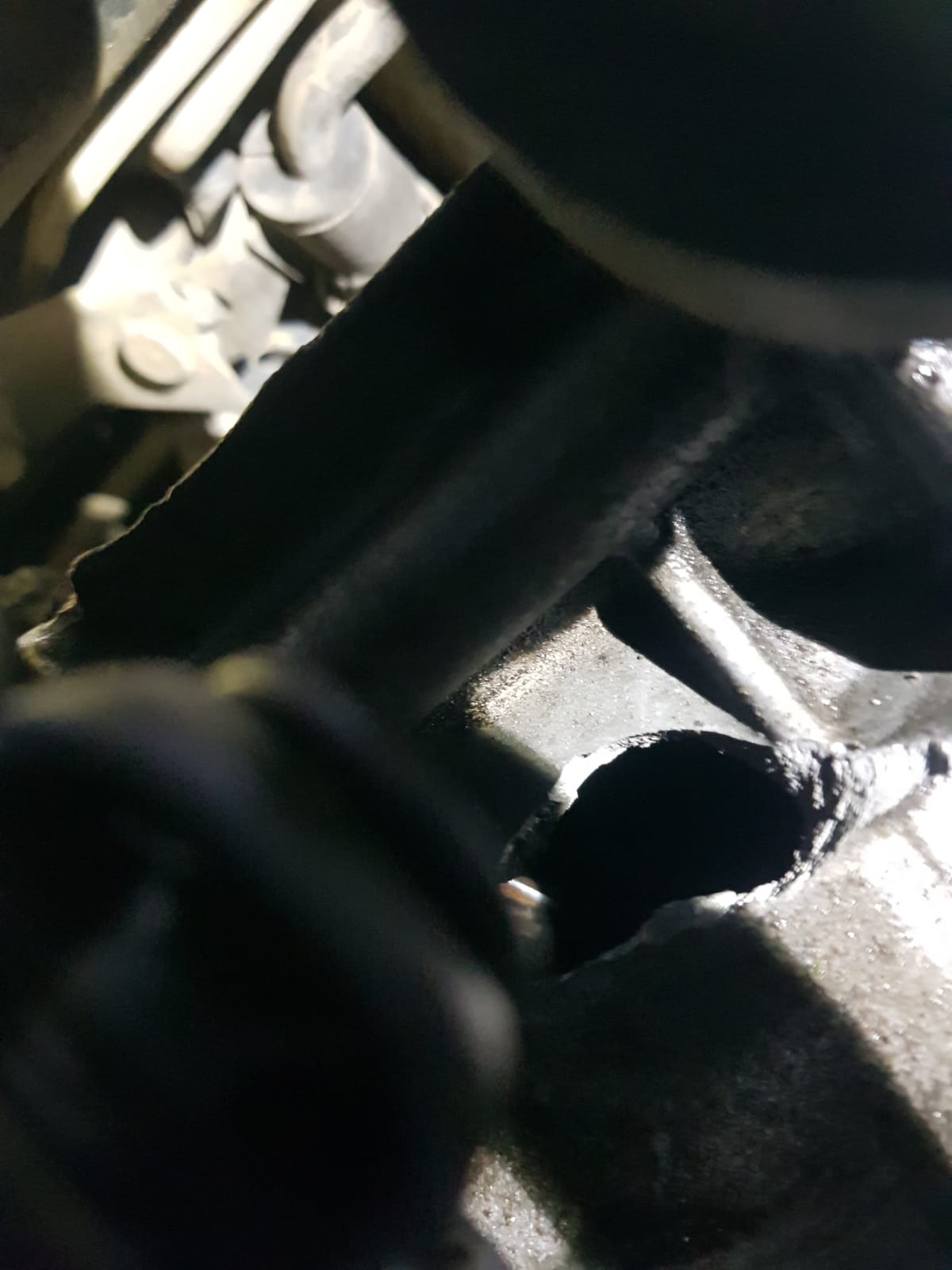

But the worst was UNDER the paper....
1417310
whenI saw the hole, nearly burnt the car straight away... but decieded just to park it, and have a though about it.

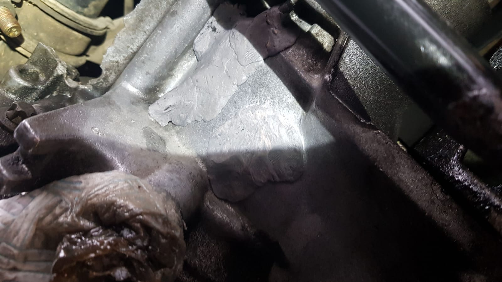

Next morning, decieded to investigate, how a fully operational gearbox could have this massive hole... as this normally means that something is tried to escape from there. And decieded that someone had trown the car over an axle stand while working on it. And... decieded to seal the hole, put oil and see what happens.
1417309
That was my bodge (chemical metal with an aluminium plate to the shape underneath). 500 miles after, is still perfect. Of course, I´m on the hunt of a gearbox... but meanwhile this one works.

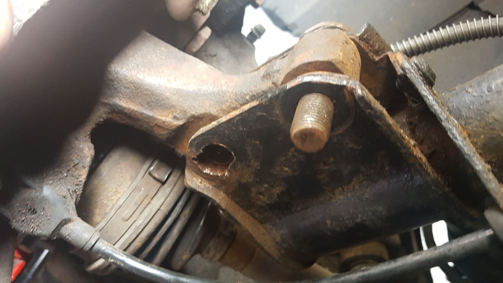

then... went to investigate why the car was pulling so badly to one side... and found the following... it is pretty obvious to me, that someone tried to fit 172 shocks in a 182 CUP... and while fighting with them, the car fallen down, cracking the gearbox... moment when they decieded to sell the car straight away....
1417311
This bodge, left the car with 2 degrees of camber in one side, and +1 in the other... no wonder it was pulling. 80 quid later that was sorted with two OEM 182 CUP shocks.

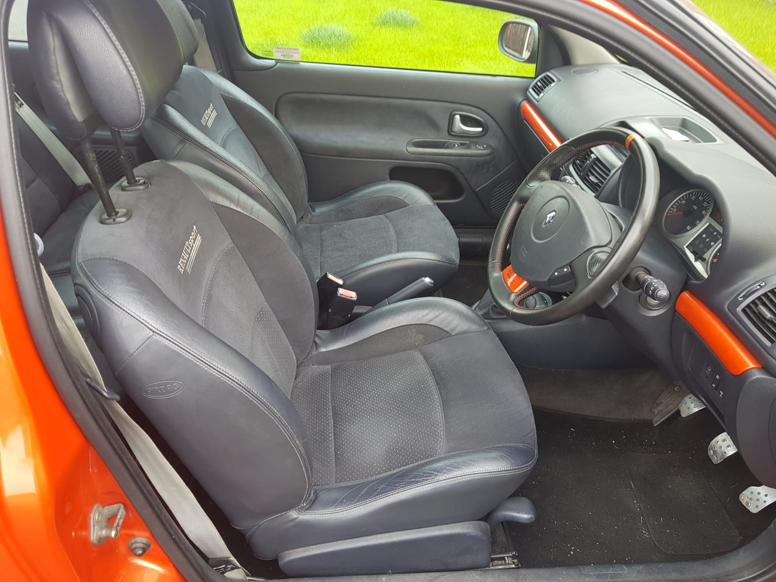

Other than this two bodges, I have to say that the car is Spot On. All the electrical gadgets work, inside is in surpirsingly good condition, and ousdie is very decent with no rust at all underneath.
The service history stops just before the last owner bought it, so it means that with a bit of luck, its only been in the wrong hands for a few months.

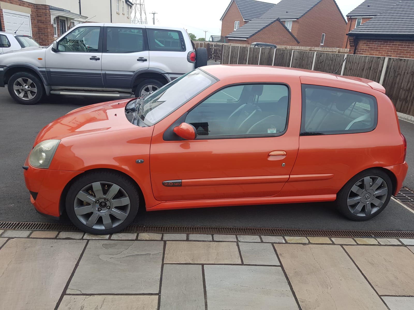

Find a few pictures of the car after a quick clean up...

That is a serious and dangerous bodge if ever I have seen one. I am amazed the box is still functioning as it can't of had any oil in it. They must have known that. The shock side of things is pretty easy to sort. Gearbox not so much.
Rest of the car looks pretty good though. Inferno is a great colour too. Hope you got a fair chunk off? Look forward to the updates.
It still had just over 1 litre of oil left when i repaired the gearbox. The car did 30 miles since its MOT to my home... and im 90% sure that the gearbox was fine in the MOT, as they spotted a broken cv cover (repaired already) and leacky shocks... (they tried to repair it) and that is when i suspect they dropped the car and fucked the diff casing.
So... lucky me the box did run less than 30 miles with low oil, and that is not enough to breack a box.
The "bodge" ive done, and will be there till the clutch lets go, is perfectly safe. Not particularly elegant, but the stuff i used seals high pressure steam tanks, will hold a bit of oil at 100 degress all day long.
Yes. The car was cheap for being a 182 cup quite original and with full service history, but not cheap enough to cover this two bodges...
To be honest im quite surprised with the box itself... regardless of the issues it had. Is incredibly sweet.
My memories of the JB boxes from my early renault times were bad... really bad. This one is half nice to use...
