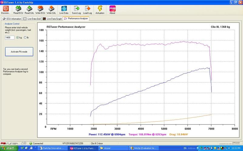

my RS tuner power graph (197)
  Renaultsport Clio 197
car's done 9000 miles, runs on poor 95RON, test was done on a very hot day and on not so good piece of road... but still... way down on power?
comments and help more then welcome :boring:

anyway, I'm a person that's unhappy with the power of my new car, try to help :approve:
  1998 BMW e46 323i
^Yeah,.. If it's at the wheels, it's prob about right. 112.45KW = 150.8 bhp, so there's no problem there mate. Try it on V-Power after a few tankfulls, would be interesting to see the difference, if any.

So, being serious now....
If its making about 155/160 at the wheels, then that would equate to about 185 at the fly? ish?
So its probably down a small bit but not a lot.
Remember, the old 172's only ever produced 160-odd horsepower at the fly.
i think 150 at the wheels is about 170/175 at the fly ?
The lowest i've seen at the fly (onthis forum) is about 185/190.
people seem to get book figures, and some of them even more.
Also, could low quality fuel, air temp and road surface affect this much?

Air temperature will make a MASSIVE difference for sure.
fuel quality will but not a lot and the road surface should make no difference to the engine.
will try tommorow with 100RON super-unleaded and see the difference on the graph...
the only problem is that 100ron fuel is available in just one station in the whole country and costs 1.3 pounds per litre :mad:
so hopefully a custom 95RON map from Henk should make a difference

Your car's only designed to run on 98 RON max (correct me if I'm wrong), so a higher than 98 ron fuel wouldn't add any power, and like I said you would need to use a higher ron for a few tanks before seeing any change (again correct me if I'm wrong).
Furthermore I think you lose more bhp via the transmission than you think bud.
Have a sprint upto 60mph on an A road against another 197 to see if you get left behind. I can't see a problem to be honest. Chill out.

john, you are right about the fuel...
but in my country there is only 95RON unleadead and one station with 100RON super-unleaded... 100ron will probably have 98octaneS or less ..
I already tried that fuel before the prices went up and the difference was massive.
It even poped and burbled from the exhaust (and it never does that on normal fuel).And the mpg was much better.
But just want too see the difference on the graph
and btw, why can u only tell the difference after a few tanks? The ecu has to 'adapt' to the new fuel or what? I think I did see the biggest difference after a full tank, but still even half a tank will do something?

Yes the ECU needs to adaped back to it 98 ron map. Yes these sort of things needs to be done on a cool night no air con on no windows open correct tyre pressure
I know all that, but I am only concerned because all the 197's here are pushing 195bhp and more at the fly... and it's not just on one RR!
I think i have misplaces 10 bhp (or more) somewhere :eek:

RenaultSport recommend 98, but they say the 197 can happily be run on 95.

Anyway.... Poor road, 95 Octane fuel (why????) , HOT. These are a good combo for ruining performance
I've never tried running 95. It WILL run fine for day to day use, just do'nt expect performance with a car mapped on 98

What is your barometric pressure over there?
Did you upload the latest B600 software version on the car ?
The PA must be used on a level stretch of road. We will adjust the software smoothing a little bit because the curves look a bit too flat.

i will update the software tommorow henk, and then I'll try !
Don't know about the preasure but I'm at sea level...so shouldn't be a problem.

i have updated the softvare wersion to B600 and it fixed the cold start issue ! FINALY no kangaroo !
and I did a PA with 100 super unleaded and it showed 5hp increase..altough the temperature was a tad lower...5 or 6 degrees lower than last time.

The weight you put in for the dyno results seems a litte heavy. i thought the 197 weighs 1240kgs, dunno if that would affect the rstuner or not.
