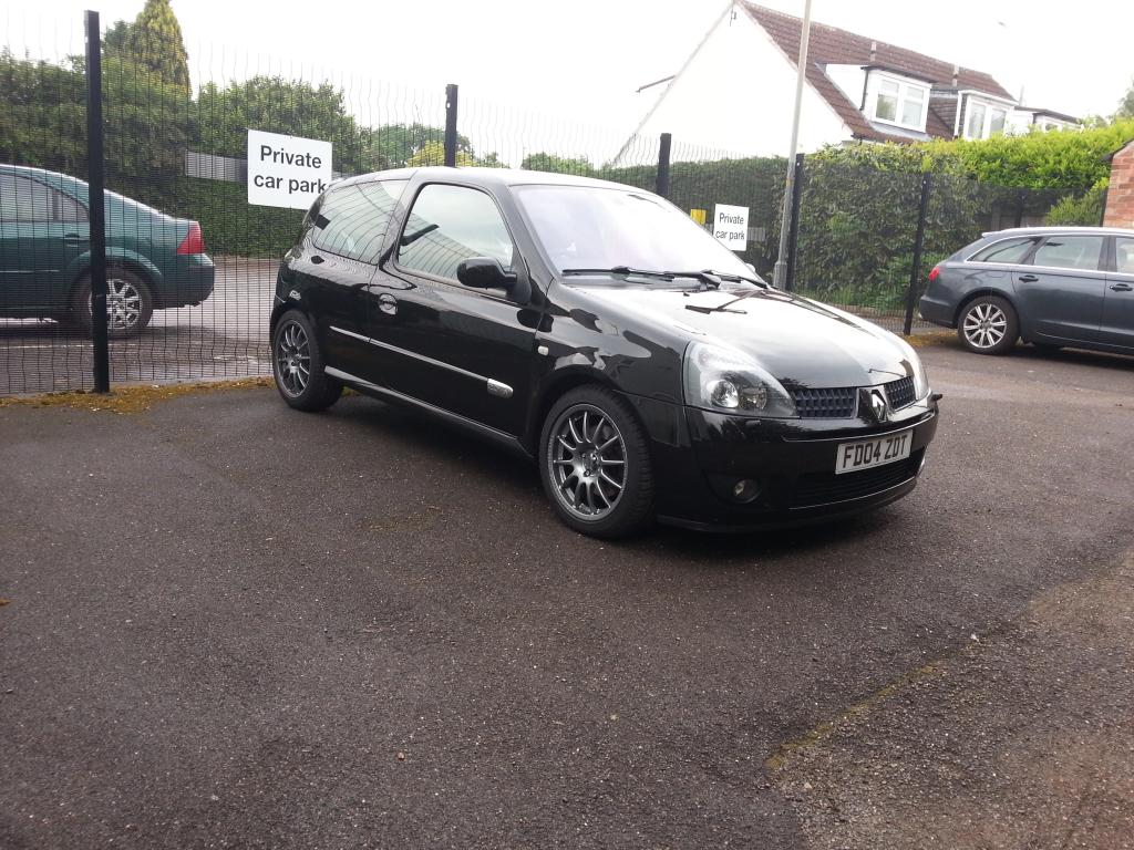

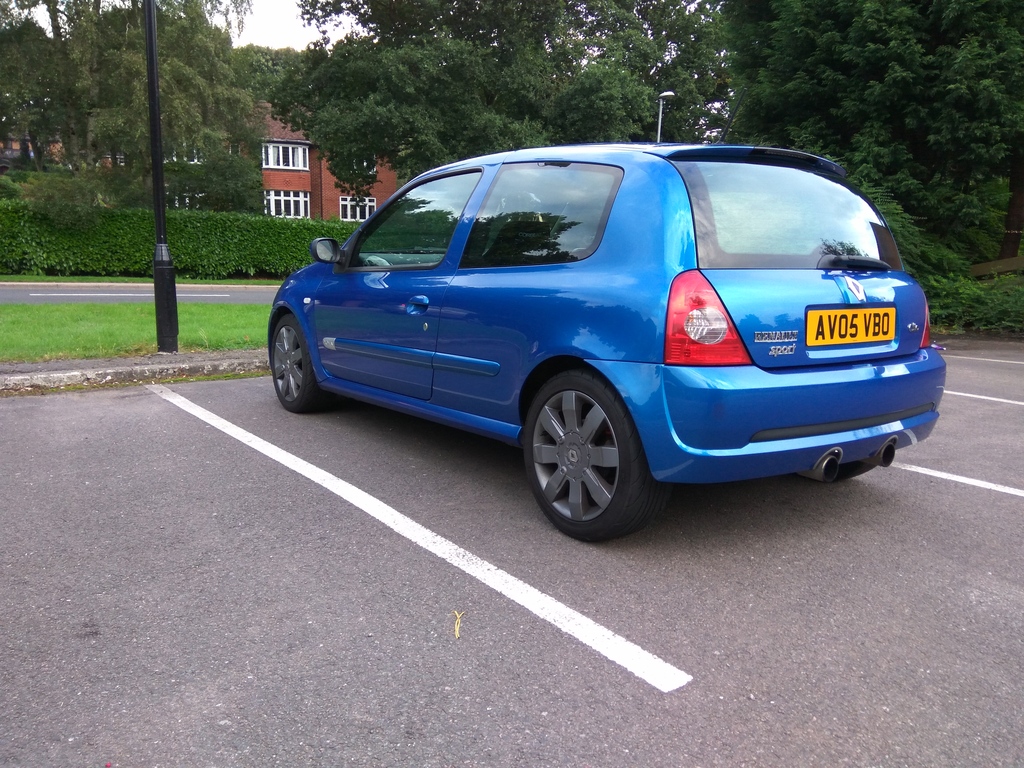

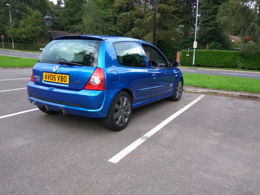

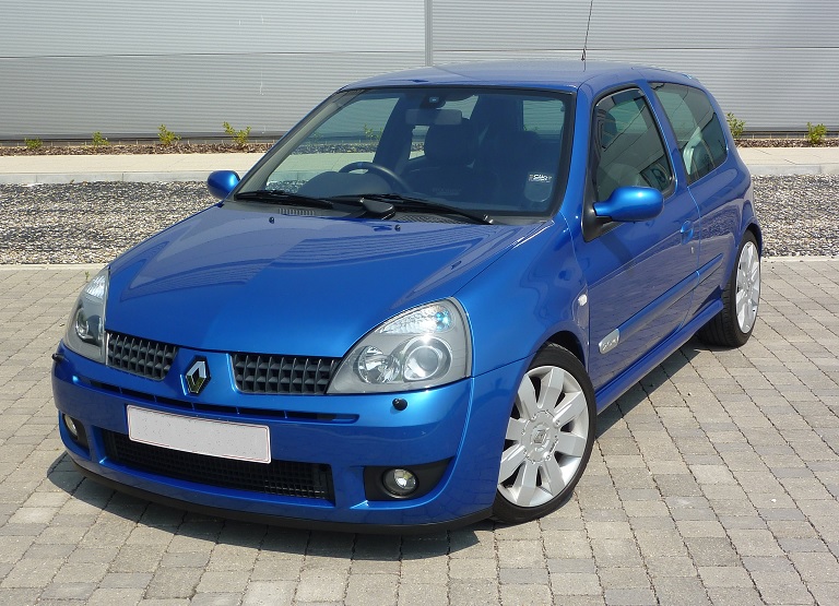

Couple of pictures with pro 1.2 custom painted by sprayshack:
Took 144 photos for the for sale add:

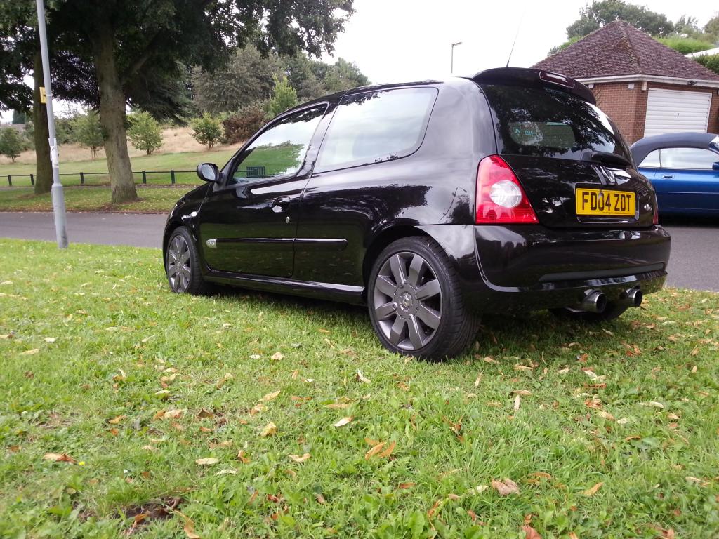

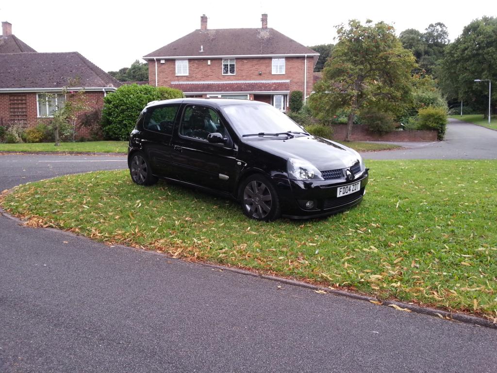

Anyway the Jetta turned out to be a bad buy, turbo failed with a few weeks. Ended up replacing it with a hybrid unit, replacing the gearbox, clutch and adding bigger wheels, lowering suspension, etc.
I'll not add any pictures of this as it's just a diesel jetta with 210-220bhp.

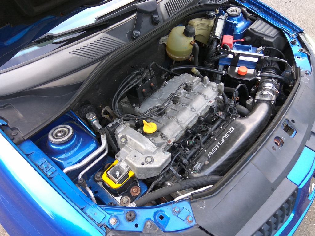

Spec of the new 182 is:
JMS RS2 mapped by RS tunning to around 185bhp
Eibach sportline springs on cup shocks
Powerflex upper engine mount, dogbone and steering rack bushes
Yanoo 3.0 shifter, with mod to move stick further back.

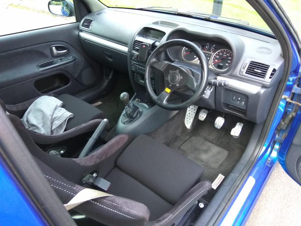

300mm omp steering wheel with mono boss
Corbeau club sport seats without runners on X-low subframes
Rear seats removed and further stripping to come
KTec racing exhaust (though centre is silenced powerflow)
Nankang NS-2R (180 street compound)
Brembo HC disc and pads front - Genuine renault rear
That may be about it for now. But future plans are to add a little more power, that is likely to come in the form of either camshafts when the belts are changed, or ditching the RS2 and going low boost.

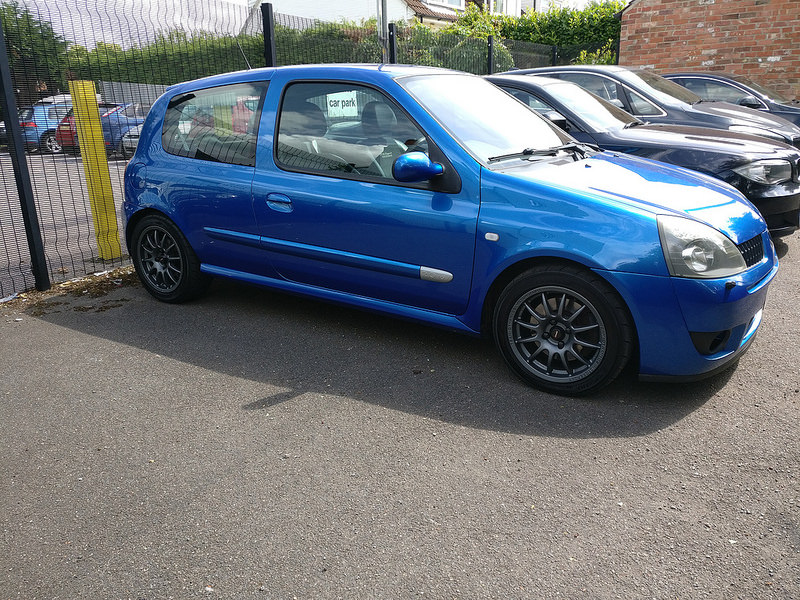

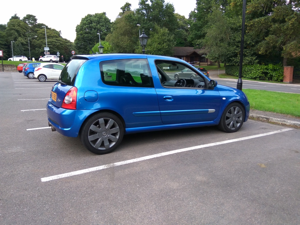

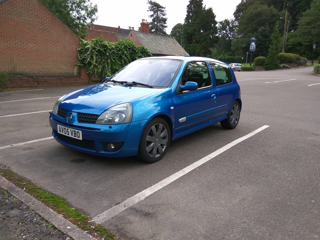

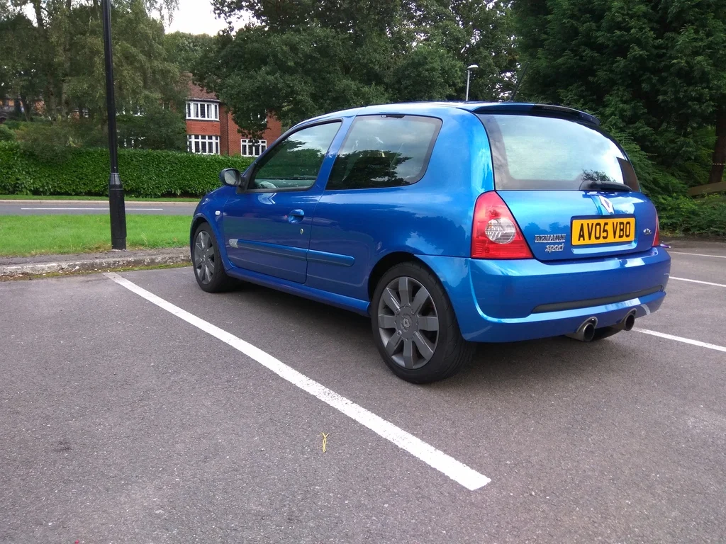

And some rubbish pictures taken on my cheap chinese phone:

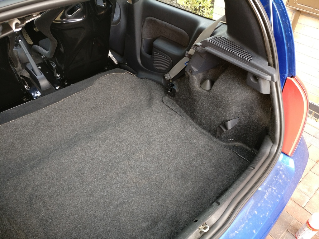

I've got some carpet/fabric to retrim the boot with, that seems to be a decent match to the existing boot carpet. Haven't decided yet on how i'm going to fix it down. looking at either double sided tape, or adhesive spray. I suspect the spray would make a better job, but it'll be more difficult to remove in the future it needed.

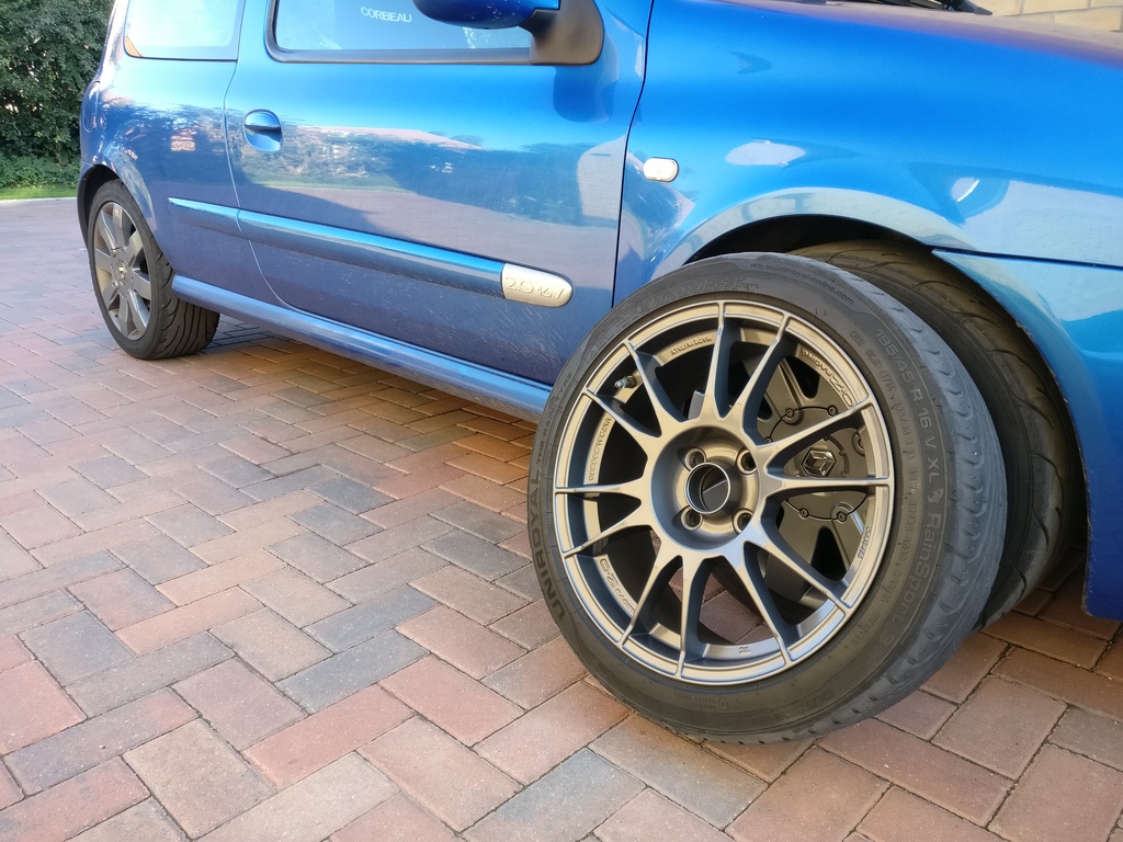

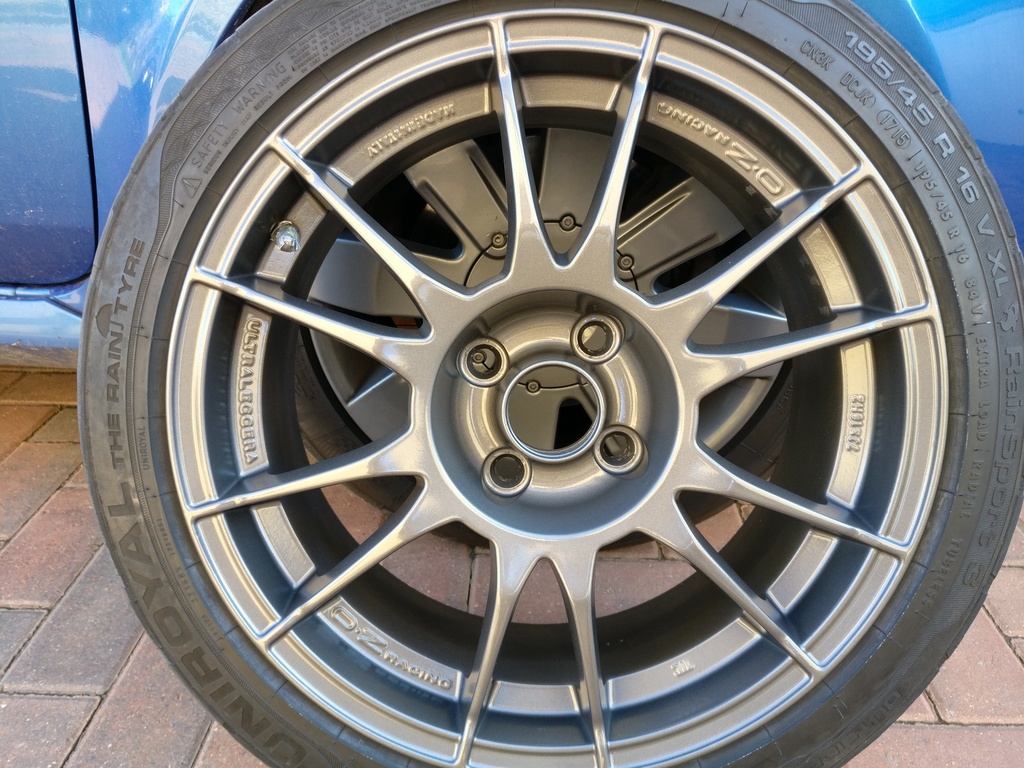

I've taken the Ultraleggeras back off the car now, they'll be getting a colour change shortly. Plus the Rainsports 3's are rubbish and the rears are probably past legal, The NS2R's are much better, at least in the dry.
The Ultraleggera are ET 37 vs the standard wheels of ET45, so already gained 8mm of offset with the wheel change. I guess my only option is to either go for something upto 10mm non hubcentric, or over 16mm hubcentric they'll equate to 18mm and 24mm. I believe the NS2R tyres are a little wider than an average road tyre, as they're a bit squarer. So will wait unti l've switched the tyres over and make a judgement from there.
Also need to think about getting longer locking wheel bolts, I assume i'll need to order two sets?

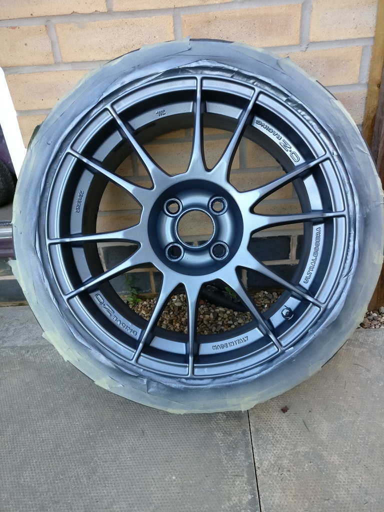

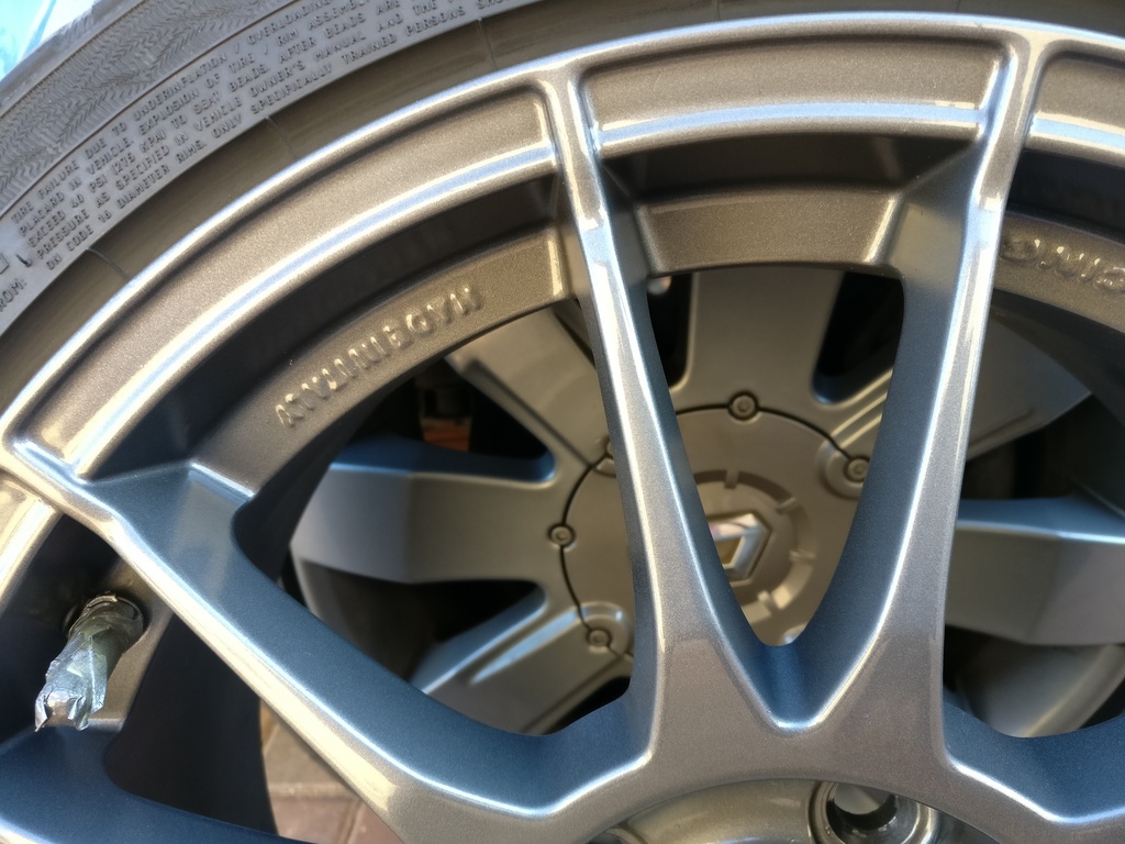

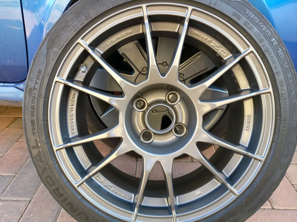

But i did get chance to sort the Ultraleggera's out, twice...
I bought some Simoniz alloy wheel paint from Halfords that was suppose to be steel grey colour, it ended up being silver, so took it back and swapped it for some Peugeot Iron Grey paint from Halfords, thinking it looked a nice shade of grey on the cap and scanning pictures on google.
Anyway while i was pretty happy with the finish it was rather blue:
Before Lacquer:
Finshed:
I didn't really realise how blue they looked until i put them against the car. The garage lighting isn't great, so they didn't look too bad in there.
So I wasn't happy with the colour, i decided to start again, I knew Rover Stone Grey was a good match for the original 182 wheels, but also read a few reviews stating this had a slight blue tinge to it, so in the end i went with Rover Gunmetal Metallic, which is maybe a tiny bit darker, but doesn't seem to have the blue tinge i was worried about.
Results:
Pretty happy with them now. Just leaving the lacquer to harder for a little longer before getting the NS2R's switched over.
I was very close to going white with them, had the paint in my hands for about 10 minutes while considering other options.
May try white, before getting them professional powder coated.

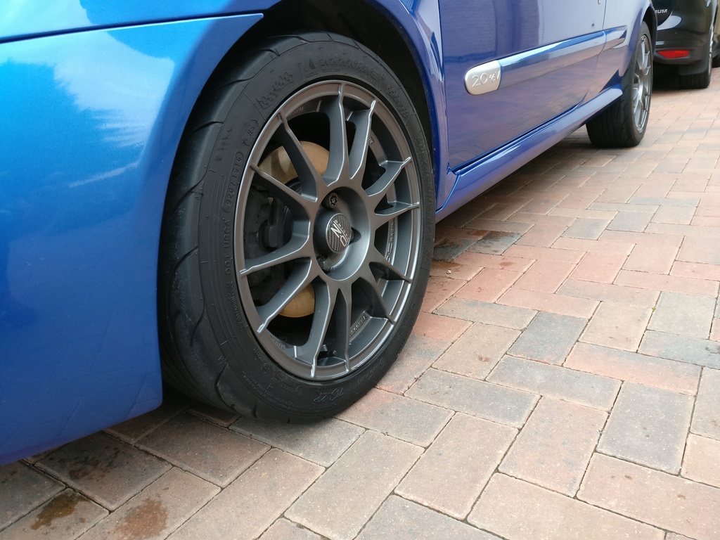

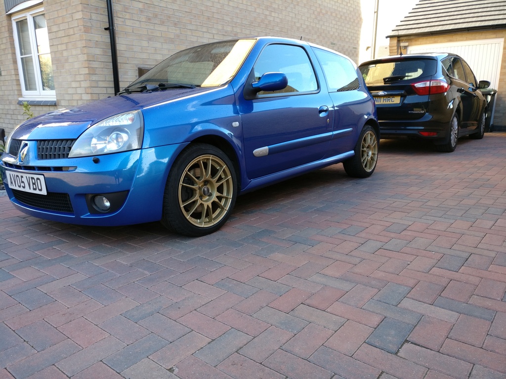

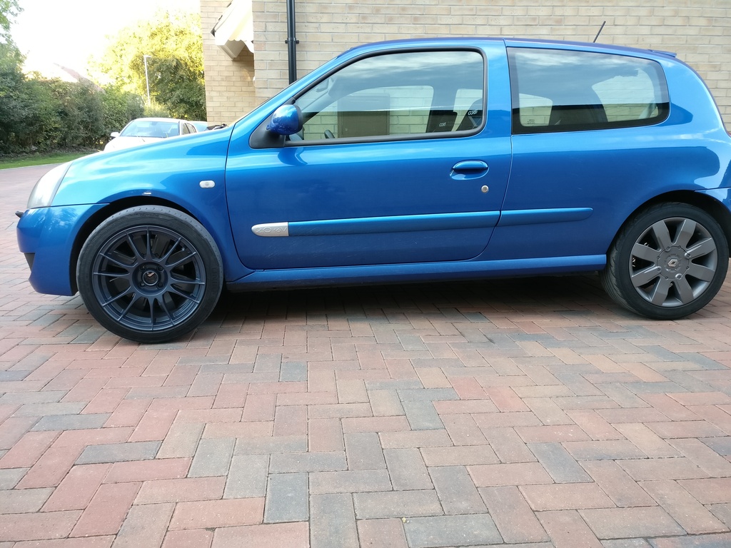

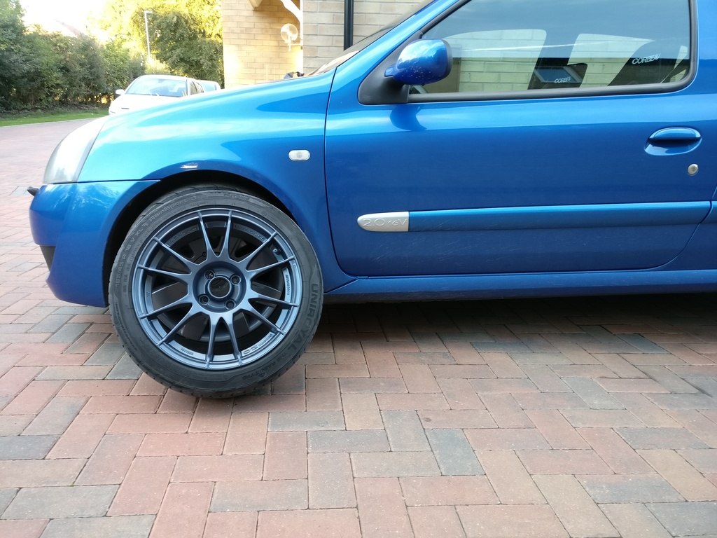

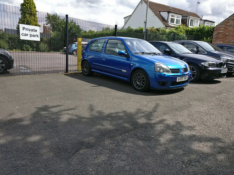

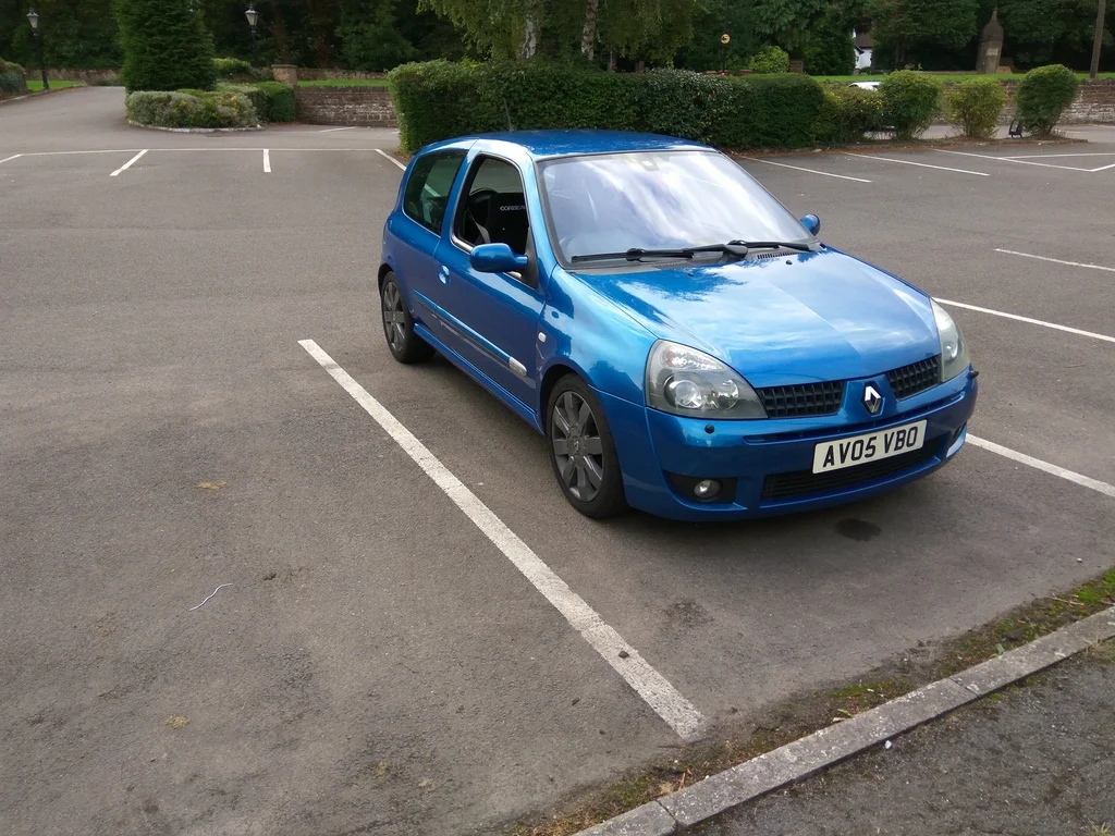

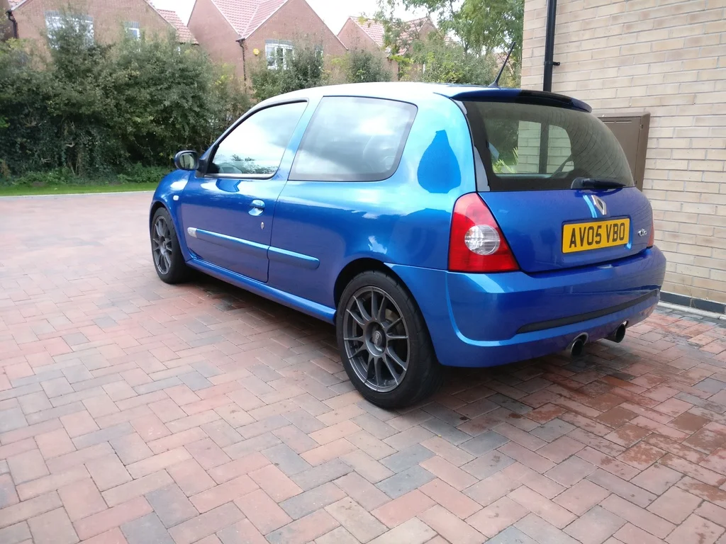

So i got the tyres switched over this weekend, gave the car a quick wash while my daughter had her afternoon nap yesterday as i didn't get time last weekend.
Much happier with this colour over the Gold, but they're a little darker than i thought they'd be.
Removed the nasty looking Renault sport badges too. Will eventually get the new style RS badge to replace the Clio badge i think.
Light was starting to fade a little, so picture are a touch darker than they should be
I've also got a scenic shifter on its way with Yanoo 3.0 already installed. Will be selling the original shifter and Yanoo 3.0 once i'm satified i prefer the scenic setup. Still need to fit the skoda splitter.
I really need to replace the locking wheel bolts too, but i'm holding off until I decide what size spaces to fit.

They look a lot better than the bluey grey you did them first.
Little drop and that'll look smart.

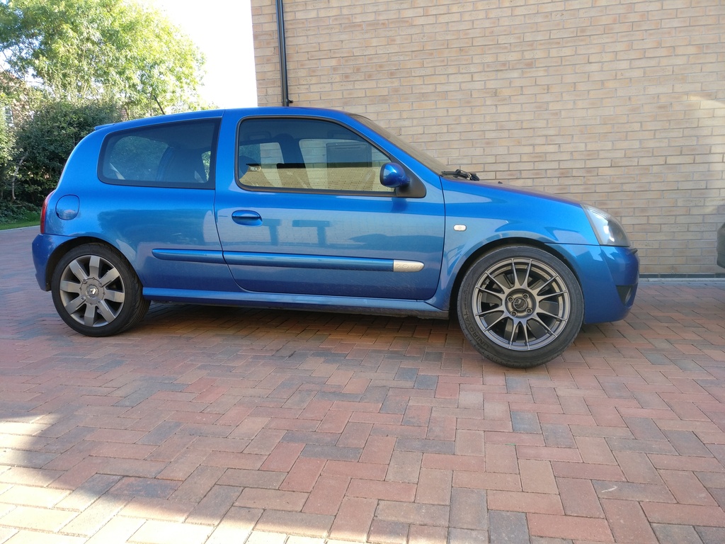

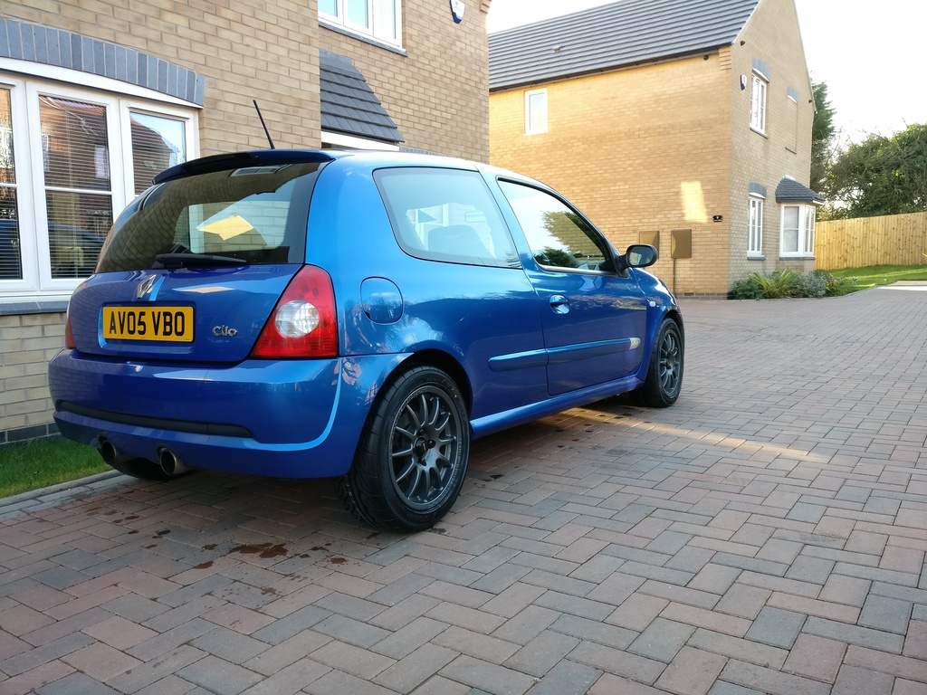

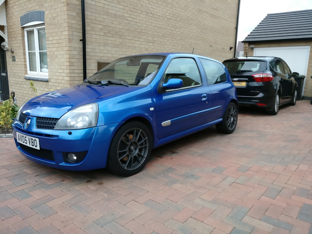

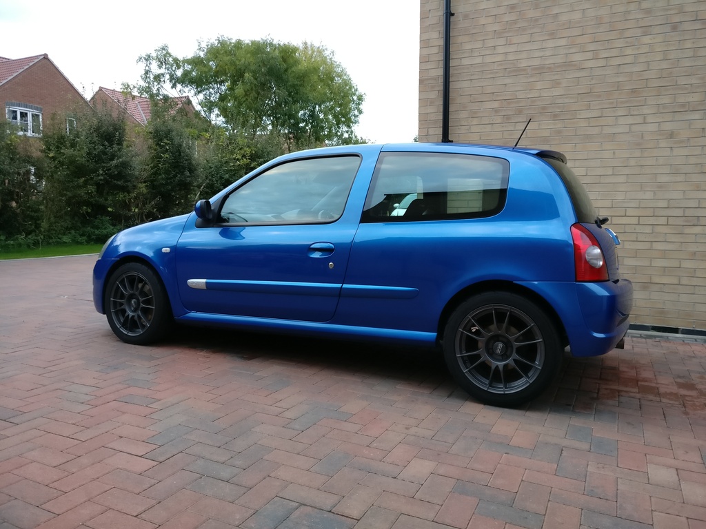

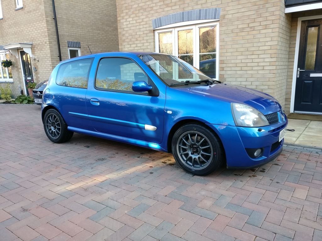

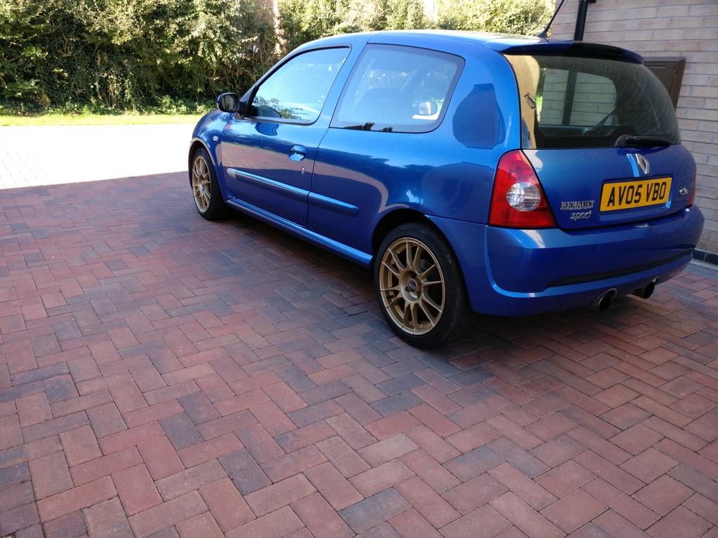

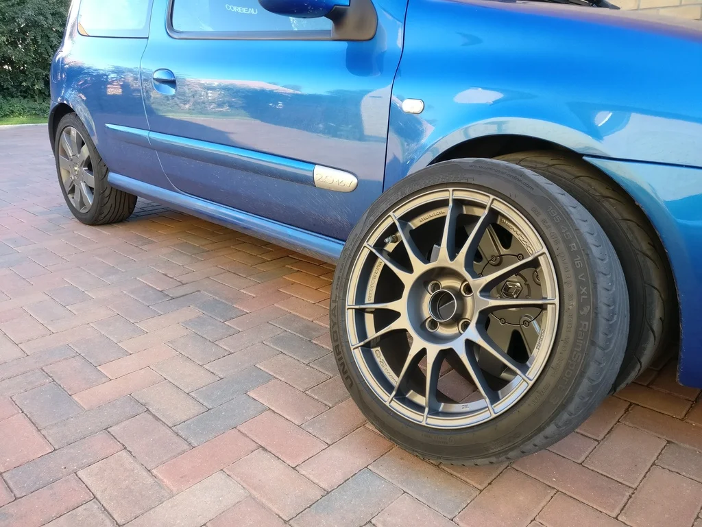

Well decided to change the wheels, as I don't think the Ultraleggera's really suit the clio to be honest.
Ordered a set of 16inch pro race 1.2's but would have been 6+ week for delivery to be manufactured. So because i'm impatient I switched to 15inch, then needed new rubber so got some AD08R thrown in for a decent amount, after topcashback, it should have cost around £570 for wheels and tyres, with fitting kit and bolt covers.
The arch gaps are annoying me a little at the minute, but i'm trying to avoid spending a fortune on coilovers. The front isn't quite so bad, but as i've removed everything out the back the rear looks pretty high.
Also finally fitted the skoda splitter too, which i think lookls much better

I kind of justified it to myself that i'll be able to sell the Ultraleggera and NS2R tyres and not be a massive amount down.... we'll see i guess
I do like the smaller wheel, bigger tyre look, but as noted it need dropping, probably another 20mm all round roughly i'd say.
Would also have liked the wheel to be a little lighter in colour, i was tempted to go with silver after spotting a few nice cars running 1.2's at the track day i did at donington on the 19th Nov. But they were about £100 more, and they didn't have stock anyway. These wheels were the only wheel they had in 15 or 16 inch that would fit the clio that wasn't black.

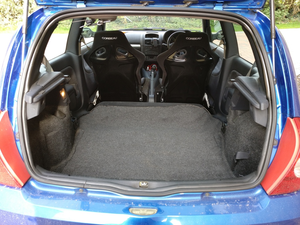

I've also stripped out the rear seats again, and bought a proper carpet to go in there. Replaced the leads with Red Magnecor, and fitted a 60mm steering wheel spacer.

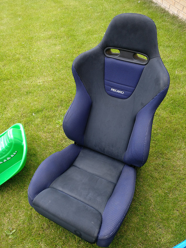

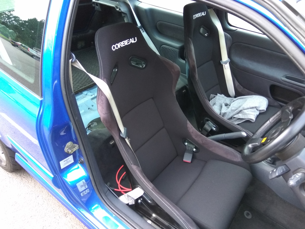

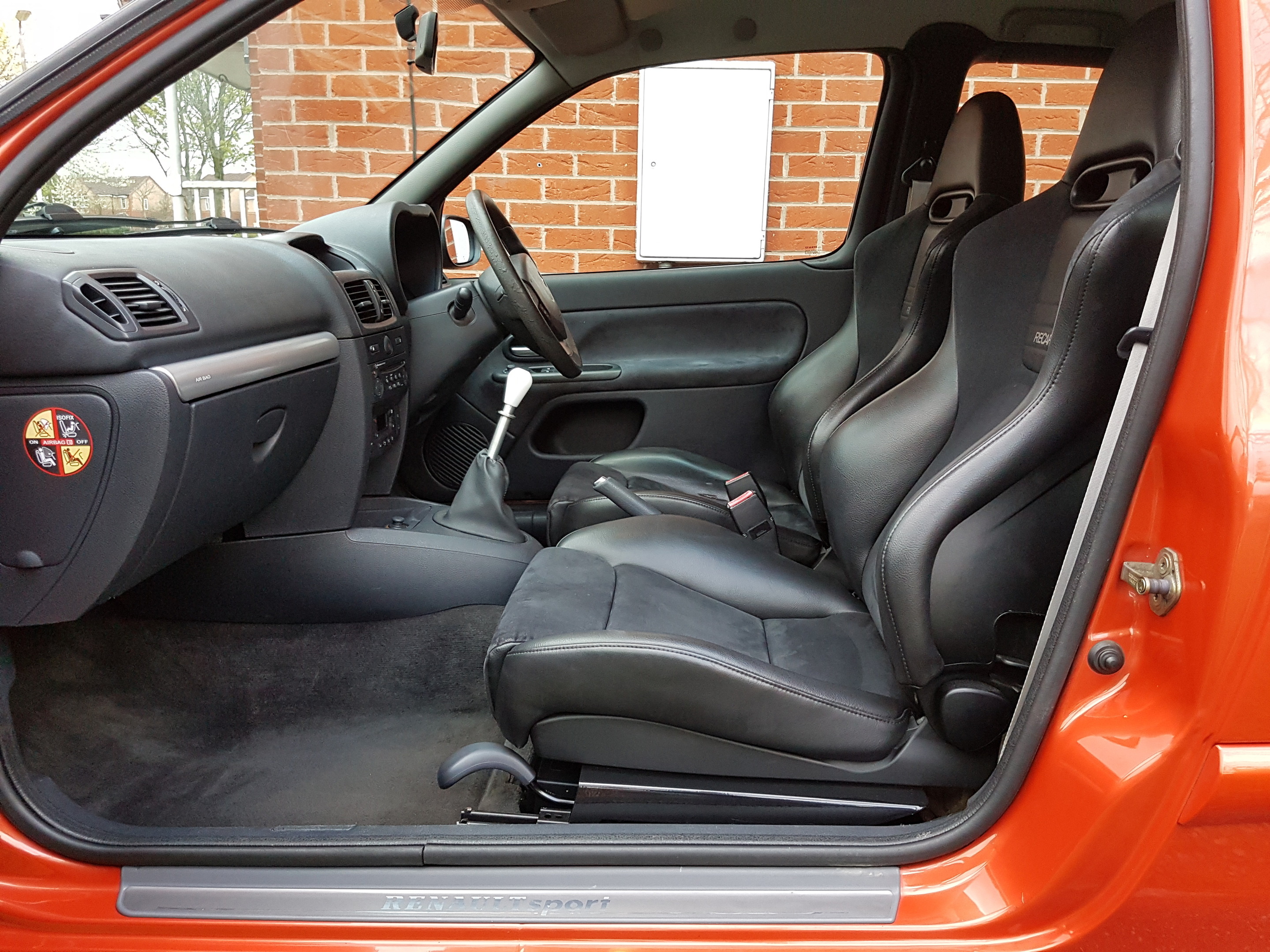

Then friday i had a quick look on ebay for some trendline evo 6 seats and made a purchase of some with the purple sides. Collected them on Friday evening after a 160 miles drive (got home at 12.30am, which was a lot later than i expected). So over the weekend i ordered some lower Recaro seat mount from Jon Foz. I'm hoping the better seating position and better seats is going to help the discomfort.
Also bought a 330mm steering wheel to replace the 300mm, as I think 300mm is a little on the small side for me.
May also look into getting another scenic shifter at some point and might need to lower the steering column slightly to suit the over adjustments made.
On another note, it passed it's MOT last week. I did have to remove the fog lights prior, as one of the lenses had cracked and i didn't want to run the risk of a fail on that. I'm thinking about getting some brake ducts to replace them. Though i don't intend to run the piping to cool the brakes at this point. I may us some to direct cool air to the RS2 intake.
Also gave the car a good wash, polish and wax yesterday, and it looks amazing now it's clean. I'd not really had time to clean it for a few weeks due to the expanding family and commitments and the weather being rubbish whenever i did have a spare hour or so.
Though this morning the air bag warning light is on. I've got resistors in for both front seats and the wheel, so not sure if it's one of these causing the issue. might be worth getting them reprogrammed i guess.
Will have to get some new pictures uploaded somewhere once the new seats are fitted.

I've got Trendlines in mine on Jon Foz lowered frames. Doubt you'll need to lower the column. The Jon Foz frames aren't that low, however they are a massive improvement over the standard seats and the standard Recaro frames that Jon does.
I've got a new wheel on my list of things to buy, will be getting an adjustable spacer at the same time and the driving position will be pretty much sorted as I already have a BMS (modded megane) shifter.

That looks better than the PMS version, being silver instead of gold. Shame they don't seem to be sold anymore.
Nice seats by the way. :smile:
Thanks for the info and PM @leeds2592 much appreciated, yeah I think that looks a bit better than the PMS one too from that photo and if it is very slightly shorter than the PMS one, that's all good...... Where did you get yours from? Website, forum?
........... yes nice seats too lol!
Cheers guys. @Darryl_1983 that's the height of mine on Jon's lower Recaro frames. I took the little spacers out but it didn't sit level so I had to put them back in on the side nearest the door on both the drivers and passenger side. Be interesting to see if yours sit level without them in.

Managed to fit my 330mm wheel last night, didn't seem much bigger side by side, but it feels massive in comparison when out on the road.
Also my Recaro mounts were delivered so bolted them up to the seats ready for the weekend.....hopefully.
