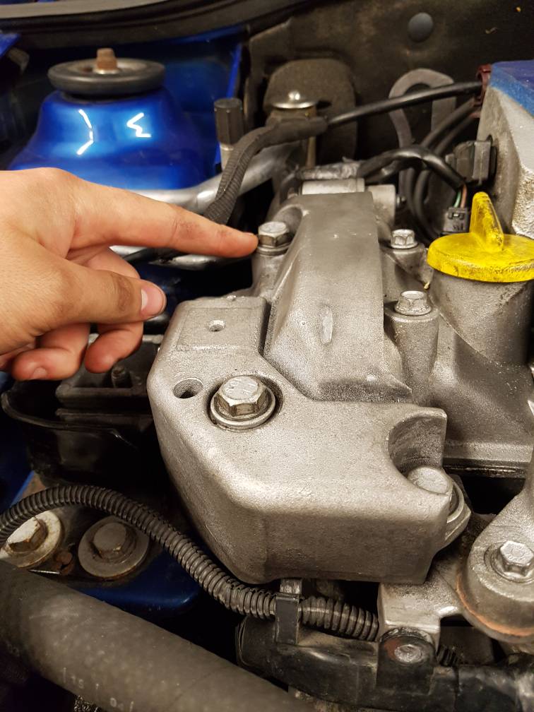

They said the same at Burnetts but I've had the engine mount off to fit a polybush mount and it's nowhere near as damp in that area. Either way they're having a look and sorting whatever it is.
On another note one of the engine mount bolts has completely stripped the thread in the block

Is it one of the bolts that screws into the cam cover though?
  M2 Comp
You can get away with just replacing the upper cambelt cover in that case - shouldn't be any more than £10 - £15 off a breaker.
