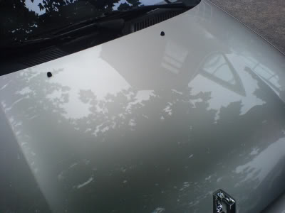

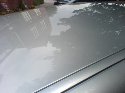

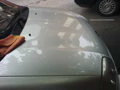

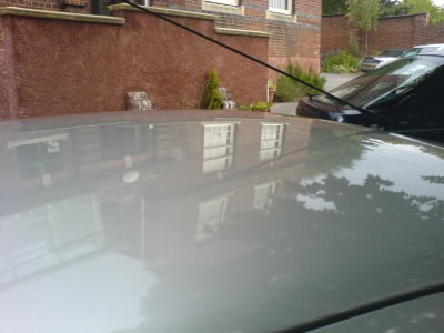

AG SRP, AG EGP, then P21s... makes ur silver clio this shiney:
  2001 Clio 1.2 Dynamique
the above looks best i feel....i will give it a go on my silver 1.2. Think the colour is a pretty s**t silver though, much prefer the silver on the sports.
