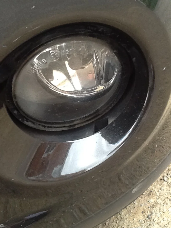

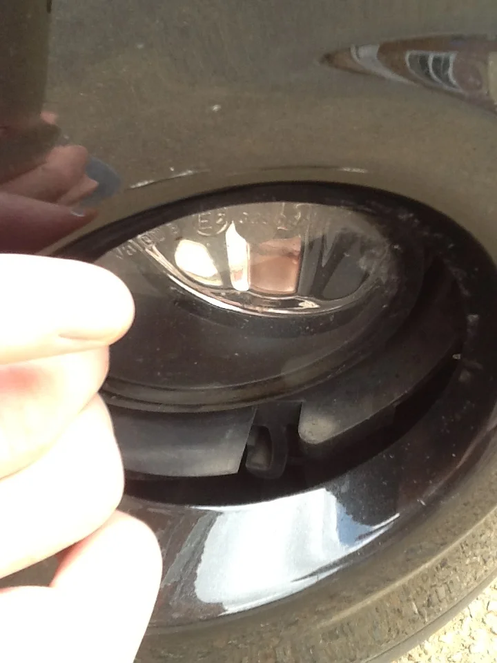

Hi, this has been bugging me for a while now. My passenger side bottom spotlight has fallen out and I was wondering how to put it back?
hi mate mine did this not long back... all i did was jack the car up and there is a gap just wide enough for your hand between the splash guards and the undertray, just reach in and push the light back into place :) you should be able to see the wire or the back of the spotlight in the gap underneath... is a 2 second job on ramps!

Cheers buddy, done it now. I managed to get it back into without using ramps ...just! Haha
