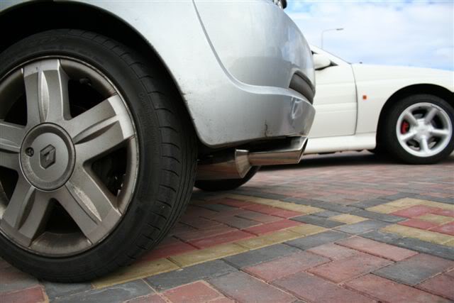

nice one mate. Ive got the loud version... chuffed to bits with it!
mine hangs below the bumper too, didnt like the looks of um below before, but its grown on me. didnt like the idea of cutting the bumper!

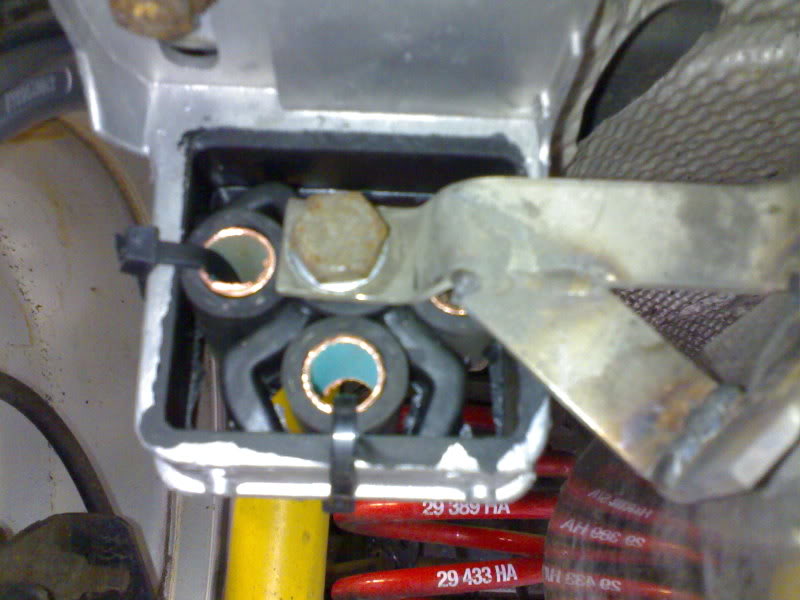

This is what i manufactured for mine, cost about £15 including the new mount, no movement or dropping anymore!! get it done!
What did you actually use?
It's dropped down about 5mm further now as I fitted a new rubber mount and its stretched slightly. Exhaust has been on since Feb and it hasn't marked the bumper at all.

^ I used a new mount ( non genuine) about £11, some 1/2" copper pipe that i pushed some rubber hose over, then slid it through the holes in the mount and cable tied the bushes in to stop them moving! can order and make you one if you wish?! drop me a pm! be about £15/16'ish.
