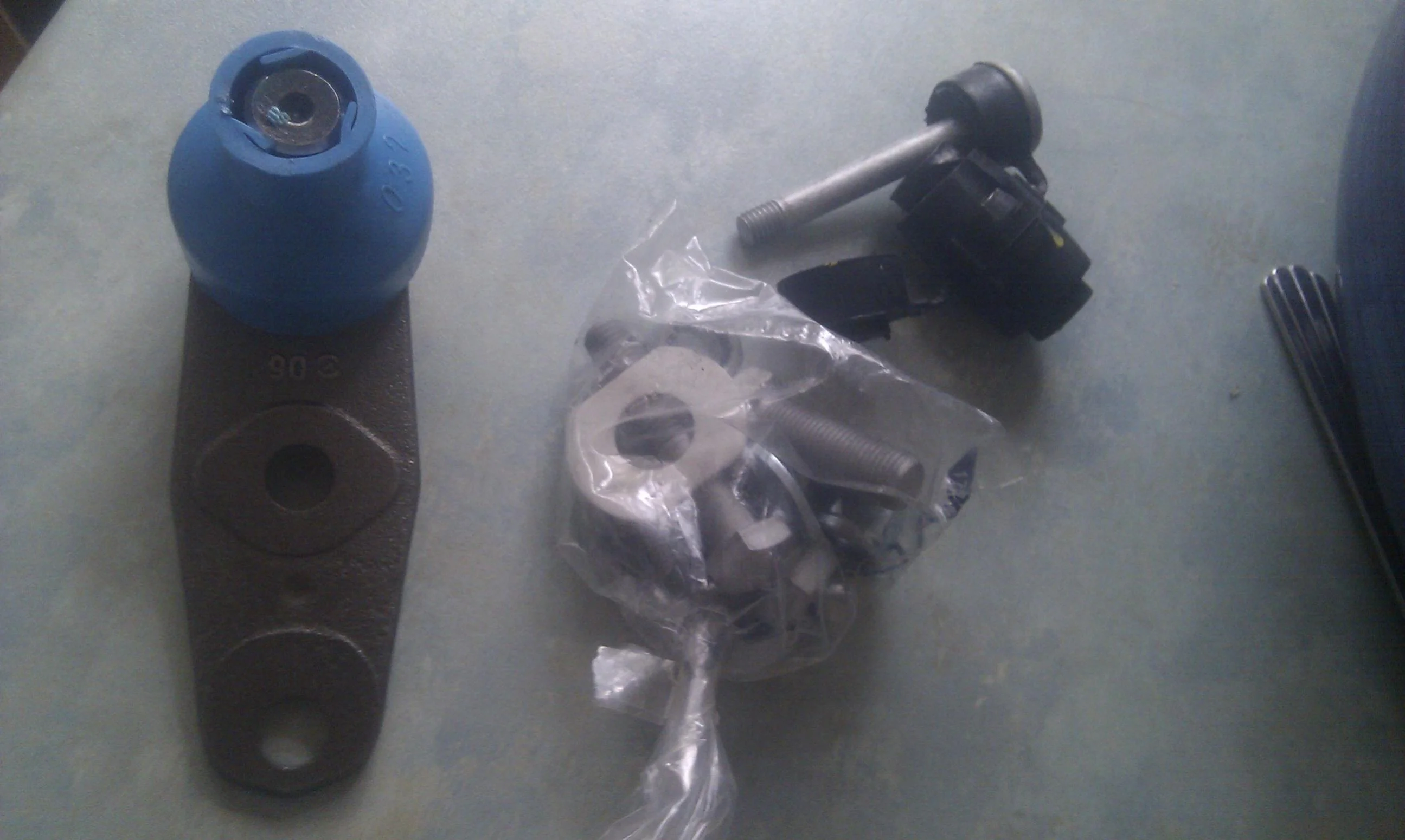

in the bag containing pinch and mounting bolts, there is a white plastic washer with 2 paralell flats, what is it?
also is that the outer arb bush that goes on w/bone? it looks dissimilar to whats currently on the car? or is that rubber bit inside the metal housing? looks a bit small :/
that picture is a ball joint the little plastic shim goes between the ball joint and the hub (pinch bolt end)
Sounds like the arb bushes are completley wrong got a picture of them
Lol my bad never scrolled across the screen to see all the picture lol. yeh you have the clio mk1 style arb/droplink bushes.
And as before slide that white plastic shim onto the ball joint with the 2 notches on it facing upwards as they will locate into the slit on the hub where the pinch bolt goes through.

take yours off and photograph it and send that pic above in with it to the supplier and tell them they have an error on their part system and you want a refund/replacement
Sounds like a good idea, there wont be much scope for them to grumble if there is photo evidence lol.
