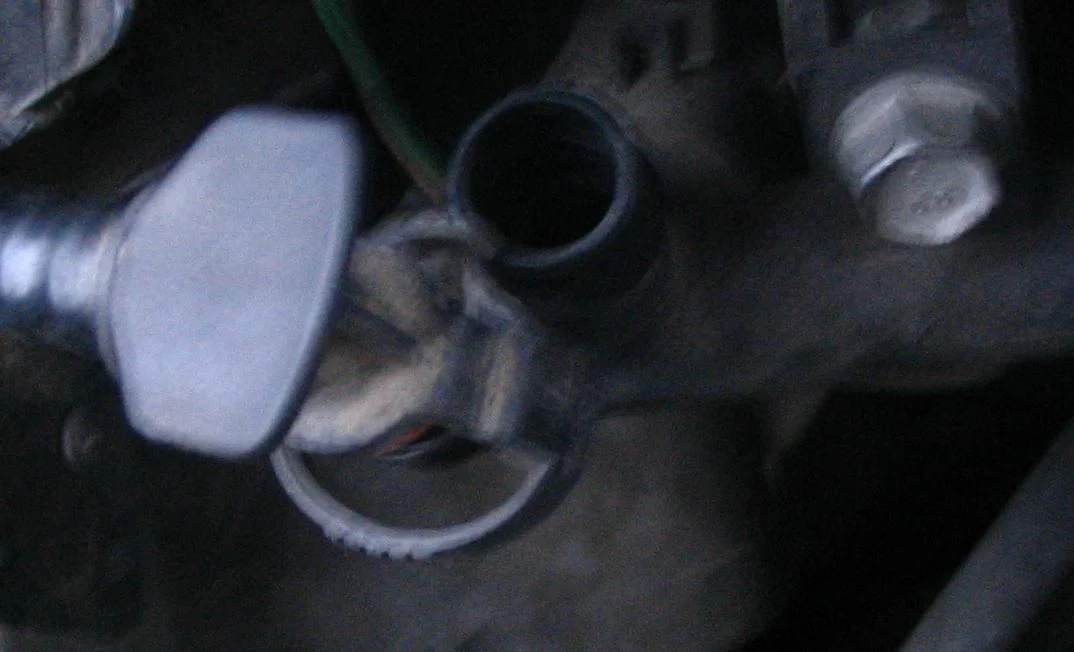

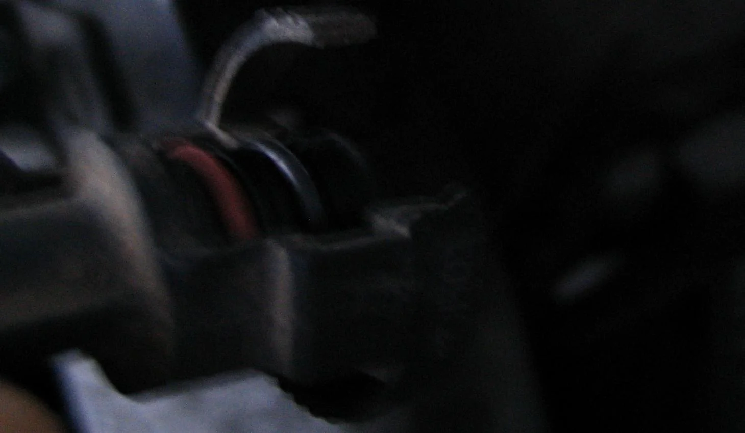

I found out the problem :) Any advice on fixing this problem...As you can see the plastic part that secures the pipe to the rail is broken...needs replacing...

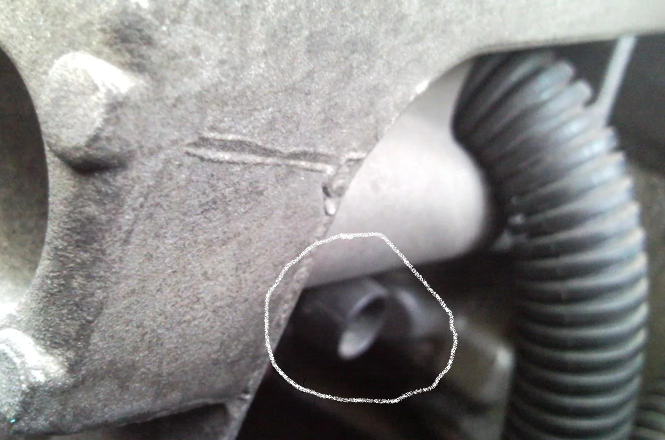

I found no other pipe/wire disconnected. Should anything be on the other end of the rail?
Idealy you need a new pipe mate. You could bodge it though. The other hole is blanked off and is a return. Only early ph1's have a return.
