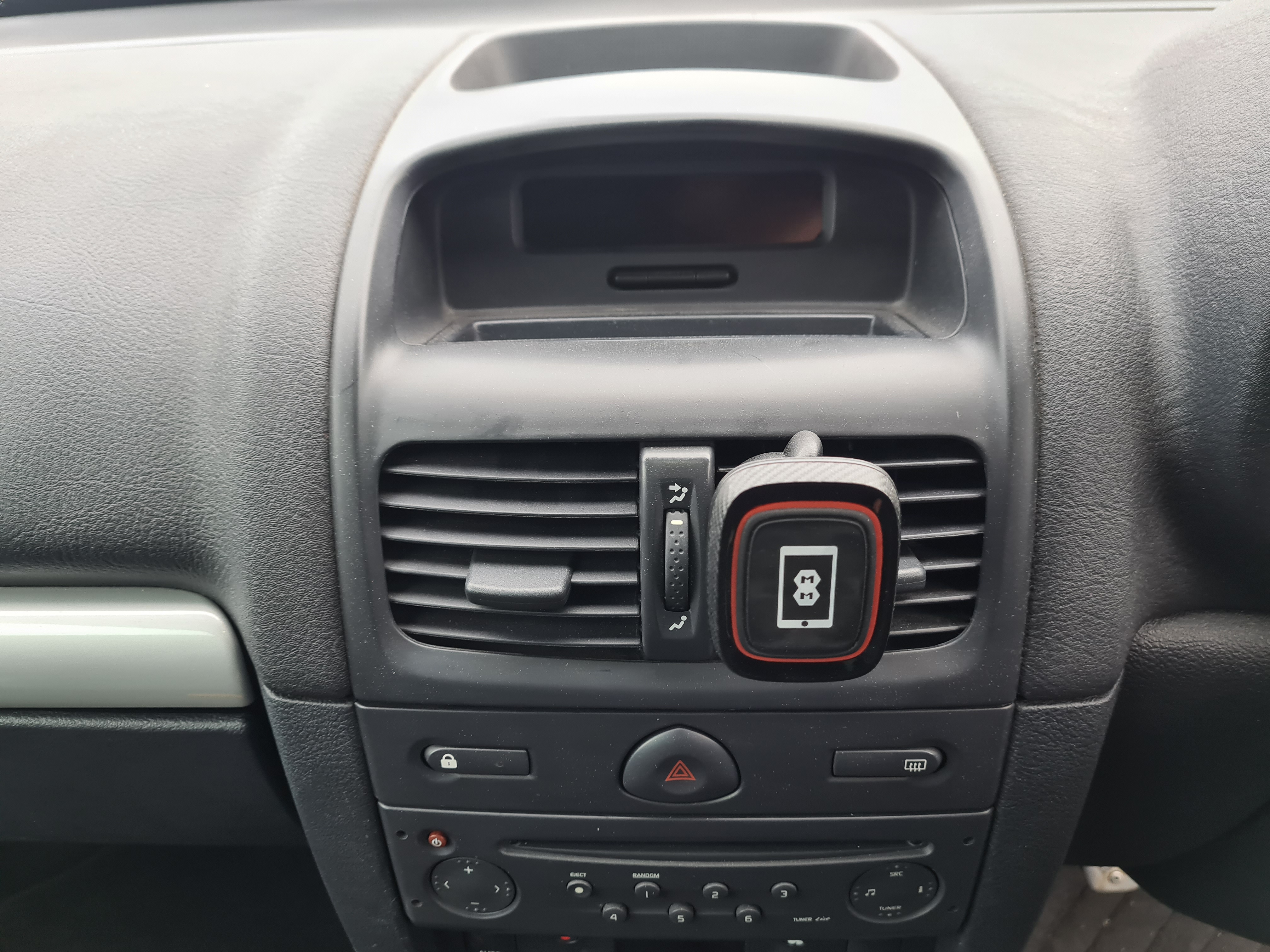

				Hi guys, does anyone know what's this part? And do I need to remove the dash to acces it?
			I was also looking for this so thank you, but I meant the whole plastic surrounding the display and vents ahahSearch for Clio Mk2 Hazard switch surround.
It just pops off using a plastic interior removal tool at top left and top right
You can then remove the 3 connectors to the switches and remove the whole thing.
The hazard switch comes out the front and the other 2 switches go out the back of the plastic surround.
Dash out job, if you were replacing it or painting it.

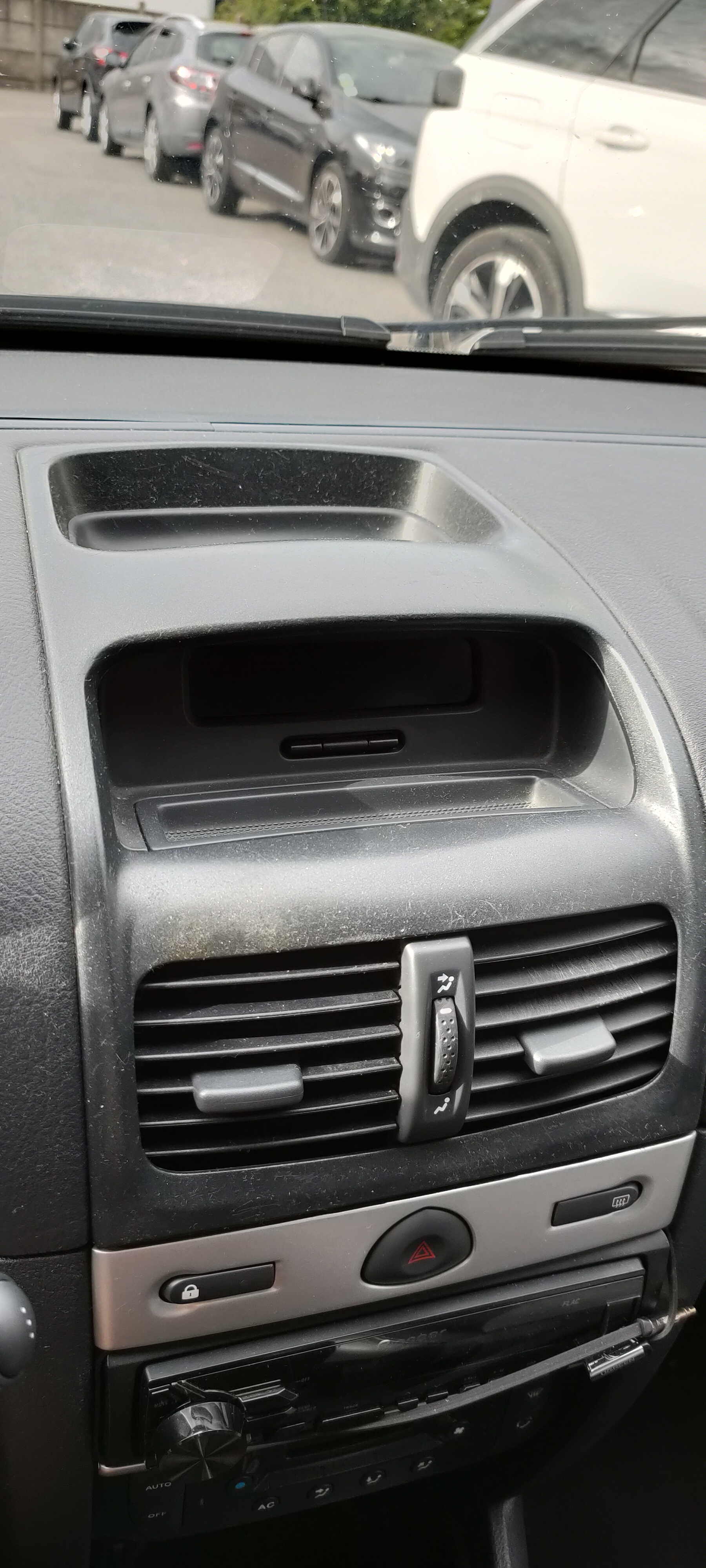

Thanks, I had a 1.4 same year as my 172 and wondered why the 172 was sticky but not the 1.4Just change the dash top for a mk2 non sport as its non sticky. There's a guide section in here on how to do it but it's a 20 min job and is a like for like swap. Saves painting it and will be a better finish.
Pic of non sport dash top.View attachment 1544588
Interesting, do you know if there's any way to make it smooth again without replacing the whole dash?The soft touch was a feature on sport models and "I think" some non sport models. But Iver the years the soft touch goes tacky. Bit like the steering wheels melting.
